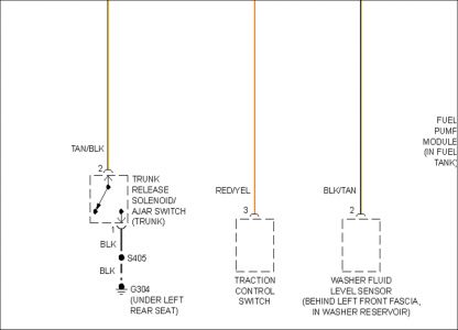

I attached another couple of pics for you. . .. . .. . .. . .. . .. . .
Also, I just went through 3 pages of transmission wiring. . .. . .nothing about the trunk. . .. . .so that must go through the transmission module to the BCM.
Now when I review the info on the transmission park/neutral switch. . ..it also says nothing about this. So as you said. . ..it is a logic circuit that goes from the PCM to the BCM. . .. . ...

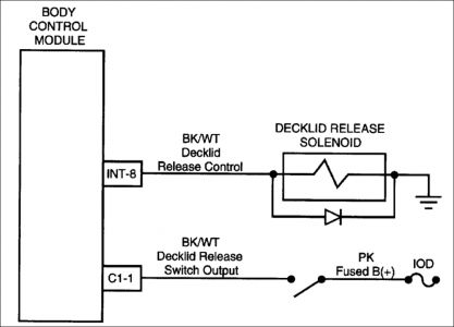

I still gotta wonder about the S204 splice though. That is between the JB and the Trunk release. That same splice is tied to the BCM and ATC. . .. . .
Did you have a chance to pull the wiring back on that and see if there was damage there?
To me. . ...I haven't seen it or defiantly have not been the one going through what you have. . ..but I would check that S204 really good before the diode. That is just me. . .. . ...but again. . ..you are the guy in the trenches on the front line here. . .. . ...so you know better than me.

Again, if you haven't. . .. . .. . .. . ..that S204 is bugging me. . .. . ...

I also attached again all the goodies the BCM plays with.
