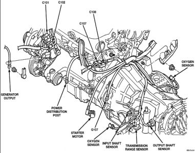

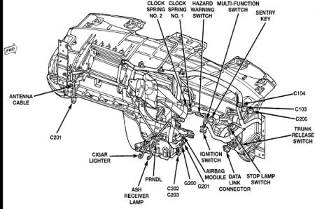

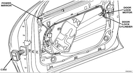

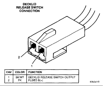

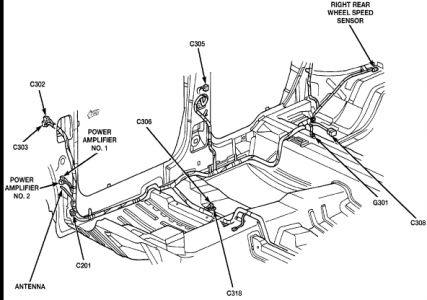

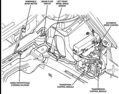

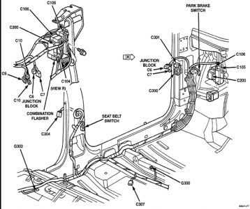

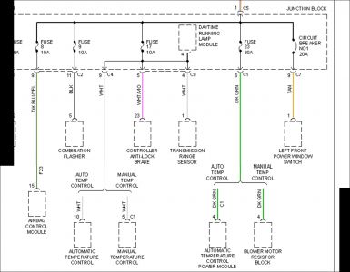

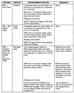

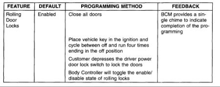

Bill The BCM is programmable as you see from the info I have provided. You can program certain things for the customer. Soooooooo, I guess if you did find a good one, it would still have to be programmed for your car based off of what your car had. It is still a pain cause you have to use the dealer no matter what.......They should have a flash drive you can plug and unplug from car to car. Let me know what you find out. Oh, I haven't received any responses from the parts request I sent out and it has been a week. Sorry. Bob The Body Control Module (BCM) supplies vehicle occupants with visual and audible information and controls various vehicle functions. To provide and receive information, the module is interfaced to the vehicle's serial bus communications network (the Programmable Communication Interface (PCI bus). This network consists of the powertrain control module (PCM) , the memory heat seat/mirror module (MHSMM) , sentry key immobilizer module (SKIM) , the transmission control module (TCM) , the electro/mechanical instrument cluster (MIC) , the optional overhead travel information system (OTIS) , airbag control module (ACM) , optional anti lock brakes (ABS) and the optional automatic temperature control (ATC) display head. The BCM is operational when battery power is supplied to the module, ignition switch power is needed for ignition switched functions. The body control module provides the following features: Automatic headlamp and foglamp A/C switch status / evaporator temperature status BCM diagnostic support Central lock and unlock (VTSS only) Climate Control (Automatic and Manual) system support Door ajar switch status Door Lock Inhibit (key in ignition or headlamps/park lamps on) Electronic Odometer Support Fog Lamp Control Headlamp multiplexing control Headlamp, Park & tail lamps with battery save feature Headlamp Time Delay Illuminated Entry with "fade to off" Interior lighting with battery save feature Mechanical Instrument Cluster (fuel level, dim data, odometer & warning chime) support Memory system (LHS and 300M) Overhead travel information system Power door lock multiplexing control Rear Window Defogger Control Remote Keyless Entry with Panic Mode Remote power decklid release Rolling door lock control (customer programmable) Sentry key immobilizer Speed proportional steering Vehicle Theft Security System Wiper Control (speed sensitive with return to park) The BCM receives information over the PCI Bus from the PCM in order to support certain features. The required information is as follows: Engine RPM Engine Temperature Injector on Time and Distance Pulses Vehicle Speed Charging System Failure, Engine Temperature Limp-In, VTSS Arming Status Engine Model "Check Engine" lamp status The BCM provides the PCM with information on the NC switch status, battery temperature which is determined by the ambient temperature sensor and the "OK to Start" or VTSS status.
https://images.2carpros.com/forum/automotive_pictures/248015_1_75.jpg
https://images.2carpros.com/forum/automotive_pictures/248015_2_52.jpg
The 1998 and 1999 LH has several customer programmable features which can be disabled or enabled by the customer.

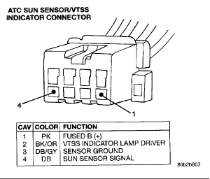

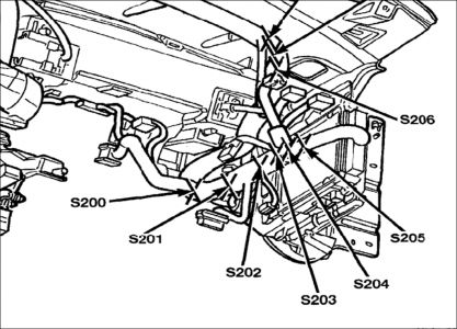

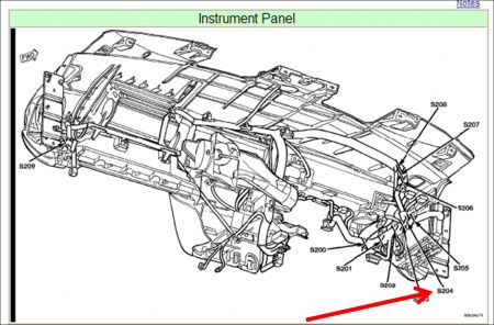

IMPALASS
  • 3,112 POSTS

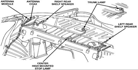

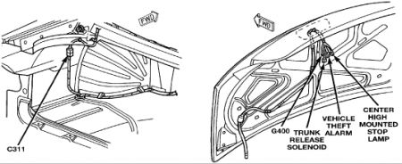

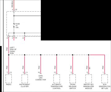

Hey Bill I was going back over the post and was wondering about seeing if something else, some other system points to the BCM as bad also. But first I figured try the in vehicle calibration check to see if it throws any codes. I attached that info - pic below.
https://images.2carpros.com/forum/automotive_pictures/248015_Picture12_2.jpg

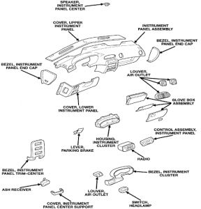

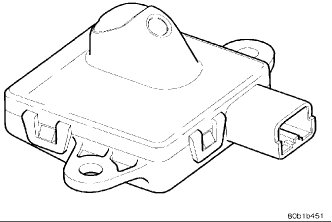

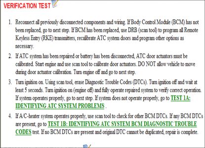

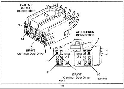

Then, I was going back through the info - back on 31 Oct post the Sun Sensor was brought up as it does aid in determining proper mode door position, temperature door position and, blower speed. The only check I had was for the plug. I have attached the system operation and how to check the plug back on the 31st of Oct but don't remember any other discussion on it. Here again is the operation.... SYSTEM OPERATION The sun sensor is only used on vehicles equipped with Automatic Temperature Control (ATC) . The sensor is mounted on the top of the instrument panel below the instrument panel top cover. This is not a thermistor type sensor but rather a photo diode. For this reason the sun sensor responds to sun light intensity rather than temperature. It is used to aid in determining proper mode door position, temperature door position and blower speed. The sun sensor is also used to sense day/night conditions for automatic headlight control if so equipped, and has an LED indicator for the vehicle security system. I was thinking about that BCM and though what about another system checking it. I attached the OTIS checkout. What I was looking at was number 2, if no communication replace the BCM.
https://images.2carpros.com/forum/automotive_pictures/248015_Picture13_2.jpg

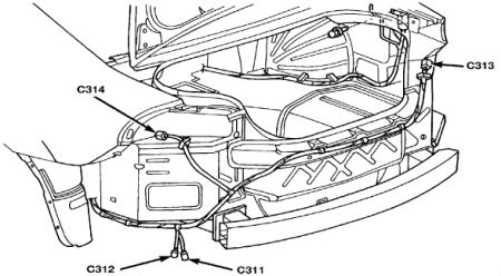

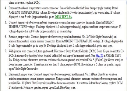

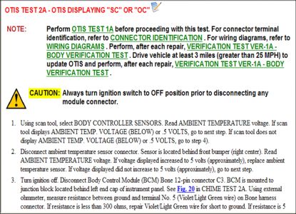

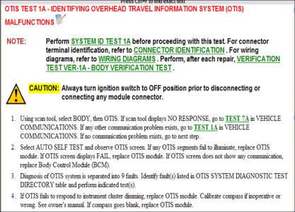

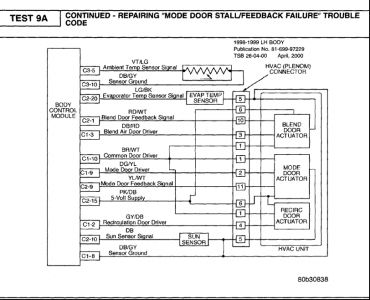

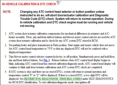

Next OTIS Test 2A. It calls for a scan tool in numbers 1 and 2 and talks about replacing that front sensor. You already replaced it so I say go to step 3 and use the Ohm meter and do this check to see again, does it point to the BCM. Also follow the testing with the ohm meter through steps 7 and 8....see if they point to the BCM. That is below.
https://images.2carpros.com/forum/automotive_pictures/248015_31_1.jpg
https://images.2carpros.com/forum/automotive_pictures/248015_32_1.jpg

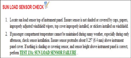

Next a little more info on the sun sensor - make sure clear etc.....below Pic
https://images.2carpros.com/forum/automotive_pictures/248015_Picture15_1.jpg
https://images.2carpros.com/forum/automotive_pictures/248015_Picture16_1.jpg

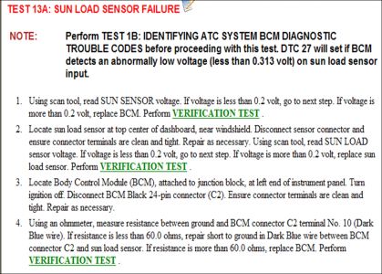

But where I am heading is the next item....pic below. Sun load sensor failure. Yes you need a scan tool (of course) but step 4 has you using an ohm meter and eventually says to replace the BCM. Then the last item is the verification and recal info...pic below.
https://images.2carpros.com/forum/automotive_pictures/248015_Picture17_1.jpg
Well, not sure if any of that is helpful.....just trying to get more confidence that the BCM is no good. Let me know what you think after review of the above info.

Bill Totally understand the frustration about the scan tool. The other day a friend of mine came by with a 1967 Camaro. Opened the hood and there it was........an engine.....yes......just an engine and the only electrical thing I saw was one red wire going to the choke....and then look there it was.........a fuel pump.....on the side of the engine.....if oil/fuel was leaking out you KNEW there was a problem.......a few hoses.......but just an engine........no relays..auto this or that.......... The only thing I know of is the actual service manual for the car. I have the actual service manual for my car.......it is detailed and gives different options to troubleshoot but you still need special tools to check computers. I can ask some of the other moderators if you would like though. Rain.......us rain and snow............ I have attached the circuit for the trunk release if that helps at all. But as we both know it goes through the BCM. Good luck today............enjoy your Sunday also..............the good Lord did.......... At least it "seems" to be kind of working right now...............on auto......I believe you said. Take care Bill............I am still cheering for ya.....I'm not wearing the outfit..:) but I am cheering for ya............... Oh........if you would and don't mind, can you go into the PM part under my name and provide me with your complete address..........this way not everyone on the post knows it.
https://images.2carpros.com/forum/automotive_pictures/248015_Picture11_9.jpg
https://images.2carpros.com/forum/automotive_pictures/248015_Trunk_1.jpg

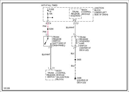

Thanks for the schematic. I printed the same one last night just before throwing in the towel for the day and buttoning everything up. I've compared this schematic to the main one for the BCM circuits and just now realized that I was mistaken about the BCM schematic as it relates to the trunk release circuit. If you look for the C-4 pin 8 designation on the BCM circuit schematic you won't see it. It was really causing me some concern last night because the C-4 connector from the trunk release schematic isn't the C-4 on the BCM itself, like I misread the trunk release schematic to mean. I now see it should have been the C-4 of the junction block..... This means that my problem with the trunk may be a junction block issue. DRAT...!!! That also means the other issues may be junction block and not BCM....
I have an errand to run and will try to sort this out later. I think I need to do more digging in the manual and pull out more system-specific schematics. This is where I'm tempted to buy Chrysler manuals and schematic books..... Paper docs are easier to navigate around....

Hey, I attached a couple of pics……….not sure if that helps……….
Also, have you tried to let it recalibrate itself?? I thought about that when you replaced it and it did okay……..then went weird again……….just a thought…..
REPAIR PROCEDURE:
1. With the vehicle at room temperature 10 °- 27 °C. (50 °to 80 °F.), remove the M-1 circuit fuse for ten minutes to erase DTCs.
2. Install the M-1 fuse and start the vehicle, this will initiate the HVAC system calibration. Allow approximately five minutes for the calibration to complete.
3. Operate the vehicle and HVAC system to verify that Symptoms and/or DTCs are gone. If tapping noise or Blend Stall/Feedback DTCs re-occur, additional diagnosis will be required.
Chrysler Tech Service………..well, I would ask the dealer…………next……….I attached a site that you ask just Chrysler questions on………now don’t be a trader…….you still gotta keep me informed on the progress here………this is getting to be a sickness……….I woke up last night about 2 am thinking about the display….(the info above)………so you have me and 1000 other readers on the edge of their seat watching this story unfold………I am not sure if you or the car are the main character……….but it is definitely suspenseful.
Yes…..sorry I didn’t respond on the PM……I did get it………thanks…..I should have responded back to let you know…..…..I did send you a snail mail………..it is crossing the frozen tundra heading to sunny CA.
Going to try and stay warm……you bet………….talk to you soon.
https://www.2carpros.com/forum/automotive_pictures/248015_101806060_1.jpg
https://www.2carpros.com/forum/automotive_pictures/248015_71540653_1.jpg

The repair manual I purchased from eAutorepair (Mitchell 1) doesn't have any M-1 fuses in it....... And the diagram you included isn't in my manual..... The Mitchell manual does the same thing by telling you to disconnect the battery negative terminal remote terminal.... The Mitchell system doesn't indicate that the ATC will automatically enter the recalibration mode. They tell you to use the ATC "In-vehicle calibration and DTC check".... wondering what kind of super-manual you moderators are "Bogarting" for yourselves.......................

Did the other information “the pics” help at all or did you have that in your manual??

The image you included in your posting didn't really help that much because its size is reduced significantly and the resolution is way down. I've tried copying the image and viewing it outside of the posting, but the resolution prevents you from even reading the labels in the image. Thanks for the thought, though.... If we were working from the same manuals, you could just tell me the image you're looking at. In some of the earlier postings, I recognized the images as being from the Mitchell manual I'm using. Those helped me to be sure I was in the right area.

Hello - On today.........interesting............ Sounds like you have a top notch body shop. You gotta think that you have a pinched, chaffed or damaged wire somewhere in there. Okay, I have two wild thoughts.........see what you think. What if the ATC and BCM are just fine.......how do you feel about taking reading while you drive? I went back and was looking over some wiring diagrams again. The first one you see that fuse 23, Dark Green goes to the ATC. Fuse 17, white wire goes to the ATC also but is probable for lighting.
https://images.2carpros.com/forum/automotive_pictures/248015_Picture7_14.jpg
Now thought one, splice a wire in and put a meter on it and while you drive around you can see what the volts are. If it goes wacky.....you see the reading. Okay, next pic. By the way.....both of these pics are spliced together to make them bigger so there is some goodies that are missing but I didn't think they were important. I just followed the wire we were looking at. Okay, next pic..........the mystery fuse 19. You follow that little red wire guy and it goes from fuse 19 to spice S204. I thought this was interesting....look at what is connected to the splice besides the ATC........yep.....the trunk release switch. Okay, so splice S204 is located on the left side of the dash. I gave you 2 pics of that....a broad pic so you have an idea of the location and then a close up...........it looks like the entire splice is pink wires going to all those different items...........
https://images.2carpros.com/forum/automotive_pictures/248015_Wiring_1.jpg
https://images.2carpros.com/forum/automotive_pictures/248015_Splice_204a_1.jpg
https://images.2carpros.com/forum/automotive_pictures/248015_Splice_204b_1.jpg
Me, that is the first place I would go.....I would open that splice are up and see if the ATC and Trunk Release wire are chaffed, touching etc somewhere up and down that area and follow those wires as long as I could. Let me know if the images are not good enough for you........I will find other ways to get them bigger or to you. Who knows, maybe I could blow them up, fax them to the local Chrysler dealership and............okay....maybe not. Really though...let me know and we will figure something else out. Here is the pics from the last time...blown up more.
https://images.2carpros.com/forum/automotive_pictures/248015_Test_1_1.jpg
https://images.2carpros.com/forum/automotive_pictures/248015_Test_2_1.jpg

You may be right on the pinched or chaffed wire. As intermittent as the problem is, the front end damage it's experienced, and the removal of the dash, that's how it's acting....
As far as the S204 concept, I can check that out, next time I'm under the dash. I've been thinking the same thing about monitoring the voltage in various circuits. Regarding the loss of voltage to the trunk release circuit, I've already ruled that out. I have voltage on the pink wire at the switch and through the switch back to the junction block. What I haven't done yet is remove the junction block and check continuity through it for the various circuits. I'm pretty sure that at an earlier point I've confirmed the voltage was available through the switch and back to C-1 pin 1, which goes directly into the BCM. If the power is operating correctly from the fuse through the switch and back into the BCM and it doesn't release the trunk that says BCM to me. Especially if I can open the trunk with the key fob. This entire circuit will get closely scrutinized this weekend.
