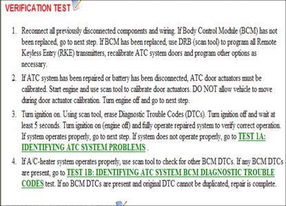

Hello - Well I totally understand BG on the frustration.............I am looking at couple of different manuals and sometimes they go in different directions...some areas you come across explain a lot....some...it's just not there..........I am sure it is back to that.....you gotta have the right test equipment to check things out.........but then last week I worked with someone who spent $600 beans at the dealer and they came up with sorry....can't figure out your fuel gauge....you must replace it. Well, we tracked wires to a connector over by the passenger door.....the dog gone thing was burn in half. When he told me I thought okay......burnt........no.....he sent me some pics.........now I gotta ask...how in the world can you have all that test equipment....charge someone $600 dollars, say you gotta replace something and the plug is totally burnt and destroyed? I don't know.....he was on his way down to the dealer..........he was rather upset....if it helps you any.....I ask him while he was shooting everyone to stop in the shop, pic up that code scanner we need, shoot his way over to the mail room and while they have him pinned down, boxed it and thrown it in the mail pile to me.....then throw the gun out and turn himself in and plead insanity.........of course I then would forward the code scanner to you and we could get some progress. Well, I haven't heard from the lad and I haven't seen anything on FOX news..........soo??? Then the other problem is it seems things are all over.........if you remember a few posts back that is what we ran into with finding the....pull the mystery fuse and let it recal.........wasn't even in the same areas as I had been. I attached another couple of pics for you.................. Also, I just went through 3 pages of transmission wiring......nothing about the trunk......so that must go through the transmission module to the BCM. Now when I review the info on the transmission park/neutral switch....it also says nothing about this. So as you said....it is a logic circuit that goes from the PCM to the BCM........ PARK/NEUTRAL SWITCH The automatic transaxle manual valve lever position sensor supplies the park/neutral input to the power train control module. The park/neutral switch input tells the PCM whether the transmission is in Park, Neutral, or a drive gear selection. This input effects idle speed, fuel injector pulse width and ignition timing. So I guess what I am saying is you may need to try to view this as a.......things to do item so it doesn't stress you out...............I think....even with the owners manual you would be jumping around....you may have more info....but still jumping around. You might consider talking to the folks you got the BCM from and see if they will extend or turn it in the purchase again if you feel you need it. At least they will know you are chasing a problem. I still gotta wonder about the S204 splice though. That is between the JB and the Trunk release. That same splice is tied to the BCM and ATC...... Did you have a chance to pull the wiring back on that and see if there was damage there? To me.....I haven't seen it or defiantly have not been the one going through what you have....but I would check that S204 really good before the diode. That is just me........but again....you are the guy in the trenches on the front line here........so you know better than me. Hey, don't get too down here......maybe you need a night out with the wife, a good meal, a good movie....and most of all some good buttered popcorn. Don't let this get you down BG.....it's Christmas...........it is working in manual......so maybe this is a project at this time..........not a quick fix.......... Again, if you haven't.............that S204 is bugging me........ Hang in there................
https://images.2carpros.com/forum/automotive_pictures/248015_Trunk_2_1.jpg
https://images.2carpros.com/forum/automotive_pictures/248015_Trunk_3_1.jpg

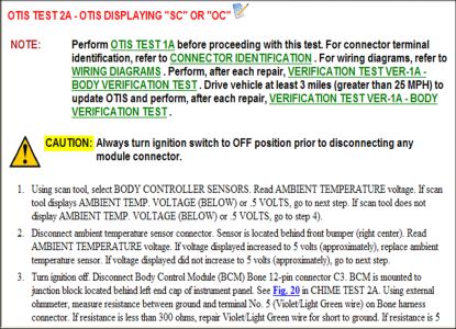

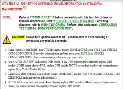

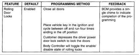

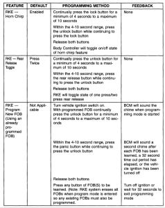

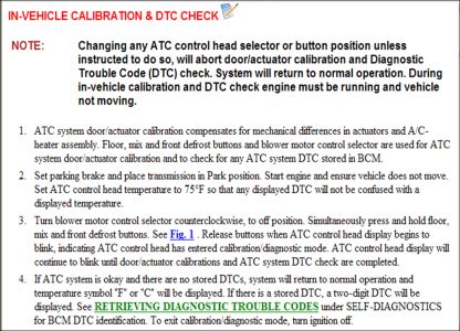

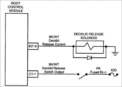

I also attached again all the goodies the BCM plays with. Body Control Module Notes The Body Control Module (BCM) supplies vehicle occupants with visual and audible information and controls various vehicle functions. To provide and receive information, the module is interfaced to the vehicle's serial bus communications network (the Programmable Communication Interface (PCI bus). This network consists of the powertrain control module (PCM) , the memory heat seat/mirror module (MHSMM) , sentry key immobilizer module (SKIM) , the transmission control module (TCM) , the electro/mechanical instrument cluster (MIC) , the optional overhead travel information system (OTIS) , airbag control module (ACM) , optional anti lock brakes (ABS) and the optional automatic temperature control (ATC) display head. The BCM is operational when battery power is supplied to the module, ignition switch power is needed for ignition switched functions. The body control module provides the following features: Automatic headlamp and foglamp A/C switch status / evaporator temperature status BCM diagnostic support Central lock and unlock (VTSS only) Climate Control (Automatic and Manual) system support Door ajar switch status Door Lock Inhibit (key in ignition or headlamps/park lamps on) Electronic Odometer Support Fog Lamp Control Headlamp multiplexing control Headlamp, Park & tail lamps with battery save feature Headlamp Time Delay Illuminated Entry with "fade to off" Interior lighting with battery save feature Mechanical Instrument Cluster (fuel level, dim data, odometer & warning chime) support Memory system (LHS and 300M) Overhead travel information system Power door lock multiplexing control Rear Window Defogger Control Remote Keyless Entry with Panic Mode Remote power decklid release Rolling door lock control (customer programmable) Sentry key immobilizer Speed proportional steering Vehicle Theft Security System Wiper Control (speed sensitive with return to park) The BCM receives information over the PCI Bus from the PCM in order to support certain features. The required information is as follows: Engine RPM Engine Temperature Injector on Time and Distance Pulses Vehicle Speed Charging System Failure, Engine Temperature Limp-In, VTSS Arming Status Engine Model "Check Engine" lamp status

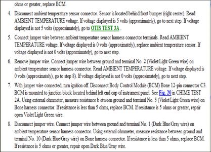

The gent who spent $600 should talk with the manufacturer's rep at the regional office before talking to the dealer. I'll bet that he'd get a much better reception at the dealer the next time around if he did.
I'm going to stop by the Chrysler dealer tomorrow and talk with the service manager. Up until now, I've always taken the car to the local Dodge dealer because my wife owns a Dodge Caravan and it's been very convenient to let them work on both. But thinking about the scan tool issue, I'm thinking that the Dodge guys may not have exactly what they need for the Concorde. I'm going to ask the Chrysler guy some very pointed questions and see what he/she says.
S204..... I admit I haven't unwrapped the bundle where the splice is and put my eyeballs on it.... However, I've measured continuity through it and I've checked for the correct voltage through it. In fact, I've checked the entire circuit from the fuse all the way to the connector where it enters the BCM, pushing the trunk release button and watching the voltage come and go. I honestly don't think it's the splice, my friend....
Manuals..... I've written a feedback note to the office here in CA. As it turns out, they're not that far from me. If I don't see a response in the am, I'll call them and talk to them about the Mitchell1 manual situation. You say you're using a Mitchell1 and I can see the color coded wiring diagrams. A friend I talked to tonight said that he also has color coded wiring diagrams in his Mitchell manual. I'm really wondering whether or not the one they allow you to subscribe to is the same that they allow me to subscribe to. Is the DIY manual different from that used by the professional mechanics...???
For $22 bucks, I think I'll order the diagnositic manual just to see if there's any possible help available in it for either the ATC issue or the trunk release issue.

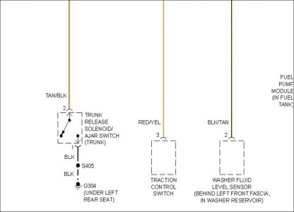

Trans in Park signal...... I looked at the transmission electrical schematics and see a switch system that indicates the condition of the shift lever. I was looking at the larger sized diagram last night and it was off the monitor. I'll print one at work tomorrow and see if there's any indication of how the BCM gets the signal.

On that switch……….if you can……….paste a copy so I can see where it is and compare….I didn’t see anything on the 3 sheets I looked at……….could have missed it but would like to see if you can.

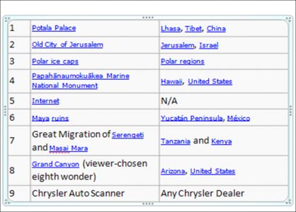

Chrysler dealer field trip.....
I talked to the Service Manager at the Chrysler dealership this am. Because I don't have the "relationship" with them that I do at the Dodge dealership, he indicated it would be an $85 charge to do the scan tool analysis. Fair enough.... He indicated that he has two gents that he believes are really good with the electronic troubleshooting issues. One bothersome point is that he said they go strictly by the flow chart that runs the tech through the procedures, based on whatever codes are found. If I decide to go that route, I'd give them an extra 20 bucks on top of the 13 pages of waivers just to let me watch to see if there's really anything magic about this super-secret scan tool.
I tried to upload a good close-up of the switch schematic but the 2CarPros web site doesn't allow direct uploading. All images have to come from a publicly-accessible server. So, next best thing I can do is point you in the direction of where I found it. From the REPAIR area, go into the WIRING DIAGRAMS -ALL / WIRING DIAGRAMS option, then SYSTEM WIRING DIAGRAMS, then scroll down to TRANSMISSION CIRCUIT (2 of 3). You'll find it at the bottom of the page. By taping all three diagrams together, I can see that the signals go to the Transmission Control Module where the info is then sent via the PCI bus to the BCM. That's how the trunk release circuit knows whether the transmission is in Park or not.
Well...... that throws a wrench into the spokes............ I was really hoping it would be a simple power available/not available option via a wire that I could find and repair. NOOOO......!!!! It's gotta be the stinking PCI bus..... which talks to the BCM.......................... why do I keep coming back to the same conclusion....????
Unless I can hijack myself a scan tool, it's looking more and more like a trip to the dealer will be the only way out of this mess.

BCM has been replaced..........
AND THE TRUNK OPENS......!!!! :-)
AND THE ATC IS STABLE....!!!!:-)
AND THE LIGHTS HAVE NOT FLICKERED....!!!!! :-)
AND I NOW ONLY HAVE 43000 MILES...!!!! :-)
Well.... at least that's what the odometer says.....
I wasn't real sure they'd be able to fix it when I dropped it off this am. My regular service writer was off and I didn't think to ask to talk with the Service Manager. (REALLY SHOULD HAVE DONE THAT...!!)
In any case, they used one of the used BCMs I brought along and did everything and checked all of the issues. After replacing the BCM, the trunk immediately opened from inside using the button. That validated my belief that the BCM was to some degree involved in these issues.
Then, the tech checked the ATC and was only able to get the A/C system to mess up by wiggling the connector to the Blower Speed Control Module. At the same time, the courtesy lights came on too.... He thinks that the speed control module and/or the blower motor might be going bad. He says that a lot of the time, when the blower starts acting up, it's a combination of the two parts. We'll have to wait and see....
He wasn't able to get the ATC to go into self-test and thinks it is the ATC head. If everything else is working, I won't worry about the self test issue.
After he stopped trying to break my blower speed control, he wasn't able to get the lights to go on intermittently any more....
When I picked up the car, the temp was set at 75 degrees. After a short drive and the system working well, I decreased it down to 74 and it stayed there all the way home. No blower speed excursions; no temp variations; no dumping out of auto into manual.
The real proof will be if we keep everything working the way it's supposed to and we don't slip back into our old ways....
With the success with this project, I'll get to try to help my daughter with a similar problem with her `04 Suburban. What the hey, huh...??? Why not put all this good knowledge to work.....???
