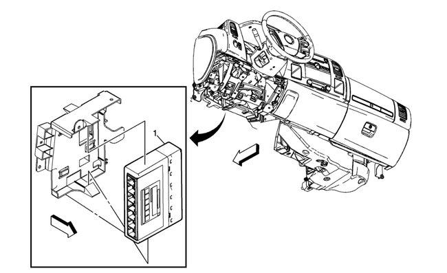

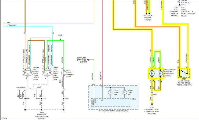

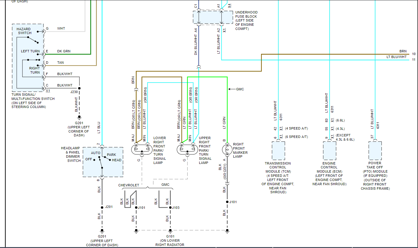

changed bulbs, checked fuses, no power at light, is there a module in circuit? regular lights work
Dec 21, 2009 at 12:30 PM

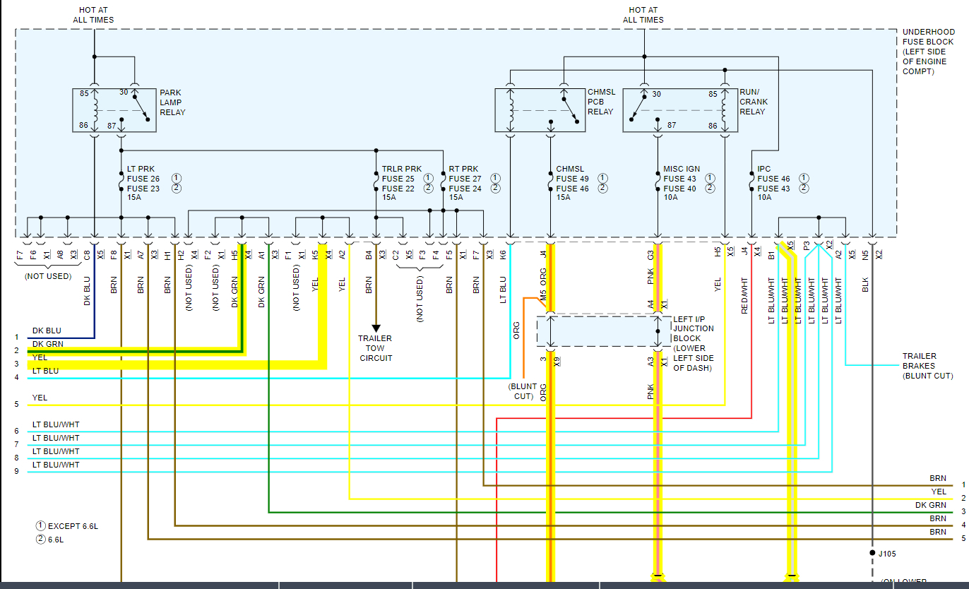

Good evening,

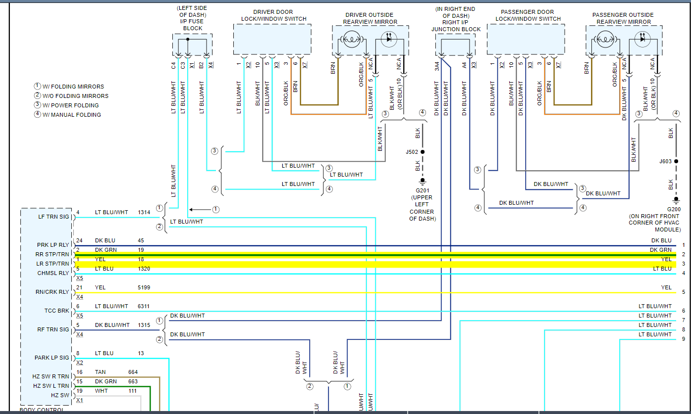

I attached a wiring diagram below for you to view.

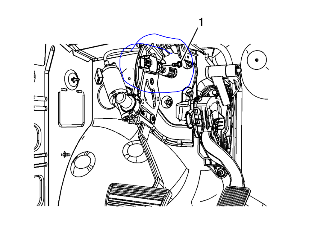

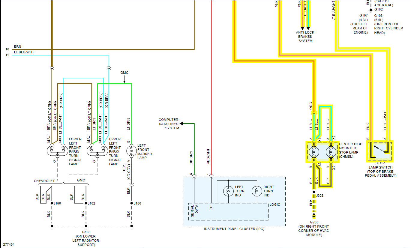

There is a fuse for the brake light switch. Check for power there and at the switch. They are in the diagrams I attached. Make sure there is power on both sides.

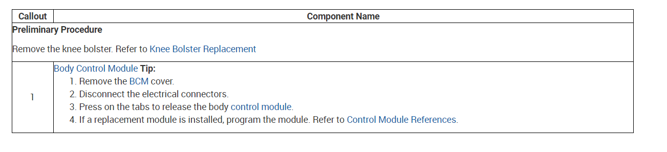

The power goes to the stop light switch and then off to the body control module. The switch sends a signal to the body control module and the module sends voltage to the brake lights, all of them.
You need to start with checking the fuses and check for power at the stop light switch both in and out.

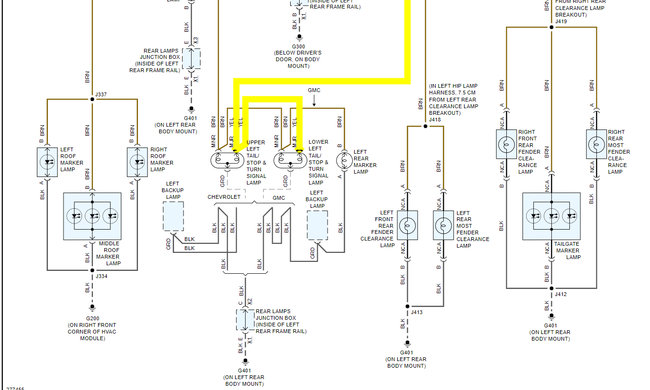

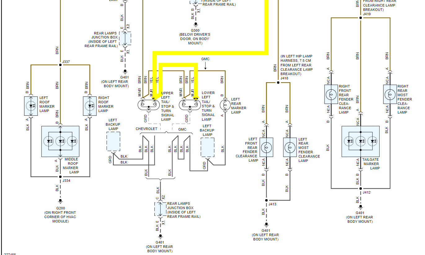

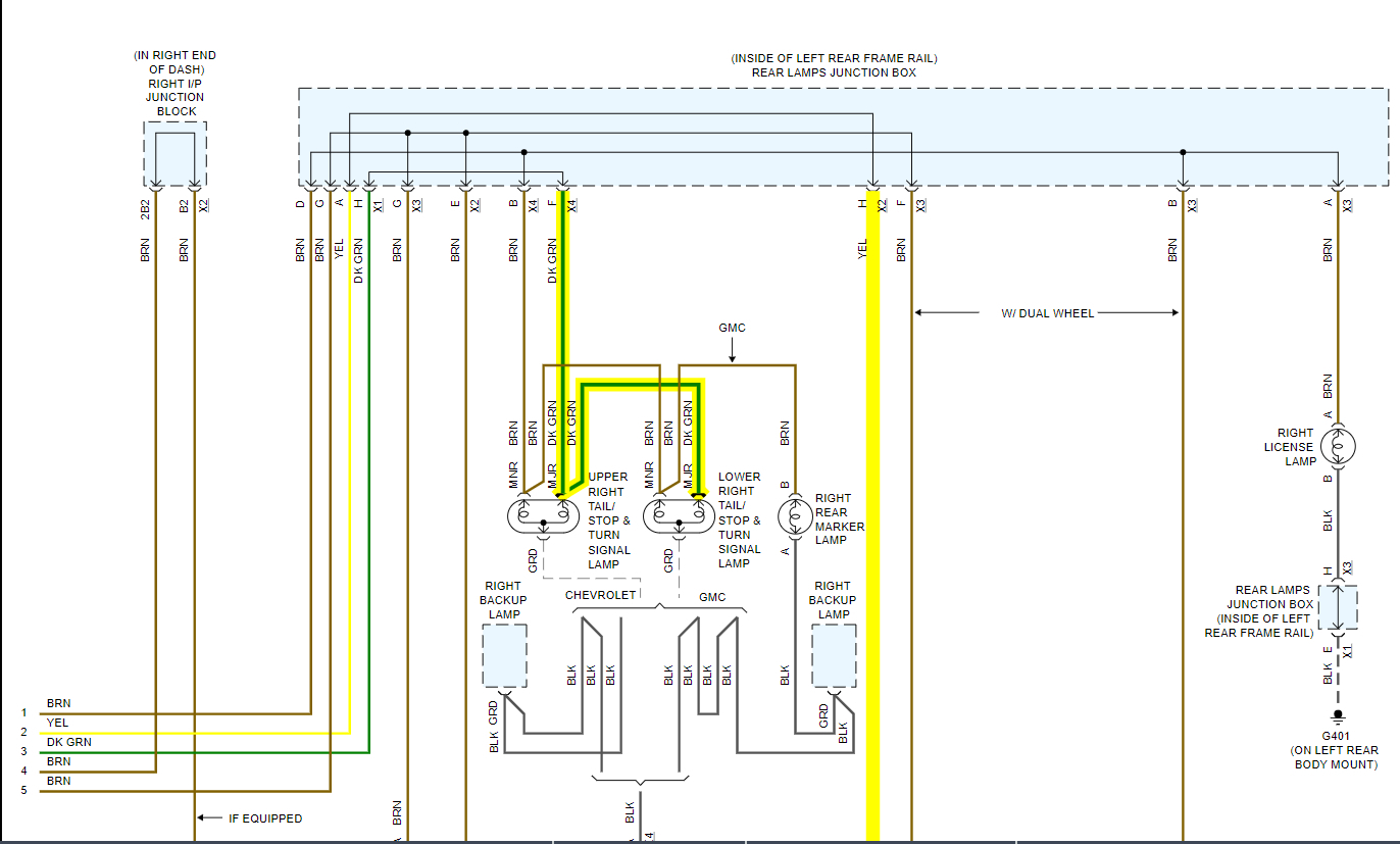

  • 110,244 POSTS
The first thing I suspect is a bad ground. Both tail lights have a common ground. However, the third brake light has a different one.
What I suggest is this. First, remove the light assembly and locate the wiring to the brake light bulb. Have a helper press the brakes while you check for power to the yellow wire on the left light assembly and dark green one on the right side assembly. Make sure you have a good ground for the test light. If it turns on when the brake is applied, then you have a bad ground.
I attached a picture for you to see the brake lights and their ground. It indicates where the ground is located and the color of the wires.
Here are a few links you may find helpful when performing the test:
Let me know if this helps or if you have other questions. And, I hate to ask this, but are you certain the bulbs are good and the correct ones?

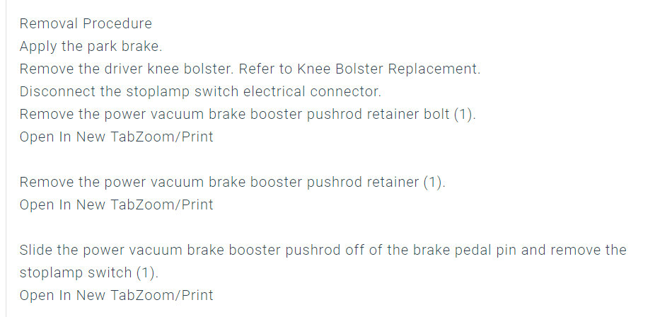

KNOWYOURAUTO
  • 113 POSTS
The relay you replaced, is it the brake switch at the brake pedal or another one under the hood somewhere?
It sounds like you are describing a failed brake pedal switch. Also, the third brake light is on a separate circuit than your rear brake lamps so will not be a symptom.

KNOWYOURAUTO
  • 113 POSTS
That's great news! You have a simple fix of replacing your brake pedal switch located on the lever part of your pedal. It is easy to install, practically just pops out and in, and can be found at any parts store.
Make sure it is adjusted properly once you put it in. with the brake pedal at rest (not depressed) move the switch towards the pedal until the plunger is fully depressed.

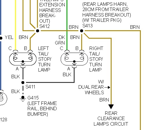

JDL
  • 16,098 POSTS
Hi, your lower brake lites and turn signals, use the same bulb filament at the rear, just not at the same time. They are wired through the multifunction/turn switch. You can go ahead and check voltage and ground at the rear. Ground wire is black, it may be a dual filament bulb, the other filament is tail lamp, brown wire, the other color wire has to be turn/brake. The high mount brake lite, where applicable, is wired differently.

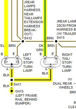

JDL
  • 16,098 POSTS
Use a voltage tester on the proper wire in the diagram. At the rear, brown wire is voltage for tail lamps, The other color wires are voltage for brake/turn. The info I looked at was for c1500.
Check the black wire in the diagram for proper ground.

MASTERTECHTIM
  • 4,750 POSTS
put a test light to the white wire and it should light when you apply the brakes. also the orange wire should be hot at all times. if light on orange wire but no light on white, replace brake light switch, if light on both suspect turn signal switch, hope this helps
