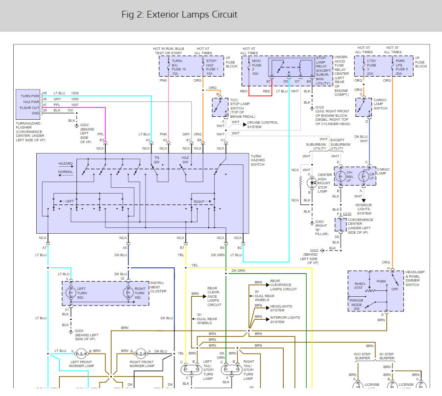

That's probably a bad turn signal switch. The 2 lower brake lights pass though it so it can cancel brake lights for turn signals

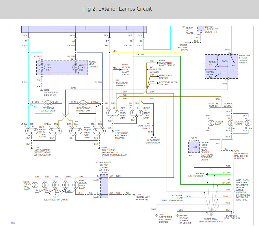

From the brake light switch the wiring goes to the hazzard then turn signal switch. Here is a wiring diagrams so you can see how the system works and a guide to help you test the connections:
