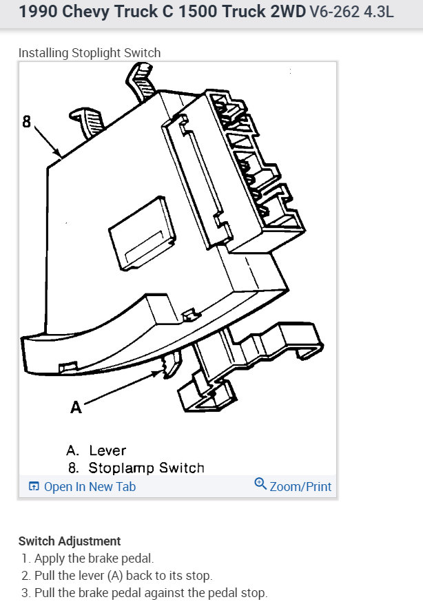

I changed the neutral safety switch but the brake lights stay on. All other lights-turn signals-running lights.The only way 2 get them to shut off is unplug the connection at/under the rear bumper

The brake light switch sounds like it needs adjustment or replacement here is a diagram to show you how. Check out the diagrams (Below). Please let us know if you need anything else to get the problem fixed.
