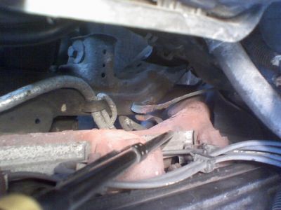

I took the altenator out and had it bench tested, it failed! I bought another, installed it and still no start. I fully charged the battery and still no start. However I noticed one of those ground straps at the bottom of the engine that goes to the frame is corroded about half way through. Can I use a jumper cable and by pass that to see if it works?

Sorry I havent got back to you, I've been busy. You could use a jumper wire to bypass it, just clean the area you use to make a good ground, I'm trying to find out where that ground goes.

I replaced both straps, still nothing.
One strap went from engine to chassis, the second went from the chassis to the body.
