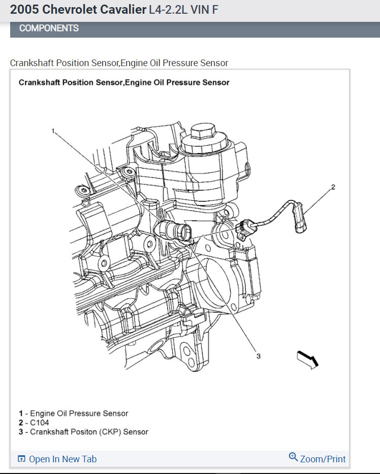

My car is stalling while driving. Usually when I slow down before a stop. I have changed the spark plugs and air filter and I have been using fuel injector cleaner but nothing has helped
Tuesday, April 6th, 2010 AT 7:23 AM
52 Replies
LEGITIMATE007
  • 5,121 POSTS
I have seen the crankshaft angle sensor cause this issue here is the location so you can change it out for a new one this guide can help as well.
https://www.2carpros.com/articles/engine-stalls
Check out the diagrams (Below). Please let us know what you find.
Tuesday, April 6th, 2010 AT 3:37 PM
JJW03076
Thank you that fixed it the site is the best!

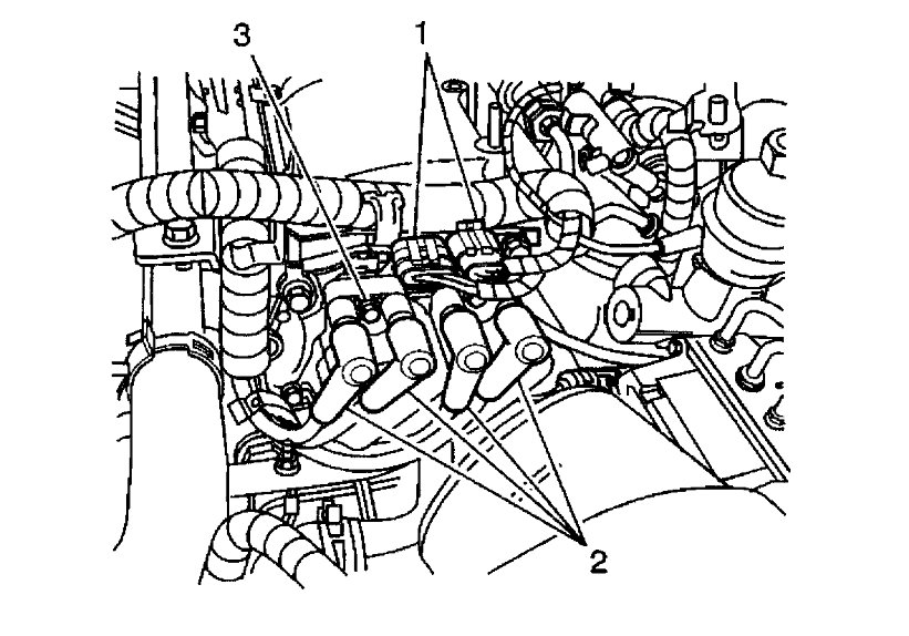

My car has been stalling when I driving around. When I turn the key off and back on it starts right back up and runs. It also cuts in and out around 2,000 rpm's. I have replaced the crankshaft position sensor. There are no codes. I need help please and thanks.
Saturday, October 10th, 2020 AT 10:45 AM (Merged)
  • 52,797 POSTS
Good morning,
A common issue with this failure is the ignition module.
Before assuming it is the issue, I would remove it and take it to a parts store and have them test it. it is a free service. make sure you have them test it at least three times as it may have to get hot to fail.
it does not sound like a fuel pump as it starts right back up. if it was a fuel pump it would crank for about ten seconds before starting.
Procedure
1. Remove the air cleaner outlet from the air cleaner.
2. Remove the ICM electrical connectors (1) and spark plug wires (2).
3. Remove the ignition coils bolts (3).
4. Remove the ignition coils and ICM assembly.

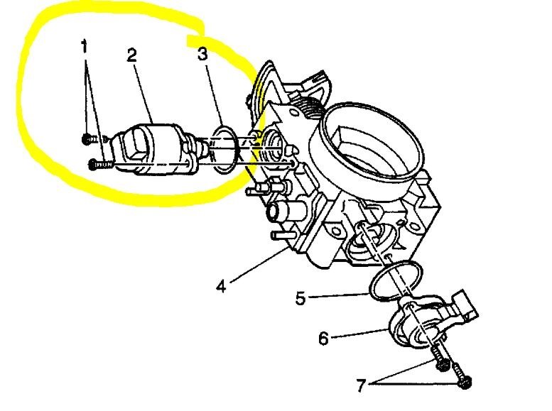

My car keeps shutting off even after I replaced the alternator and the battery. Before my car shuts off it revs really low and high while the trac off light comes on. Also my temperature gauge keeps going up and down. I don't know if all of that is tied together or not?
  • 52,797 POSTS
Good morning,
Do you mean the battery dies and has to be jumped started or charged for it to start?
Please give me as much information as possible.
CAV385
When turning it on I give it a little gas and it will start. I typically do not have to jump start it or charge it.
  • 52,797 POSTS
Okay, thanks.
There is an idle control motor. That is the usual cause for having to give it throttle to start.
Does it have any codes?
1. Remove the idle air control (IAC) valve electrical connector.
2. Remove the IAC valve attaching screws (1).
NOTE: If the IAC valve has been in service: DO NOT push or pull on the IAC valve pintle. The force required to move the pintle may damage the threads on the worm drive. Also, DO NOT soak the IAC valve in any liquid cleaner or solvent, as damage may result.
3. Remove the IAC valve O-ring (3).
Clean the IAC valve O-ring sealing surface, the pintle valve seat, and the air passage.
The IAC valve may be cleaned. Use a shop towel or a parts cleaning brush to remove heavy deposits.
Shiny spots on the pintle or seat are normal, and do not indicate misalignment or a bent pintle shaft.
Whenever air passages have heavy deposits, remove the throttle body for complete cleaning.
Inspect the IAC valve O-ring for cuts, cracks, or distortion. Replace the valve if it is damaged.
Whenever installing a new IAC valve, be sure to replace it with an identical part. The IAC valve pintle shape and diameter are designed for the specific application.
