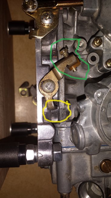

Intermittent carburetor backfiring on both sides
CITYGUYUSA
  • 86 POSTS
4th time I've tried to post this.
There's something wrong with this system. This is the 3rd time I've had to rewrite this.
Behind the choke lies a lever. The green side has a screw that adjusts against the jagged end of the plastic fast idle cam. However, does the red side need to connect up to something?
Thursday, May 27th, 2021 AT 5:55 PM
STEVE W.
  • 13,573 POSTS
There should be a spring behind that piece that goes on the tab you have circled in yellow. The screw is used to adjust the fast idle while the spring pushes on the screw and lever in the opposite direction.
