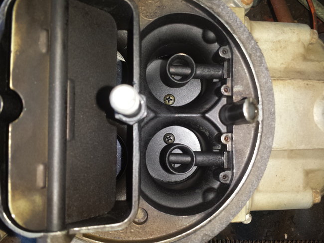

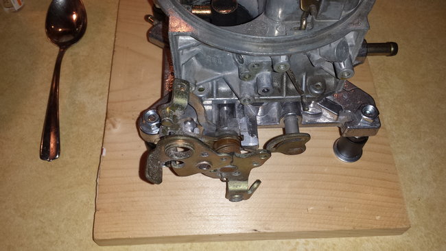

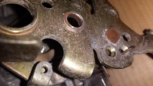

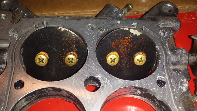

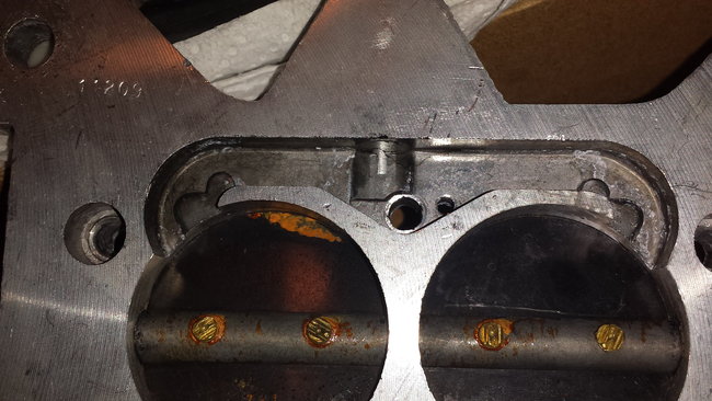

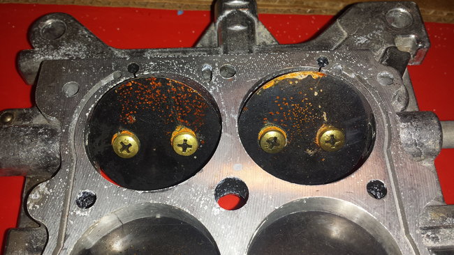

All my text is gone yet again 3 times now. The catb is mostly clean at this point. It appears to be 2 different carbs melded together. The ID tells me that it should have a single bowl fuel connection but it has 2.
The secondary diaphragm needs replaced.
There's damage to the primary and secondary plates I'm guessing need cleaned of rust and repainted?

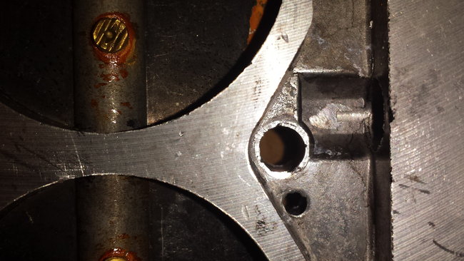

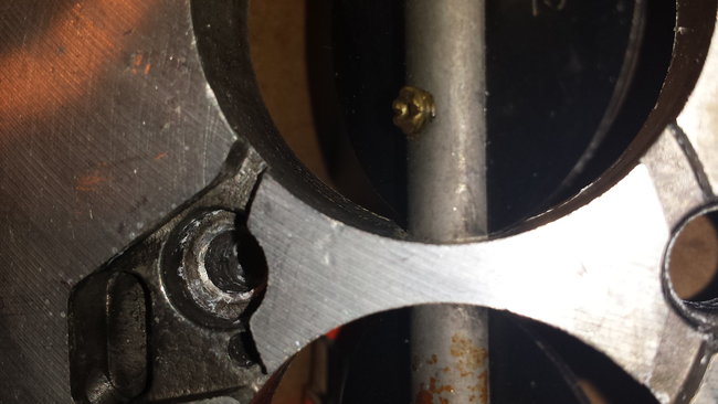

The 2 holes leading to the front and rear vacuum ports seem to be routed out a bit as do the 2 tiny holes right next to the bigger holes. I don't know what this might cause.
Then in the primary channel there are some strangely shaped metal pieces I suppose are blocking or partially blocking the flow? The one looks like it might have been minimally reduced at least in 1 place.
Take a look and let me know your thoughts.

Throttle plates are normally uncoated aluminum or brass. Now and then they are thin steel but not as common as the others. The screws are staked in place so I would simply clean the plates off and leave them. The holes you are talking about look to be the ported vacuum and bowl air feeds. I would put it together, adjust it to the correct specs for that engine size and then see how it acts. Then tune from there. Worst case you could stick a new carb on it. Or one of the Holley injection kits.

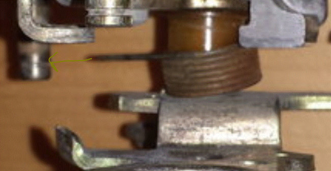

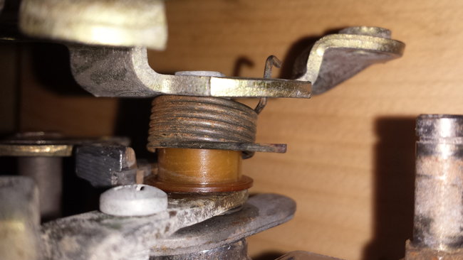

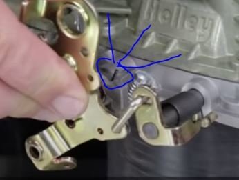

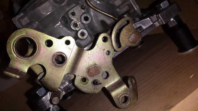

Okay, a small problem. I started putting the carburetor back together but I don't know where the other side of this spring on the primary goes or if it may have broken off? These parts don't have a name I guess because you can't remove all these levers as they are pressed on. Why? Because they make money replacing or repairing for a cheap spring.
May 2, 2021 at 10:32 AM
  • 110,241 POSTS

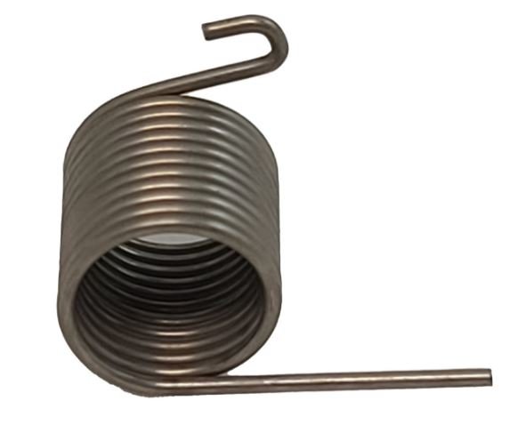

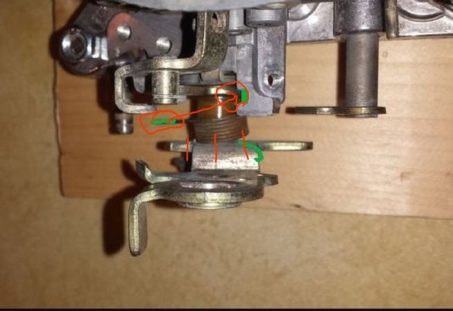

That is a throttle shaft return spring and it appears to be broken. The straight part simply rested against a stationary position. In the picture, it looks like it may be short. It's hard to tell.
You should be able to get one from a different carb. I attached a pic of yours below and pointed to where I believe it should mount. If you give me a side view of the carburetor, it may help.
To replace that spring, you need to remove the throttle plates and then the throttle shaft.

That means grinding off the screws that hold the plates. I can't open your picture. The spring looks wrong to me but I don't recall where it was. There's a lever towards what is technically the rear side that has a groove in it but that spring won't reach that far and it seems to simplistic to just rest a spring there. Just seems a an odd location with nothing to ensure the spring would remain there. . I've looked a many carbs online but the spring just seems to disappear in those pictures. Mine has a spring running from the distributor to the throttle which would seem redundant.

This is a Holley carburetor not a QJet in this case. That spring is the secondary shaft return spring. It slips over the orange bushing and should rotate to hit the stop above it where the green spot is next to the notch. Then you hold the plates closed and the hooked piece goes around the opposite side where the curved green is. It is a spring designed to hold the secondary's closed until the linkage opens them.

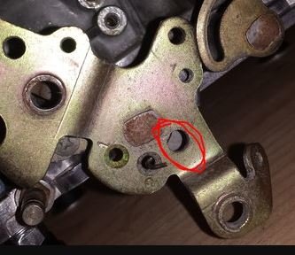

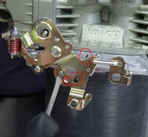

Definitely a Holley. These are vacuum secondary's. Does that make a difference? Which hole are you saying it goes into on that piece that has 8 holes on the side that is pressed in? I've added a side image so you can point or color the hole that spring goes in. I thought that hole was the one it was in. I guess I could pull the end around counterclockwise an entire time so it would be pressing against the trough..

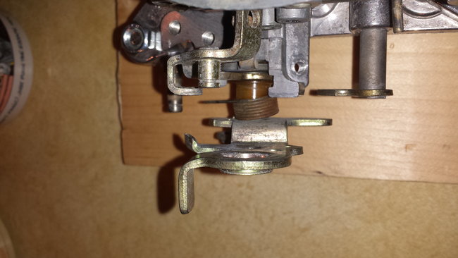

That's a lot of shafts and springs but since you told me not to grind off the plate screws it's going to be real hard to do much with the spring other than to set it.

Setting it is all you need to do with the spring, it looks okay. The hooked end goes into the hole next to the chamfered holes circled in red in the last image. The straight tang just sets in that notch I circled in red. in the first pic, You need to wind it one turn then it snaps in the notch. If you go to the Holley site you should be able to enter the carbs model number and get the adjustment and tuning guide they have. It has the various setting in it and tells you if you need to adjust the spring or change the dashpot depending on what the engine needs.
