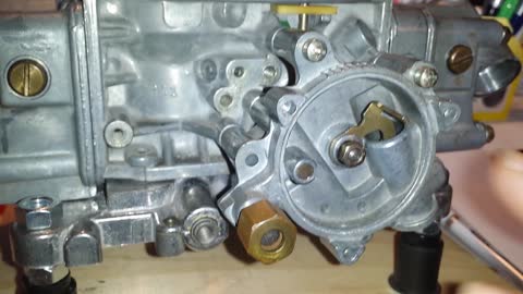

I got the electric choke on but I'm not sure if there's a linkage issue or something. I can't seem to move it at all unless I first open the throttle.

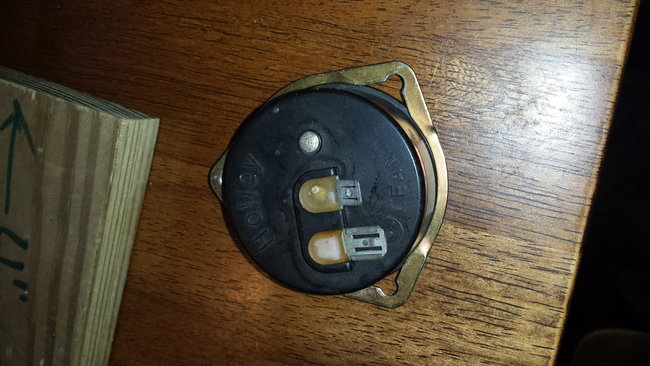

The red cam also shows a silver ball in the end (perhaps used for weight?) Mine has a hole but no metal ball. The metal triangle that holds the spring on is broke I think it's copper so I guess I could solder it.

The choke is correct in needing the throttle to release it. That is why you need to step on the gas at least once in a carbureted vehicle, that "sets the choke" by releasing it so it can close on a cold start. Then once it warms up the electric, manifold or exhaust heated pull off system holds it open. Some carburetors also have a vacuum choke pull off that will modulate the choke using vacuum passing through a temperature valve on the thermostat housing. You also will adjust that once you have it installed. The linkage bar can be bent to close it tighter but it shouldn't be needed, you don't really want the choke to seal the inlet off because it does need some air to go past it to atomize the fuel and in the event the choke were to stick you could still move the car around. Once you get it installed you will adjust the cover to keep the choke on for the correct amount of time based on the way the engine warms up and the climate you have. Colder area likes the choke to stay on longer as a general rule.

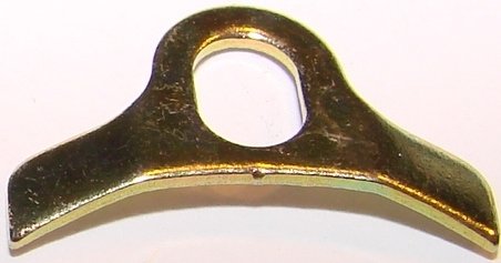

The broken part sounds like the choke cap retainer, looks like the picture? If yes you can get them as replacement parts. They simply push the cover in solid to keep crud out of the housing.

It's not copper. It that metal they use to frame out consumer electronics it may not solder. It is the retainer for the choke spring housing.

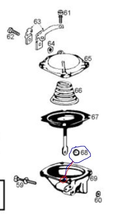

I'm trying to do the vacuum secondary. First which hole does the ball go into? The top or the bottom top or side? Should I put Vaseline on the edges of the diaphragm to help seal it?

That retainer is the fancy version of the one I posted Holley used both as well as a wire version. It's actually just cad plated steel but I would say replace it, they are cheap.
That spring isn't really a spring, it's a bi-metal strip that heats up and pulls the choke open as it heats. The terminals on the outside go to a good ground and a switched power.

The check ball goes in the lower section of the secondary diaphragm housing, then the diaphragm and spring then the cover.

I presume you're telling me to drop the ball in the top of the bottom, not into the side of the bottom?

The ball goes inside the housing in the vacuum port that attaches to the carb body. There will be a gasket, then the passage goes into the secondary housing and makes a right turn and comes up through the diaphragm and into the top cover. The ball goes in the upturned section right under the diaphragm. The check ball passage will have a round hole with a notch in one side. The idea of the ball is that it slows the rate that the secondary's can open. It's one of the trial and error parts in that carb. Some engines need it and some don't. If the engine needs it you will know because the engine will bog as the fuel flow won't keep up with the increase in air through them and you get a big flat spot and lean mix. The ones that don't need it will run just fine. Most of the OE Holley carbs that came on GM engines don't have it.

This connection between the throttle and the secondary plates doesn't do anything at all. I wouldn't think this is just for looks.

It will when the carburetor is actually working and creating vacuum and the choke is on.
