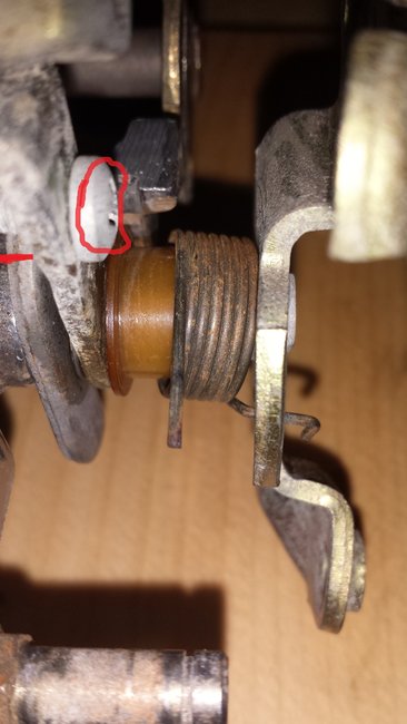

The pump cam goes between the plastic bushing the spring goes over and the screw simply goes through the plate and screws into it. The spring doesn't ride on it, it goes over the bushing. The screw for the pump cam is part 171. The cam is part 172 and goes behind the yellow linkage lever. The cam then moves the pump link 168 which goes over the stud sticking out of the baseplate. That link is what moves the pump. The screw is shown in the second image. The pump cam is behind the throttle linkage.

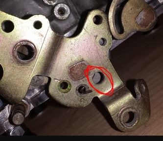

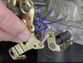

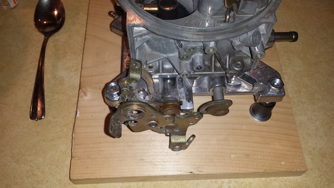

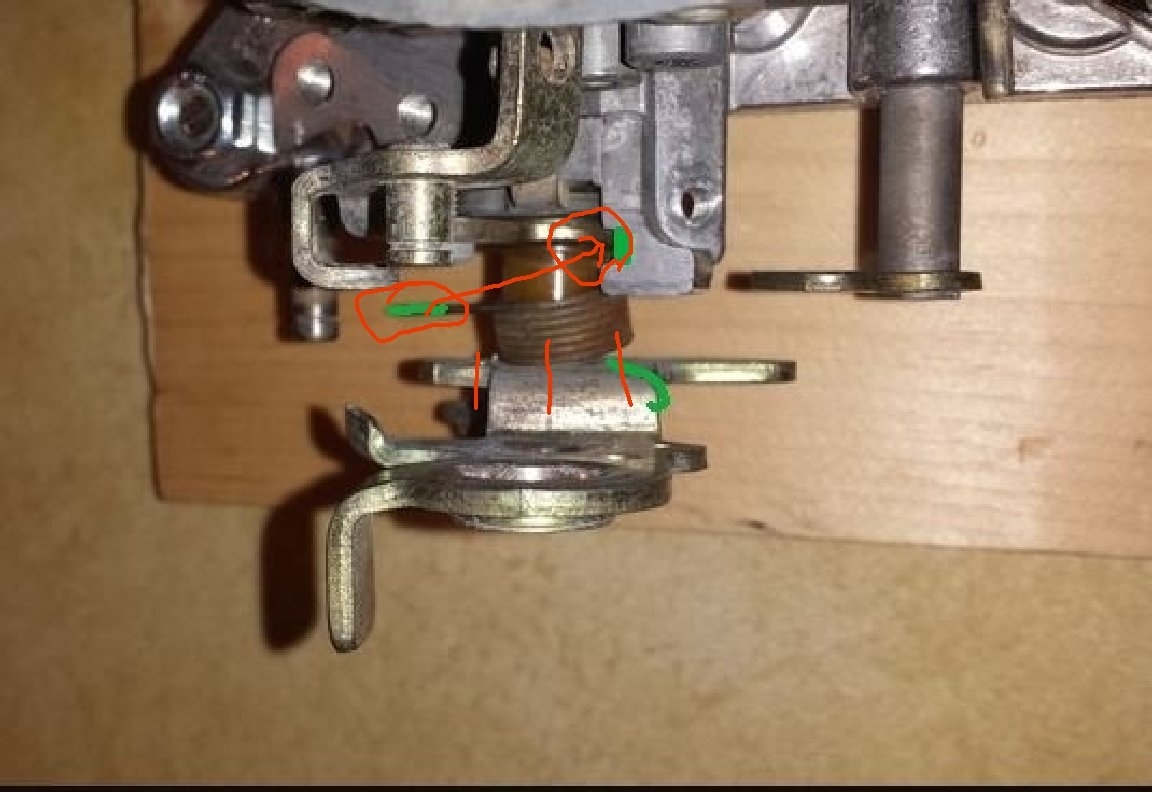

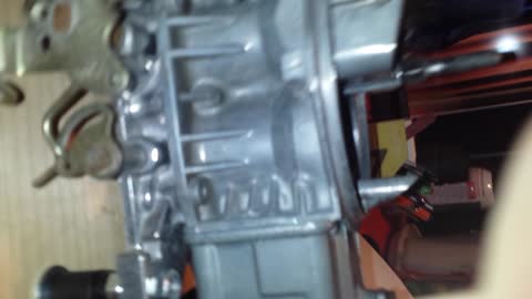

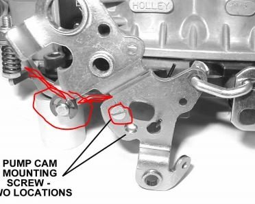

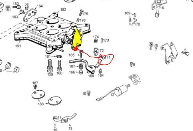

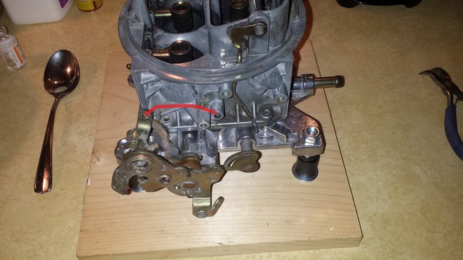

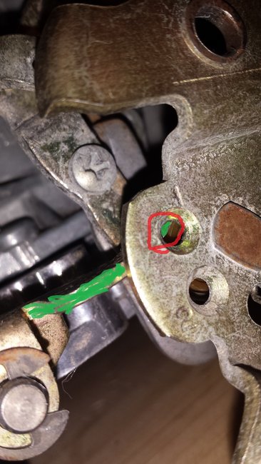

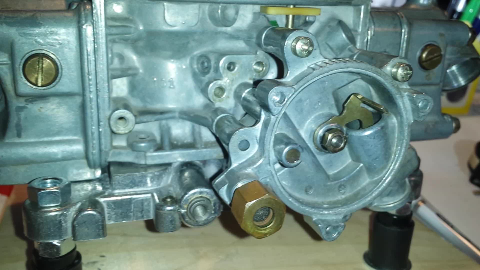

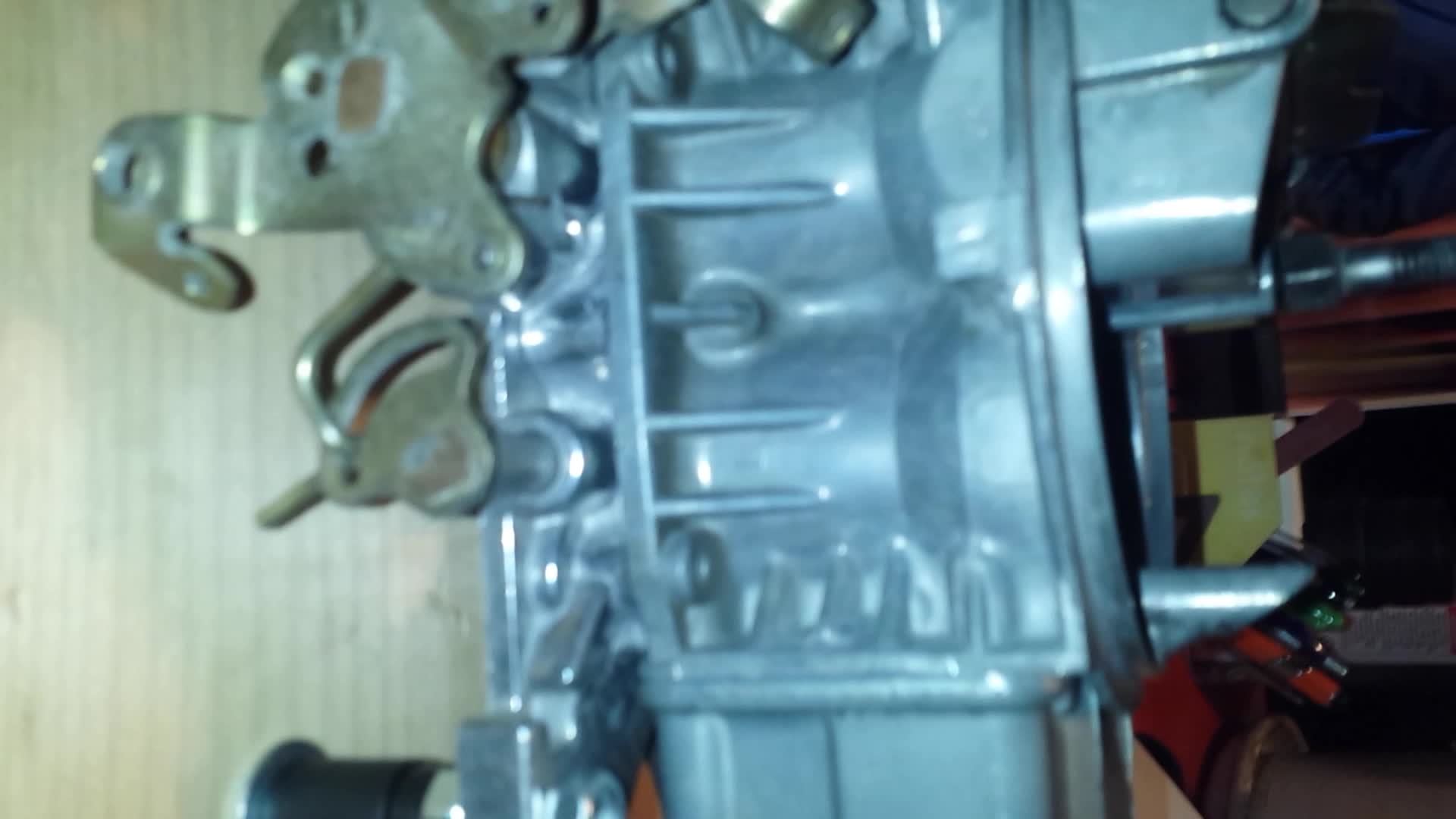

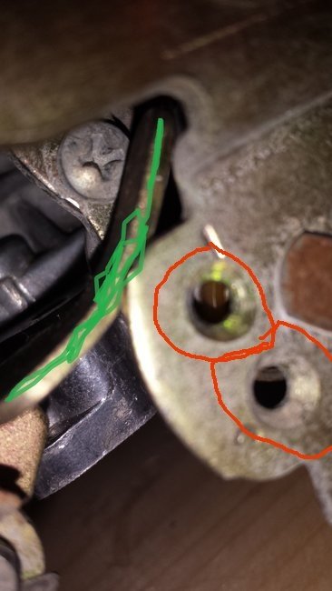

It's hard to follow what you're saying so let me rephrase. My 1st pic shows the lever that rides on top of the throttle cam spring. You can see it laying on top. The 2nd picture shows me moving the throttle to all but full open to show how that lever moves and you can see the lever is right above the throttle plate above the 1st screw position. The 3rd picture shows you the extent that the lever can go to at full throttle. It barely reaches screw position 1 and can't even get to screw position 2.

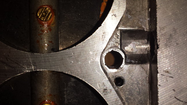

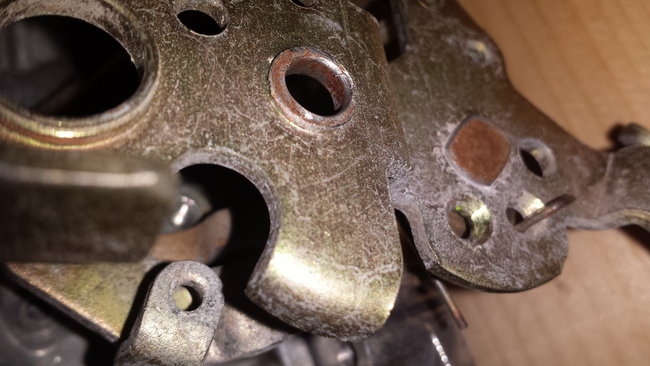

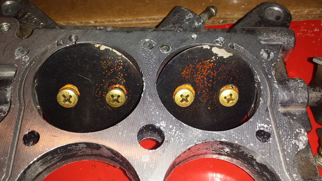

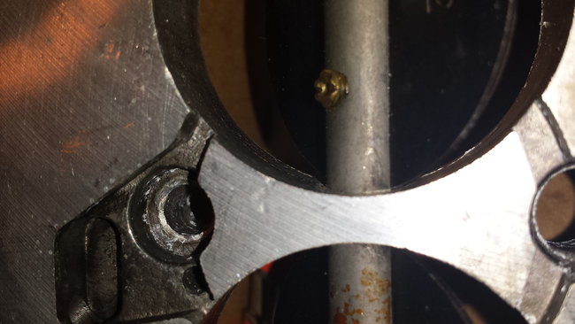

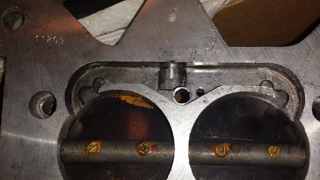

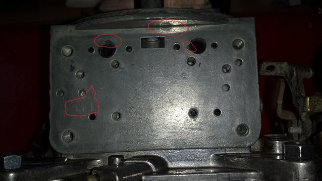

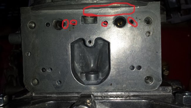

The last 2 pictures are the where the metering plates sit against the throttle body. They will have cardboard gaskets applied to them. There are quite a few imperfections here I'm not sure how important that is or isn't but before I cover them over...

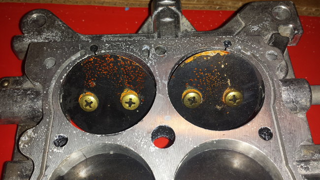

I have some sticky parts like the primary plates on the bottom get caught on the rusty edge when you're at idle. Should I use silicone spray to help lubricate them or something else?
The paperboard gaskets for the fuel bowls and other places should I use something other than tightening to hold them? Whoever built this thing had adhered the gaskets in place. They seemed like they were using an adhesive it didn't seem like RTV because it had soaked into the layers of the paperboard. Then all those tiny little circles that go around all the screw connections those will need something to hold them.
So that screw that you IDd on the drawing, 171, I would never in a million years figure that to go into the throttle plate besides that it's no where near it and in fact appears to go with the plastic cam, 172, and it's 3 holes although it's really just hanging out there in no where land.

That lever is the accelerator pump arm. It should ride on the pump cam which you don't have installed. It doesn't ride on the spring. The cam goes between the spring, it's bushing and the throttle arm. The two screw holes circled in the face of the throttle lever are where the cam is attached. It looks like the parts in the second picture and is adjustable to tailor how much fuel is added when you step on the throttle. Without it the pump arm doesn't move and you get a massive flat spot and stalling when you hit the gas.
These show it better.
https://www.youtube.com/watch?v=k-Nx5HEzvlY
https://www.youtube.com/watch?v=ep_dTRTSGPI
With it in place the pump lever should start moving the second the throttle moves off idle. Then you adjust it to inject whatever amount of fuel needed to make up for the air increase as the throttle opens. The idea is to match the extra fuel injected to the amount of time it takes for the fuel to transfer through the jets inside the carb when you hit the throttle. If you don't have it right you get a stumble, which can be from both excess fuel or not enough.
For the gaskets they are installed dry. The OE gaskets sometimes had a layer of high tack sprayed on them to hold them in place for assembly but it isn't needed. Keep any type of RTV gasket maker away from the carb. Especially inside it. RTV isn't fuel friendly and tiny bits get free and plug jets and fuel passages. Those marks won't cause any issues.

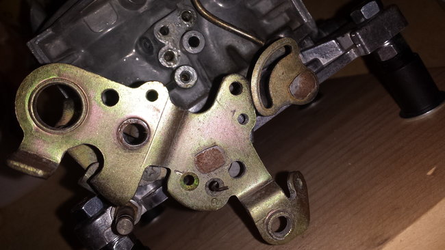

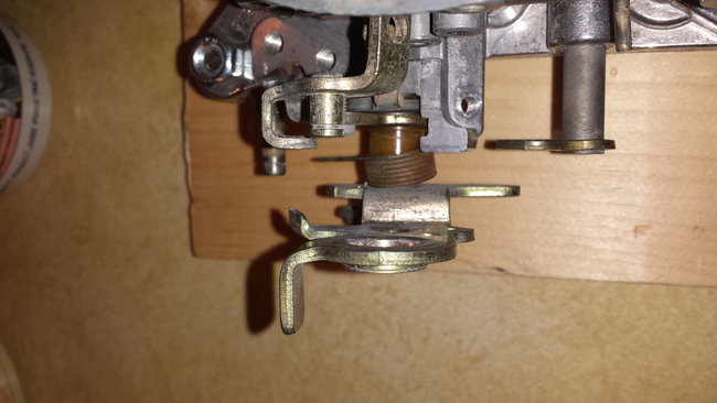

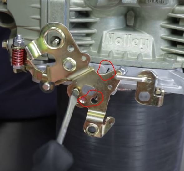

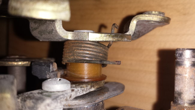

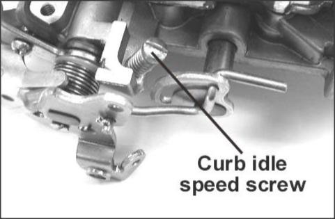

We are talking different things kindof. These both came from the videos you told me to look at. If you look at the first one the lever is riding on cam which is screwed into the back of the throttle plate which is on the inside edge of the throttle return spring. If you look at the 2nd one their throttle plate is turning further than mine. You can see the cam retaining screw is at the top when they rotate their throttle with the accelerator lever riding on the cam which I was saying the spring because I hadn't put the actual cam back on yet. The last picture is mine. When I rotate my throttle, the path of that secondary lever of the throttle hits the throttle body. Follow the red line. That inner throttle piece rides on the throttle cam on the other side of the spring from the plastic cam. There's a screw that kind locks it in place from passing yet another piece of that throttle assembly that rides against the throttle body. The 4th pic is just so you can see the lever that I'm talking about and how it's shaped. Then the last shows the screw at the bottom that just sticks through the backside of the lever and prevents it from moving past the level that is against the throttle body which is hard to see. But the red mark that's horizontal is just suggesting how the screw sticks through the back of that lever. I know it's not accurate.
I don't know where that cam was initially I seem to recall it hanging by a rod. I don't remember unscrewing it and the screw was partially sticking out of the cam which I would have screwed in or left out. Just weird.

In your last picture the cam is not installed, neither is the accelerator pump lever. Until you assemble the entire carb nothing is going to fit correctly. Then the linkage needs to be set once it's together. I don't see the secondary trip on yours either, that is the heavy link between the primary and secondary shafts that is adjusted to open them at full throttle.

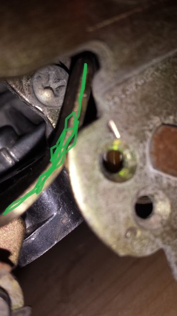

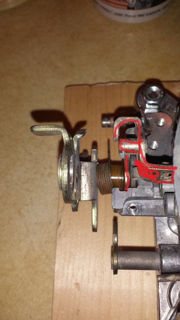

I didn't take new pictures. All I want to know is how that Kickdown is supposed to work. I don't have an automatic. And no matter what I add or take away is going to solve the problem of the Kickdown hitting the side of the throttle body. It doesn't move from side to side only front to back.

It looks like it's in the wrong place. The kick down mounts farther over on the carb body but only for a Ford. The GM kickdown mounts to the throttle lever itself but it's only used with an automatic. You shouldn't need it for your manual car. Just the accelerator pump. When you first got this car did it run okay with no issues?

It ran fine until the environmental upgrade and then it came back a total mess.
I understand that I don't need it but it's hitting the throttle body as per the picture which is preventing the throttle from being able to go past that point which prevents the throttle plate from being able to open 100%.

It should be removable. However it sounds like whatever they did as an upgrade wasn't. What exactly did they do?

I've figured it out. The baseplate was rotated. Everything else has tabs and pins to ensure you put it in correctly but the baseplate can go on either direction although there may be pins missing because the gasket is supposed to hook onto 2 pins but there's no 2 pins to hook onto and I noted on the main metering plate there is a cracked off pin.

The upgrade that they did. It went in running okay came out running bad. It's possible it is something that can be compensated for in tuning.
It sounds like someone has mistreated that carb in the past. It should have locator pins on it. They don't label much of it because of the modular design, you need to match up the parts to the particular carb you have. You can build the carbs up or down to match the engine it's on.

Setting the floats is normally done with the carb assembled and on the engine, That compensates for any tilt or angles caused by the engine mounting. I would keep it as close to what it ran good at before. The plastic will deform as needed to seal. Just don't crank down on the screws, you want the seals to seal and that's about it, I've seen people assemble them and have the gaskets squeezed out like they were liquid sealer. One thing to check on the float bowls, be sure the face of the throttle body and the float bowls is flat. I generally do that using a piece of glass or polished granite like a surface plate. The easy trick is to use a marker and coat the edge where the seal rides, now lay that surface on the glass and see if it rubs all the way around. It's rare that one isn't but it could happen.

I showed you the pics of the surface.. I didn't check for flat I was more concerned with the divest around the port holes and the odd edges but just off the top of my head they didn't look especially flat but I'll run a steel edge over it.
Since the needle valves are replaced hard to say where they were before there wasn't any way to mark them. Like I said they're center hung floats 2 screws and 2 screw holes nothing to adjust except the height of the needle valve.

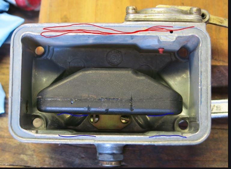

I came across a set of directions to set the valve and the float except you have to do the them in reverse order well because why would they even have them in order?
For the valve, the "bottom of the valve",
whatever that means (Does it include the pin? Who knows? Their instructions leave a lot to be desired!) is supposed to line up with the bottom of the site plug. Why not just mark a line in the bowl? If I assume they're talking about the actual body and not the moving pin you can't get the float into place with the valve in place.
When you put the float in you're supposed to hold the fuel bowl upside down and center the float by bending it. Needless to say I can't get my fingers or anything else behind that float to even attempt bending it so it won't rise above the level of the screws. This is absolutely asinine thinking whoever came up with these ideas. Why not just manufacture it so it sits where they want it that would make way more sense. Whoever built it initially didn't see a need to bend the floats and yet I'm suppose to figure out how?

There are a couple of styles of float bowl, the non adjustable are commonly used on the marine carbs but they will work on the street as well. To adjust them you flip the bowl upside down, hold it level with the gasket surface vertical like the picture. Then you check the level. you want the float parallel across the body so the blue lines are the same. Then the float should be level with the screw heads like shown. If you need to adjust them I generally note where they set, then pull the float and bend the tang that moves the needle. Then try again. if it sets level then it's close enough. The adjustable needle makes this all much easier but you have the other type so you need to do it with the bowls off. It works, but it's messier with it on the car and full of fuel.

I do have adjustable valves. The more you screw them in the sooner the stop filling the bowl. My float has a single piece of metal that goes from the back of the float to the pin that it rotates on. That piece is sliced into 3 separate pieces. The outer 2 are just flat but the middle has camel's hump coming up to meet the valve I suppose. I just turned the valve so it prevents the float from rising to the top showing the screws in the upside down position.
Is that reasonable? I think the effect would be the same right? Seems like they should have measurements in the bowl. Holley is trying to have the needle close before the float hits the top. A million other ways to do this better. Same thing mechanics say about car design. They could have built it in a way that you don't have to hold a wrench with your toes.

As a dry baseline with the adjustable seats you start with the bowl inverted, then screw in the seat until the float is level and just above the screws. Then once it's on the car with fuel in it you adjust it so that on level ground with half a tank of fuel you get just a few drops of fuel out of the sight plugs. That is the baseline wet setting and will get you close enough. Then you determine if you need to adjust it more based on what you are using the car for.
If you are drag racing for instance you might want a lower fuel level to keep fuel from exiting the vent on the primary side under hard acceleration. Once you get the carb together and back on that is when you can really start adjusting it to exactly what your engine needs. Usually most of that is done on the primary side as that is what you run on about 80 percent of the time. Oh, one big thing to check as you were having issues before, check the fuel pressure at the carb inlet. Excess pressure will overfill the bowls and cause a rich mix. The elevation you are driving at can change things as well because the air pressure difference will change the mix.

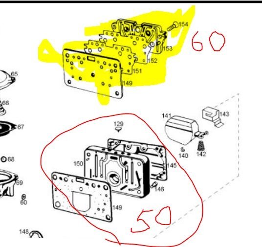

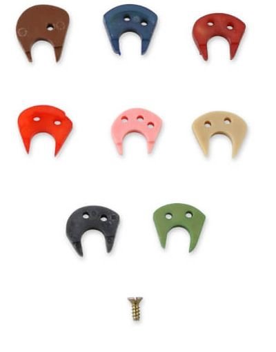

So in my rebuild kit I got 2 gaskets for meter blocks and one that matched the shape of the secondary plate. I used the one shaped like the plate not understanding why you would use a gasket that wouldn't be properly pressed against the throttle body. The plate comes with those odd screws. Then when I was looking for something else I saw them attach their plate to a full gasket. What the heck is the plate sized gasket for if not for putting between the plate? If I had a full-sized metering block I'd have used the full size gasket.am I right on this?

There should be a plate gasket, but on some carburetors that gasket is part of the full sized gasket used to seal the bowl and others it's a different piece. The kits usually include a few different parts to match what your particular carburetor uses. Plus there are some updates they did through the years so they include those parts as well.

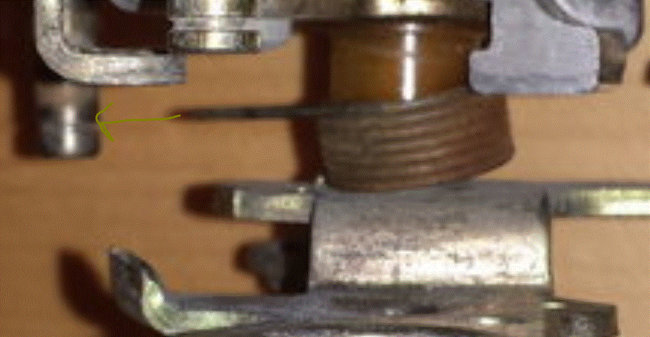

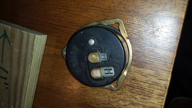

I got the electric choke on but I'm not sure if there's a linkage issue or something. I can't seem to move it at all unless I first open the throttle.
The red cam also shows a silver ball in the end (perhaps used for weight?) mine has a hole but no metal ball. The metal triangle that holds the spring on is broke I think it's copper so I guess I could solder it.

The choke is correct in needing the throttle to release it. That is why you need to step on the gas at least once in a carbureted vehicle, that "sets the choke" by releasing it so it can close on a cold start. Then once it warms up the electric, manifold or exhaust heated pull off system holds it open. Some carburetors also have a vacuum choke pull off that will modulate the choke using vacuum passing through a temperature valve on the thermostat housing. You also will adjust that once you have it installed. The linkage bar can be bent to close it tighter but it shouldn't be needed, you don't really want the choke to seal the inlet off because it does need some air to go past it to atomize the fuel and in the event the choke were to stick you could still move the car around. Once you get it installed you will adjust the cover to keep the choke on for the correct amount of time based on the way the engine warms up and the climate you have. Colder area likes the choke to stay on longer as a general rule.
The gasket depends on what it had originally. Some used a gasket for the metering block and bowl as one piece, some used a similar gasket with the metering plate, Others used two gaskets for the plate, one for the plate and another for the bowl, as long as the holes all line up and it seals either one should work.

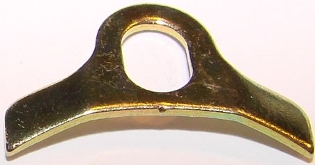

The broken part sounds like the choke cap retainer, looks like the picture? If yes you can get them as replacement parts. They simply push the cover in solid to keep crud out of the housing.

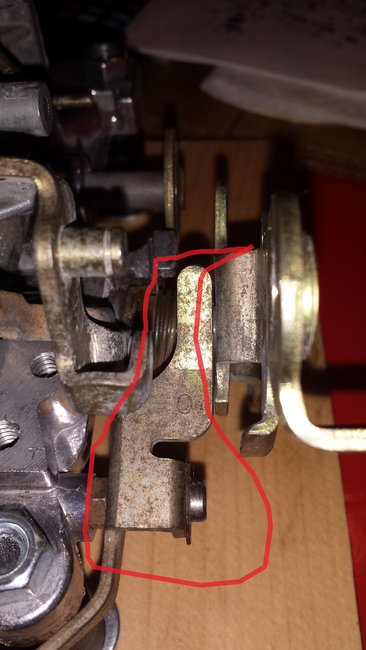

It's not copper. It that metal they use to frame out consumer electronics it may not solder. It is the retainer for the choke spring housing.

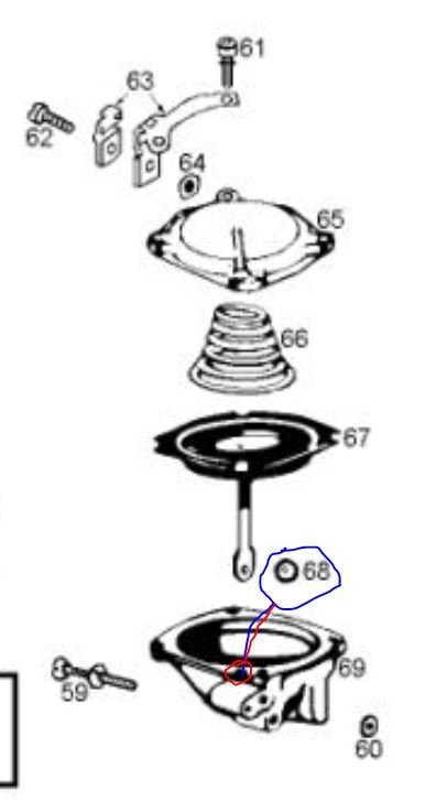

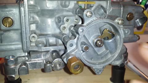

I'm trying to do the vacuum secondary. First which hole does the ball go into? The top or the bottom top or side? Should I put Vaseline on the edges of the diaphragm to help seal it?

That retainer is the fancy version of the one I posted Holley used both as well as a wire version. It's actually just cad plated steel but I would say replace it, they are cheap.
That spring isn't really a spring, it's a bi-metal strip that heats up and pulls the choke open as it heats. The terminals on the outside go to a good ground and a switched power.
The ball is there to pull it down, if yours is missing replace the cam with the correct one for the application.
The check ball goes in the lower section of the secondary diaphragm housing, then the diaphragm and spring then the cover.
No on the vaseline it should seal on its own.

I presume you're telling me to drop the ball in the top of the bottom, not into the side of the bottom?
May 15, 2021 at 8:34 AM
STEVE W.
  • 15,411 POSTS
The ball goes inside the housing in the vacuum port that attaches to the carb body. There will be a gasket, then the passage goes into the secondary housing and makes a right turn and comes up through the diaphragm and into the top cover. The ball goes in the upturned section right under the diaphragm. The check ball passage will have a round hole with a notch in one side. The idea of the ball is that it slows the rate that the secondary's can open. It's one of the trial and error parts in that carb. Some engines need it and some don't. If the engine needs it you will know because the engine will bog as the fuel flow won't keep up with the increase in air through them and you get a big flat spot and lean mix. The ones that don't need it will run just fine. Most of the OE Holley carbs that came on GM engines don't have it.

This connection between the throttle and the secondary plates doesn't do anything at all. I wouldn't think this is just for looks.

It will when the carburetor is actually working and creating vacuum and the choke is on.
