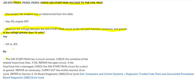

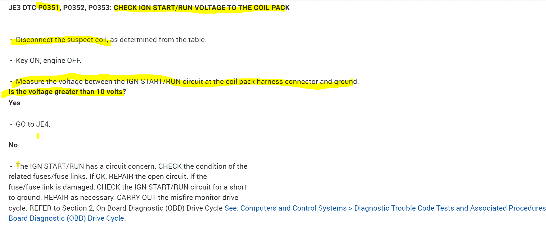

  • 109,885 POSTS
It could be the coil pack. Do me a favor, if the repairs you do make no difference, I want you to follow the diagnostic test below. It's simple.
Let me know what you find and how things turn out for you.
See pic below.
Monday, January 24th, 2022 AT 4:14 PM
