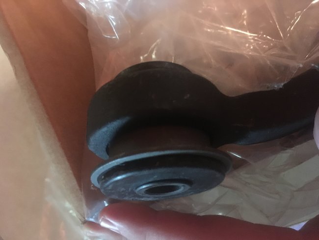

So this is new control arm am I supposed to press bushing all the way flesh with metal on part or leave it like it is?
Jul 25, 2018 at 2:44 AM
DANNY L
  • 5,648 POSTS
Hello again
They are usually ready to install. You will know the minute you attach to the frame if it needs to be pressed slightly more. They will be a little tight fitting but I seriously doubt you need to make any clearance adjustments. Let us know how things go. Hope this helps. I have attached a how-to link.

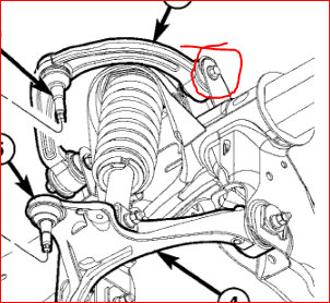

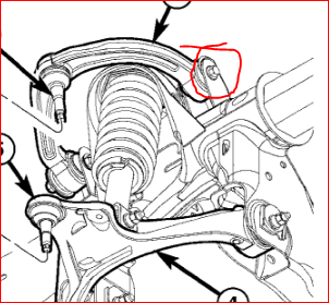

So doing control arms today. Does it matter how I put control arm bolts back in since I have to have a alignment.
Jul 26, 2018 at 12:55 AM
DANNY L
  • 5,648 POSTS
Hello again
Due to the close proximity to the shock perch the nuts go on the insides. You probably can only put the bolts in one-way. Picture attached. Hope this helps and thanks again for using 2CarPros.

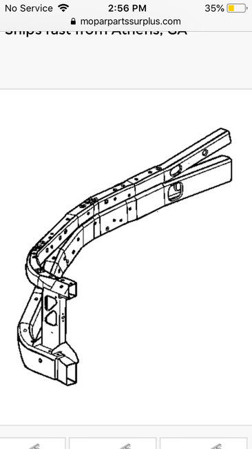

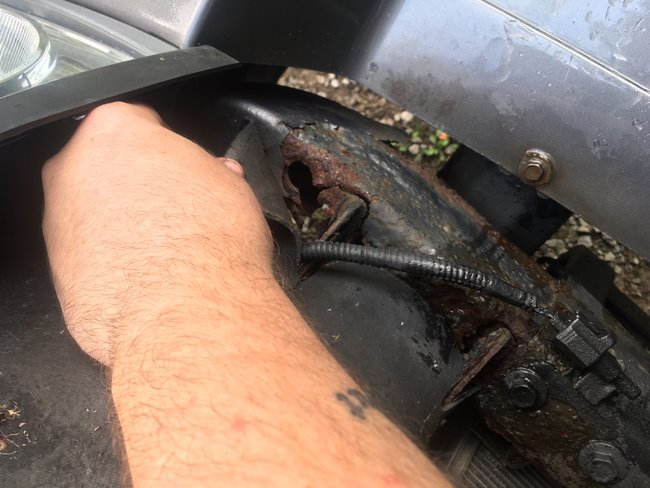

Sorry, I have been asking so many questions. I have not had the truck long trying to get everything fixed. Would you happen to know how to put driver side radiator closure in? It is what radiator support bolts to.
Jul 27, 2018 at 4:51 AM
DANNY L
  • 5,648 POSTS
Hello.
Do you mean the plastic shroud? I can look it up and get back to you.
Danny-
Jul 27, 2018 at 4:54 AM
CORY2427
  • 293 POSTS
No, it is called a radiator closure. It is like a frame it goes underneath fender all the way to front of truck then your radiator support attaches to it.
Jul 27, 2018 at 4:55 AM

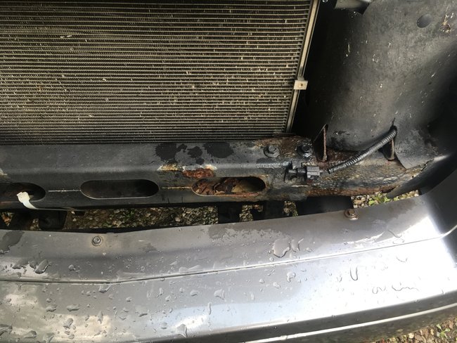

CORY2427
  • 293 POSTS
Here is a picture of it.
Jul 27, 2018 at 4:57 AM

DANNY L
  • 5,648 POSTS
Hello.
Is there a chance you can take a picture of where it mounts on your truck?
Danny-
Jul 27, 2018 at 5:40 AM

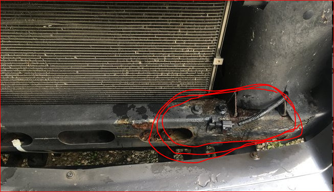

CORY2427
  • 293 POSTS
Not with out taking fender off. I can get a picture of what little comes out and goes into radiator support.
Jul 27, 2018 at 5:55 AM
CORY2427
  • 293 POSTS
That is what little I can get from under the inner fender and what little comes out of front to go into radiator support.

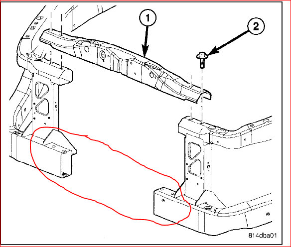

DANNY L
  • 5,648 POSTS
Hello.
Are you speaking of this metal piece (circled)?
Danny-
Jul 27, 2018 at 6:14 AM

DANNY L
  • 5,648 POSTS
Hello.
Oops, did not attach. Here you go.
Danny
Jul 27, 2018 at 6:23 AM
CORY2427
  • 293 POSTS
Yes, minus the radiator support you got in it that piece goes all the way past the fender it is a radiator closure .
Jul 27, 2018 at 6:26 AM

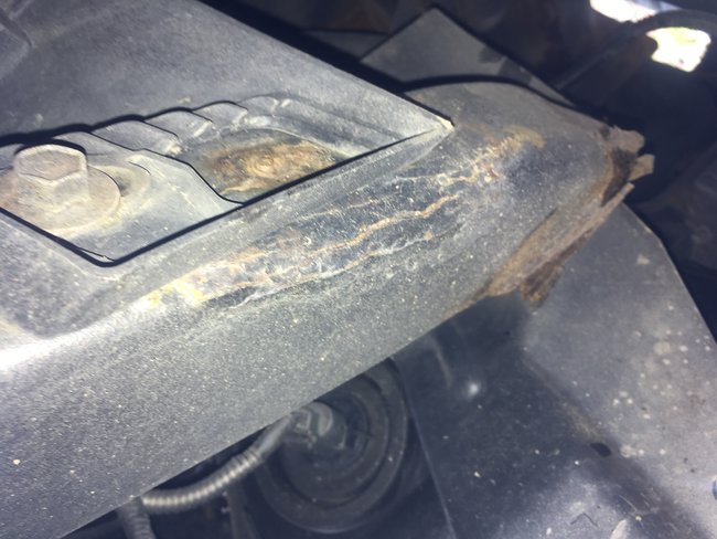

CORY2427
  • 293 POSTS
Here is a closer picture of that piece.
Jul 27, 2018 at 6:40 AM
DANNY L
  • 5,648 POSTS
Hello again.
From what I found it looks like you have to take the front bumper and sheet metal off to get access.

Yea, I cannot find anything either. How about doing lower radiator support? Might pull something up on that be replacing it to.
Jul 27, 2018 at 7:52 AM
DANNY L
  • 5,648 POSTS
Hello again.
Does this look familiar to where it goes?
Danny-
Jul 27, 2018 at 8:01 AM
CORY2427
  • 293 POSTS
Yep, the pieces hanging out is the piece I was talking about because radiator support attaches to it.
