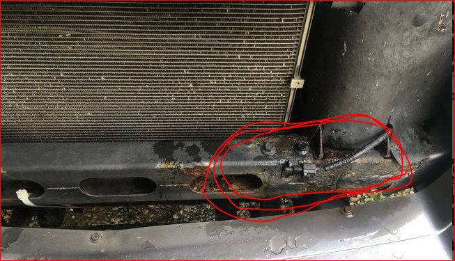

Hello again.

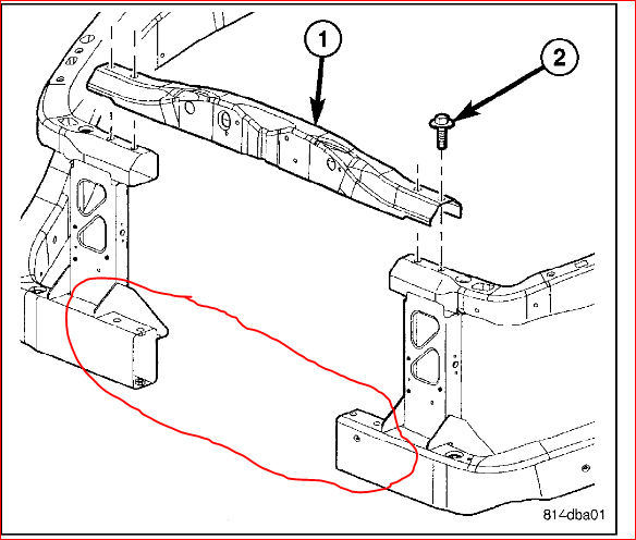

Oh okay. So it looks like you are just doing one side (driver). You will have to take the hood, fender, bumper, and center brace off.
Danny-
Jul 27, 2018 at 8:11 AM
CORY2427
  • 293 POSTS
Okay, any step by step instructions? I am doing driver side what mounts that piece and need instructions on lower radiator support to.
Jul 27, 2018 at 8:13 AM
DANNY L
  • 5,648 POSTS
Hello again
Unfortunately, that is the only picture that I could find. There were no other step-by-step diagrams. Only other thing was bumper removal. I think you might have better luck with checking YouTube. I wll try looking elsewhere as well.

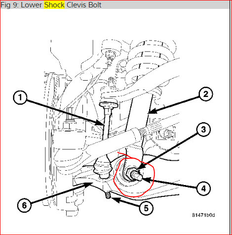

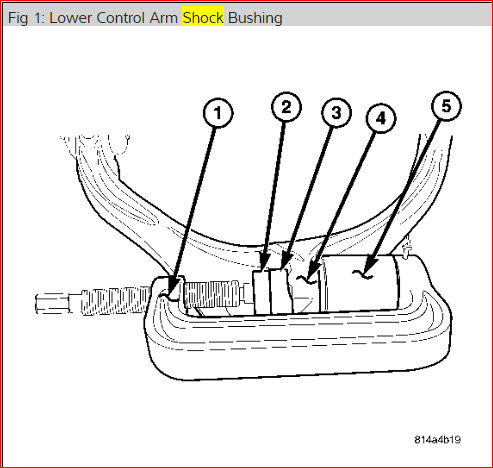

How do I go about changing struts and strut bushing out on lower control arm?
Jul 28, 2018 at 8:39 AM
DANNY L
  • 5,648 POSTS
Hello again.
I have attached a few pictures for you. If you do not have a ball joint/press removal/installation tool you will have to rent one for the lower control arm strut bushing replacement. If you are going to replace the strut cartridges and not the whole complete unit you will have to rent a strut spring compressor tool as well. Hope all this helps and let me know any more questions you have.

Okay, so my plan was to replace the whole strut assembly and was wondering what all I have to take apart to do it and if I still need coil spring compressor any step by steps?
Jul 28, 2018 at 9:49 AM
DANNY L
  • 5,648 POSTS
Hello
If you are replacing the whole assembly you do not need the spring compressor as it installs as a complete unit. You will only need the spring compressor if you are just replacing the strut cartridge and re-using your old spring. I can look for a step-by-step if you are replacing the strut cartridge. If replacing entire unit it is just bolts in.

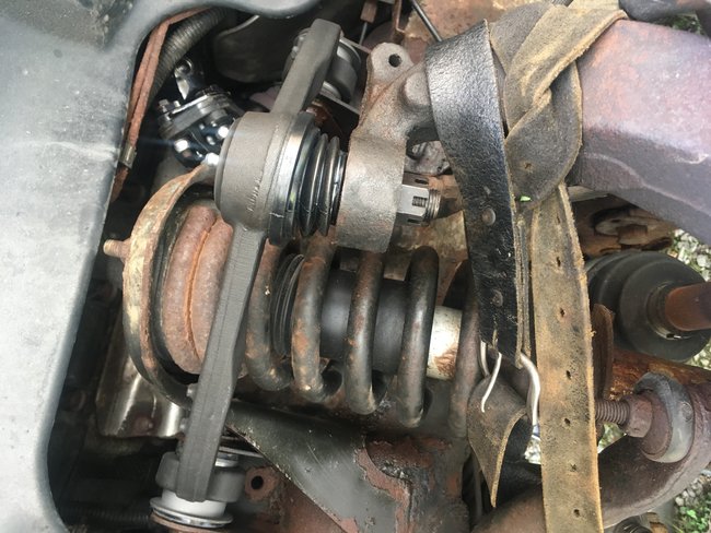

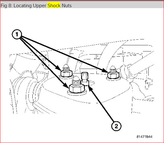

What do you have to take apart to be able to get strut assembly out? And would the strut not still have pressure behind it? What do I need to torque bolts to on it?
Jul 29, 2018 at 8:25 AM
DANNY L
  • 5,648 POSTS
Hello again.
If you jack up the truck and put jack stands under the frame let the upper and lower control arms be free (unloaded) the struts will come out after being unbolted with nothing else having to be taken apart. The torque is 50 ft lbs for the upper strut nuts and 150 ft lbs for the lower. Hope this helps. Let me know if you have any other questions and thanks again for using 2CarPros.

So I do not have to remove any sway bar links or take tie rod out or lower control arms out? Here is a picture:

Do I need a alignment after?

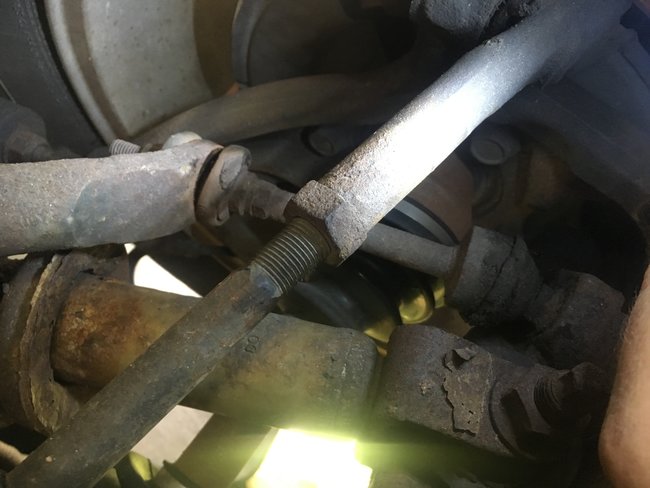

What about spindle and rotors so on they have to come out?
Jul 29, 2018 at 8:57 AM
CORY2427
  • 293 POSTS
Here is bottom picture of strut bolt.
Jul 29, 2018 at 9:00 AM
DANNY L
  • 5,648 POSTS
Hello again.
No, nothing else has to come apart. You do not need an alignment after strut replacement. After unbolting you will be able to remove by just tilting sideways and bringing out towards you. Hope this helps.

So everything stays bolted you said let upper and lower control arms be free. Do not have to mess with them either. Basically just unbolt strut wiggle some. How pull out? Does not look like I could pull towards me any or pull out will it drop or something when unbolt it.
Jul 29, 2018 at 9:16 AM
DANNY L
  • 5,648 POSTS
Hello
Yes, Just unbolt strut assembly and move it around enough to bring it out.Nothing else needs to be unbolted.It may take a few minutes but it will come out as a complete unit.
Danny-
Jul 29, 2018 at 9:51 AM
CORY2427
  • 293 POSTS
I a little iffy about it what videos I watched shows on the 2006 Dakota having to take upper control arms off tie rod end has to be popped out and people using ratchet straps on spring because of so much tension. Sway bar links have to be off. Please insure me your way is right and will not get myself injured.
