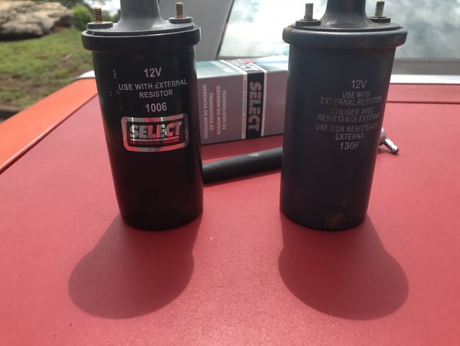

I tested the primary and secondary circuits on both the original and the replacement ignition coil. Both primary circuits were fine. For the original secondary, it read about 8000 ohms. For the replacement secondary, about 9200 ohms.
In my photo, the original is on the right (1306). The replacement (1006) is on the left. Could the different part numbers mean I was given the wrong coil?

Manual calls for 1.34 ohms to 1.55 ohms on the primary resistance and I’m also getting greater than 1.6 on both coils.

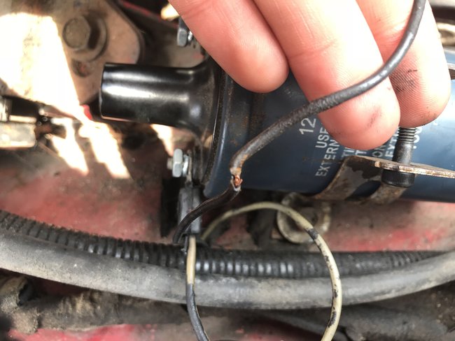

I got it! It was so obscure I never saw it before. But when I put the engine mount back in last year it was on top of the negative terminal wire. I got the wire out of there, taped it up, and it runs!
