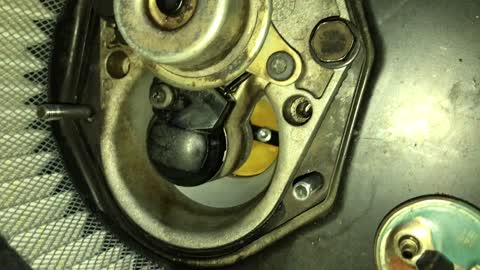

Lets go back to the basics. Watch under the injector to see if you get a nice cone-shaped spray of fuel when cranking the engine. Check for a strong spark from the plug wires.
The next thing is Chrysler's DRB2 scanner has a "No-Start" menu selection. That is not to tell you the reason for the no-start. It simply shows the live data for all of the sensors and switches the computer needs for fuel and spark calculations. It lists the ASD relay as "off" or "on', for example. You want to see that switch to "on" during cranking.
The MAP sensor has the biggest say in fuel metering calculations. If you see very little fuel spraying from the injector, the MAP sensor is a good suspect. There was a recall for it too that involved inserting a tee at both ends of the vacuum hose, then running a second hose between those two tees. This pertains to MAP sensors that were mounted way over by the right strut tower. If there was a droop in the original hose, fuel fumes could condense and puddle there. I don't remember what the symptoms were or if we had to replace the sensor too. Those that I worked on were all running okay at the time. The extra hose was to allow air to circulate, (I know; that doesn't make sense, but it worked), and dry out those fumes.

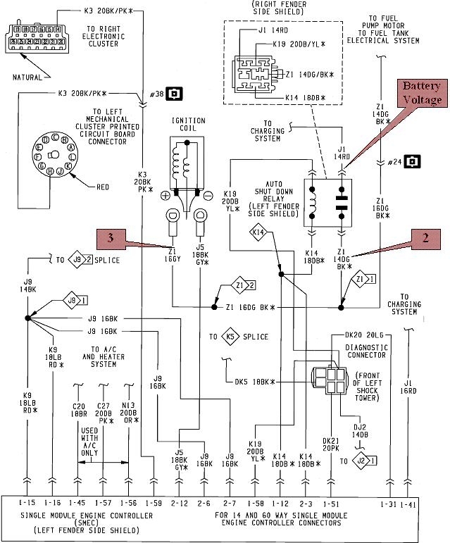

You can't ground the coil's negative terminal. That's the switching side. The computer grounds that terminal so the electromagnetic field can build up inside the coil, then it opens the circuit, forcing that magnetic field to collapse instantly, creating a huge spark in the secondary coil. If you ground that terminal with a jumper wire, there will never occur a spark.
This diagram shows part of the circuit with the ASD Relay. The second one is the same diagram, but the call-outs show you should have full battery voltage on the red wire in the ASD relay's socket, and when it engages, that same battery voltage is switched onto the dark green / black wire, (point "2"), and that turns into the gray wire, (point "3"), at the ignition coil. Everything you've found so far is pointing to a different voltage at point "3" and the red wire. That means there has to be undesirable resistance in that circuit. The best suspect would be pitted contacts in the relay. The next best suspect would be a corroded splice, Z1-2.
Part of the problem is these voltages are all going to be lower during cranking because the starter's high current draws the battery voltage down. There's a way to get around this so battery voltage is not a variable and we can prove one way or the other if there's excessive resistance in the circuit.
Place the red meter probe right on the battery's positive cable clamp. You can use a vise grip pliers to hold it there, or use a small jumper lead to connect it. Place the negative meter lead on the ignition coil's positive terminal. At this point what you get for a voltage reading is irrelevant and meaningless because there is not a good ground circuit for the meter. The voltage reading here becomes valuable during cranking. During that time, the ASD relay's contacts will be closed, and the same voltage should appear at both places. The meter should read 0.0000 volts during cranking. The many zeros indicates that many decimal places of accuracy, and is just meant to emphasize my point.
If there is any undesirable resistance between the meter leads, current flowing through that resistance will cause a voltage drop. That's what the meter will read. Ideally that will be as low as possible, but in reality, there is going to be some. We want to see what that voltage is, then we'll make a judgement as to whether there's a problem in that circuit.

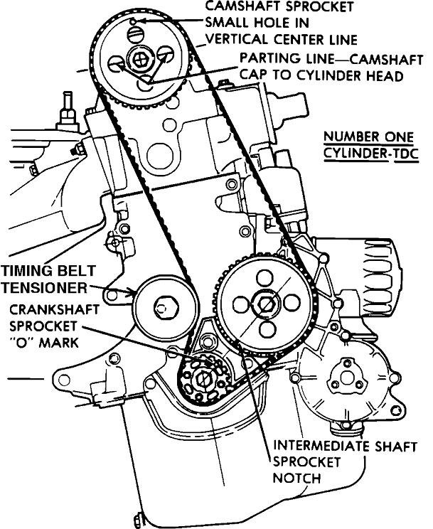

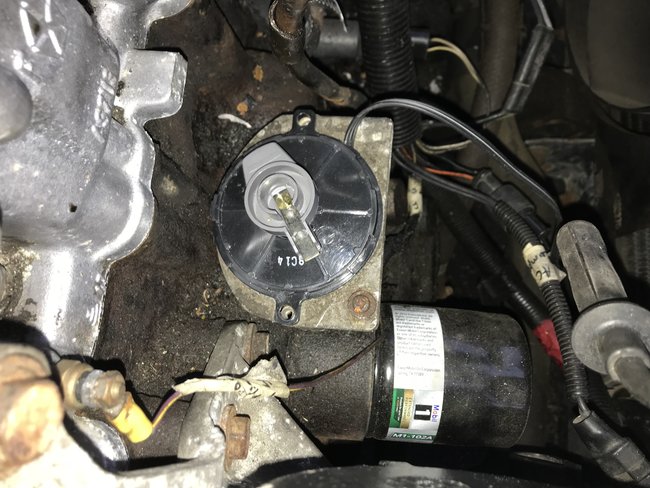

The next thing to do is remove number one spark plug and see if it's wet. If you installed Champion spark plugs, my experience has been that once they've been flooded, they will always misfire and cause very hard starting. They need to be replaced.
Leave that spark plug out so you can find top dead center on the compression stroke. There's a foam plug to remove on top of the transmission's bell housing, then you'll see the timing marks in there. When you have it at TDC, remove the distributor cap and see if the rotor is pointing to the terminal for that spark plug wire. If it's not, we'll need to check the cam timing.

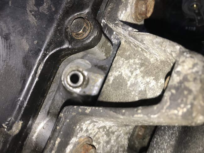

So I need to check the fuel injector tomorrow, and I’ll try to siphon out some of the gas.
I looked at all of the spark plugs last week, and there was some carbon deposit on them. Cylinder 3’s spark plug was a little bit wet. I cleaned all the spark plugs and put them back in. I installed Autocraft spark plugs back in June.
How much fuel needs to be in the cylinders to be defined as “flooded”? I wasn’t looking for it when I pulled all of the plugs, but I didn’t notice anything horrible. Nothing in the cylinders has changed so I can go back and look.
I was talking to a mechanic buddy of mine who used to work on my car for about ten years. Did the LeBaron have a kill switch or something similar attached to the alarm?

No alarms yet in the '80s. They are especially effective at keeping owners out of their cars, particularly GM cars.
The cylinder is flooded when condensed gas coats the spark plug's electrodes. Even if the spark is able to occur, liquid gas won't burn. It has to be a vapor to burn. Even if there is vaporized gas in the cylinder, the spark won't reach it to ignite through the liquid gas. That will also prevent starting fluid from igniting.

Fuel injector was fine. Spark plug didn’t look flooded this time. Nonetheless, how can I clear it? I’ll be testing for bad fuel over the weekend. I’ll also replace the spark plugs nonetheless just to be safe.
Found TDC for cylinder 1, and it’s in time with the rotary button. Button was pointing towards that spark plug. Timing belt was fine.

I'm out of ideas unless there's something in the fuel. We need fuel, air, spark, compression, and correct timing, and we have all of those.
Well, what about compression? We know you won't lose that on all the cylinders suddenly, but I did see one where the camshaft broke in half, then most of the valves stopped opening and closing. You could tell that by the abnormal cranking sound. If yours sounds like there's no compression, or cranking speed is uneven, pop the valve cover off and watch if all the valves are moving.
There was a different problem where the cam sprocket was in perfect time, but the camshaft itself stopped turning. That was somewhat common on a different engine used in the Neons. I never saw that happen in a 2.2 / 2.5L.

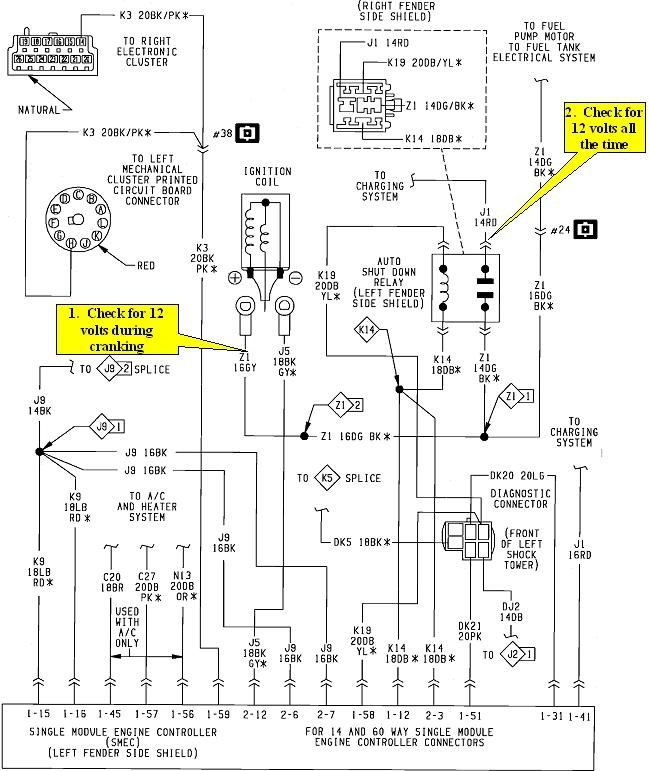

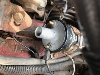

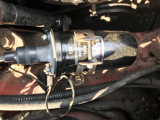

I'm still bothered by the low voltage to the ignition coil. Check if there is a condenser connected to it. In this application it would just be for radio noise suppression, but if it is "leaky", meaning not quite shorted, it could draw the voltage down.
Another way to track this would be to use a small jumper wire to connect the two larger-diameter wires in the ASD relay's socket, then measure the voltage at various places in the circuit. You don't need to have the ignition switch on for this, and bypassing the relay just powers up the circuit like normal, but without the engine running.
Start right at the battery's posts. If it's good and fully-charged, you'll find close 12.6 volts. Now move the meter's probes from the posts to the cable clamps on them. You must find the same voltage. If it's lower, one of those connections is loose or corroded.
Next, move the negative meter probe from the battery cable to a paint-free point on the engine. The voltage still should be the same. Move the positive meter lead to the ASD relay's wires. By this time you might see the voltage drop a little, but ideally it should still be the same as when you started at the battery.
Finally. move the positive meter lead to the positive terminal on the ignition coil. If you're seeing the same 9 volts you found originally, three volts is being dropped somewhere. Finding where is done this way by taking these voltage readings all along the circuit.
If you still have a good 12+ volts at the ignition coil, but it goes down to 9 volts when the jumper is removed from the relay socket and you're cranking the engine, the only thing left is the contacts in the ASD relay. If those are arced or corroded, you should get a nice strong spark if you put that jumper wire back on, and replacing the relay should solve that.

My dad (who bought the car, I was born after he bought it) says he is 100% positive that the car had an alarm, and that there's a switch (not kill switch, just normal swtich) for it under the dash, plus a light for it. The alarm was disabled at some point. Are you sure there's no kill switch?
I'll test the voltages over the weekend, it's too dark out right now. There's no condenser immediately connected to the ignition coil.

If there's an alarm system in the car, it is either an aftermarket product or it is something I have never seen before. The factory systems live inside the Engine Computer and the Body Computer, and Body Computers first showed up in '92 models.
The factory systems never have a "kill" or "defeat" switch as those would make the systems pointless. Anyone could steal the car and know right where that switch was located. Also, when it is on the car, there is no way to disable it.
I can elaborate more if necessary, but for those '92 and newer cars, if yours does not have the factory anti-theft system, you have to be careful when sticking in a used Engine or Body Computer. If you stick one in from a donor car that had the anti-theft system, it is going to teach the programming to the other computer as soon as the ignition switch is turned on. At that point you'll have a crank / no-start until both computers are replaced at the same time with two that do not have anti-theft programming. Once a computer learns that programming, it can't be undone, and from then on that computer will only work in a car that does have the anti-theft system.

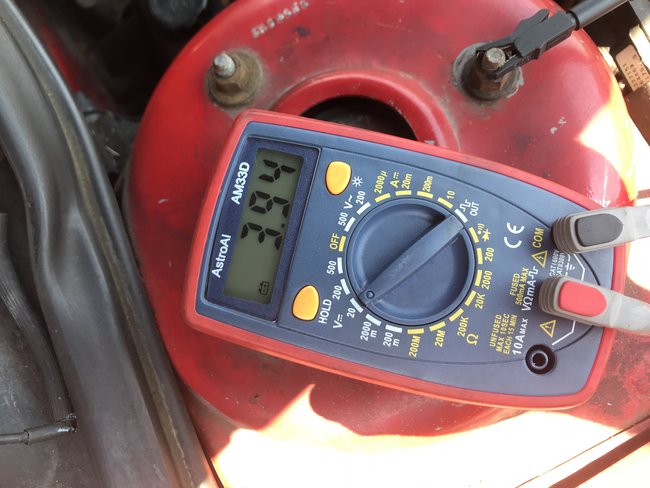

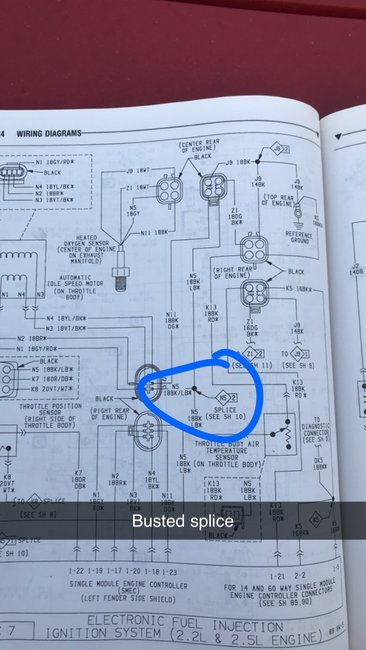

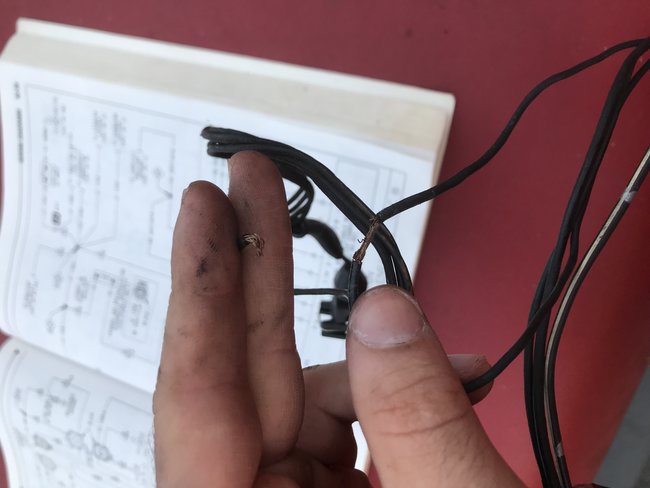

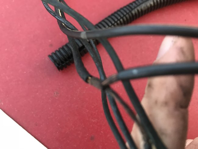

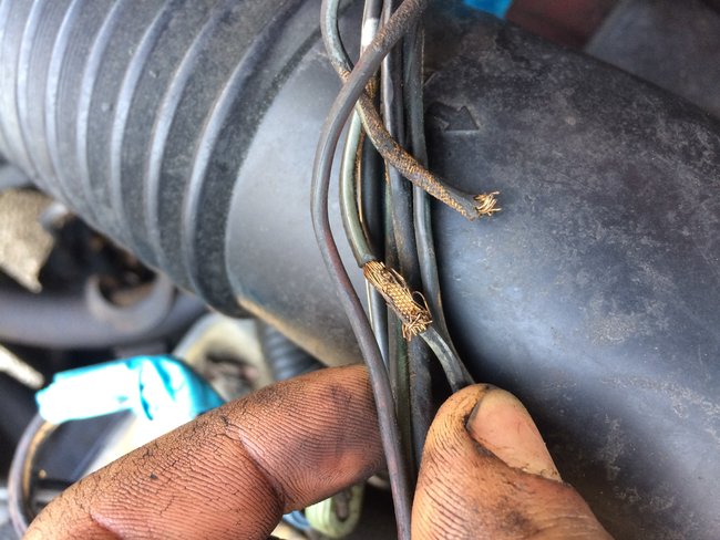

Did the voltage test you described. I put a jumper in between the ASD wires, and the ASD was getting 12.1 volts, just like the battery, and the battery terminals. With the jumper wire, the ignition coil got 10.9 volts. Should I crank the care with the jumper wire in and see if it starts? I still need to test for bad fuel.
My dad said it was an aftermarket Viper alarm that did have a kill switch.
Apr 28, 2019 at 4:10 AM
CARADIODOC
  • 34,414 POSTS
The voltages at the ASD relay and at the ignition coil have to be the same. I suspect you're measuring at the coil while you're cranking the engine. A lower voltage then would make sense because the starter is going to draw the battery's voltage down a volt or two.
10.9 volts at the ignition coil should be enough to develop a strong enough spark.
Apr 28, 2019 at 3:50 PM
SIMONNJ
  • 33 POSTS
That 10.9 wasn’t while cranking, that was just with the key in the “on” position.

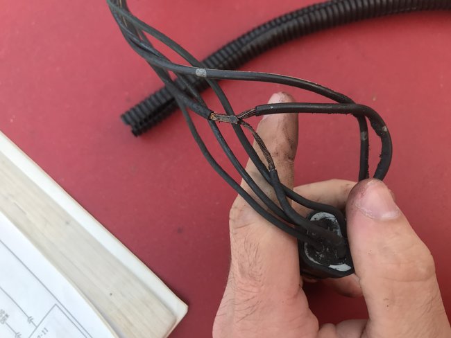

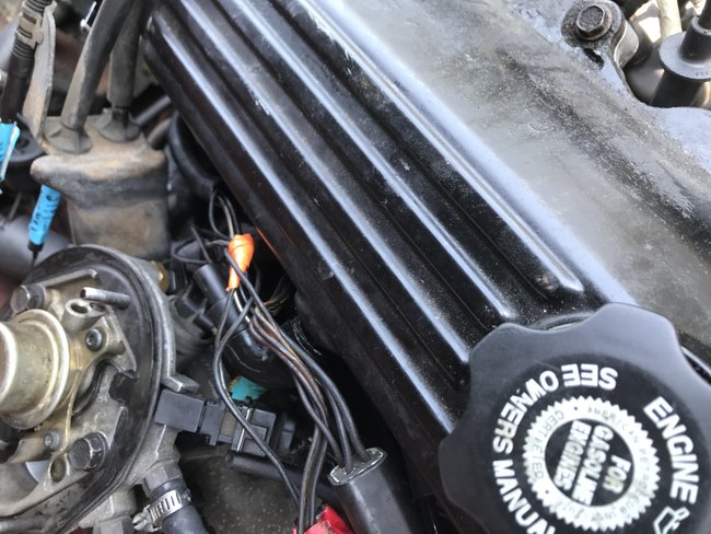

Well now with the key in the “on” position, and bypassing the ASD relay or not, the coil is now getting max 3 volts.
Last summer, I had a wiring harness part of the O2 sensor snap, and I just wrapped the copper around the copper it was connected to and put some electrical tape on. I just tried to repair it 30 minutes ago, and added some dielectric grease to the connection. Could this explain the voltage drop? Nothing else has changed since I took my 10.9 V reading. Do I need to saucer the connection?

I don’t know why my grammar is so poor typing, and I meant to say solder not saucer. Some of my photos also didn’t go through.
The taped connection is the orange tape. The O2 sensor has a splice that goes off from the ignition coil. My second photo here is what the connection looked like broken last year.
May 19, 2019 at 3:23 AM

Yes, the wires must be soldered, otherwise there will be resistance in the joints, and that will cause a drop in voltage. Also, only use heat-shrink tubing with hot-melt glue inside to cover the splices. Electrical tape will unravel into a gooey mess over time.

I’ve replaced everything in the ignition system at least once (ignition coil, spark plug wires, spark plugs, distributor cap, rotary button, Hall effect sensor), and the car still won’t start. The coil is getting slightly low voltage, but I agree with you, I don’t think that’s it because when I put a jumper wire from the battery to the ignition coil, it still won’t start.
All of my ignition coils say on it “12V Use with External Resistor”. Where is this resistor? Even the original coil I had with oil in it says to use an external resistor. I know we briefly talked about this before.
I’ve also tried jumping the car using starter fluid, to no success. My next action is to do a compression test, and I was having trouble siphoning gas out of the gas tank.
Jun 2, 2019 at 6:36 AM
CARADIODOC
  • 34,414 POSTS
No external resistor is used in this system. When one is used, it is to limit current flow and reduce voltage to the coil to the voltage it is designed to operate on. Since system voltage is dropped even further when the battery is loaded down by the starter motor, that resistor would lower the voltage to the coil too much, so it needs to be bypassed during cranking so the spark will be strong enough to ignite the fuel. There is no provision in this system to bypass a resistor during cranking.
I just noticed something while rereading the previous replies. In the photo from three replies ago where you referred to a broken oxygen sensor wire, it looks like that has a braided copper shield around the other wires. If that is what was used, that braided wire and the other wires are different and can't be soldered together. The braided wire is a shield to keep out stray magnetic interference and it is always connected to ground.
One of those other O2 sensor wires is a dark green / black for the internal heater. That's the same 12-volt circuit coming from the ASD relay that goes to the ignition coil. If that dark green / black got soldered to the ground wire, or has a stray strand of wire that is touching the ground wire, that would explain the real low voltage feeding the ignition coil. A dead short should burn open a fuse link wire by the left strut tower, but if that short isn't a perfect short, there can be enough resistance in pitted ASD relay contacts and other connector terminals to limit current low enough so that link doesn't burn open. Instead of the expected 0 volts, you might get a few volts at the coil during cranking.
Jun 3, 2019 at 5:58 AM
SIMONNJ
  • 33 POSTS
This sounds plausible. So what do I do with this wiring harness and the open wires?
Jun 3, 2019 at 8:19 AM
CARADIODOC
  • 34,414 POSTS
Open it up and look at the wires more closely to see if there are four of them inside a braided shielding wire. Those can be rather difficult to repair. You'll need to peel the braid back far enough to expose enough wire to be spliced and soldered. Each wire has to be spliced individually, and sealed with moisture-proof heat-shrink tubing. Pull the braided shield over those wires as best you can, but don't panic if a few inches aren't covered.
I don't remember there actually being a braided shield, so if there is not, just splice the four wires the same way, then for good measure, it would be nice to seal the entire repair with a larger piece of heat-shrink tubing.
Before you splice these wires, leave them disconnected, then see what happens to the voltage at the ignition coil during cranking. If those wires were shorted before, the engine should start now. It will run without the oxygen sensor connected, but expect to see the Check Engine light turn on. You can erase the fault code later by disconnecting the battery's negative cable for a few seconds.

This is the busted splice. I can’t tell if the wires are behind a braided shielding wire. It doesn’t look like it. What do you think?
I pulled the O2 sensor and it didn’t run.
Jun 4, 2019 at 11:32 PM
CARADIODOC
  • 34,414 POSTS
I don't recall ever seeing a braided shield but It kind of looked like that in your earlier photo. There isn't one in these photos. The only thing to watch for related to a crank / no-start problem is that none of these wires are shorted together or to ground.
