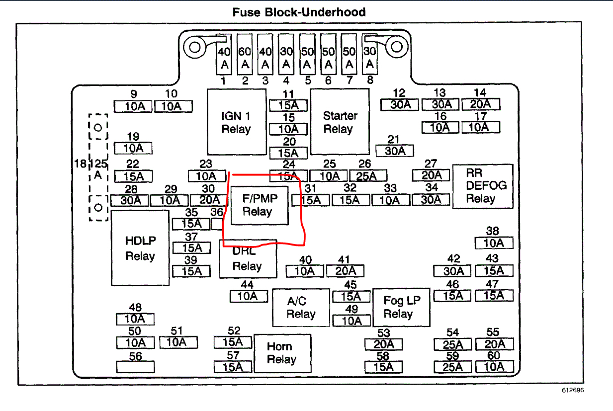

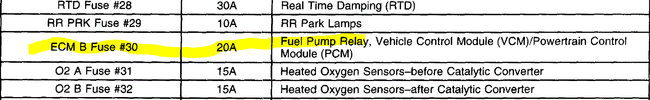

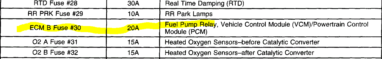

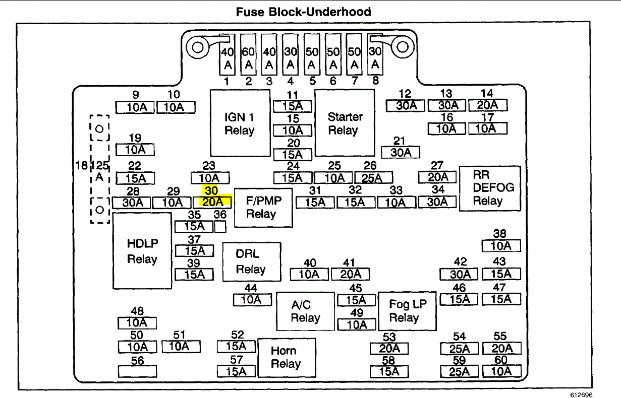

I pushed truck to the pump and put gas in it. After I got gas tried to start the car but it wouldn't start, and it said I had low fuel even though I just put gas in it. I'm not sure if it's the fuel filter or the fuel pump. I also wanted to know where the reset switch is located if this module has one. I've recently had the alternator replaced as well as an oil change/tire rotation. And just put in transmission fluid.
Tuesday, May 4th, 2021 AT 11:56 AM (Merged)
  • 109,885 POSTS
The fuel pump relay is under the hood in the power distribution box. There is no reset on it. I attached a pic below (picture 1) and circled the relay. If there is a relay with the same part number, switch them. If not, here is a link that explains how to test it:
Here is a link that explains the most common causes of a crank no start. Take a look through it to see if it helps.
Next, check fuse 30 also (under hood). It powers the fuel pump relay. (see picture 2 and 3)
Now, the first thing I would be checking is if there is fuel pressure at the engine. I can provide the manufacturer's specs, but I need to know which engine is in your vehicle. There are 4 different V8 engines.
Here is a link that explains how to test fuel pressure in general:
Next, if fuel pressure is good, then we need to determine if the ignition system is working. Here is a link that explains how to test for ignition spark:
