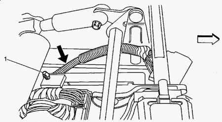

MERLIN2021
  • 17,250 POSTS
There is another tech bulliten on the driver's seat wiring harness chaffing on the seat rail, have a look there, it also can cause a no start.. Here's the TSB: INTERMITTENT NO START, SERVICE STABILITY MESSAGE, ABS LIGHT ILLUMINATED, MULTIPLE DTCS, DIC SHOWS UNKNOWN DRIVER, VARIOUS ELECTRICAL RELATED CONDITIONS (REPAIR AND/OR REROUTE SEAT WIRING HARNESS) TECHNICAL SERVICE BULLETIN Reference Number(s): 03-08-50-014,  Date of Issue:   August 20, 2003 CADILLAC: 2003 Escalade, Escalade ESV, Escalade EXT CHEVROLET: 2003 Avalanche, Silverado, Suburban, Tahoe GMC: 2003 Sierra, Yukon, Yukon XL SECTION: 08 - Body and Accessories Related Ref Number(s): 03-08-50-014 ARTICLE BEGINNING CONDITION Some customers may comment on any of the following conditions: Vehicle intermittent no-start "¢ Service Stability Message "¢ ABS light illuminated "¢ Multiple DTCs set "¢ Driver Information Center (DIC) shows unknown driver "¢ Various electrical related conditions "¢ CAUSE A chafed or pinched seat wiring harness under the driver seat may be a cause of this condition. Because of the routing, a portion of the seat wiring harness may rest on the inboard edge of the seat track or frame. Over time, the harness may be pinched or chafed because of the seat movement. Refer to the illustration below ( Fig. 1 ). The illustration shows the inverted position of the seat bottom. The arrow shows the primary location of the possible harness chafing/pinching. CORRECTION Inspect the routing of the seat wiring harness. Reroute the seat wiring harness and attaching harness fastener (1 in Fig. 1 ) to the opposite side of the seat module bracket. Repair the harness as necessary. Refer to Wiring Repairs in the Wiring Systems sub-section of SI. The seat may have to be removed for ease of access and proper repair of the wiring harness. Fig. 1: Sear Wiring Harness If any of the above conditions still remain after this repair, refer to SI for further diagnostic information. Page 1 of 2 INTERMITTENT NO START, SERVICE STABILITY MESSAGE, ABS LIGHT ILLU...2/21/2010
https://images.2carpros.com/forum/automotive_pictures/62217_seat_harness_1.jpg
May 4, 2021 at 4:51 AM (Merged)
POSSUMFL
  • 6 POSTS
Wow. Who would have thought to look under the seat!! I spent 3 hours yesterday looking for wiring problems, took the fuse block out, took the dash apart, looked for any king of loose or chafed wires, but silly me did not look under the seat. Well I looked under the seat today, moved the wire from where it was caught on the seat frame, moved the seat all the way back, and what happened? The fuel pump kicked on and it started right up. Thank you!!! I hope that is really the problem this time. I guess I will know in a few weeks if it keeps on starting. Everytime I have replaced something else it always started right up so it is hard to say if this was the culprit, but I sure hope so.

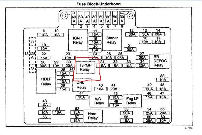

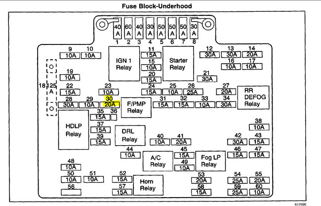

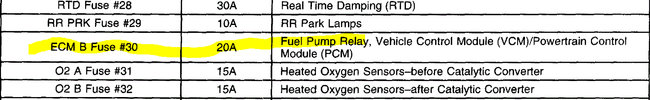

MJESSICA
I pushed truck to the pump and put gas in it. After I got gas tried to start the car but it wouldn't start, and it said I had low fuel even though I just put gas in it. I'm not sure if it's the fuel filter or the fuel pump. I also wanted to know where the reset switch is located if this module has one. I've recently had the alternator replaced as well as an oil change/tire rotation. And just put in transmission fluid.
May 4, 2021 at 4:56 AM (Merged)
  • 110,248 POSTS
The fuel pump relay is under the hood in the power distribution box. There is no reset on it. I attached a pic below (picture 1) and circled the relay. If there is a relay with the same part number, switch them. If not, here is a link that explains how to test it:
Here is a link that explains the most common causes of a crank no start. Take a look through it to see if it helps.
Next, check fuse 30 also (under hood). It powers the fuel pump relay. (see picture 2 and 3)
Now, the first thing I would be checking is if there is fuel pressure at the engine. I can provide the manufacturer's specs, but I need to know which engine is in your vehicle. There are 4 different V8 engines.
Here is a link that explains how to test fuel pressure in general:
Next, if fuel pressure is good, then we need to determine if the ignition system is working. Here is a link that explains how to test for ignition spark:
https://www.2carpros.com/articles/how-to-change-spark-plugs
