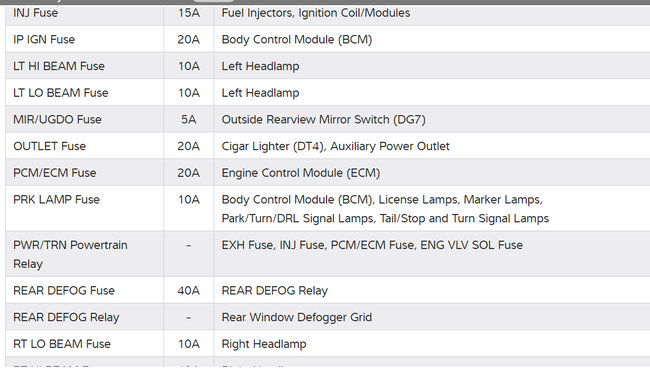

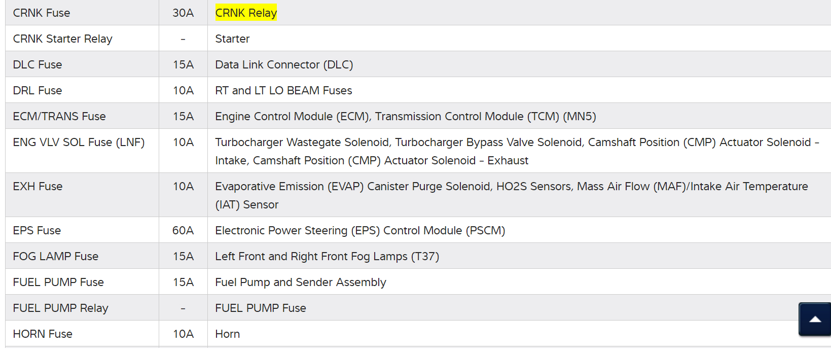

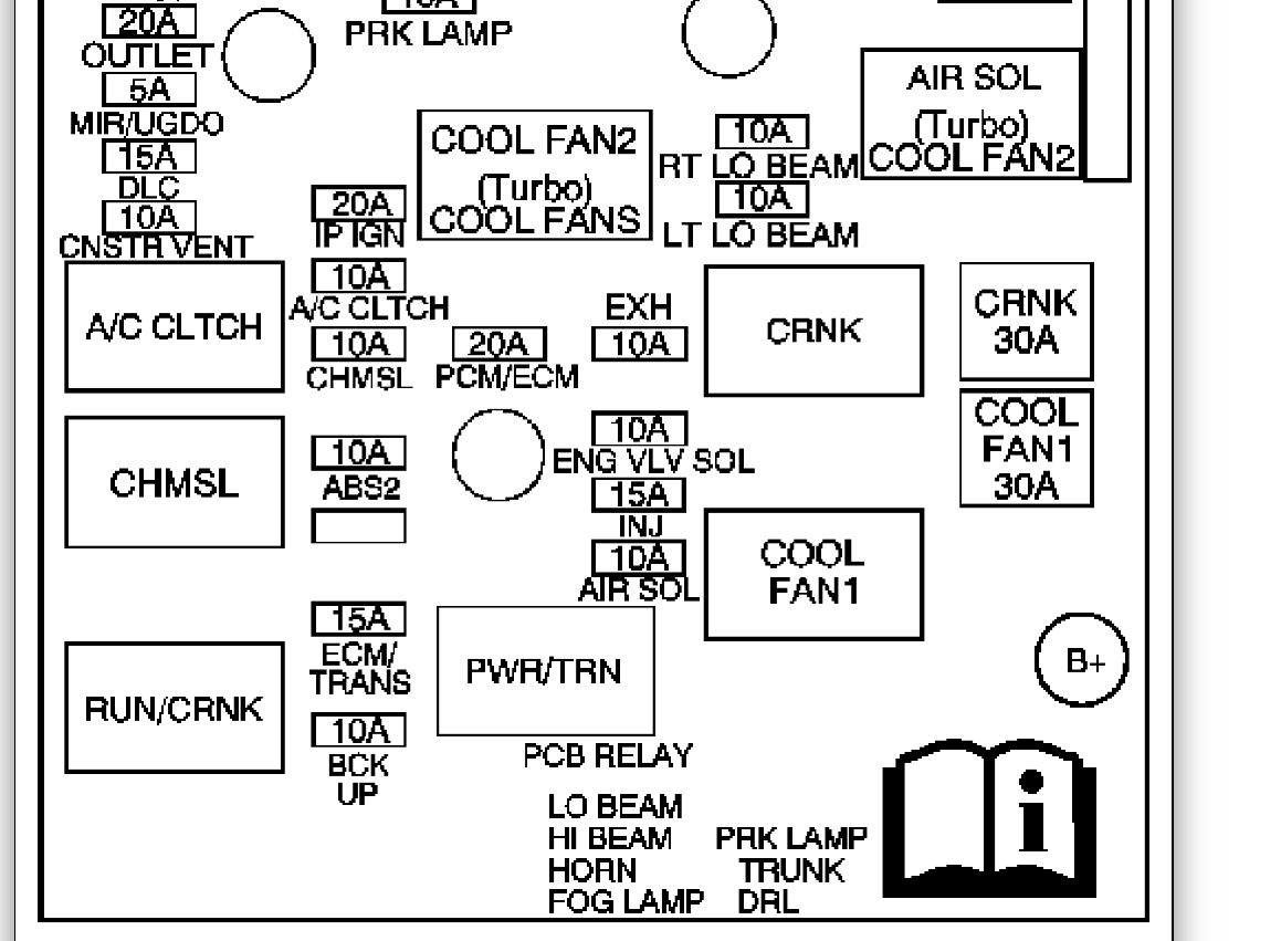

working on this car, I was trying to install a remote car starter and got it to start and try to crank but no fire. after a while of trying that the car decided to go into car lock mode. the car lock symbol is on it does not flash, the airbag light and brake light are now on as well. there is a clicking from the fuse box in the hood so i replaced a couple fuses and relays and it still will not do anything
wondering if i might have fried the board inside the fuse box? please any suggestions would help. i have also tried leaving the key in for ten minutes to relearn the key but that did not work.
Jan 26, 2018 at 7:37 AM
CARADIODOC
  • 34,381 POSTS
Before you get all wrapped around the axle, everything you described could be caused by a run-down battery. Thanks to all the unnecessary computers that do things they were never needed for before, a slightly weak battery can cause no cranking at all where it used to cause the common slow cranking. Computers will do weird things when they get confused from low system voltage.

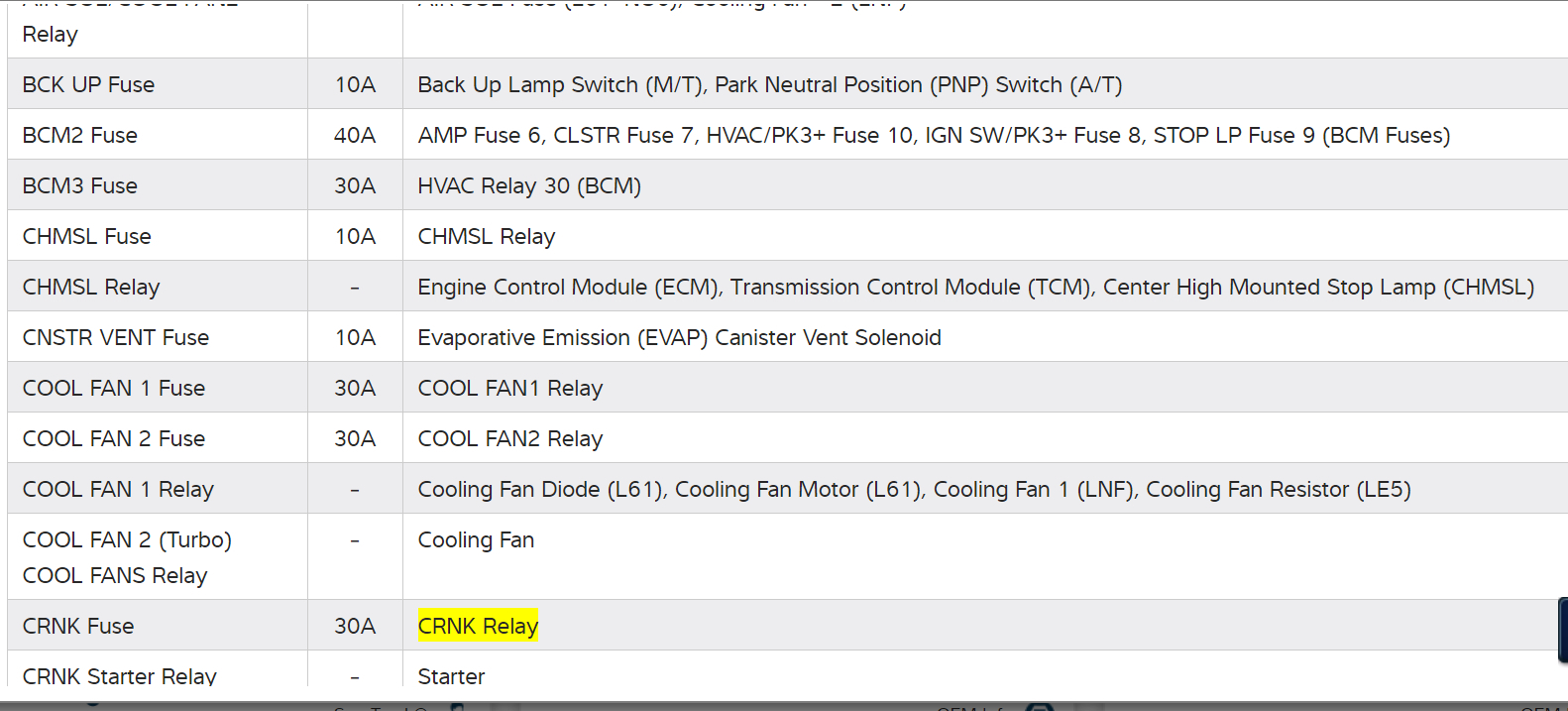

the car does not even try to crank it just shows the car lock symbol the brake light and the air bag light and the head lights turn on and the radio and that is it except the trunk light.
really hoping it is the battery however i have my doubts, if you could go into detail about the voltage drop testes on the fuse panel that would be greatly appreciated.
Jan 27, 2018 at 7:27 AM
ROBERTMENKEN
  • 7 POSTS
was also thinking the BCM, but not sure how to test it. the fuses for it are still good though.
Jan 27, 2018 at 7:28 AM
CARADIODOC
  • 34,381 POSTS

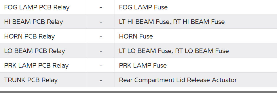

Are you saying the trunk light does not work? If so, a blown fuse is a good suspect. They often blow from the current surge when connecting the battery or even when connecting jumper cables. The problem is on newer cars the lights are usually run by a computer and those can start to shut down some functions when system voltage is low.
This miserableness also applies to the starter relay, as I briefly mentioned earlier. On older cars, a weak battery caused the starter to crank the engine too slowly. With the addition of computers, with low system voltage, the computer may refuse to turn on the starter relay, resulting in a no-crank condition. The engineers found a solution where there was no problem when they added an unnecessary computer to the starter system.

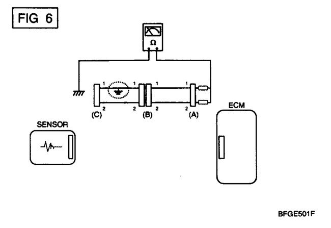

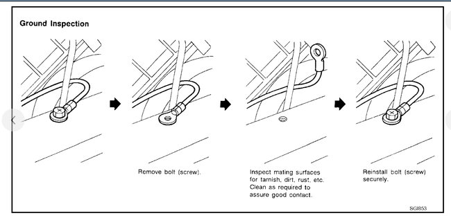

Nope. That can only be done by the manufacturer and their authorized repair centers. We have to approach these the same way I tested integrated circuits in tv's and vcr's. First you have to verify all the power supplies are there. For computers in a car, that means twelve volts on a minimum of one wire when the ignition switch is off, and a minimum of one other wire when the switch is on. It is common to find four twelve volt supplies to an engine computer.

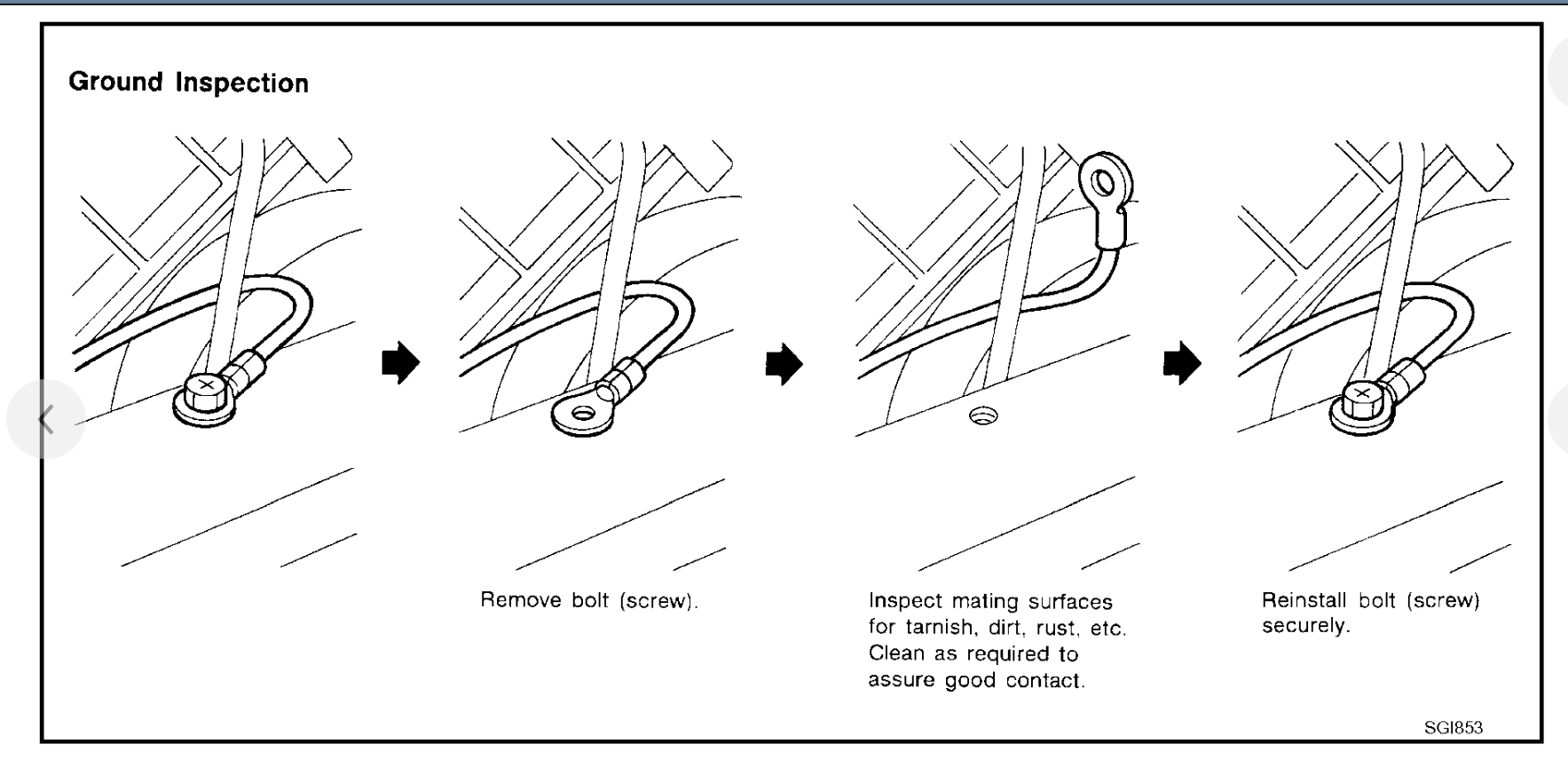

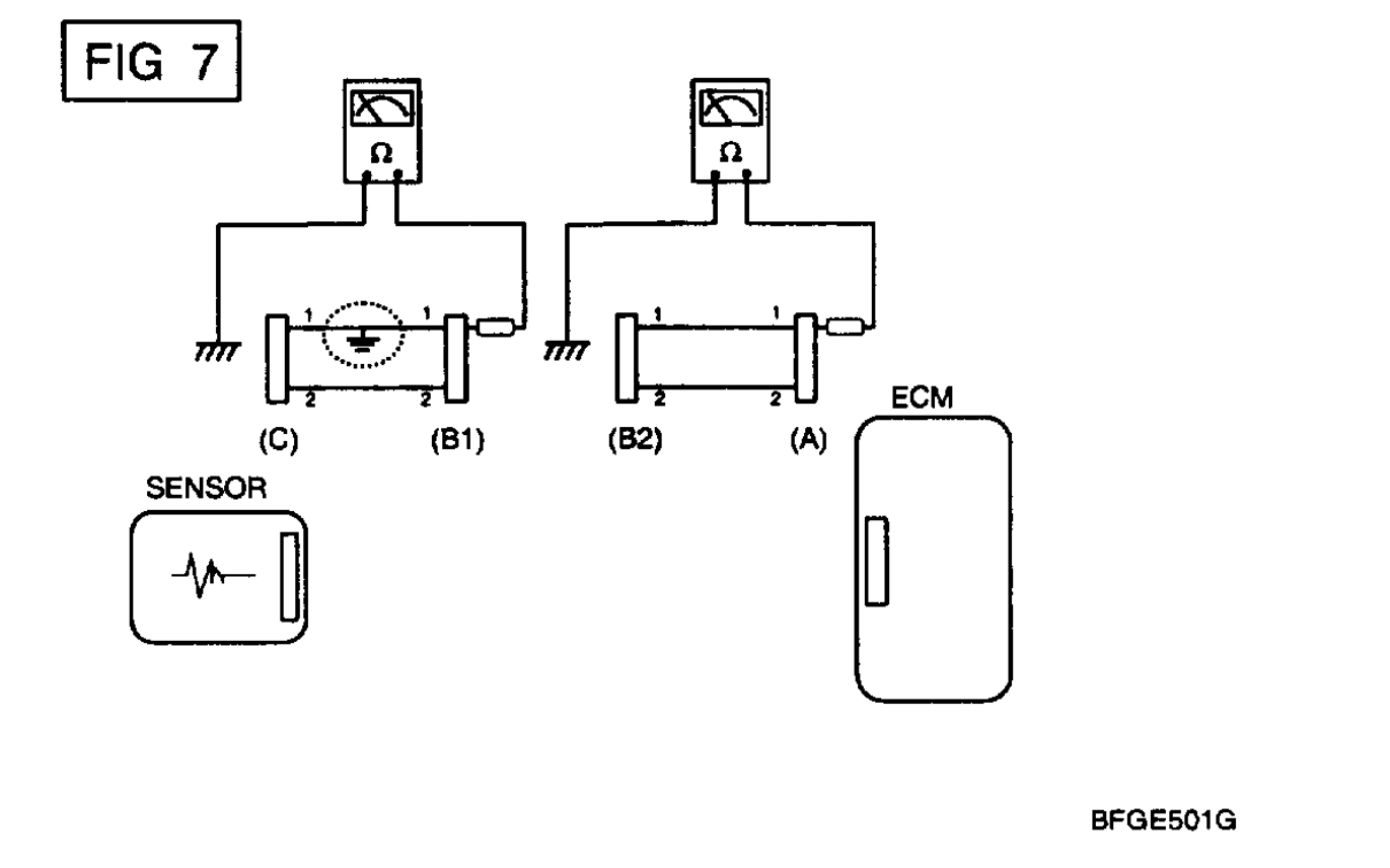

Next is to verify the ground wires. As with the tiny resistances in the battery cables, it is not sufficient to just measure the wires with an ohm meter. Instead, while that computer is powered up and running, measure the voltages on those wires. On Chrysler engine computers, there are two "signal" ground wires for the sensor circuits, and two "power" ground wires for the stuff that has pulsing high current, like injectors and ignition coils. The reason is if there is just a little corrosion and resistance in the ground wire, that will result in a slight voltage drop, and that voltage drop will jump higher each time an injector or coil is fired. That tiny voltage means nothing to those circuits, however, if you put those few hundredths of a volt on the ground wire for the sensors, that will raise their signal voltages, and you will see those pulses in their signals. A few hundredths of a volt can mean a real lot to some sensor readings. For that reason, they want sensors being grounded independently of the more tolerant high-current stuff. There is just two of each ground wire in case one gets a bad connection. You will find that most GM and other brand computers also have multiple ground wires.
Once the power supplies and grounds are verified to be okay, you have to look at the inputs. There is no better way to do that than with a scanner. It is way too time consuming and tedious to find each wire on the wiring diagram, then on the computer, then take the voltage reading, and interpret it.
If you have power supplies, grounds, and inputs, you will get the correct outputs, if the computer, or integrated circuit, is okay. There is just one more stipulation. There cannot be any defects in the output circuits. For example, if a line leading out of the integrated circuit goes to a transistor that is shorted, that circuit cannot be run by the IC. If you have a wire to a solenoid or relay, for example, that is rubbed through and grounded, it cannot work either. The luxury we have with cars is the computer will usually detect a defective condition in an output circuit and will set a diagnostic fault code to tell us where to look.

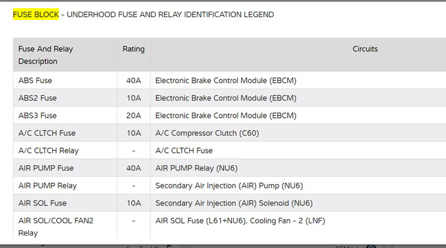

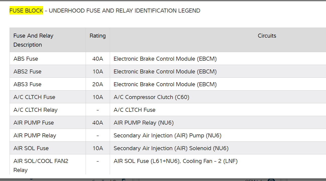

alright well, when the car first started to not work i found two 30 amp cooling fan fuses blow. is that a sign that the engine computer is bad? i did replace them to no avail. they have not blown since.
Jan 27, 2018 at 11:04 AM
CARADIODOC
  • 34,381 POSTS
Nope. Those would be protecting the radiator fan motor. The computer simply turns on the fan relay. It is the relay that handles that high current, not the computer. GM often uses a two or three-speed system for their fan motors. I suspect you have a two-speed. The common cause of blown fuses is the motor has tight bearings and must be replaced. You can verify that by spinning the fan by hand. It should coast for many revolutions. If the bearings are tight, it will stop spinning the instant you let go of it.
Generators need three things to work; a coil of wire, a magnet, and most importantly, movement between them. When you drive the generator with a belt, it develops its current.
Guess what? Inside a fan motor, (and a starter motor), is a coil of wire, a magnet, (an electromagnet), and when it is running, movement. To simplify that wondrous statement, a spinning motor acts like a generator. We cannot measure the current it develops, but it is less than the current that's running the motor, and it opposes that current that's running it. Your fan motor might draw 35 amps when it is standing still, but once it comes up to speed, lets say it develops 15 amps that opposes current coming from the battery. That means actual current flow drops to 20 amps, which is a safe and normal current for a fan motor.
When the bearings become tight, the motor slows down, and with less movement, less reverse current is generated. That means current flowing through the fuse and motor goes up, often to the point the fuse blows. The motor is not shorted, but being tight makes it draw higher current. The confusing part is now that it is drawing higher current, the electromagnets become stronger, so the motor becomes stronger, often to the point it appears to be running at normal speed.

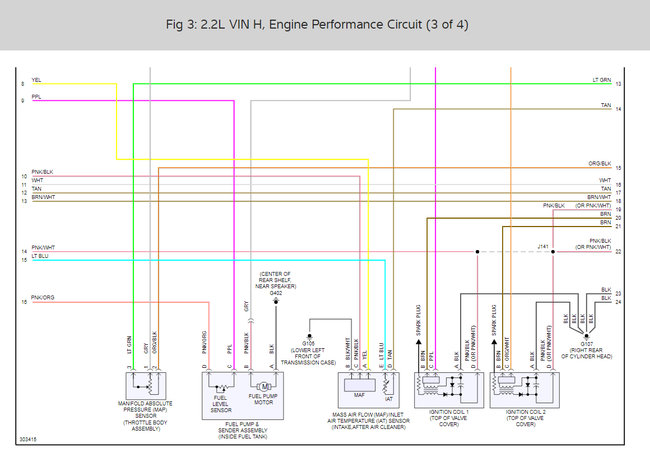

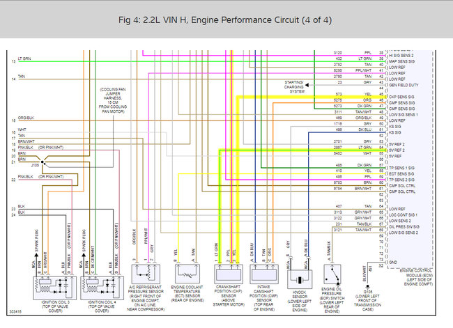

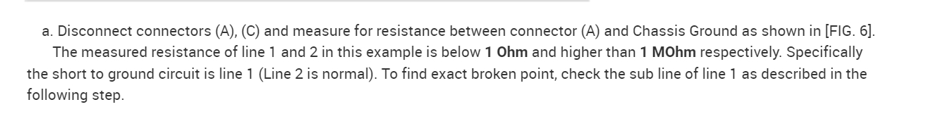

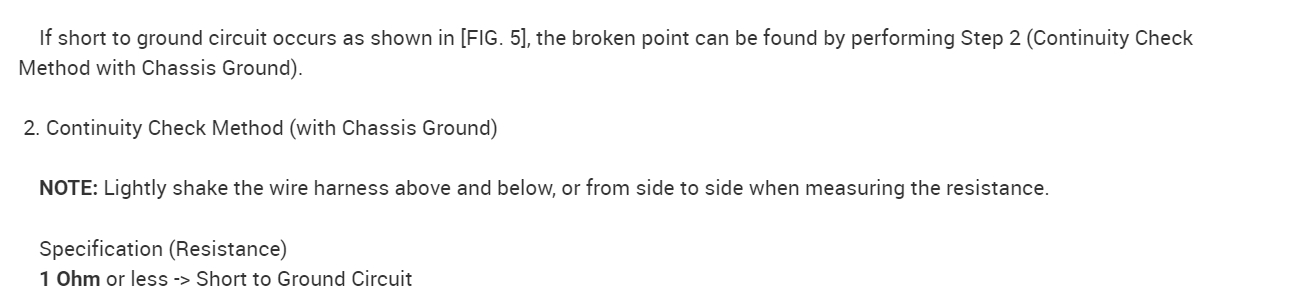

LE CHEN
Thank you all for reading this post.

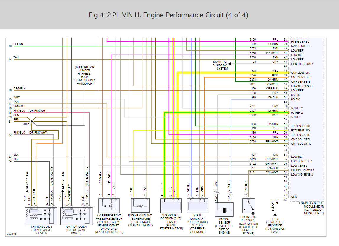

My car has been running flawlessly for years until two months ago. It refused to start when I parked my car at a mountain top with very low fuel. After adding two or three gallons of fuel, I managed to drive it back home. I immediately topped the gas tank then the nightmare started. It constantly stalled and struggled to start.
The local auto shop diagnosed the car then replaced the fuel filter, crankshaft sensor, and camshaft sensor. The car ran well for two days, then the same issue reappeared. The shop replaced the sensors again, as they suspect the replacement parts can be faulty. This time my car lasted for a month. Finally, the auto shop told me they could not figure out why.

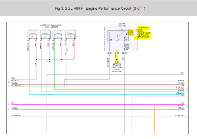

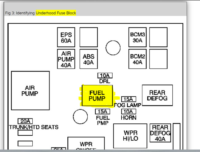

So, here are symptoms of my car:
1. I managed to start the car initially, now it shut off completely.
2. The engine cranks but the car will not start.
3. When the key is on, the fuel pump does not prime, and there is no control signal on the fuel pump relay.
4. When I applied 12v to the fuel pump relay control pin, the pump runs and good fuel pressure was tested. I cranked the engine, still no start, only to smell unburned gas.
5. This indicates that the vehicle lost fuel and spark at the same time, and a bad crankshaft sensor seems to make sense.
6. But then what can make the sensor go bad frequently?
Any sort of help is greatly appreciated!
Jul 29, 2020 at 5:18 AM (Merged)
SCGRANTURISMO
  • 4,897 POSTS

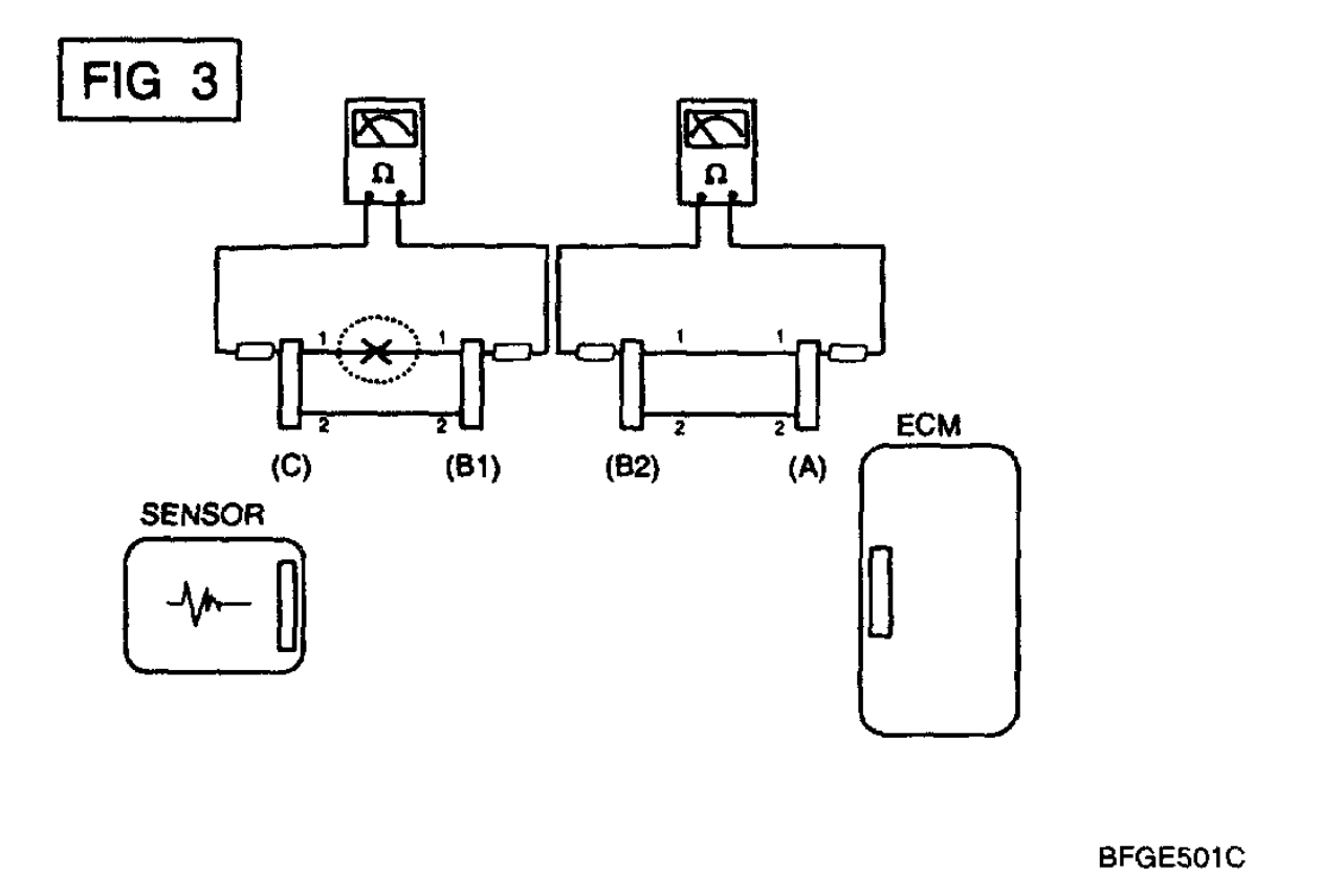

The fuel pump relay ground it probably bad. This is the ground on the coil and the other side should be coming from a switched power supply. The crankshaft sensor is probably good, but did the shop check the connector and the wires going to the Power-train Control Module (PCM)? This could very well be the problem. In the diagrams down below I have included wiring diagrams for you to check the CKP wires for damage as well as instructions for checking for an open, short circuit, and ground inspections on your vehicle's CKP circuit and fuel pump relay. Also here is a link on how to test a relay properly:
Please go through these guides and get back to us with what you are able to find out.

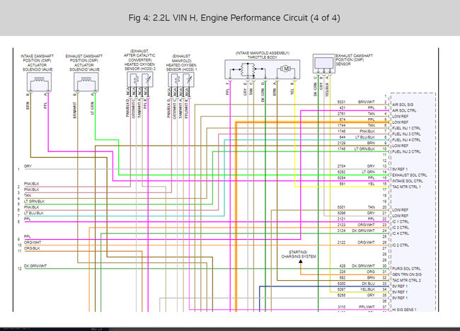

LE CHEN
Hi 2carPro friends,

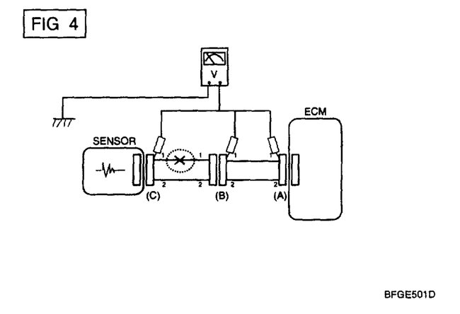

Here is an update on the above issue. A mechanic helped me diagnosed the vehicle. Confirmed there was ignition spark, just fuel pump not running. So he replaced the fuel pump. Still not running. Switching fuel pump relay did not help.
Honestly, to troubleshoot circuit issues as Alex suggested requires a more advanced skill level. So he came up with a simple fix -- jumped a wire to bypass the fuel pump relay -- fuel pump shuts off when the key is off.
Yes, there is still a circuit issue which causes the fuel pump relay not getting control signal.
I asked another experienced mechanic whether he can fix the issue, he said this issue could be related to the "engine computer" which can only be reprogrammed at the dealers.
So far my vehicle runs perfectly. No engine light or any type of error codes.
Both mechanics told me it should be fine with the current solution.
What do you guys think? Any potential risk for bypassing the fuel pump relay?
Thank you for any kind of input!
Leo

SCGRANTURISMO
  • 4,897 POSTS
Hello again,
I have done the same thing in my vehicle. I have a 1997 Ford Mustang GT and the fuel pump relay is contained in what is called the Constant Control Relay Module (CCRM) that also holds the PCM relay and both the high and low speed fan relays. So when I had an issue with the fuel pump relay, I simply ran a new relay, using the high amperage wire from the Under hood Fuse Box and a switched power line from the Instrument Panel Fuse Box via a fuse tap. Just like yours, when the ignition key is in "run" or "start" the fuel pump is getting power and is running, and as soon as the ignition switch is turned off, the relay also turns off. Works great.
