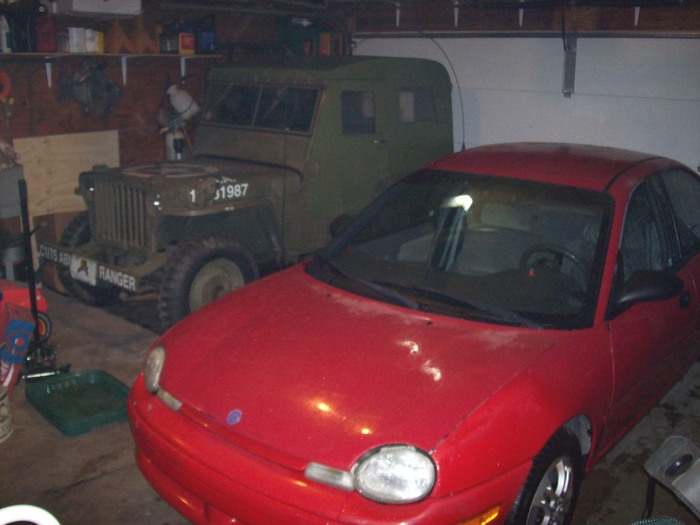

I have a '95 neon that the key will not rotate back to "lock", so it will come out....happens often...i'm lazy, only gave $250 for it. Good a/c and 30 mpg! As long as i can get the key out, i will not perform surgery!!!
This is our spare "automatic tranny" car, mainly for my wife to drive.....i won't let her drive my standard tranny jeeps....she scared me so bad, the time, i did let her!
My trick is to unlock the "tilt column" and sorta gently bounce it up and down a couple of times, it'll then rotate back.
My guess is there is linkage inside (probably to the shifter, in a round about way) for the "park lock feature"....it just will not slide freely into place, less it's moved w/ the tilt
