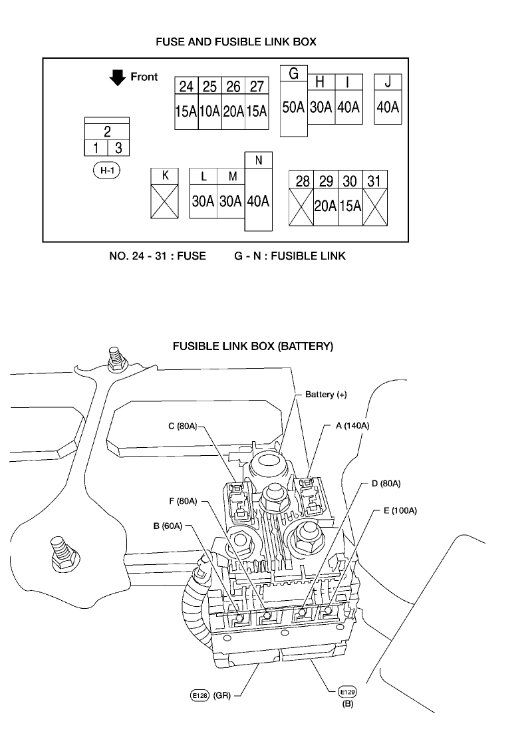

Please, I am having this issue with my car, it won’t start but it cranks. I have these fault codes p1820 and U1000 as well as P1808. Please help me figure out how to repair this fault. I am a mechanic.
Jul 9, 2023 at 8:11 AM
  • 54,840 POSTS

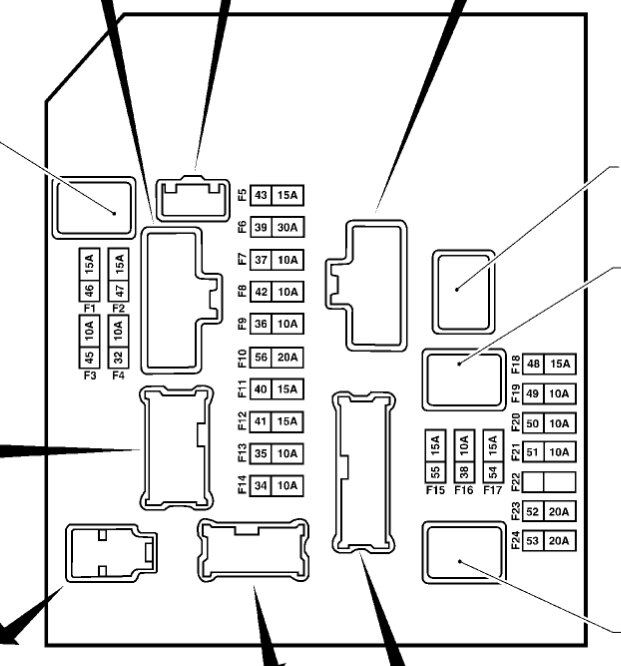

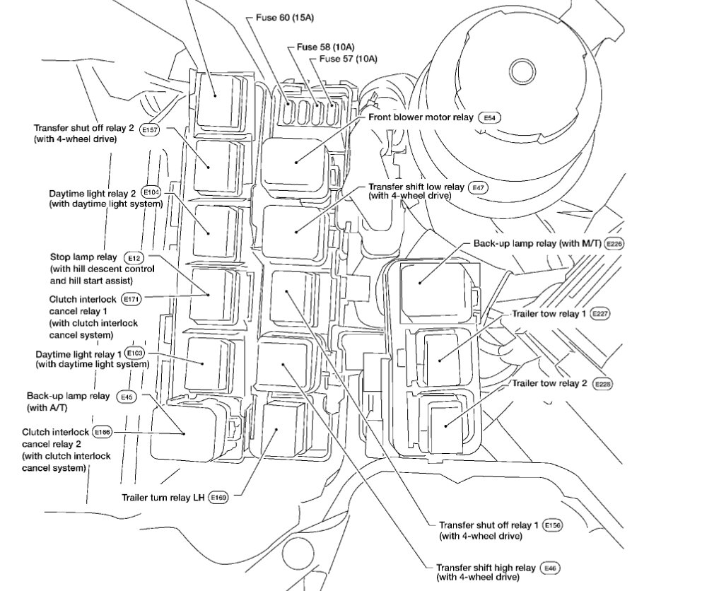

The communication code will be the problem, the others are for non-essential engine performance issues.
I would start by checking the fuses here is a guide that can help, and I have included the fuse locations as well. If all fuses are good, I would swap out the ECM relay (the ECM relay maybe interrogated into the IPDM which might be bad).
U1000: This code signifies a communication problem between the ECM and another module on the vehicle's network.
P1820: This code is related to the transmission range sensor circuit malfunction.
P1808: This code relates to the transmission 4-wheel drive (4WD) mode select switch circuit.
