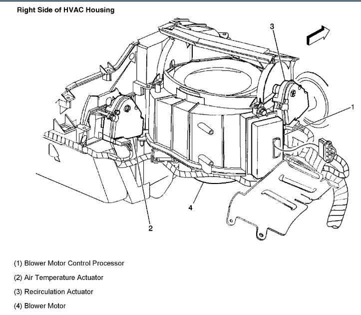

My A/C comes on but does not flow out the vents.
Monday, March 22nd, 2021 AT 2:22 PM (Merged)
DANNY L
  • 5,648 POSTS
Hello, I'm Danny.
It sounds like you are having a problem with the blend door/re-circulation actuator.It is mounted to the HVAC unit under the dashboard.It's an electrical motor that opens/closes doors to move air throughout the ducts. Here is a tutorial showing what is involved in it's replacement:
I've attached a picture below of its description.Hope this helps and thanks for using 2CarPros.
