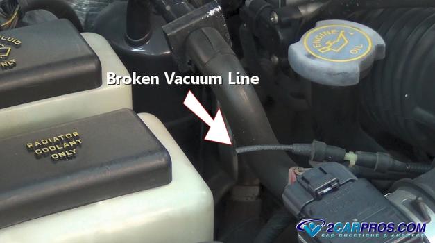

4. Check Vacuum Feed Line: If you have an older car, then the defroster system is controlled by using vacuum supplied by the engine. Lift the hood and inspect the vacuum hoses or tubes that feed vacuum from the intake manifold to the passenger's side firewall area. The image below shows a typical line break which causes the vents to stay in the defrost position.
broken defroster vacuum line

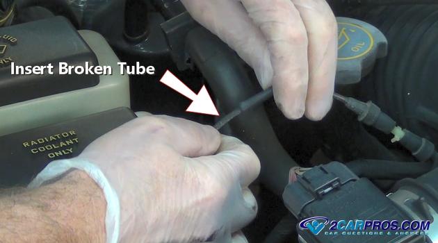

If a broken line is found, use the rubber vacuum tube to insert it over the broken part of the plastic tube.
insert rubber tube

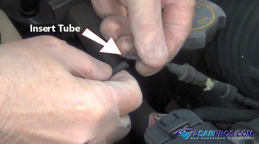

Locate the other end of the broken vacuum tube and insert in into the rubber vacuum line.
insert broken vacuum tube

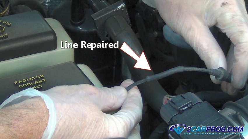

After both ends have been inserted into the rubber line, double check for other line breaks, this is a common problem with defroster issues.
defroster line repaired

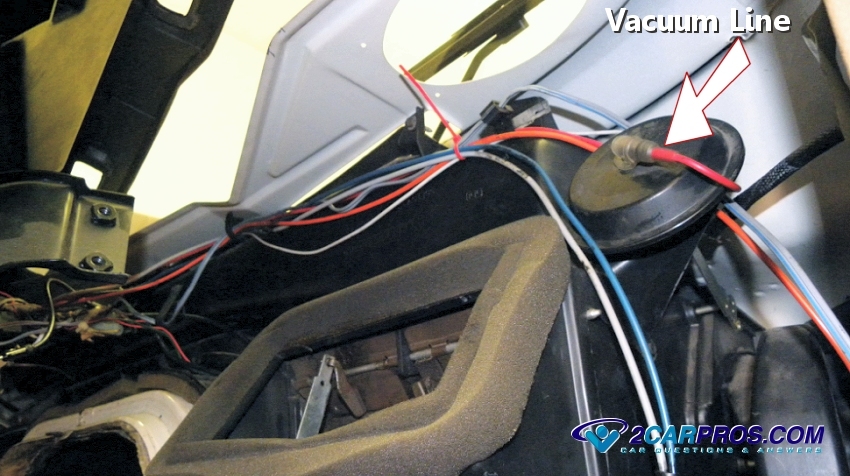

Vacuum lines travel from the vacuum control switch on the dash to vacuum servos under the dash. If you can hear an air hissing sound from under the dash then vacuum is escaping. This kind of system also uses a check valve which stores vacuum to help hold the defroster mode when travelling up a hill and engine vacuum is low.
defroster vent vacuum line
