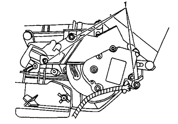

2004 Buick LeSabre Floor Vents Only
102,000 MILES • 3.7L • 6 CYL • 2WD • AUTOMATIC
TOM T-GUNZ RATH

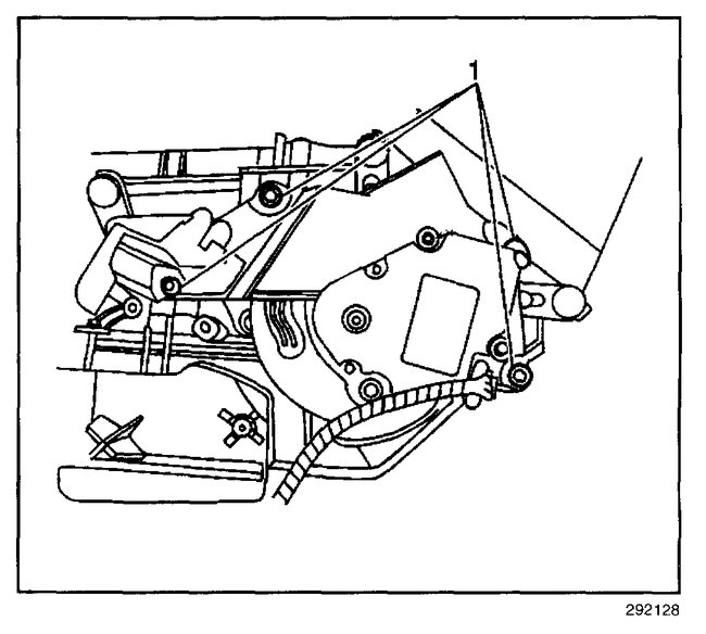

No matter which selection I make air only blows from floor vents. It will not blow through defrost or front vents. This is manual temperature control set up. Blend door actuator works (can change temperature). Please help, this is my wife's car and she is panicking because defrost won't work. Thanks in advance.
Mar 6, 2020 at 7:03 AM
  • 110,248 POSTS
It sounds like the mode door actuator has failed. The mode door is what changes air flow directions. I would remove it and check to see if it is operating when you change directions. If not, replace it. Here is a guide to help you step by step with instructions in the diagrams below to show you how on your car.
Here are the directions specific for your vehicle as far as replacement. The attached pictures correlate with the directions.
MODE ACTUATOR REPLACEMENT
REMOVAL PROCEDURE
1. Remove the left sound insulator.
2. Remove the knee bolster.
3. Remove the IPM.
4. Disconnect the electrical connector from the mode actuator.
5. Remove the mode actuator retaining screws (1).
6. Remove the mode actuator.
INSTALLATION PROCEDURE
1. Align the mode door levers with the cam slots.
2. Install the mode actuator.
3. Install the mode actuator retaining screws (1).
NOTE: Refer to Fastener Notice in Service Precautions.
Tighten
Tighten the screws to 1.4 N.m (12 lb in).
4. Connect the electrical connector to the mode actuator.
5. Install the IPM.
6. Install the knee bolster.
7. Install the left side sound insulator.
8. Recalibrate the actuator.
If you look at the last pic, it shows location.
Check out the diagrams (Below). Let us know what happens and please upload pictures or videos of the problem.
Mar 6, 2020 at 1:13 PM
TOM T-GUNZ RATH
Thank you Joe. That is exactly what it was. Removed the actuator, started the car, turned on the air, manually moved the doors to make sure air changed between vent, defrost and floor and it did. Now just need to install the new actuator. Thank you so much. You saved me approximately $300.00.

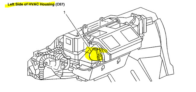

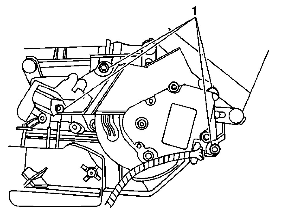

Good evening,
Good chance the mode door actuator is the issue. I attached a picture and the procedure for you to view.
3. Remove the IPM.
Mar 22, 2021 at 7:21 AM (Merged)

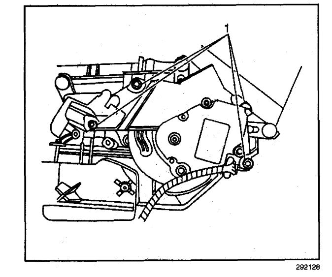

Good afternoon,
Most likely the mode door actuator has failed. It is under the dash and easy to access.
I attached the procedure and a picture for you to view.
3. Remove the electrical connector from the mode actuator.
4. Remove the mode actuator retaining screws (1).
5. Remove the mode actuator.
1. Align the mode valve levers with the cam slots.
Tighten
Tighten the fasteners to 1.4 N.m (12 lb in).
5. Install the knee bolster.
6. Install the left side sound insulator.

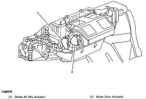

PATRICK CALLAGHAN JR.
  • 9 POSTS
The mode door actuator is not working. I know it has to come out but I cannot figure how to access it. I can only get my finger tips in there. It is number 2 in the diagram. The actuator seems blocked by the dash structure.

Are you sure you are on the correct actuator?
Is this auto climate control?
  • 9 POSTS
Yes, it is the CJ2 dual zone climate control. It is #2 in my attached picture.
Okay, that's the issue.
For the auto climate control, the actuator is at the top of the housing where you cannot access it without removing the dash cluster. It has to be moved forward to get to the actuator.
Is this something you will be doing yourself?
  • 9 POSTS
It is on the side per my attached drawing. I got it out and bench tested it and it worked. so now back to square one.
What drawing?
  • 9 POSTS
My original post. I attached a diagram. It shows the actuator.

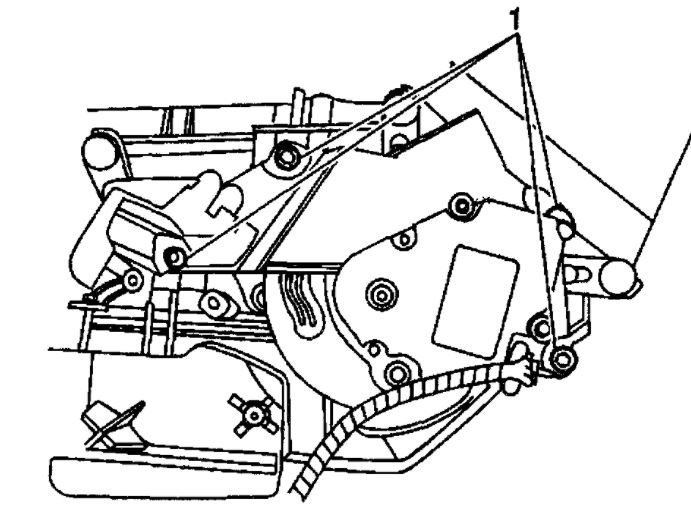

DAMEIDASH34
I need to know how to locate and fix my mode door actuator.
Mar 22, 2021 at 7:22 AM (Merged)
  • 110,248 POSTS
Welcome to 2CarPros.
Here are the directions for replacement. It is located under the dash on the HVAC box. See the pictures for location.

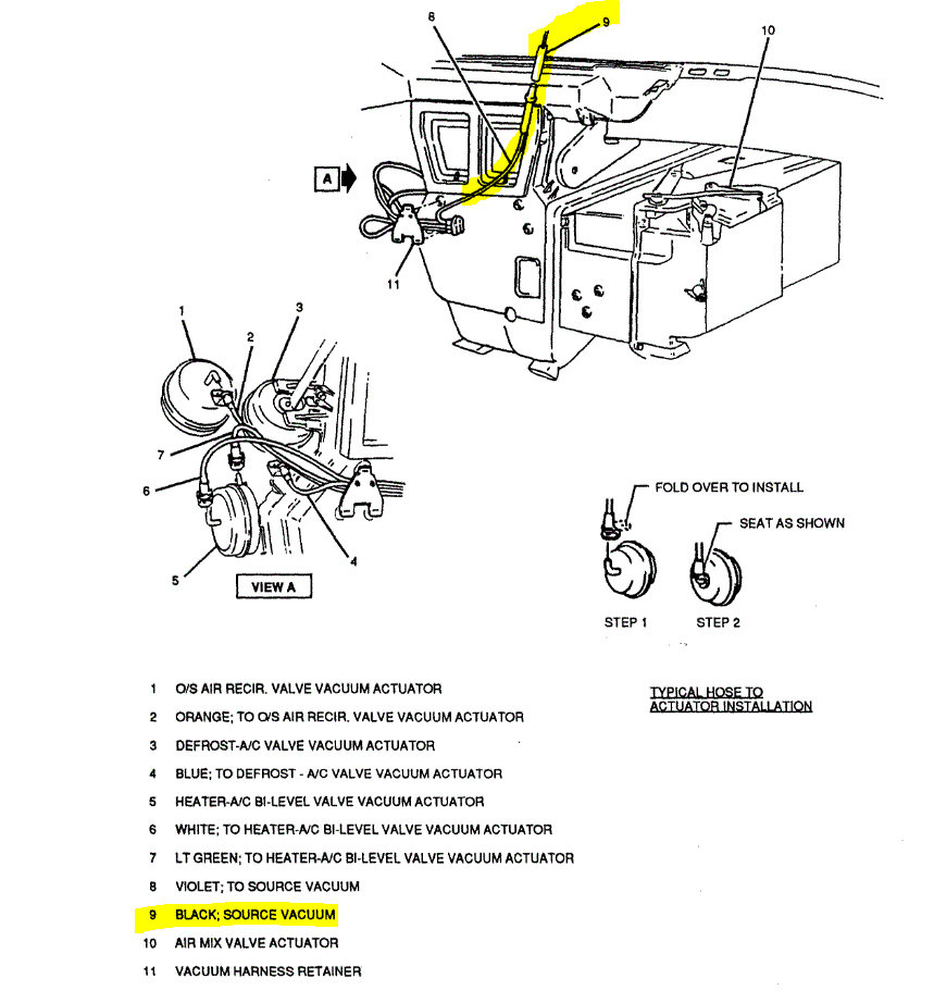

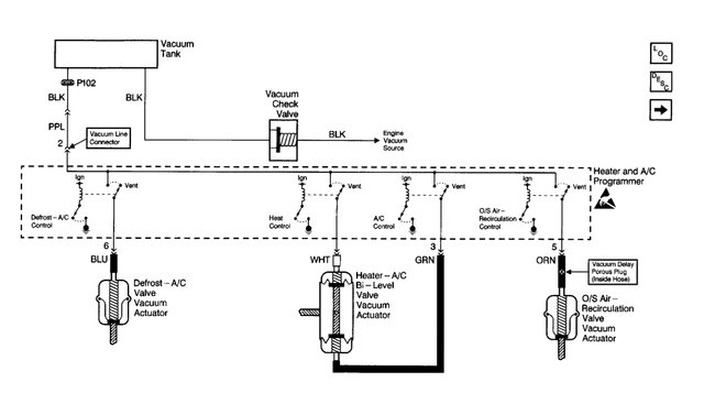

  • 110,248 POSTS
The air flow direction is controlled by what is called a mode door actuator. On this vehicle, all actuators are controlled via engine vacuum which is supplied from the engine intake manifold via a black vacuum hose. That hose connects to the rear of the controller in the vehicle where you select air flow directions. Then, based on your selection, engine vacuum is routed to the different mode actuators which open and close different doors allowing the air to flow in different directions.
_________________________________________
Since you are getting air at both the defroster and the floor, I suspect the vacuum supply from the engine has failed. In most cases, the plastic hoses crack and break off. So what I need you to do is simply craw under the dash and locate the vacuum hoses to the rear of the controller. Locate the black supply hose and remove it from the controller. Start the engine and place your finger over the end of that black hose to see if there is a vacuum (suction) available from the engine. If there isn't, we will need to locate where the break has happened.
__________________________________________
I attached a pic below that shows the different actuators and vacuum lines. Note that I highlighted the supply. That is the black one you need to check.
LIPS81
Would it have anything to do with the plastic cover over the blower motor?
  • 110,248 POSTS
I'm not sure what you are referring to. Are there vacuum hoses going to something at that point? If it is just a cover, I don't see how that would cause this.
