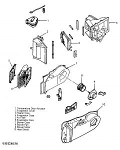

1993 buick lesabre 113000 mi.
How do you get at the A-coil to clean? The fan blows good, but not much air comes out of heater,defrost, or vents. I think the A-coil is blocking the fiow,but i don't know how to get to it to clean.
Thanks in advance!

If you are askig haow to clean the evaporator core, You'll need to remove it...

Please answer the question, How to get to it to remove it.
Thanks

First discharge the a/c system then disconnect the accumulator and the evap core under the hood, locate the bolts that go thru the firewall then split the case! This is a lot of work to try and clean an evap core, first check for a cabin air filter! remove the cowl under the wipers and check for a filter...
