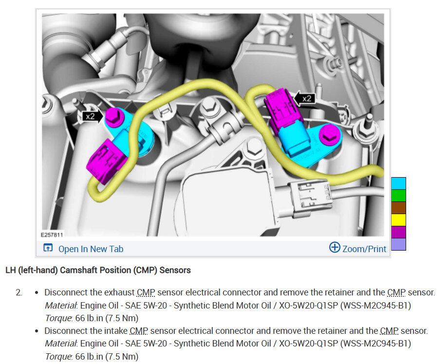

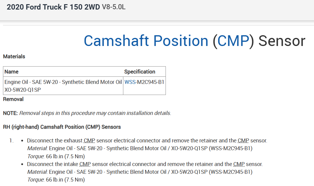

I need to know for the truck listed above XL model super crew, where the Camshaft Position Sensor B Location is on the driver side is. I can’t seem to find any information on it on the internet. I’m getting code P0390.
Jan 10, 2025 at 12:02 AM
  • 55,743 POSTS
P0390 - Camshaft Position Sensor "B" Circuit (Bank 2) The P0390 code on your 2020 Ford F-150 indicates an issue with the Camshaft Position Sensor (CMP) "B" on Bank 2.
Yes, there are two sensors for the camshaft which are on the rear of the valve cover. I need to tell you though it might not be the sensor, these engine had problems with the camshaft phasers, also I would make sure the engine oil is clean and full, if not change the oil a filter and clear the code and it might go away. The sensors are on the left side of the engine toward the rear of the valve cover. If you change the sensors make sure to clear the codes once the job is complete. Check out the images (below). Let us know how it goes.
