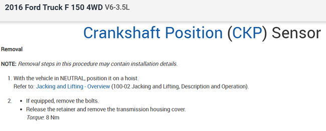

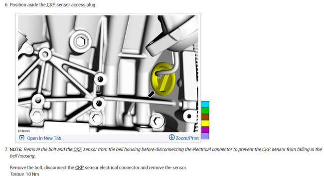

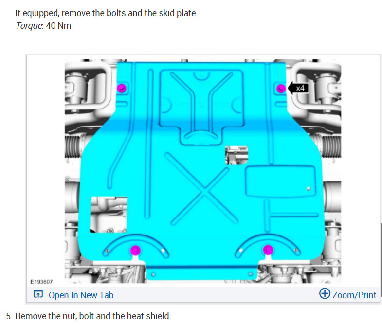

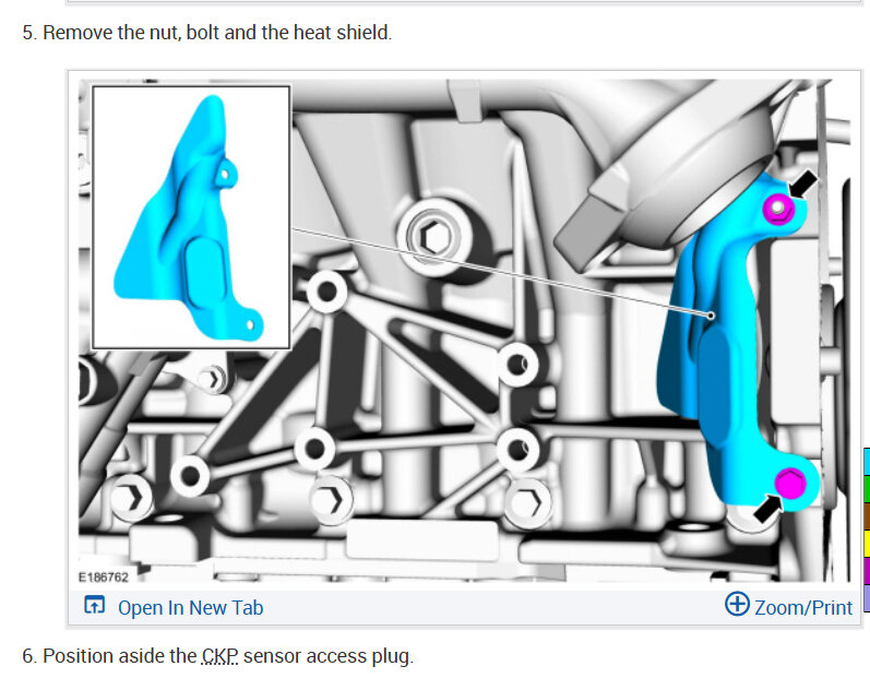

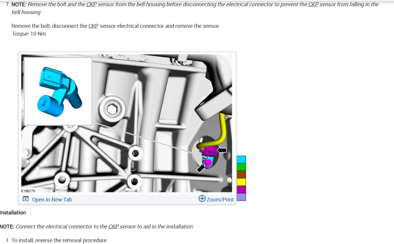

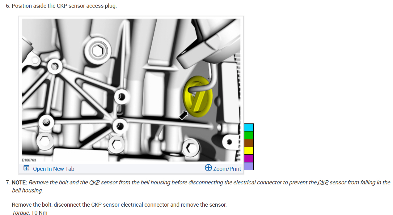

Trying to locate the crankshaft position on the truck listed above eco-boost.
Jan 14, 2025 at 1:17 AM
  • 55,443 POSTS

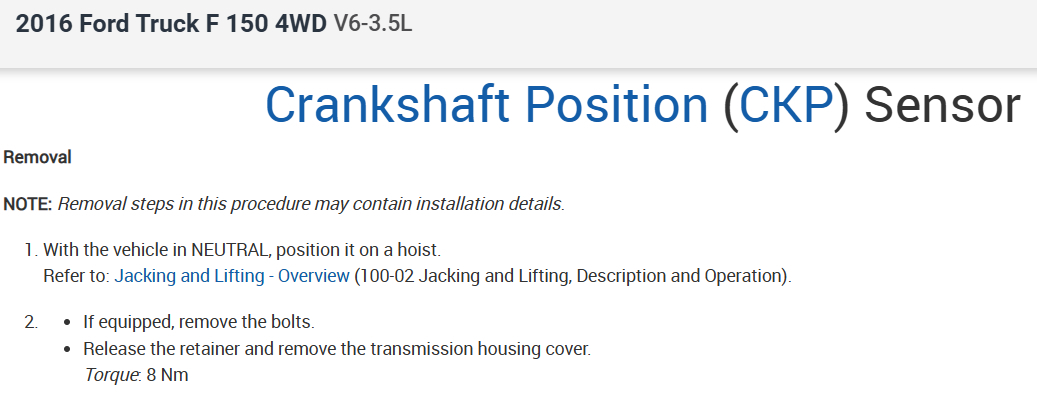

Yep, they hide it from you on this truck, the crankshaft sensor is inside of the access port for the torque converter bolts which is on the left side of the engine down at the bellhousing. You will need to remove the skid plate and a bracket to get at it. Here is how the job is done and the location of the sensor. Check out the images (below). Let us know if you need anything else.

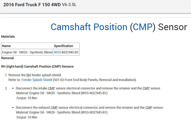

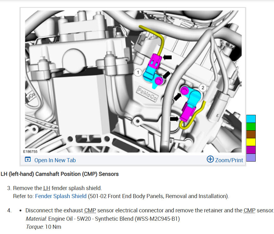

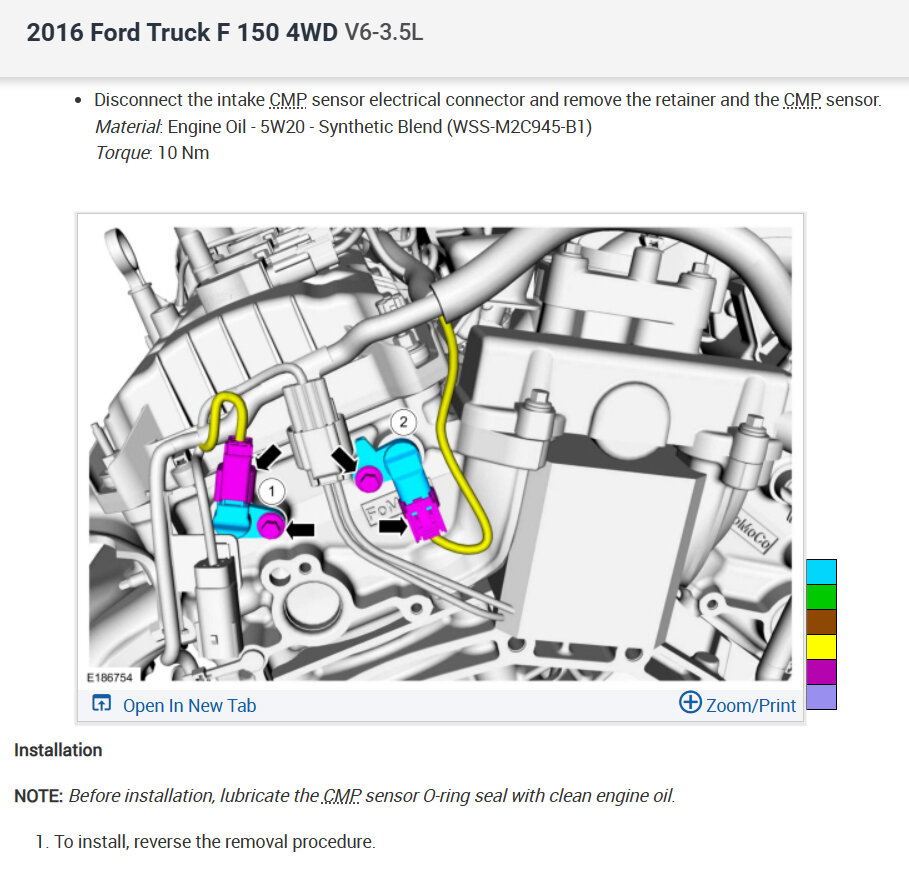

I need a diagram of the crankshaft and camshaft position sensor for a 2016 Ford F150 3.5 L eco-boost.
Jan 14, 2025 at 8:17 AM (Merged)
  • 55,443 POSTS

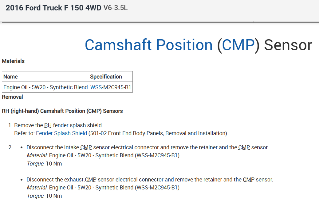

My bad, here is the camshaft sensors as well. They are at the rear of the cylinder head. Check out the images (below). Let us know if you need anything else.
