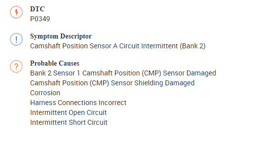

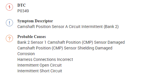

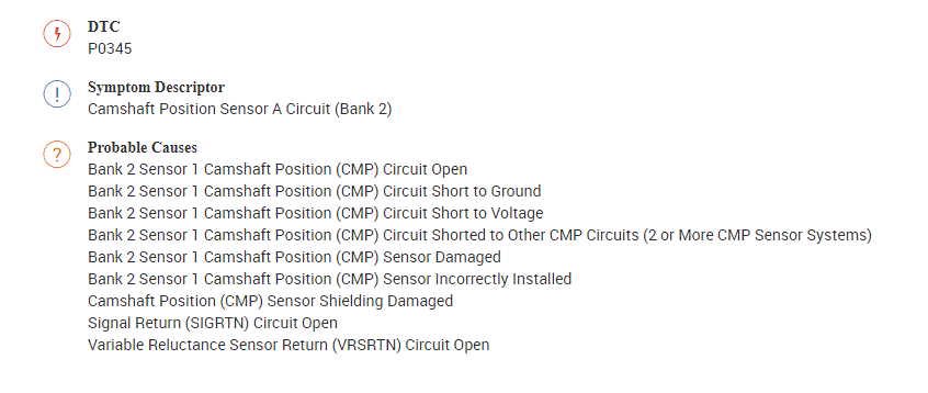

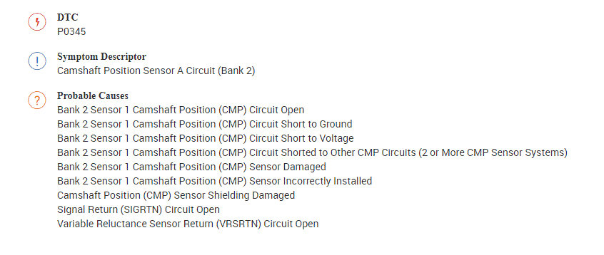

Good afternoon y’all, trying to find the Camshaft Position sensor A bank 2 location. Would really appreciate your help in locating this so I can fix it. I’m getting a P0345 and P0349 code on my scanner.

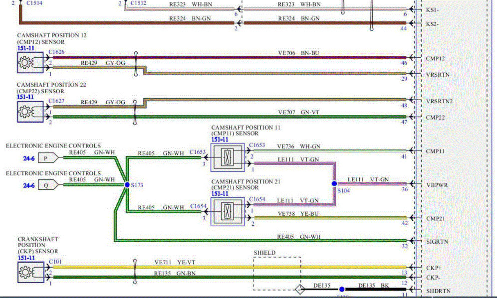

I attached the possibilities for you below as well as the procedure for the cam sensor.
Check the voltage to the sensor as well. You need 5 volts with the key on.
The sensor is on the back of the left cylinder head. There are 2. If I were you, I would replace both while you are there.

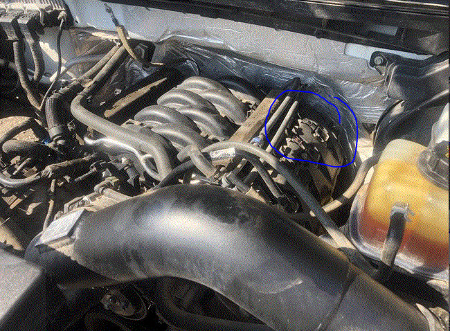

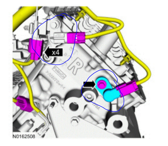

Thanks! So if I’m looking at the engine from the front of the truck that bank two sensor A is which side? That’s a thing I can’t seem to find it looking at the engine if you could have a diagram etc., of the engine and a indication of where it is located that would be great. The dealer replaced the sensor the other day. And then the check engine light came on again so he’s ordered a pigtail wiring etc. The dealership is an hour away from me I’m just trying to see if I could mess with it just to get it to work so my truck doesn’t drive badly.
Oct 9, 2020 at 6:17 AM

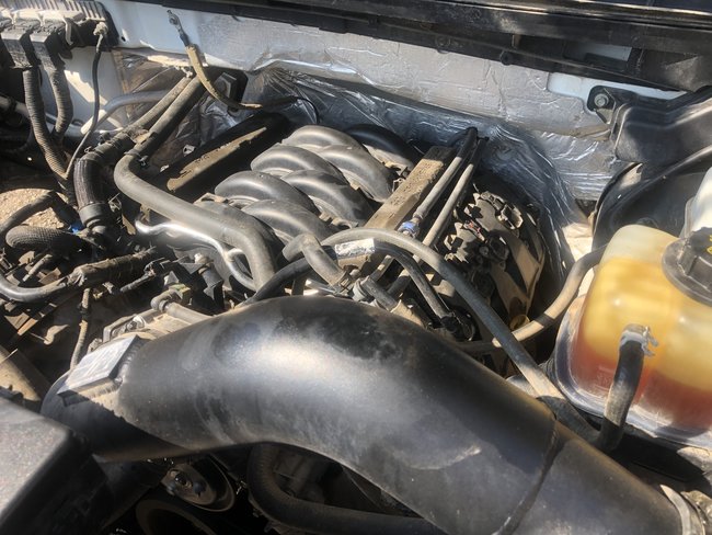

Drivers side is the location.
I attached a picture already. The left side is the same. It is on the very back of the head and not easy to access.
I lay across the top of the engine to get back there.

So is it in the very back by fire wall? If you could circle the location on my picture. Thanks for your help.
Oct 9, 2020 at 7:01 AM
I attached a picture and circled the sensors in my previous responses.

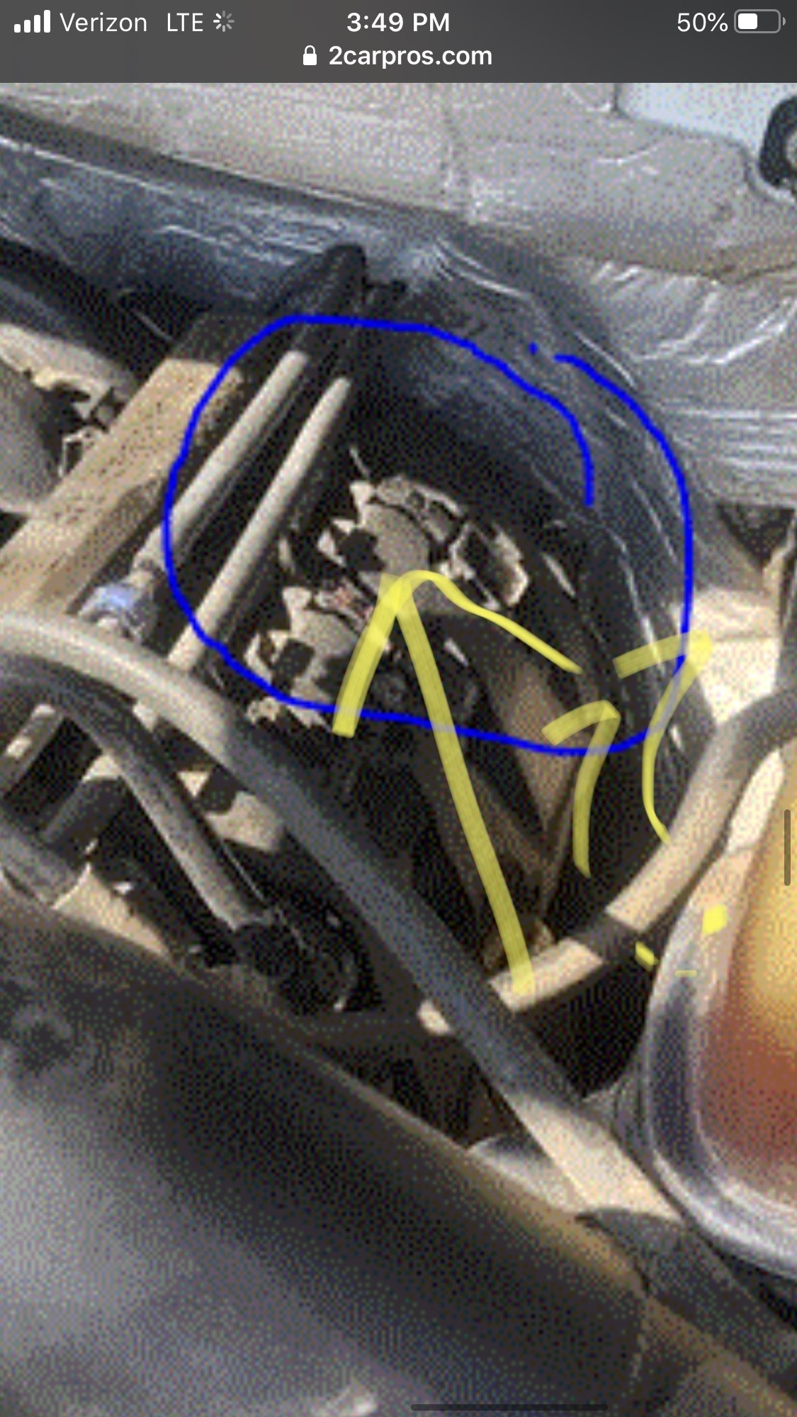

Thanks for your replies. So where I’m pointing out here with the yellow arrow is that it?
Oct 9, 2020 at 7:51 AM
No, the sensors are in the back of the head by the firewall. See the picture I posted and they are on the back of the head.

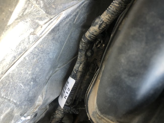

So, this right here “wire” how the heck do I get to it is there easier way? I just want to unplug the sensor clean it off and plug it back in just to see if that works before I go to my car dealership appointment on Monday.
Oct 9, 2020 at 8:29 AM
Yep, that is where they are.
The instructions tell you to get it from underneath as I posted.
I was able to get them from the top by laying on the motor and moving the harness out of the way.
