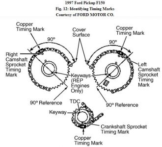

timing chain marks?
1997 FORD F-150
PSTAG
Have replaced right head gasket and didn't precheck timing marks. 4.6L may be 96 model left over, as to coolant tube under intake. Have 98 book and timing marks are different. Any suggestions?
Apr 12, 2009 at 3:13 AM
KHLOW2008
  • 41,814 POSTS
Hi pstag, Is this the correct diagram?
https://images.2carpros.com/forum/automotive_pictures/192750_TimingMark97F150_1.jpg
There are 2 different engine model, (eighth character of VIN Code) Windsor Engine Production (WEP) , VIN Code = 6 Romeo Engine Production (REP), VIN code = W
