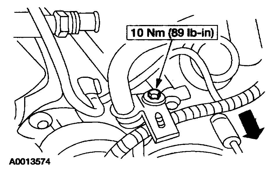

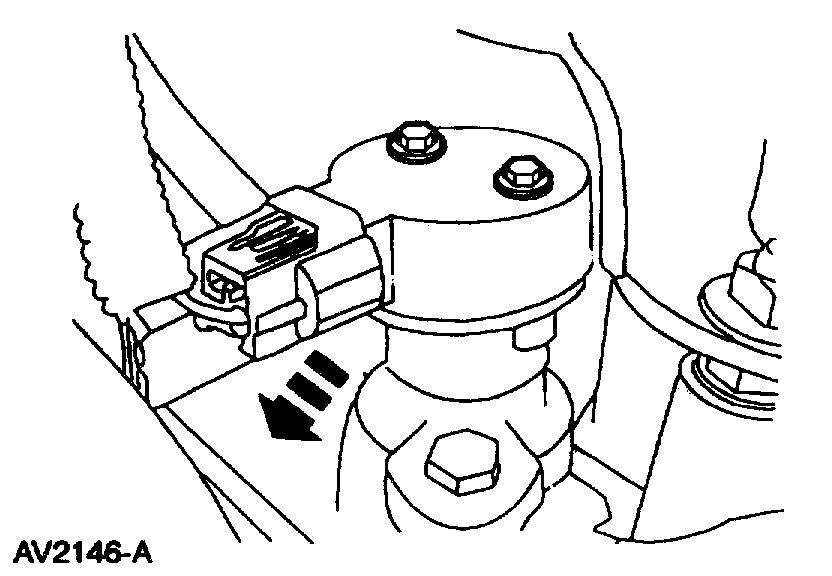

Where is it located exactly on my truck?
Aug 21, 2020 at 5:53 PM (Merged)
  • 110,194 POSTS
See picture 1 for location.
___________________________________

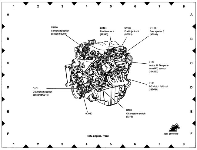

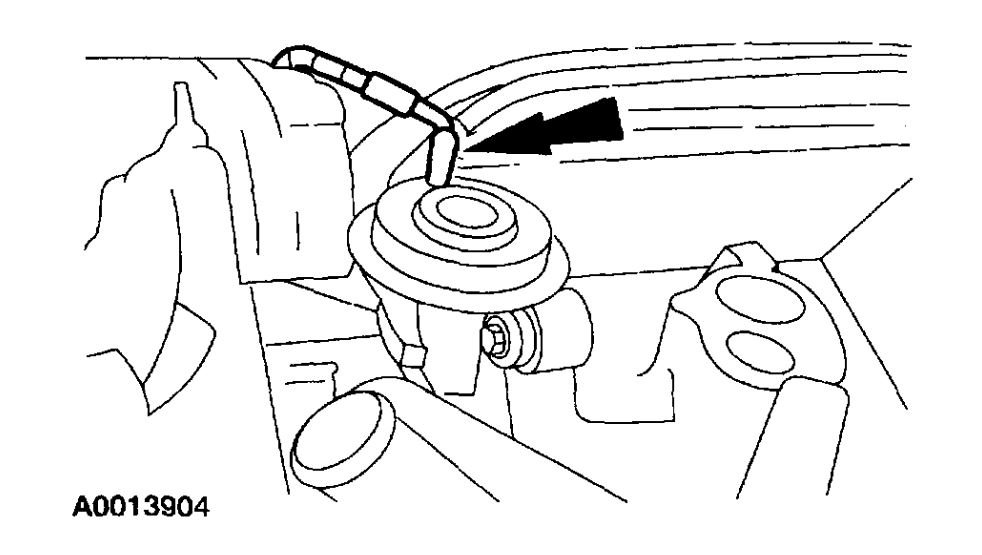

Here are the directions for replacement:
CAMSHAFT POSITION SENSOR
REMOVAL
1. Disconnect the battery ground cable.
2. Partially drain the cooling system.
3. Remove the air cleaner outlet tube.
See picture 2

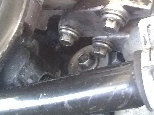

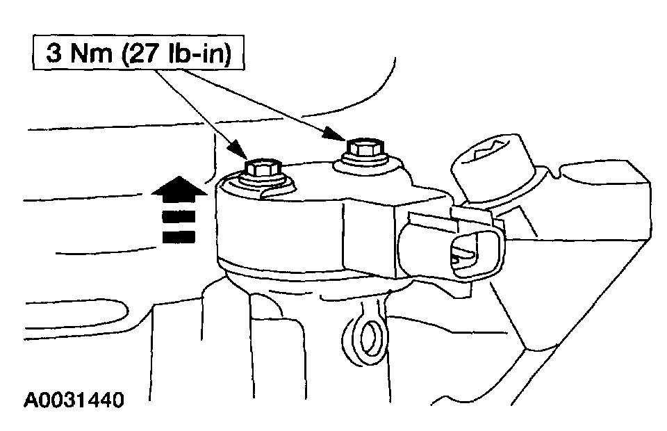

4. Disconnect the engine harness from the water tube, remove the bolt and position the heater water outlet tube aside.
See picture 3

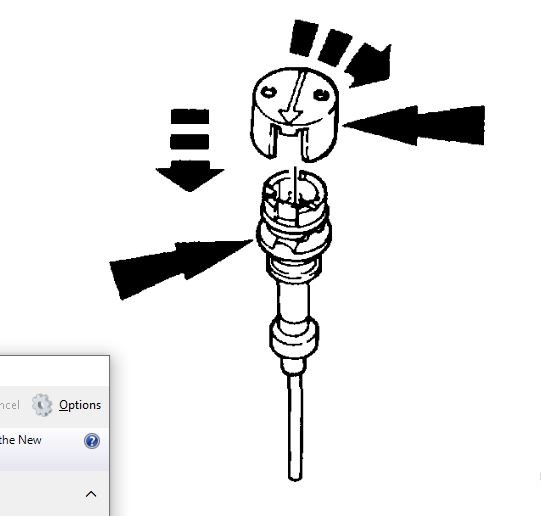

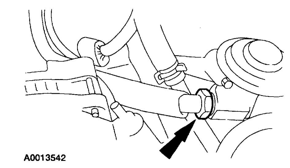

5. Disconnect the Camshaft Position (CMP) sensor electrical connector.
See picture 4
6. Remove the screws and the CMP sensor.
INSTALLATION
1. To install, reverse the removal procedure.

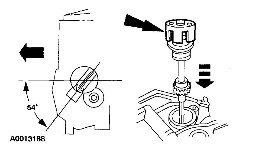

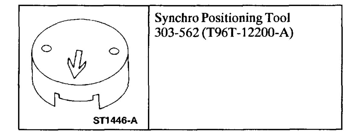

Procedure.
INSTALLATION
CAUTION: The Syncro Positioning Tool must be obtained prior to installation of the new camshaft synchronizer assembly. Failure to follow this procedure will result in the fuel system being out of time with the engine, possibly causing engine damage.
1. Install the Syncro Positioning Tool on the camshaft synchronizer by rotating the tool until it engages the notch in the camshaft synchronizer housing.
CAUTION: A Syncro Positioning Tool must be used during the installation of the new synchronizer assembly. Failure to follow this procedure will result in the fuel system being out of time with the engine, possibly causing engine damage.
2. Install the camshaft synchronizer housing assembly so the arrow on the synchronizer alignment tool is 54 degrees from the centerline of the engine.
NOTE: During installation, the arrow on the synchronizer alignment tool will rotate clockwise as the gears engage.
3. Install the bolt and remove the Syncro Positioning Tool.
NOTE: Do not remove the Syncro Positioning Tool until the bolt is tightened.

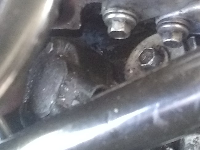

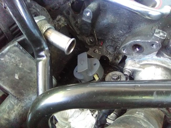

While working on my truck listed above 4.2 v6 I noticed that one of the electrical connectors to some type of sensor the wires were showing. so I cut it off to replace it and somehow I lost it and wasn't sure the part that it was connected on to. I've been looking into books and everywhere online I can't find what that was that was connected to. finally I just decided to take it off and then take it to the auto parts store so I can get the correct connector for it and realized later that it was a camshaft position sensor. I did not totally remove it from the vehicle but I lifted it up and kept trying to pull it out but can't get out of course, but I want to know what damage I've done? is my engine going to start ?is it going to cause worse damage to the motor it if I try starting it? what should I do? I bolted it back down to where I think it was but I'm not quite sure. please tell me what I need to do. Do I need to take take it all apart? Should I not attempt to start it or what? Please help!

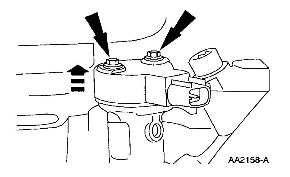

Good evening,
You need a pigtail for the cam sensor. You ask for that at a parts store.
As far as the sensor, it is held by 2 small bolts. I attached a picture for you to view. Is that what you tried to remove?
GINALANGSTON1
  • 66 POSTS
No,I tried to remove the whole camshaft position sensor. that that electrical part is bolted on top of . Without first marking it's location . What do I do now?
Did it come all the way out?
The top part is the sensor.
How did you make out?
GINALANGSTON1
  • 66 POSTS
I have not done anything yet. So I have to basically take my whole engine apart to do this? Such as to remove the crankshaft pully, oil pan, oil pump, radiator and get to the timing chain and all that? I didn't completely take it out because the EGR valve was in the way,does that matter? Also how do I donatemoney to you guys? I did it before a few times but can't remember how.

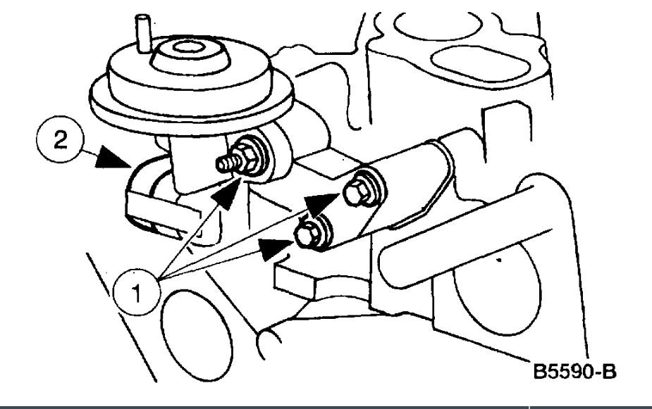

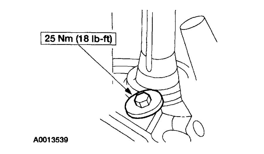

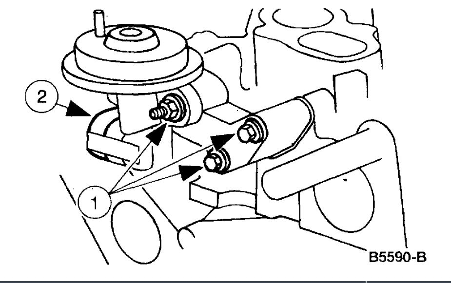

Okay, no, the engine does not have to come apart. You need to remove the EGR valve to get the syncronizer out for reset.
REMOVAL
1. Rotate the crankshaft until the No.1 cylinder is at Top Dead Center (TDC) of the compression stroke.
CAUTION: Do not turn the crankshaft or camshaft during the removal and installation procedure or the fuel system timing will be out of time with the engine and possibly cause engine damage.
2. Remove the camshaft position sensor. For additional information, refer to Camshaft Position (CMP) Sensor.
3. Disconnect the Exhaust Gas Recirculation (EGR) valve vacuum hose.
4. Remove the EGR valve tube upper fitting.
5. Remove the EGR valve and adapter.
1 Remove the nut and the bolts.
2 Remove the EGR valve and adapter assembly.
6. Remove the bolt.

Okay,
1. If the gear came away from the camshaft, then it has moved and needs to be reset.
2. If the unit went back down into place flush as it was before, then it is engaged in the oil pump.

Okay this is where I am at. I pulled the Fuel rail back off to check the seating of the Injectors and the rail itself did push them down a bit, the bottom tips of each one are in the holes. Now on the Synchronizer I rented the tools there were 1black, 1 yellow, 1 gray and I think 1blue,. Anyways I used the Gray. This is all I did though please tell me if I need to do more or if it is Good. Okay I removed the camshaft positioning sensor and tried each color tool, not any of them went on it so I put the sensor back on and then I "loosened " the large bolt and Washer and just turn the whole Synchro and housing slightly until I got one of the tools to fit down on it properly (which was the Gray one. I then tightened up the big bolt and put the sensor back on it. . I never attempted at all to lift the Synchronizer out. So is that okay now? Do I need to do anything more to it? Am I now TDC?
The top dead center is from the engine. You need to remove number 1 cylinder and hand turn the motor until the piston is at top dead center. You have to remove the spark plug to do this.
You may be good if the gear did not come off the cam gear.
