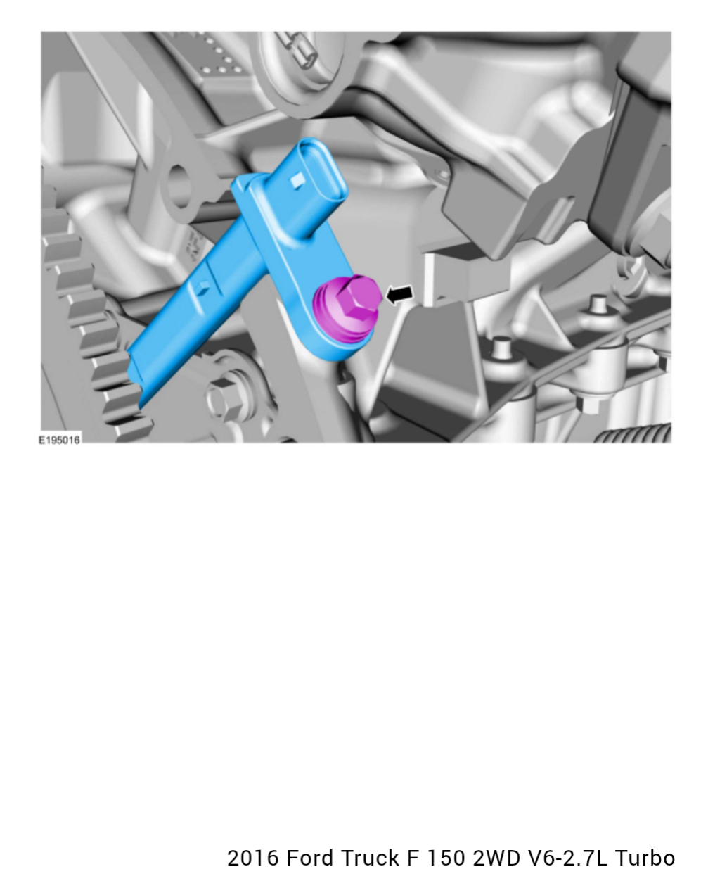

I can't seem to locate the crankshaft position sensor on my 2016 f150 2.7L ecoboost engine. There's tons of literature and videos for the 3.5 but not for the 2.7 and they are not the same. Can anyone tell me, with certainty, where this sensor is located? I have the replacement in hand ready to go. Thanks in advance

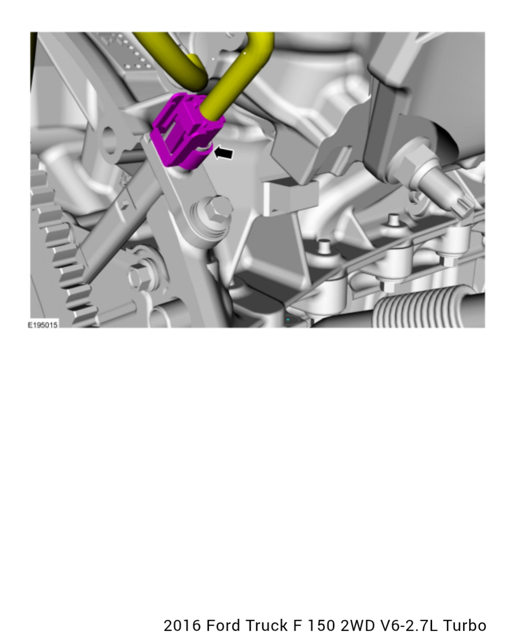

Ur is behind the right hand fender splash shield. Removal and Installation instructions are below. Photos attached as well.
Removal
NOTE: Removal steps in this procedure may contain installation details.
Remove the RH fender splash shield.
Refer to: Fender Splash Shield (501-02 Front End Body Panels, Removal and Installation).
Disconnect the CKP sensor electrical connector.
Remove the retainer and CKP sensor.
Torque: 10 Nm
Installation
To install, reverse the removal procedure.
Using the scan tool, perform the Misfire Monitor Neutral Profile Correction procedure, following the on-screen instructions.
