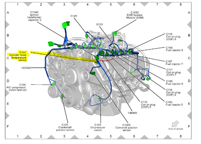

Cylinder head temperature sensor and putting the engine as overheating. Coolant tank is full no leaks. Changed the oil last week. (Jiffy Lube) Just put gas in the truck drove 1/4 mile parked at a restaurant picked up food got in the truck it sputtered during the start but it did start. Drove about 3 miles engine light came on and radiator light. The truck then cut back on power. Is the sensor under intake manifold?
Oct 5, 2019 at 5:34 AM
BMDOUBLE
  • 1,139 POSTS

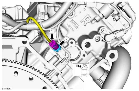

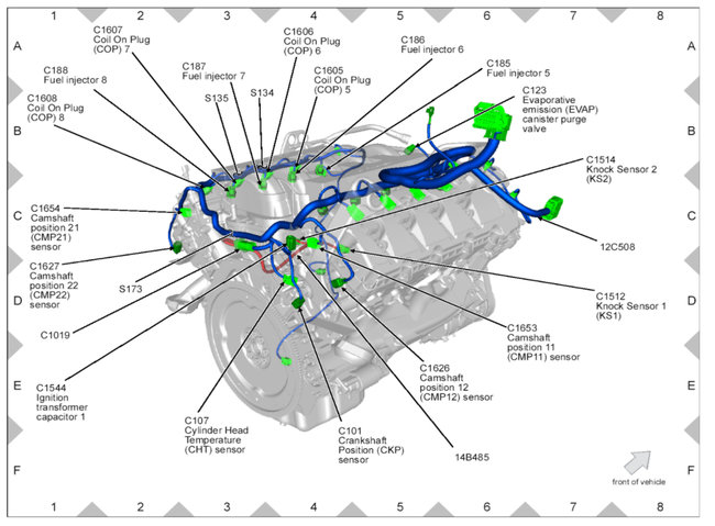

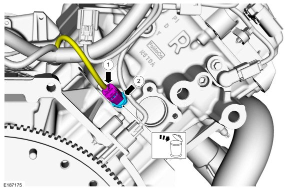

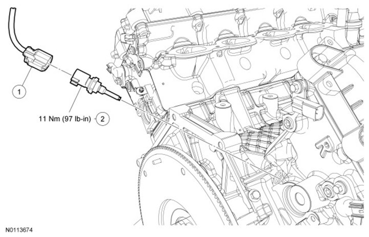

It’s on the back side of the passenger side head. The best way to get at it is through the passenger side fender well and removing the fender liner for easier access and fewer curse words, lol. Also inspect the connector and the wiring for rodent damage! I’ve done lots of them for chewed up wiring. Check out the diagrams (Below). Please let us know if you need anything else to get the problem fixed.

WAYNE1963
Where is my cylinder head temperature sensor located?
May 6, 2021 at 12:01 PM (Merged)
Picture attached.

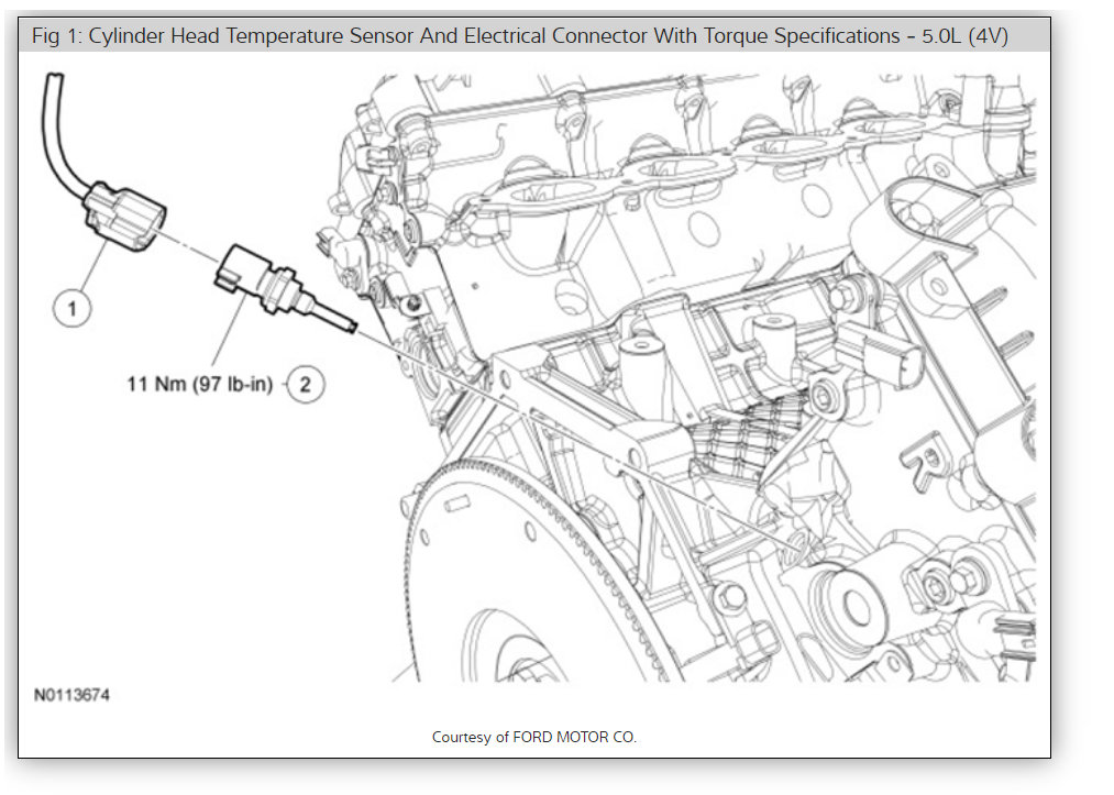

Having a tough time getting the deep sockets i have over the fitting.

Never mind, and thanks for all your help with the diagram, found it impact socket that would work.

The cylinder head temperature sensor is mounted at the rear of the passenger side cylinder head. To replace it you'll need to remove the passenger side fender splash shield for access, disconnect the sensor and unscrew the sensor. reverse for installation.

OLVERAMANUEL62
Where is it located?
May 6, 2021 at 12:03 PM (Merged)
Good afternoon.
The sensor is on the rear of the drivers side cylinder head. Here is a guide to help you see step by step what to do with diagrams below to show you on your truck. Check out the diagrams (Below). Please let us know if you need anything else to get the problem fixed.

You are correct, sorry. That was me.It is on the back passenger side of the motor. Sorry, I took a quick look and thought it was the front.

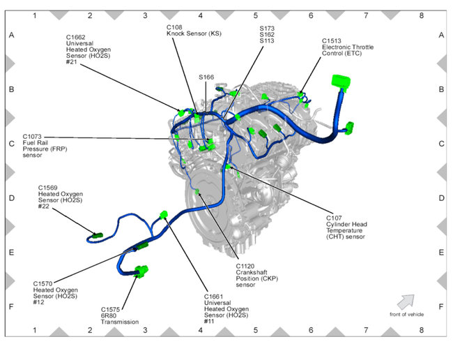

On 3.5L Ecoboost, it is on the passenger side above the flywheel housing. You can get to it from the top of the engine. I had to lay on the engine and reach back there to get to it. Or you can remove the wheel well liner to get behind the engine. I did it both ways it was easier to screw it back in, from the wheel well.

Yes, Roy. Your diagram was very helpful. I couldn't get behind the engine so I used my phone to video the exact location then replaced it. It needs 3/4 deep well socket. I don't get the "Engine Coolant Overtemperature" warning anymore and temperature reading is stable.

Here are some diagrams to help you see for yourself where the sensors are I have included all different engine for that turck so anyone coming to this post can be helped.

LEROYBUBBA
Where is the cylinder head sensor located?
PATENTED_REPAIR_PRO
  • 1,853 POSTS

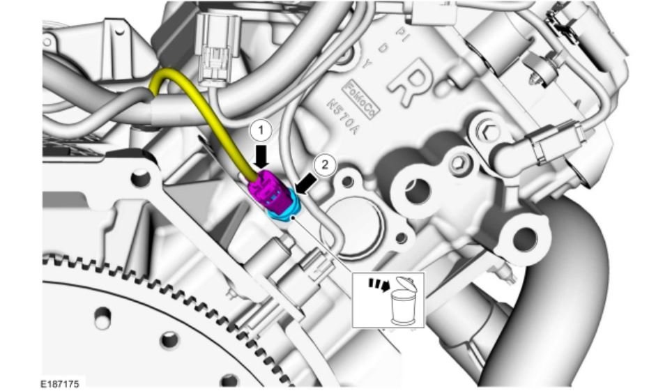

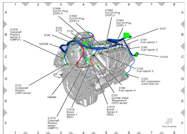

At the rear of the right cylinder head back near the flywheel/flex plate. Here is a diagram and a guide to help you step by step with diagrams BELOW to show your coolant sensor location.

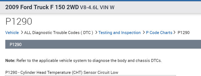

CRAB69

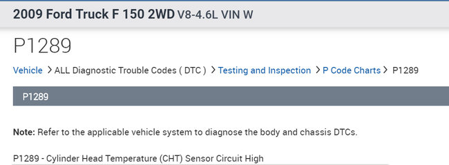

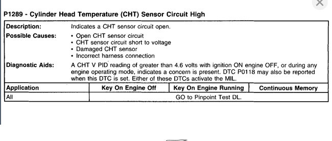

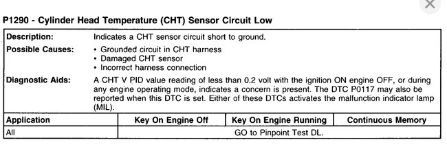

I have error codes P1289 and P1290; high input and low input.And is it fairly easy to replace?Thank you for your time,chuck
May 6, 2021 at 12:04 PM (Merged)
LEROYBUBBA
SCGRANTURISMO
  • 4,897 POSTS

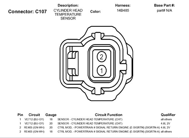

I have included the information that you requested in the diagrams down below. I have also included diagnostic information on DTC's P1289 and P1290 as well. Please go through these guides and get back to us with what you are able to find out.
