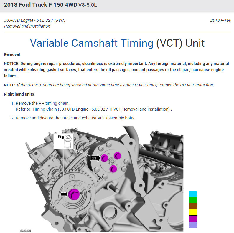

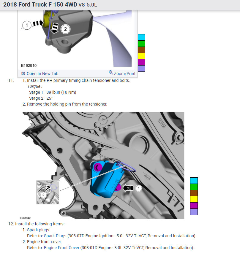

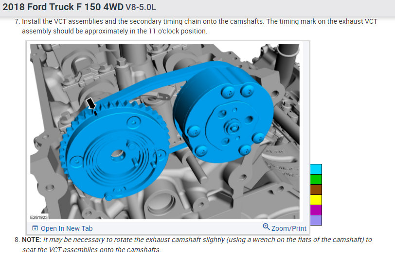

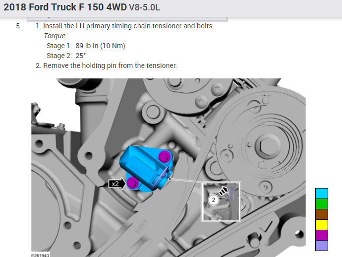

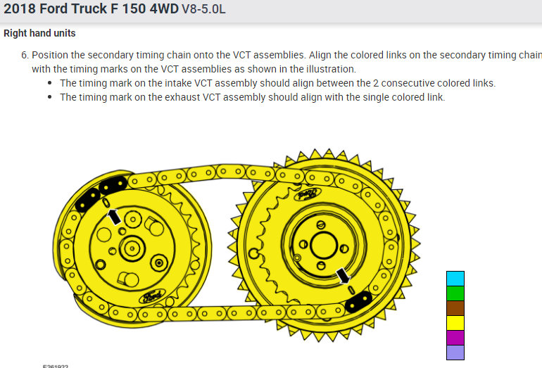

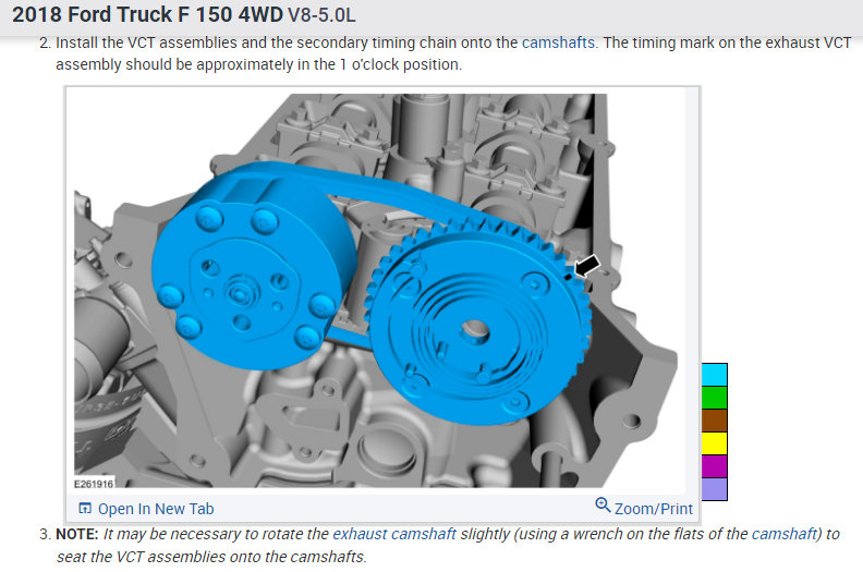

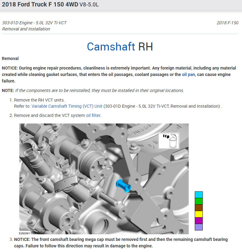

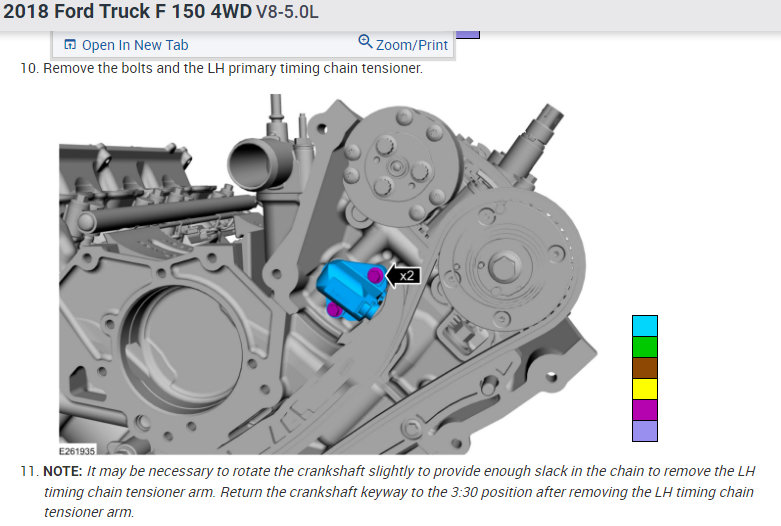

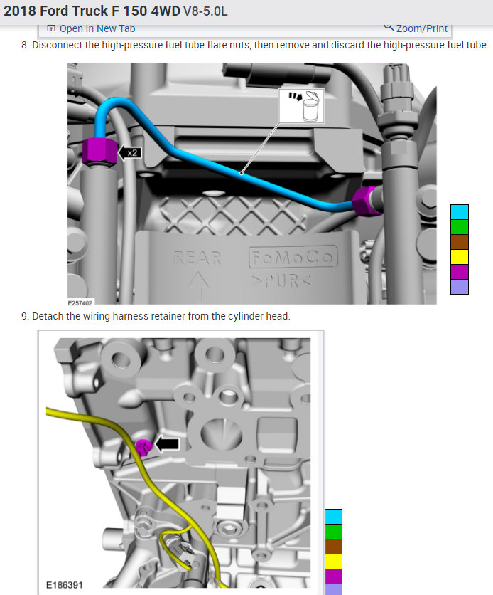

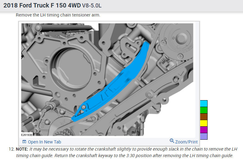

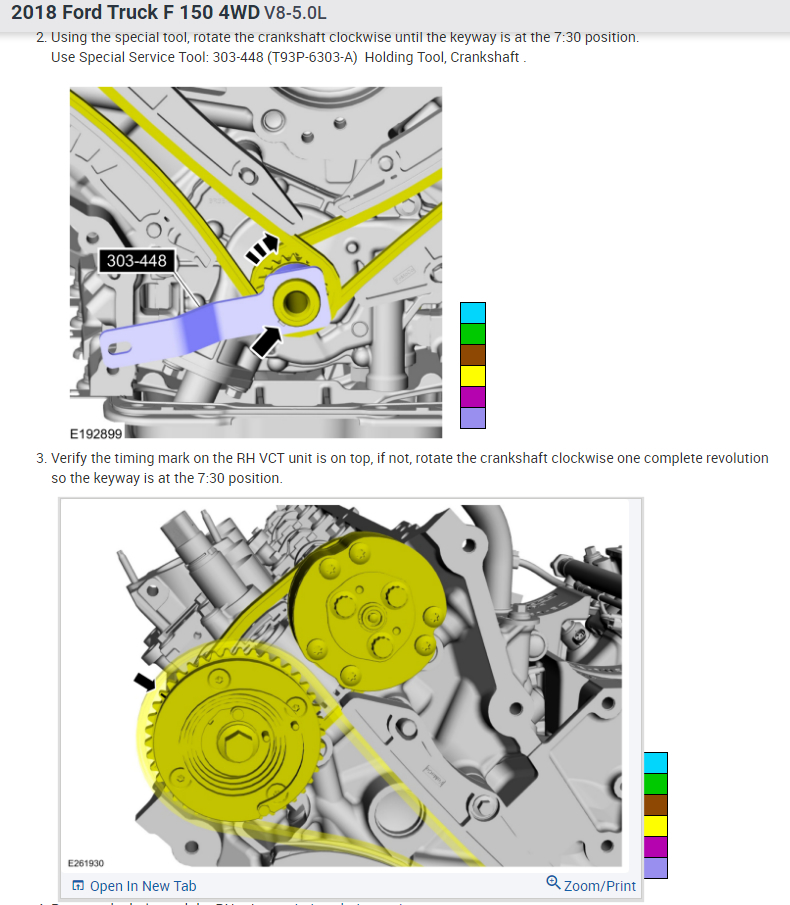

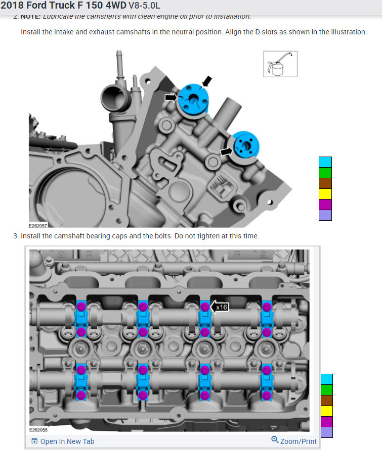

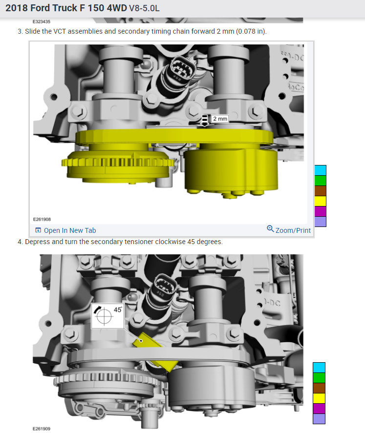

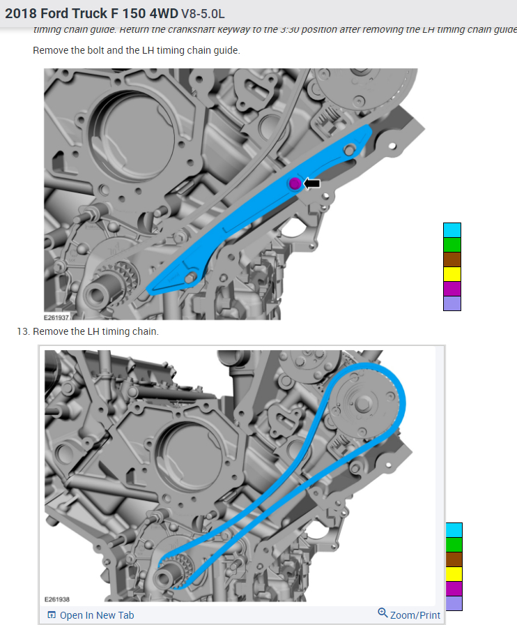

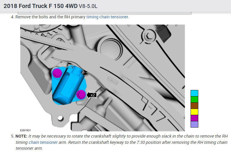

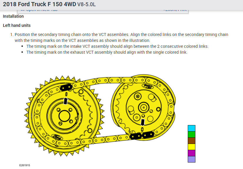

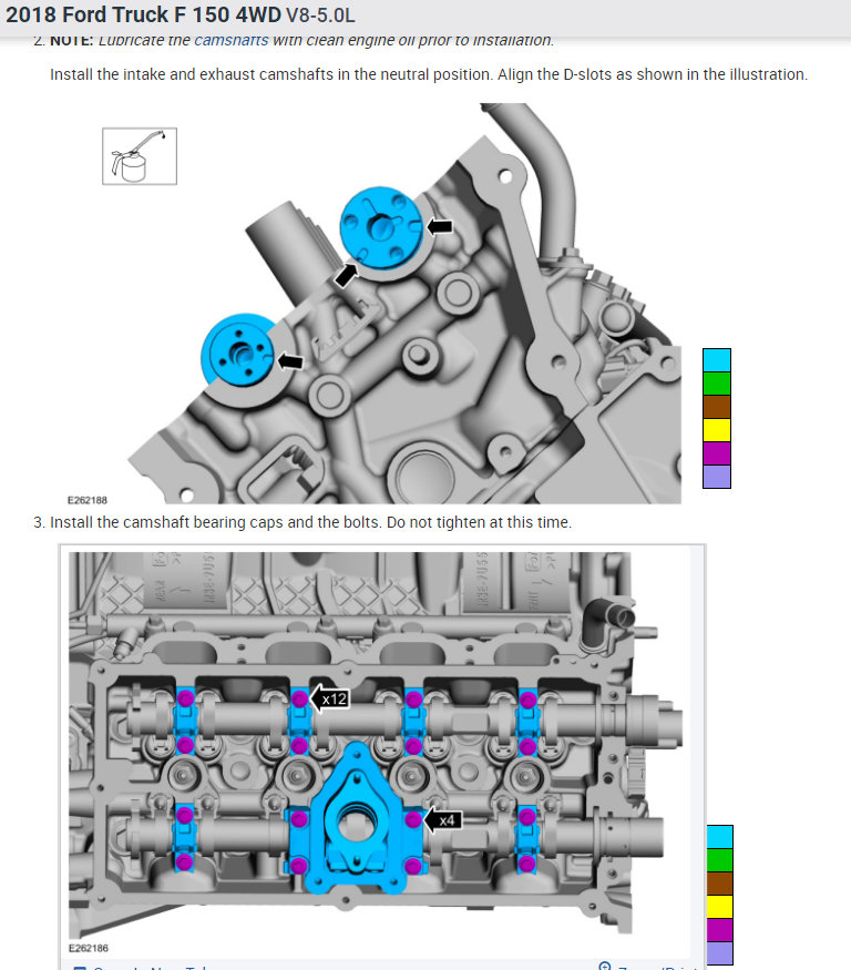

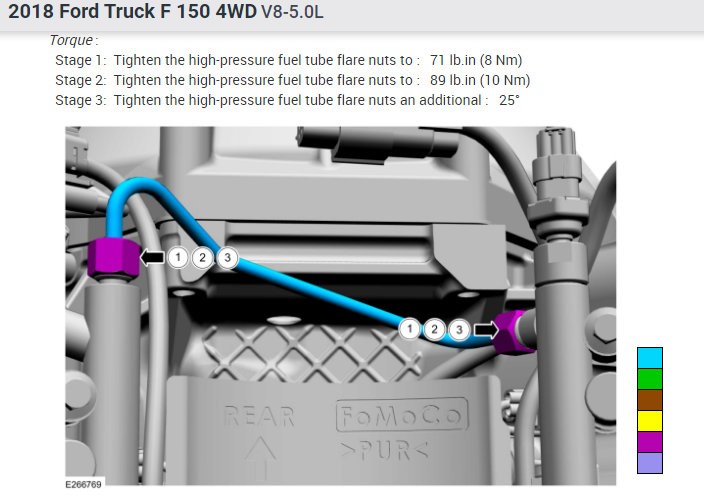

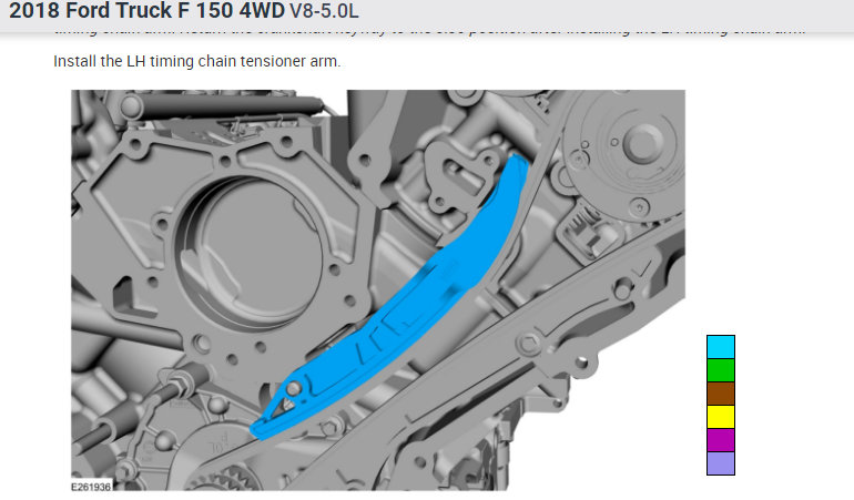

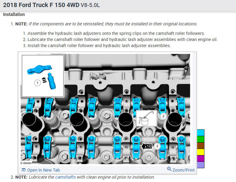

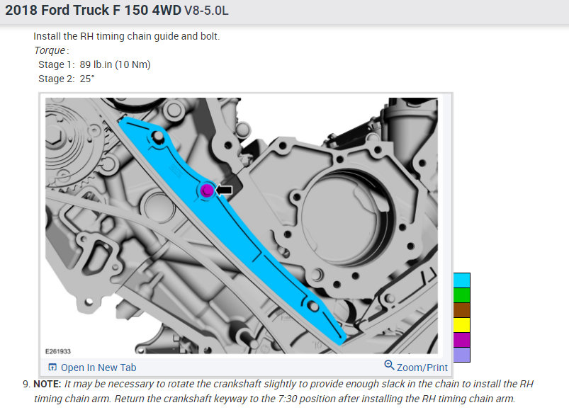

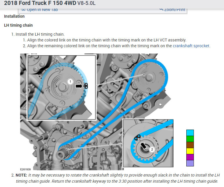

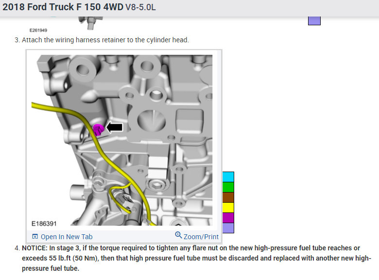

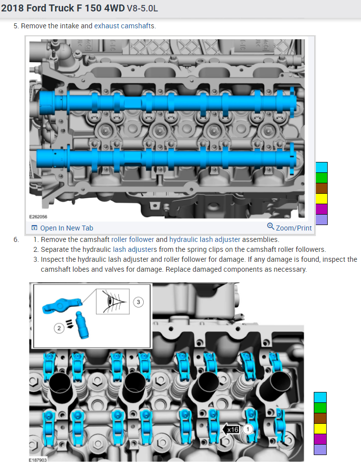

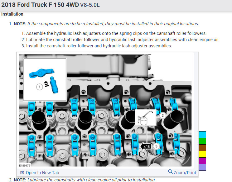

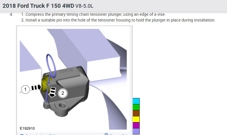

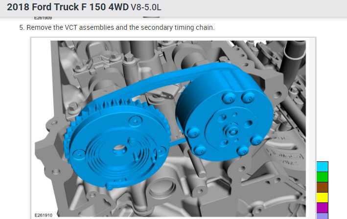

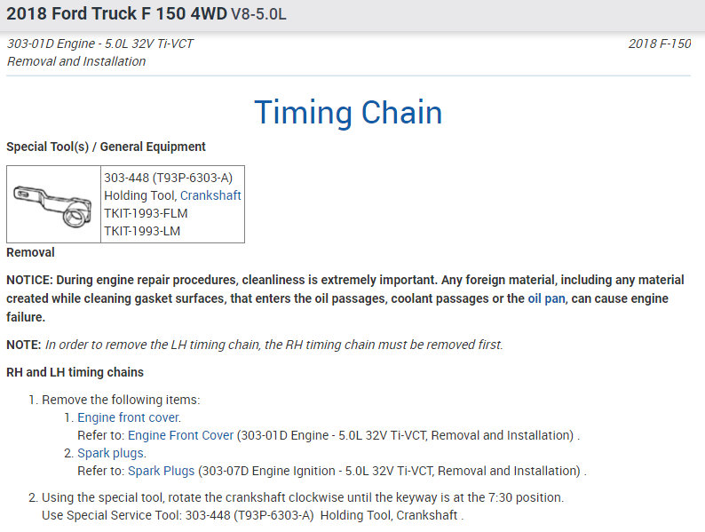

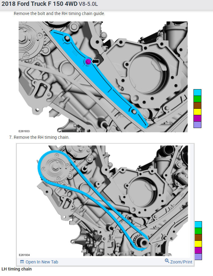

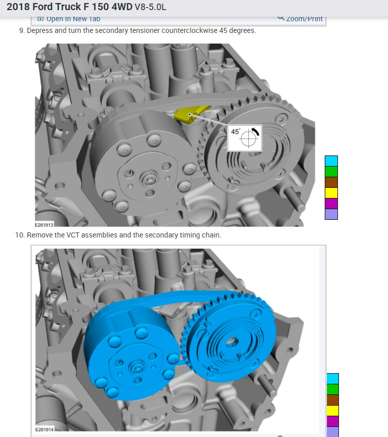

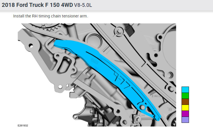

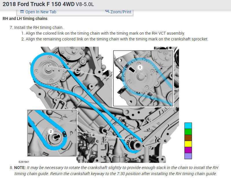

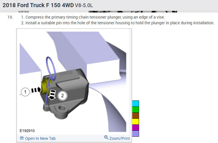

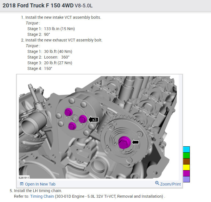

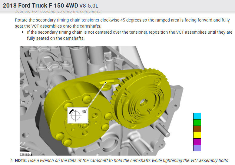

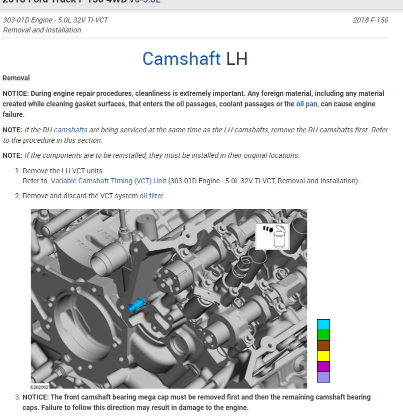

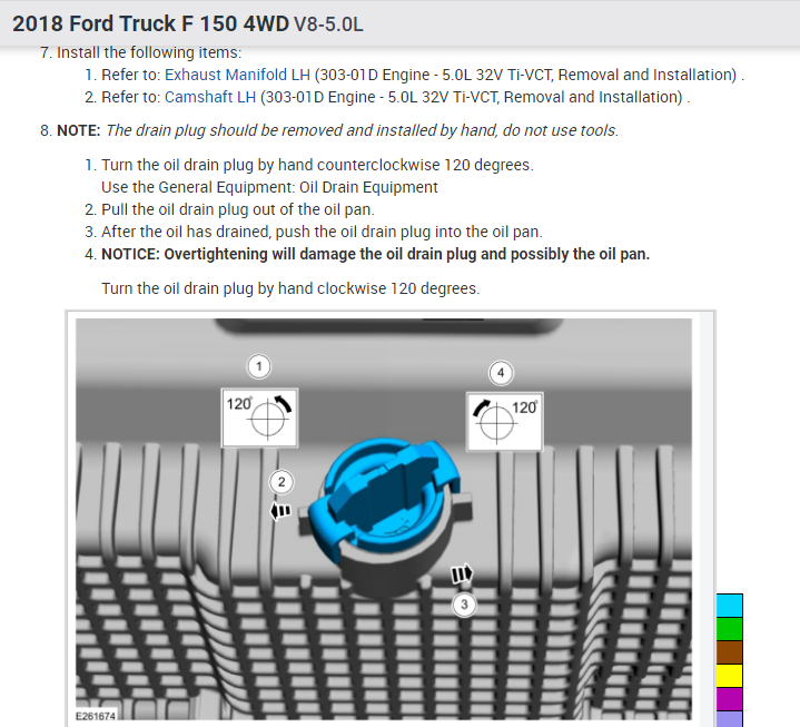

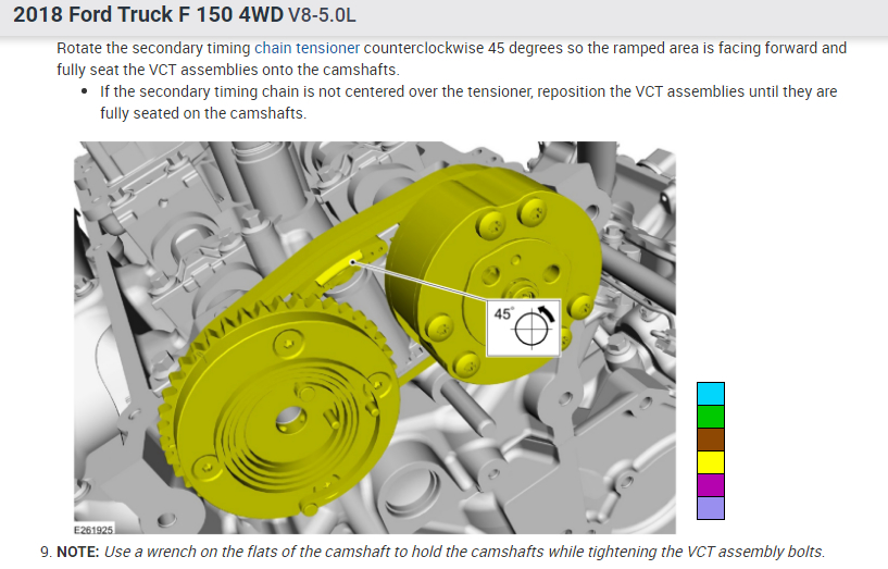

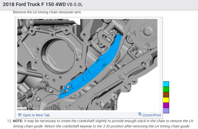

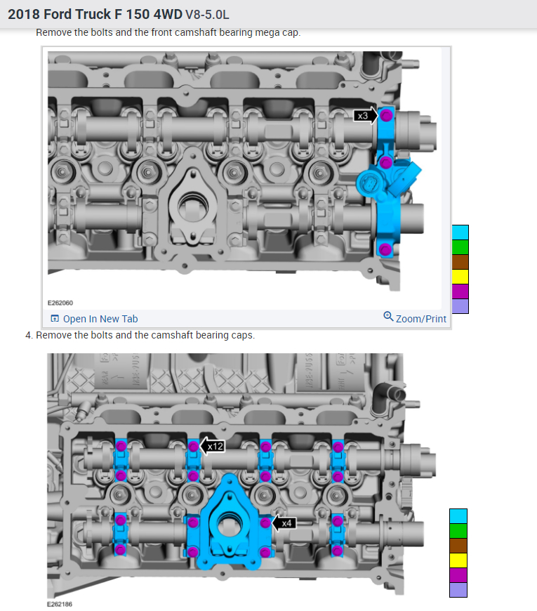

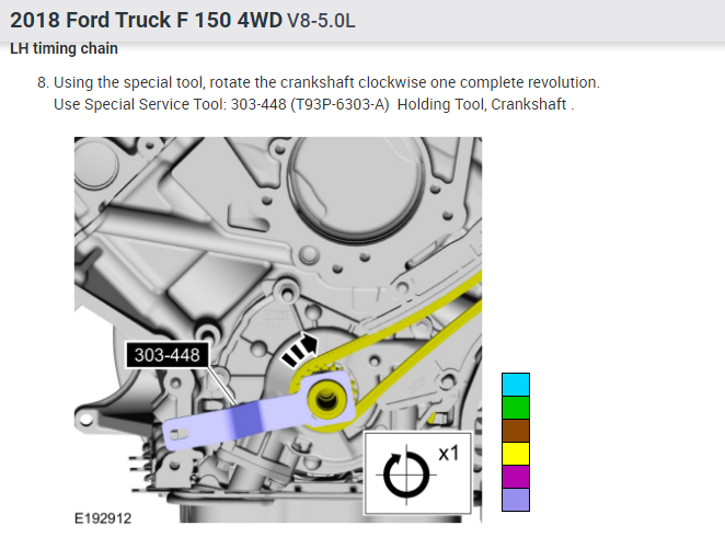

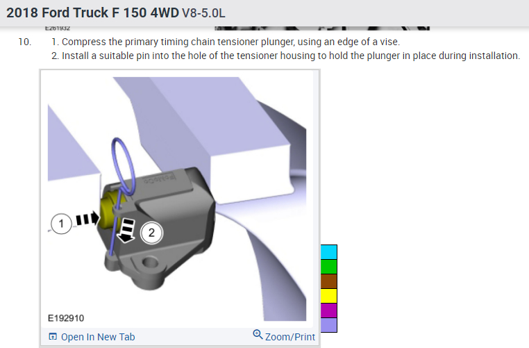

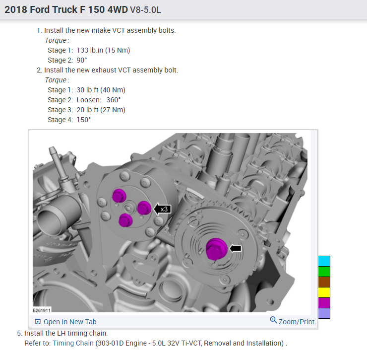

Need a diagram and procedure on how to install the cams and VCT timing chains as well with the main timing chains on the truck listed above. i bought a short block and I'm going to assemble it.
Oct 7, 2021 at 5:10 PM
SQM
  • 6,383 POSTS

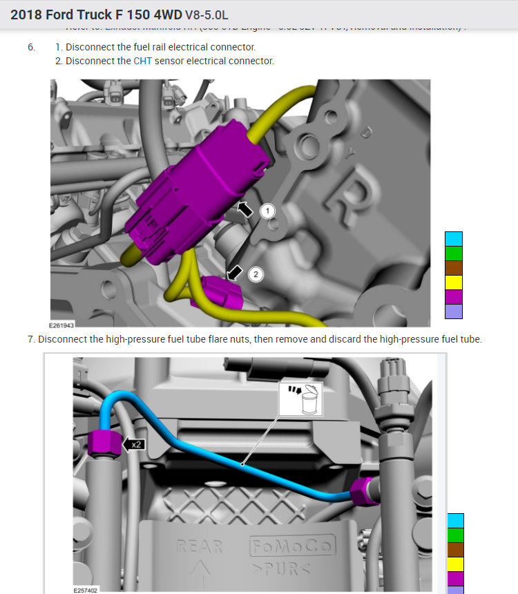

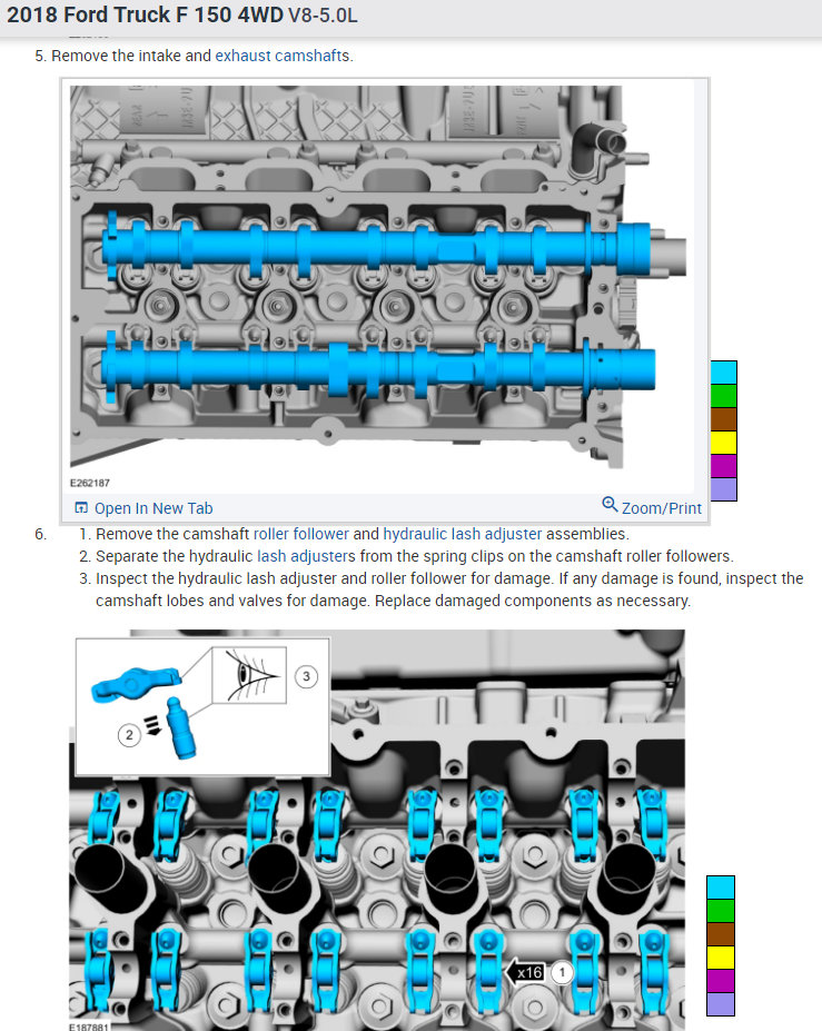

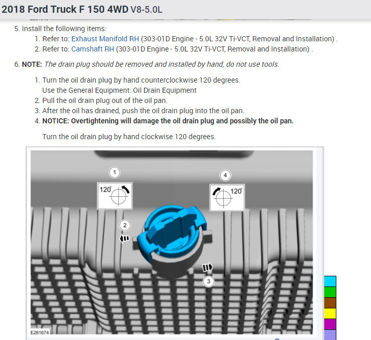

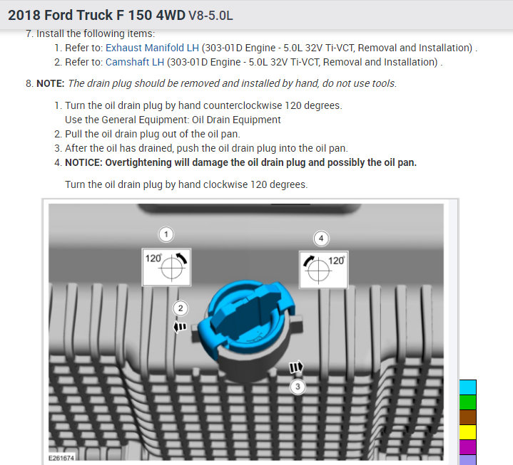

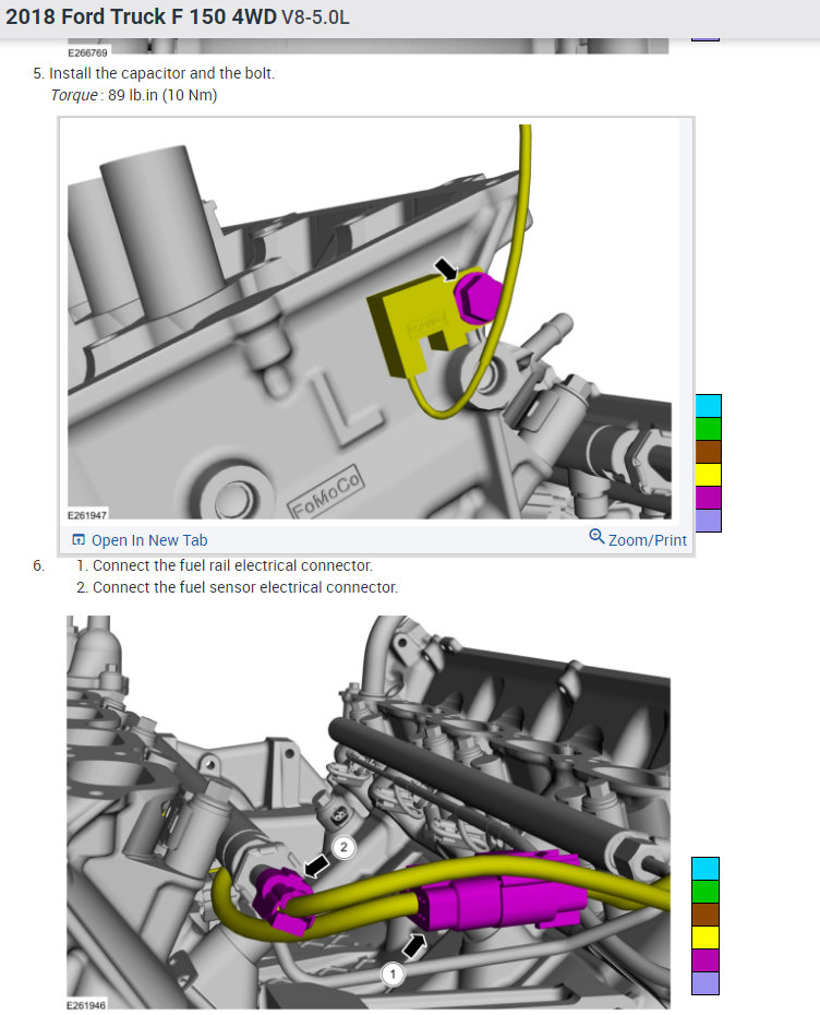

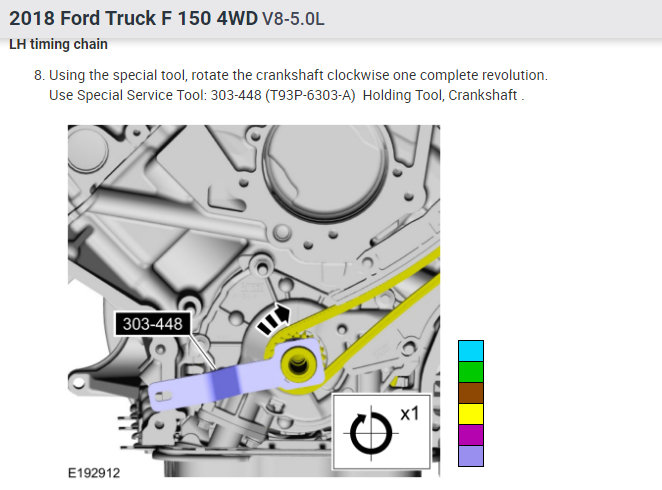

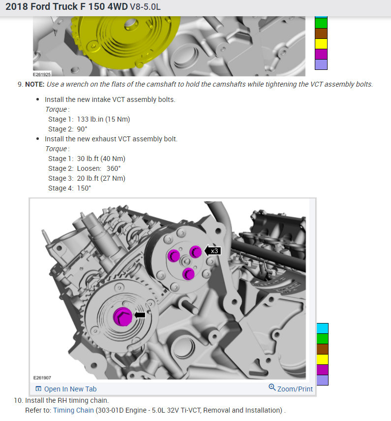

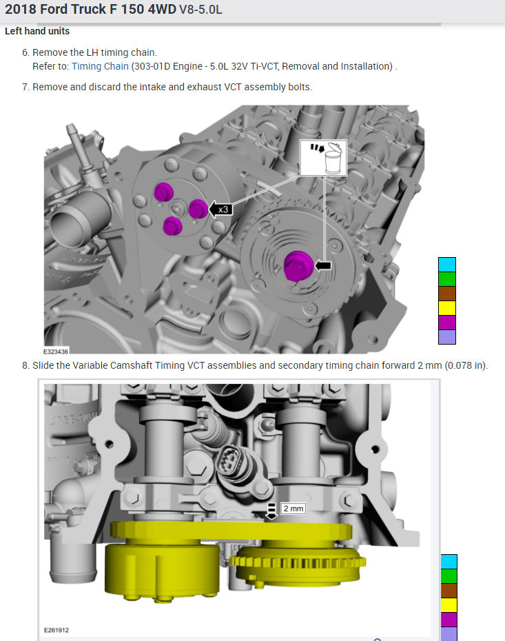

I have attached the timing chain, cam and the VCT timing replacement procedures below.
Please let me know if you need any other information.
https://www.2carpros.com/articles/how-camshaft-variable-valve-timing-works
Oct 8, 2021 at 1:14 AM

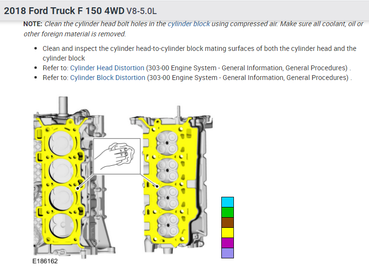

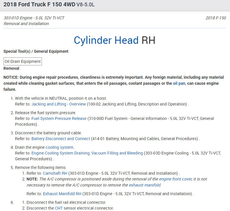

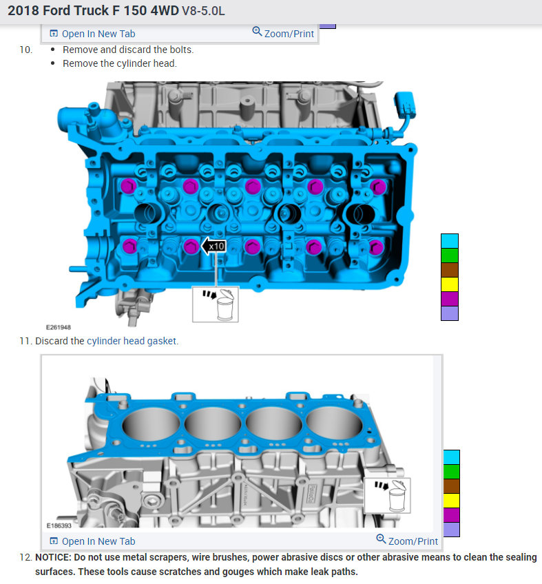

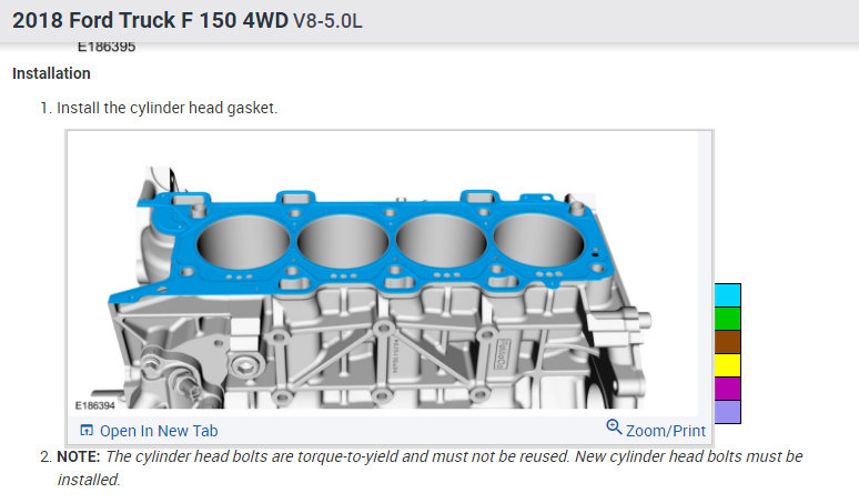

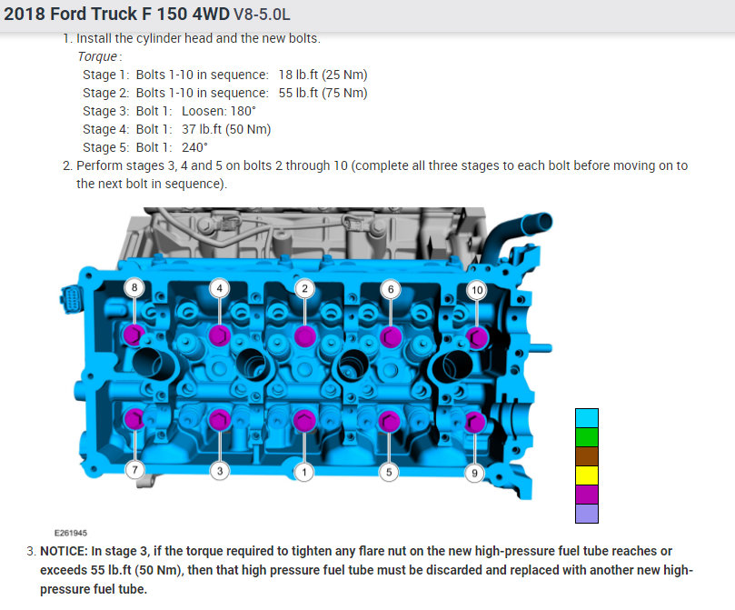

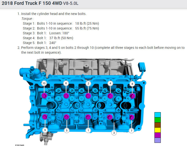

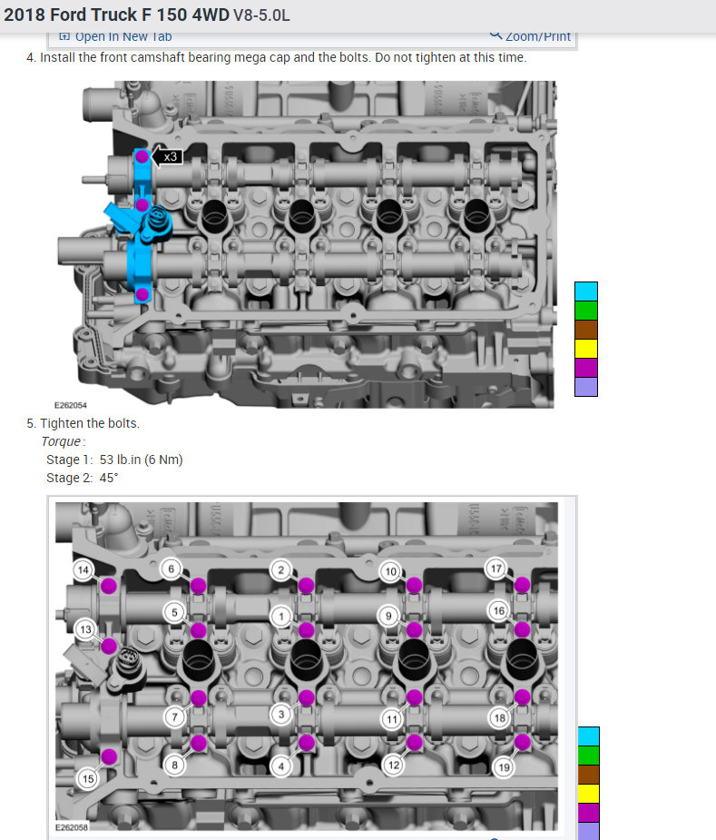

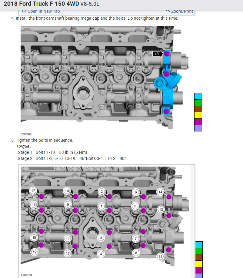

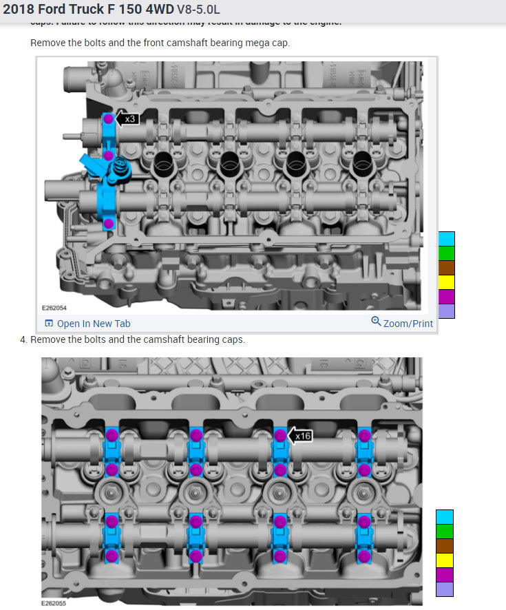

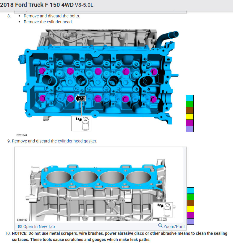

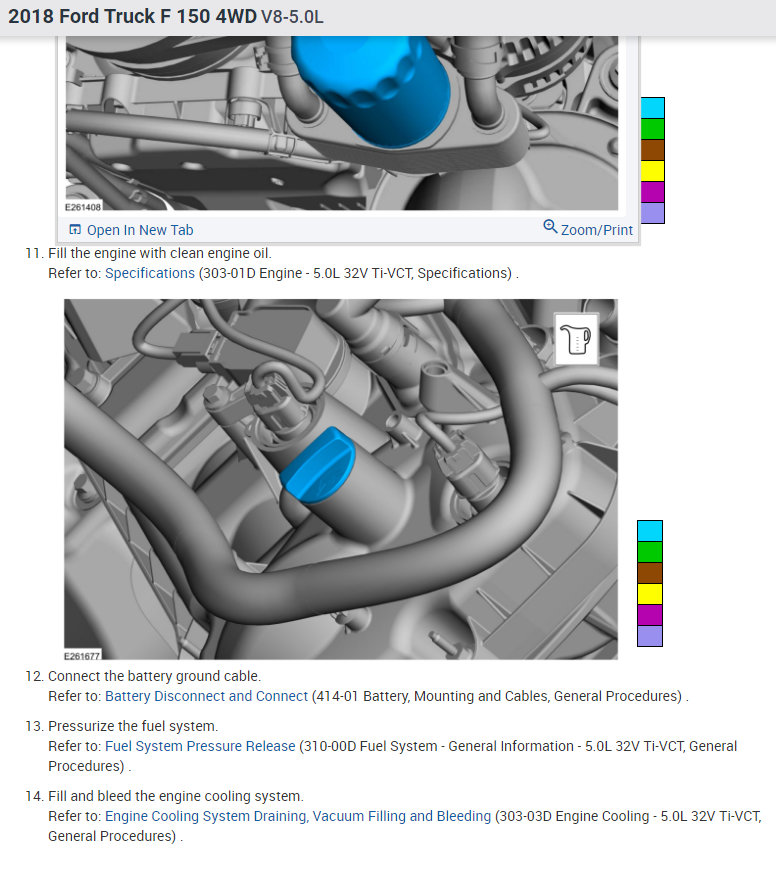

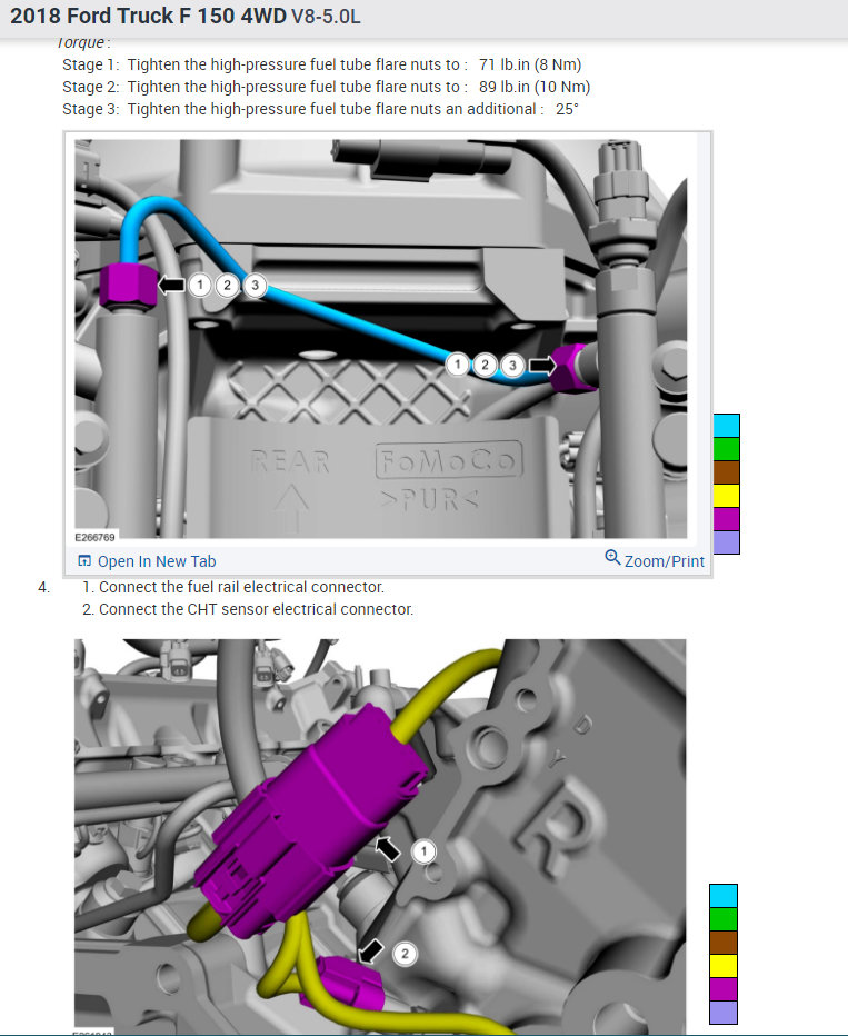

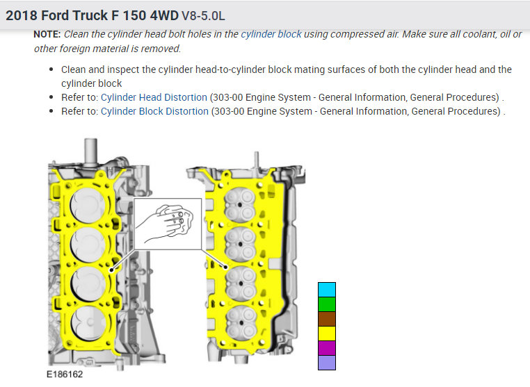

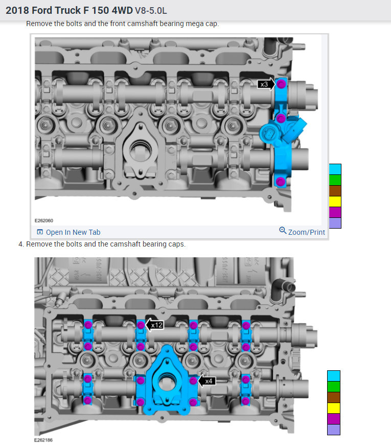

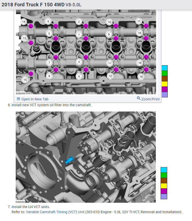

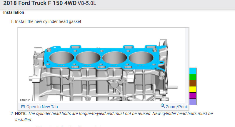

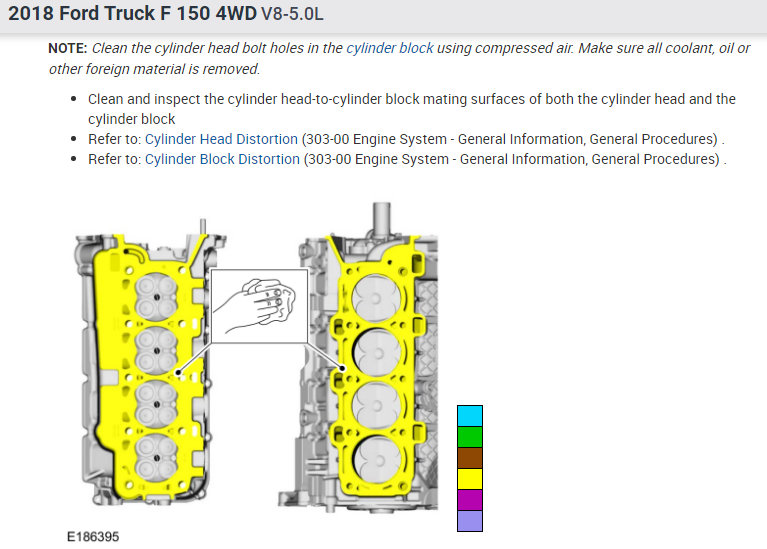

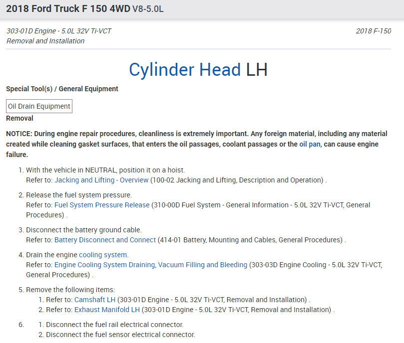

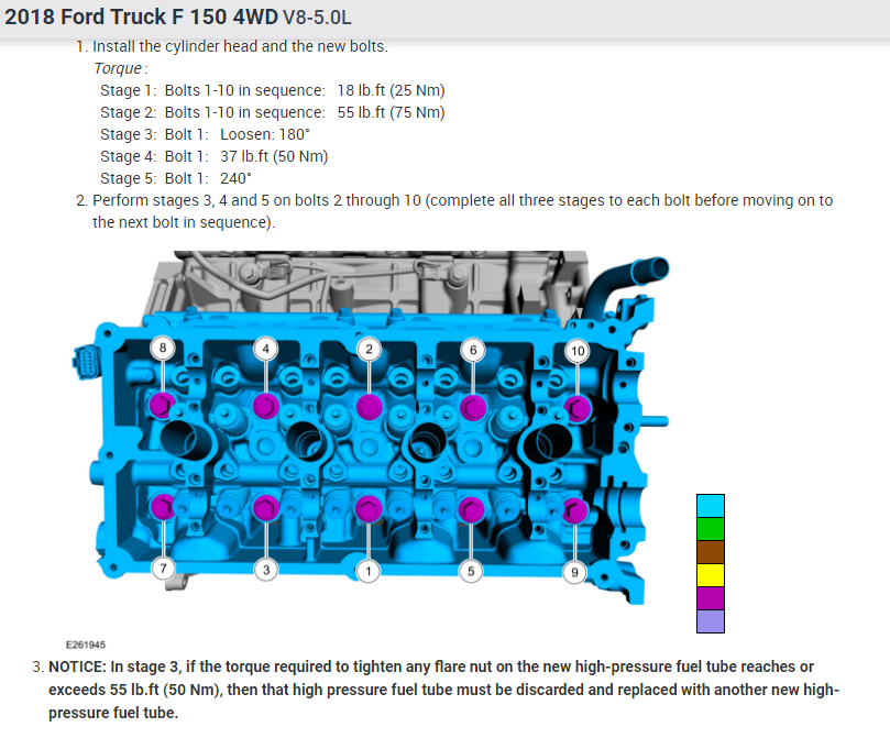

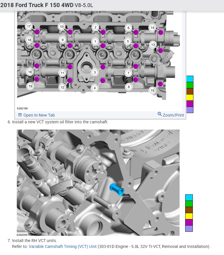

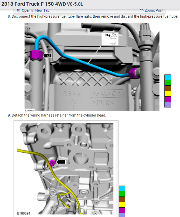

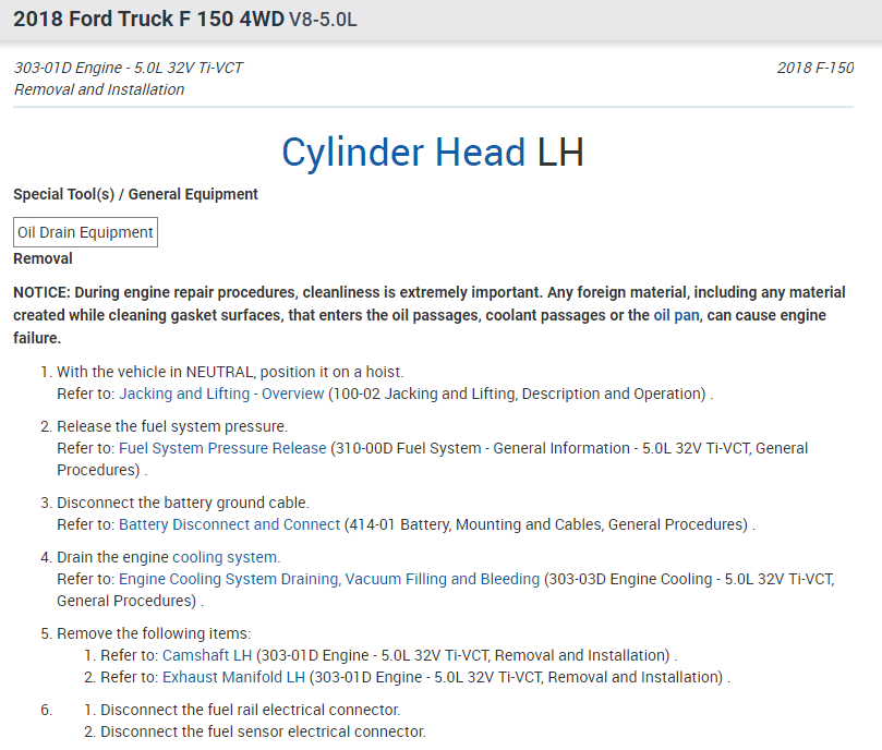

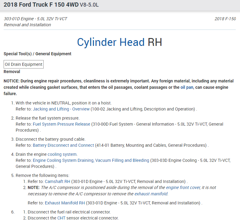

Thank you very much. this helps a lot. by any chance do you have the head installing instructions and torque specs?
Oct 8, 2021 at 3:23 AM
SQM
  • 6,383 POSTS
You are welcome.
I have attached the cylinder head replacement procedure including the torque sequence and specifications.
Let me know how it turns out.
Oct 8, 2021 at 4:00 AM
JORGE LUQUIN

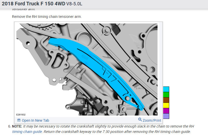

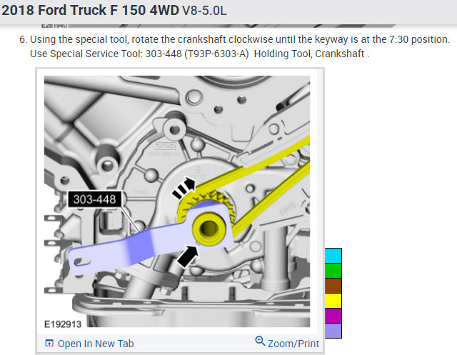

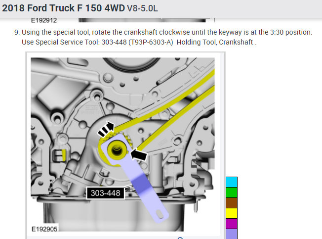

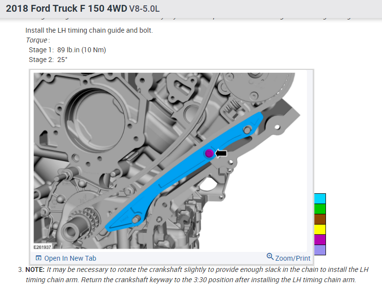

Okay, thank you. one last question so since I'm going to start on a new short block in what position do i place the crankshaft keyway to start doing the timing? is there a procedure for that or do i start at 3:30?
Oct 8, 2021 at 4:20 AM
SQM
  • 6,383 POSTS
You want to keep the keyway at 3:30 after you remove the chain and when you install the chain.

Keep the crankshaft keyway at the 3:30 position when the timing chain is removed and when it is reinstalled. Use the attached camshaft, VCT, main timing-chain, and cylinder-head procedures, including the head torque sequence and specifications.
