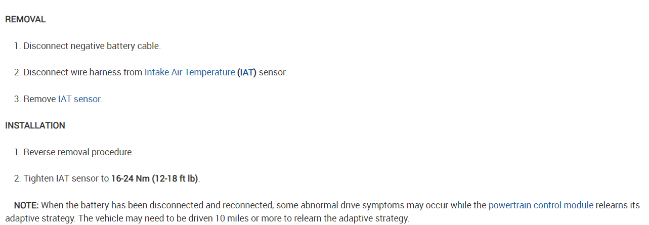

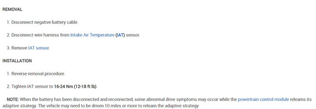

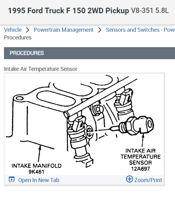

I have a 95 F150. I need to chance the air charge sensor. Does the intake need to be removed to do this? Thanks, David.
Mar 25, 2006 at 2:42 PM
PEPPERMRJ
  • 1,158 POSTS
Nope. here is the location of the sensor and the instruction on how to change it out. Check out the images (below). Let us know if you need anything else.
Mar 25, 2006 at 4:48 PM
Suggested Repair
The intake does not need to be removed to replace the air charge sensor. Replace the sensor at its installed location using the applicable location and replacement procedure.
