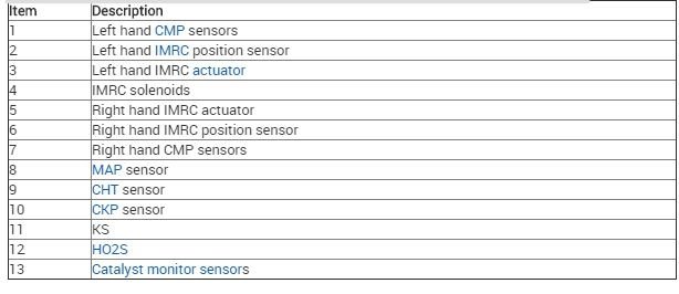

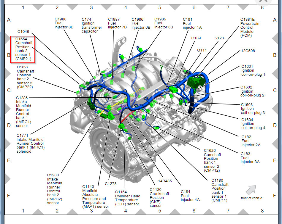

Trying to figure out where this sensor is located on the engine.
Jul 9, 2020 at 9:43 AM
I attached the location of the CMP21 sensor. As you can see it is on the back of the head on the driver side. I also attached the info on the code I assume you have.
However, I should say that if you are having an issue, it would be wise to take this to a dealer because unless the issue is as a result of something you altered on the truck, it will be covered under warranty. If the finds that you have been working on the truck, they may give you a hard time and say you caused the issue so it is always best to have them look at it and repair the issue.

Thank you for the info. I understand about the warranty. We are set to go on vacation on Monday and no dealer can get it in before then and they don't have any loaner vehicles available.

Thanks again for the diagram. It was a 5 minute job and it appears to have fixed the issue. No more check engine light and the truck has full power again. FYI, the code it gave was P0345 incase anyone is wondering.

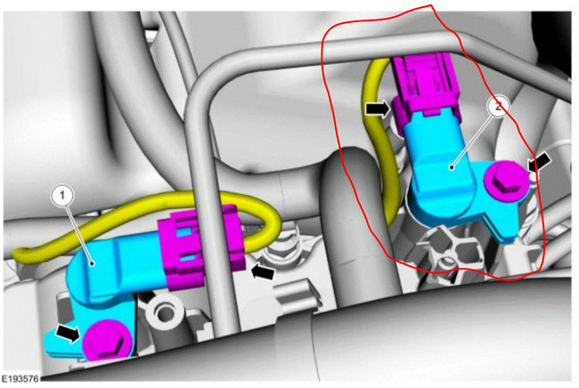

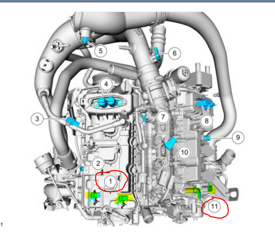

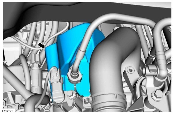

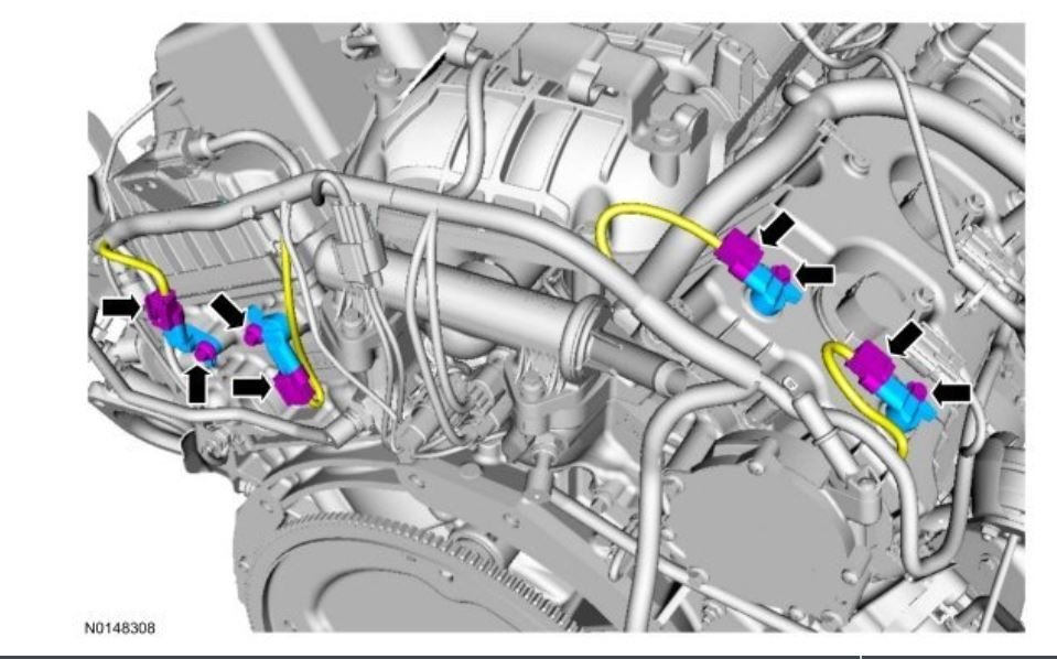

There are a total of 4 cam sensors on this engine. I have attached two pics below showing locations. Take a look and let me know if that helps. Also, if you know what sensor needs replaced, I will be happy to provide the directions / pics for doing it. If you provide the code set, I can get it from that.

They are located on the rear of the cylinder head. There are two per cylinder bank, one intake, one exhaust, for a total of four sensors. I have included a factory description in the diagrams down below. Let us know if there is something else we can help you with.

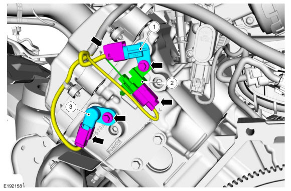

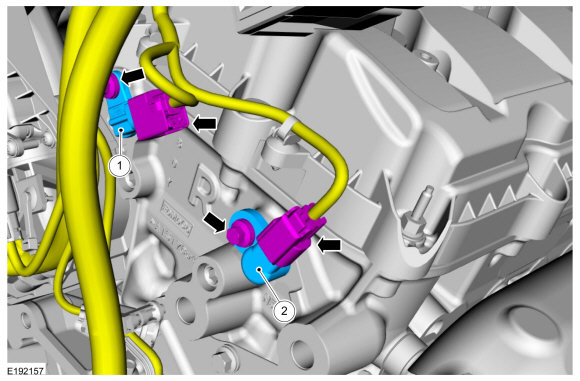

The sensors are on the rear of the engine. There are two per side, one for the intake cam and the other for the exhaust. I have attached a picture to help you locate them. The first picture shows location. The second picture is a legend of the components listed. You are looking for numbers 1 and 7 on the legend.
Here are the directions for removal and replacement. Pictures 3 and 4 correlate with these directions.
NOTE: Removal steps in this procedure may contain installation details.
RH (right-hand) Camshaft Position (CMP) Sensors
Remove the RH fender splash shield.
Refer to: Fender Splash Shield (501-02 Front End Body Panels, Removal and Installation) .
Disconnect the intake CMP sensor electrical connector and remove the retainer and the CMP sensor.
Material : Motorcraft® SAE 5W-20 Premium Synthetic Blend Motor Oil / XO-5W20-QSP (WSS-M2C945-A)
Torque : 89 lb.in (10 Nm)
Disconnect the exhaust CMP sensor electrical connector and remove the retainer and the CMP sensor.
Picture 3
LH (left-hand) Camshaft Position (CMP) Sensors
Remove the LH fender splash shield.
Position aside the radio ignition interference capacitor.
Picture 4
Installation
NOTE: Before installation, lubricate the CMP sensor O-ring seal with clean engine oil.
To install, reverse the removal procedure.

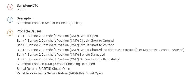

ECO2015
  • 8 POSTS
So it seems that everyone who has an issue with the Camshaft sensor can't find them. Well I believe I have found them, but would really like to make sure.
So, the check engine light would come on and off, but I never noticed any running issues. It came on and I and I had it scanned. The scan was P0365.
Two days later my truck started running rough and I couldn't go over 40-50 miles a hour. It take a long time with the key turned over to start.

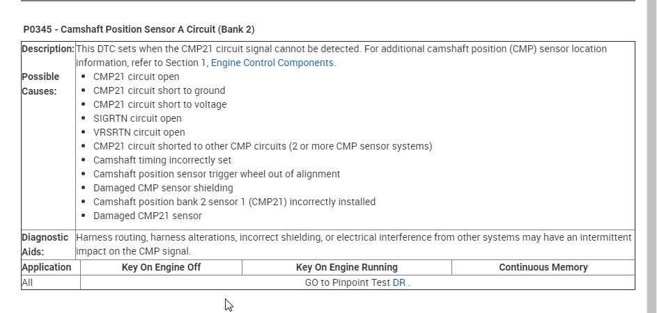

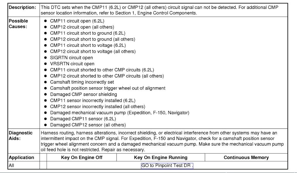

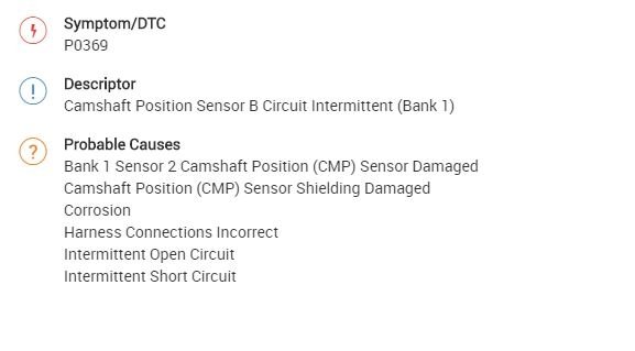

P0365 Camshaft Position Sensor B Circuit Bank 1
I believe that there are two Camshaft sensors on the passenger side at the rear of the engine. 1 is more towards the direct rear and the other off to the rear passenger side.
I did replace the one at the rear and still had the issue. I put the old sensor back in and put the new one in the one off to the passenger side rear and still had the same issue.
I would appreciate some help on this. This website and you guys are invaluable.

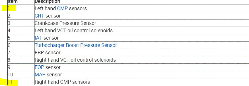

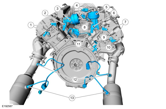

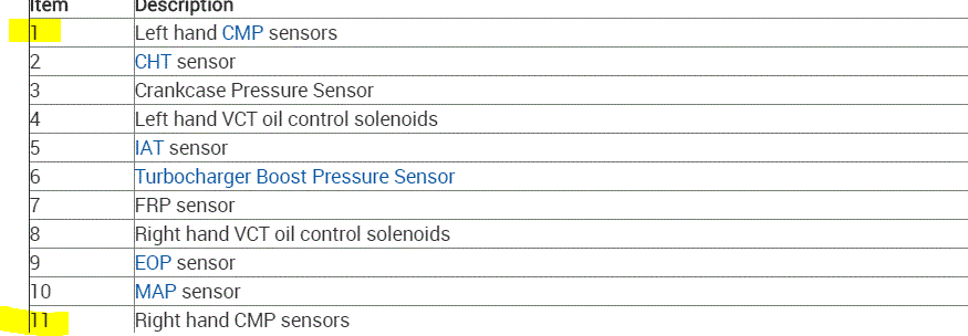

Bank 1 will be the passenger of the vehicle. I attached a picture below and circled sensor B. Is this the one you are referring to?

There are four CMP sensors, two intake and two exhaust.

Yes, that's the one. That is honestly the best diagram that I've seen. I ended up changing the one your circled and still had the problem. So, I put the old sensor back in and changed out the other one. I was trying to rule out which sensor had the issue since I didn't know which one was sensor B.
Tomorrow I will change it back out to the right sensor. My problem is that even when I changed sensor B, it did not change the way the truck ran. I unhooked the battery before changing them out.
My plan going forward is to change out both sensor and see if that fixes the issue. I have been reading about the wire harness potentially being bad.
I appreciate you taking the time to help me navigate this.

  • 110,244 POSTS

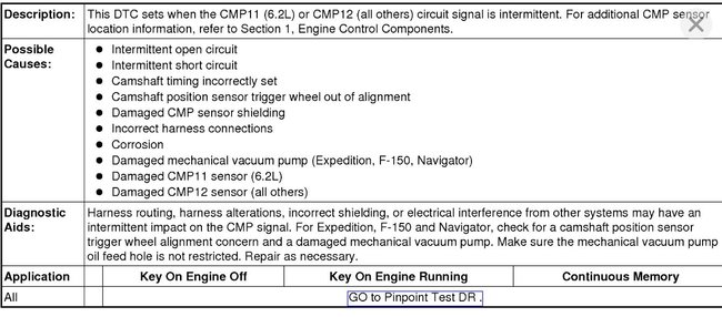

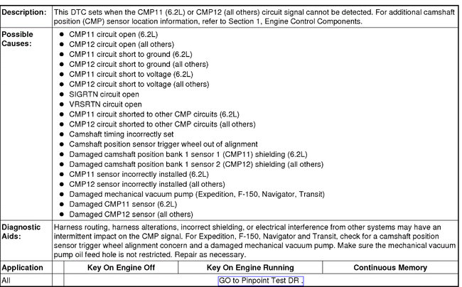

You are very welcome. I have a feeling that replacing the other sensor isn't going to remedy the problem. The code you have is specific to the sensor you already replaced.
Here is the actual flow chart for diagnostics related to this code. I feel bad attaching it. LOL I don't how comfortable you feel doing it, but thought it may be of interest to you. If you look at that last pic I attached, it shows a list of things that can cause this code.

2015 Ford Truck F 150 4WD V6-2.7L Turbo
DR: Camshaft Position (CMP) Sensor - Pinpoint Test
Vehicle Powertrain Management Computers and Control Systems Testing and Inspection Diagnostic Trouble Code Tests and Associated Procedures Powertrain Control / Emission Diagnostics (PCED) SECTION 5: Pinpoint Tests DR: Camshaft Position (CMP) Sensor - Pinpoint Test
DR: CAMSHAFT POSITION (CMP) SENSOR - PINPOINT TEST
DR: Introduction See: Computers and Control Systems > Diagnostic Trouble Code Tests and Associated Procedures > DR: Camshaft Position (CMP) Sensor - Introduction
DR1 CHECK FOR DTCS
Are DTCs P0340, P0341, P0344, P0345, P0346, P0349, P0365, P0366, P0369, P0390, P0391, or P0394 present?

Is a concern present?
- REPAIR as necessary.
- Clear the PCM DTCs. REPEAT the self-test.
- GO to DR11
DR11 CHECK THE CMP SENSOR OPERATION
- Ignition OFF.
- CMP Sensor connector connected.
- PCM connector connected.
- Ignition ON, engine running.
- Access the PCM and monitor the SYNC (MODE) PID.
Does the engine start and does the SYNC PID read YES?
- GO to DR12
- INSTALL a new CMP sensor. REFER to the Service Information Section 303-14, Electronic Engine Controls.
DR12 CHECK FOR DTCS
- Carry out the PCM self-test.
Are any DTCs present?
- The system is operating correctly at this time. The concern may have been caused by a loose or corroded connector.

It's likely that you now hate me for attaching this. LOL Regardless, let me know what you find.

I’ve been searching for hours. I can’t find it on my truck or online to show me where it is on my truck.
Aug 21, 2020 at 7:50 AM (Merged)
Good morning,
I attached a picture of the locations of the sensors. You have 4 sensors, 2 intakes, and 2 exhaust.
Why are you replacing the sensor? Was there a code? If there was, what is the code?

The code was p0365.

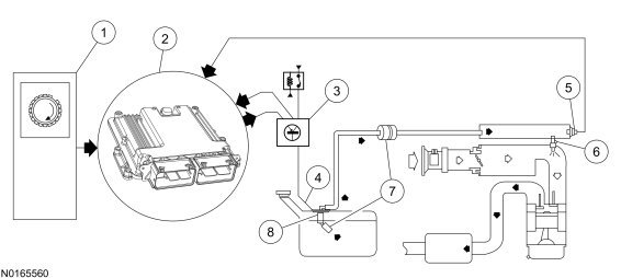

  • 110,244 POSTS
There isn't a traditional regulator on this vehicle. It is controlled by a two fuel pump control modules. The two fuel pump control modules modulate the voltage to the 2 fuel pumps (FP) required to achieve the correct fuel pressure. Voltage for the two fuel pumps is supplied by the power relay and fuel pump control module relay. See pic 1. On the fuel rail is a FRPT sensor which signals the control module of real time pressure so the module can adjust voltage to the pumps.
Let me know if this helps explain.

Which 2 are the exhaust?

Okay, bank 1 is the passenger side of the engine. The sensor is the one that is closest to the exhaust manifold.
This code indicates a voltage issue with the wiring. I would verify there is 5 volts to the sensor and the return line to the ECM is not damaged or open.

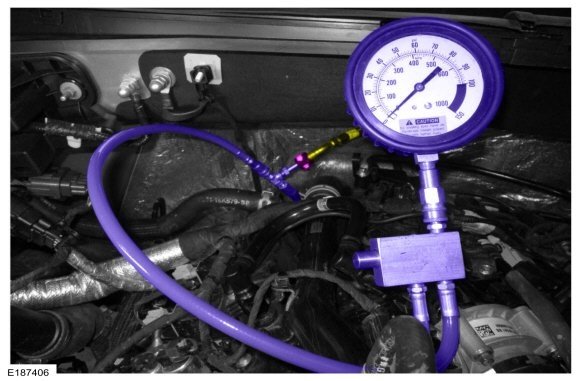

Here are the directions specific to your vehicle. You will need a fuel pressure gauge, but most parts stores will lend one to you with hopes of selling you a new part. lol
The attached pics will correlate with these directions.

pic 1
Check
NOTE: This Fuel System Pressure Check is for the low pressure side of the system.
1. Release the fuel system pressure.
Refer to: Fuel System Pressure Release See: Fuel Pressure Release > Procedures > Fuel System Pressure Release (310-00A Fuel System - General Information - 2.7L EcoBoost (238kW/324PS), General Procedures).
2. Disconnect the battery ground cable.
Refer to: Battery Disconnect and Connect See: Battery > Procedures > Battery Disconnect and Connect (414-01 Battery, Mounting and Cables, General Procedures).

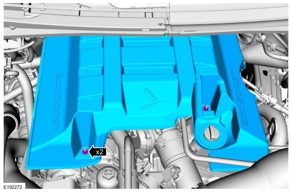

3. Remove nuts and the engine appearance cover.
Torque : 42 lb.in (4.8 Nm)

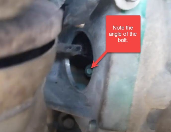

pic 2
4. Remove the High Pressure Fuel Pump noise insulator.
pic 3
5. Disconnect the fuel supply line-to-high pressure pump quick release coupling.
Refer to: Quick Release Coupling See: Fuel Line Coupler > Procedures > Quick Release Coupling (310-00A Fuel System - General Information - 2.7L EcoBoost (238kW/324PS), General Procedures).
6. Install the Fuel Pressure Test Kit between the fuel supply line and the high pressure pump.
Use Special Service Tool: 310-D009 (D95L-7211-A) Fuel Pressure Test Kit.
pic 4

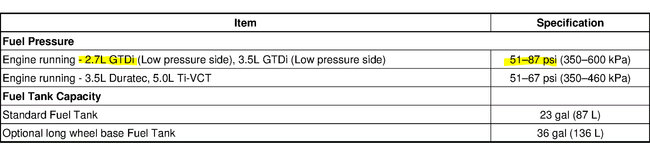

Test the fuel system pressure to make sure it is within the specified range. For additional information, refer to Specifications.

The last pic shows pressure specifications.
Let me know what you find.

The ones that are closest to the exhaust manifolds.

Thank you for the information. Nothing I have read mentioned 2 sensors (exhaust). I had to get my OBD tool... The tool actually shows 6 DTC's the other code is P0369, it shows both the codes 3 times each.

AJB442
I have a transient code p0016 along with a turbo under boost code. It comes and goes there is no noise from the motor or timing chain. I will be driving and the truck performs normal turbo engages and runs smooth. Then i will loose the turbo the truck will run smooth though under powered. Turning the truck off and restarting often clears the symptoms for a while. I have replaced the cam sensor and located and removed the crank sensor but am having a difficult time reinstalling the new one. I cant seem to locate the opening for the pick up on the sensor. Does it seat into a hole like the cam sensor?
Okay, I posted the 369 possibilities as well.

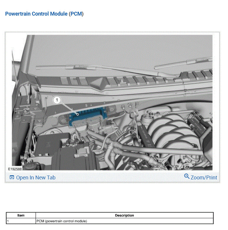

I thought I found the PCM but not sure. ECM - Ford (GD9Z-12A650-AANP).

I attached a picture below of the PCM's location. Part number (GD9Z12A650AANP), so you have the correct number. Interestingly, the directions to remove and replace refer to it as a PCM, but under the parts, it is referred to the ECM. They are the same thing. LOL
Let me know if this helps.
