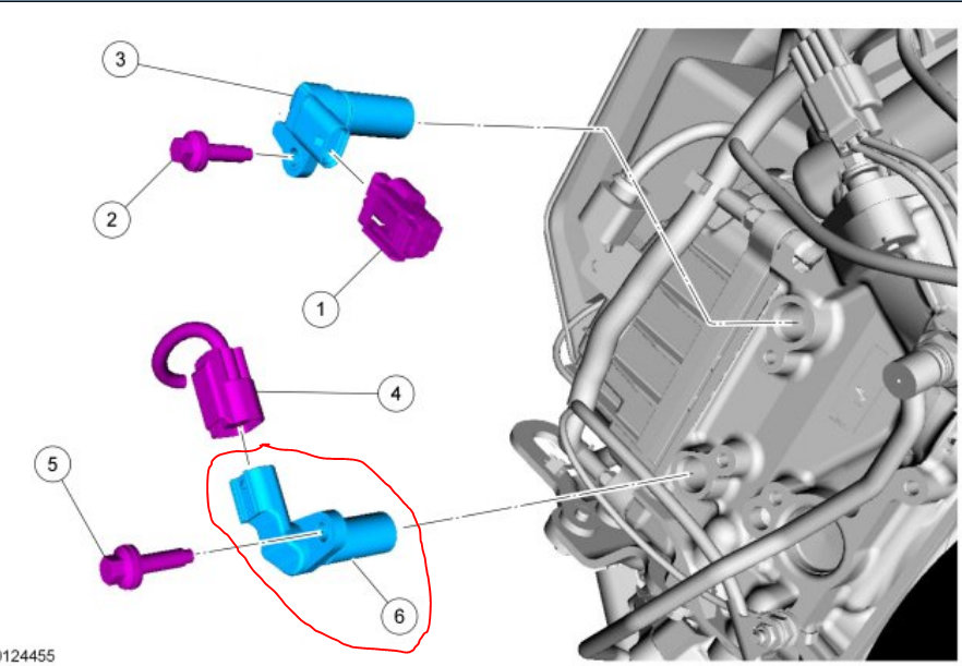

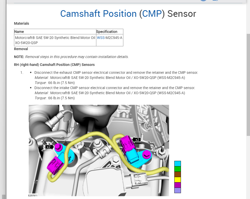

Camshaft Position Sensor Location and Replacement?
AJB442
Thanks. So the shaft of the sensor doesn't go into a hole? I can see the bolt hole and prob line it up but was unsure about a hole for the shaft.

AJB442
Okay, thanks. Just to be clear the shaft of the sensor doesn't have to fit into a hole?
Friday, August 21st, 2020 AT 2:50 PM (Merged)
  • 109,896 POSTS
That is likely the problem. Let me know if it takes care of the issues. Darn mice! You have no idea how many times they have caused problems.

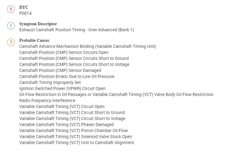

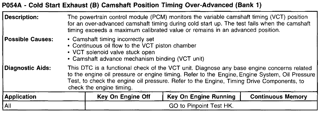

STEVE6268
  • 2013 FORD F-150
  • 3.7L
  • 2WD
  • 100,365 MILES

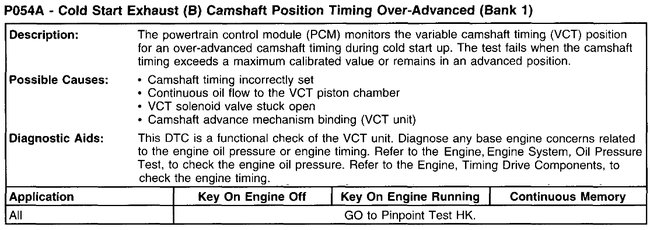

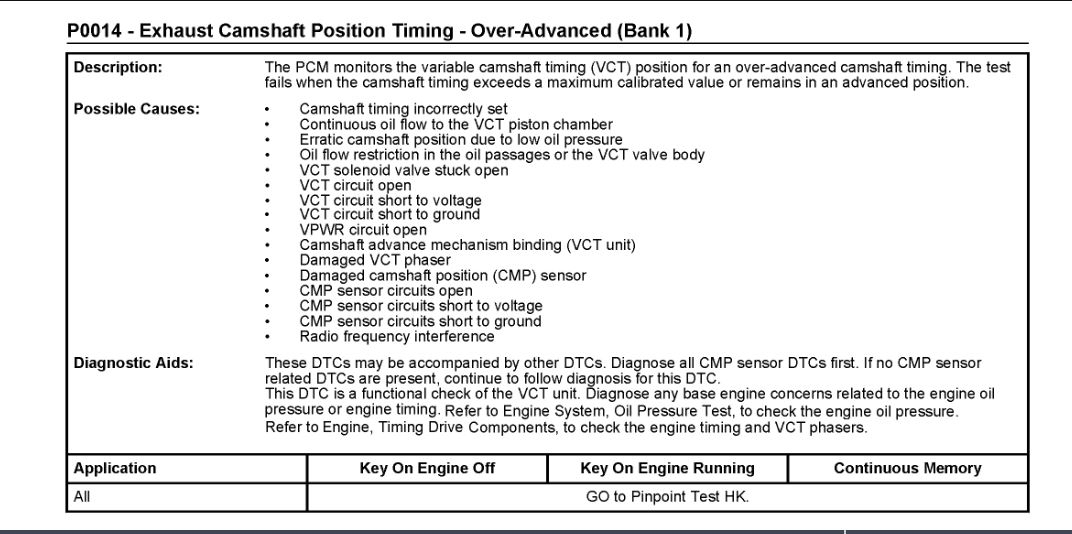

Truck stalled then wouldn't start ran odm on it came up with code P0014.
  • 52,797 POSTS
Good morning,
This is a complicated code as there are so many possibilities.
It could be anything from a bad timing chain to a bad guide or phaser, a clogged oil control valve from sludge in the oil to a electrical issue.
https://www.2carpros.com/articles/how-camshaft-variable-valve-timing-works
The diagnostic tree is below and you will need an advanced scan tool to monitor the system.
HK: Variable Camshaft Timing (VCT)
HK: Introduction See: Computers and Control Systems > Diagnostic Trouble Code Tests and Associated Procedures > HK: Variable Camshaft Timing (VCT) - Introduction
HK1 CHECK FOR DIAGNOSTIC TROUBLE CODES (DTCS)
Note:These DTCs may be accompanied by other DTCs. Diagnose all CMP sensor DTCs first. If no CMP sensor related DTCs are present, continue to follow diagnosis for the DTC. If any CMP DTCs are present, GO to Pinpoint Test DR See: Computers and Control Systems > Diagnostic Trouble Code Tests and Associated Procedures > DR: Camshaft Position (CMP) Sensor - Introduction. If no CMP DTCs are present, continue to follow this test.
Are DTCs P000A, P000B, P0010, P0011, P0012, P0013, P0014, P0015, P0016, P0017, P0018, P0019, P0020, P0021, P0022, P0023, P0024, P0025, P052A, P052B, P052C, P052D, P054A, P054B, P054C, P054D, P2088, P2089, P2090 or P2091 present?
For DTC P0010, P0013, P0020, P0023, P2088, P2089, P2090 and P2091, GO to HK2.
For all others, GO to HK10.

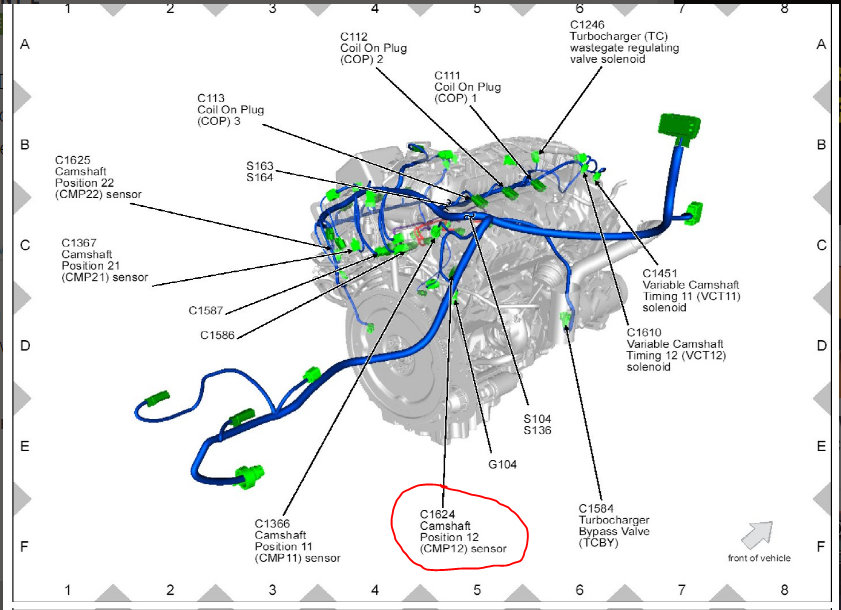

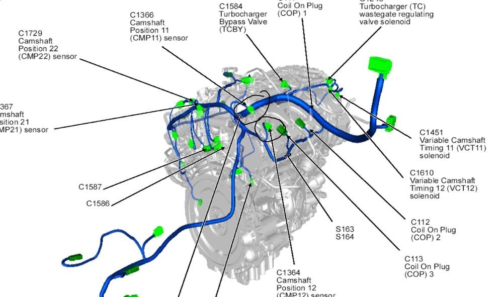

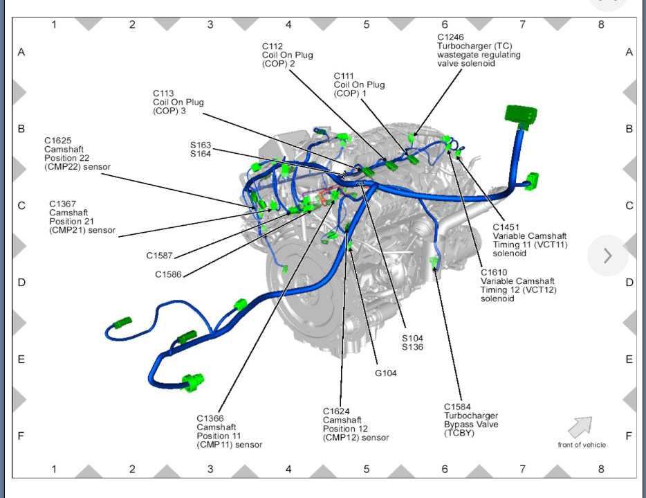

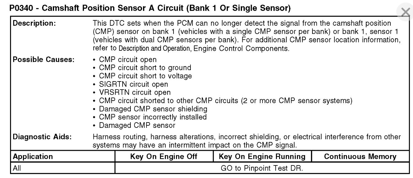

BETH N ET
  • 2013 FORD F-150
  • 5.0L
  • V8
  • 134,000 MILES

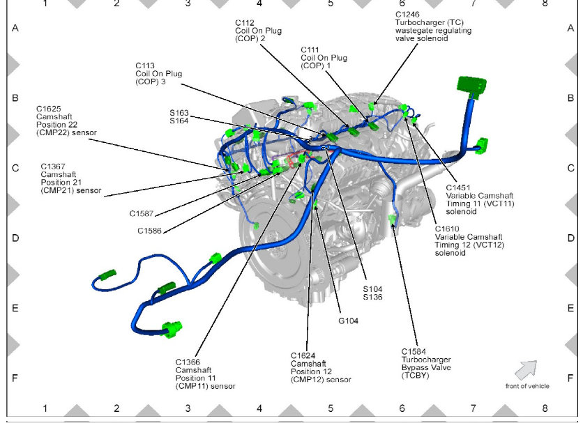

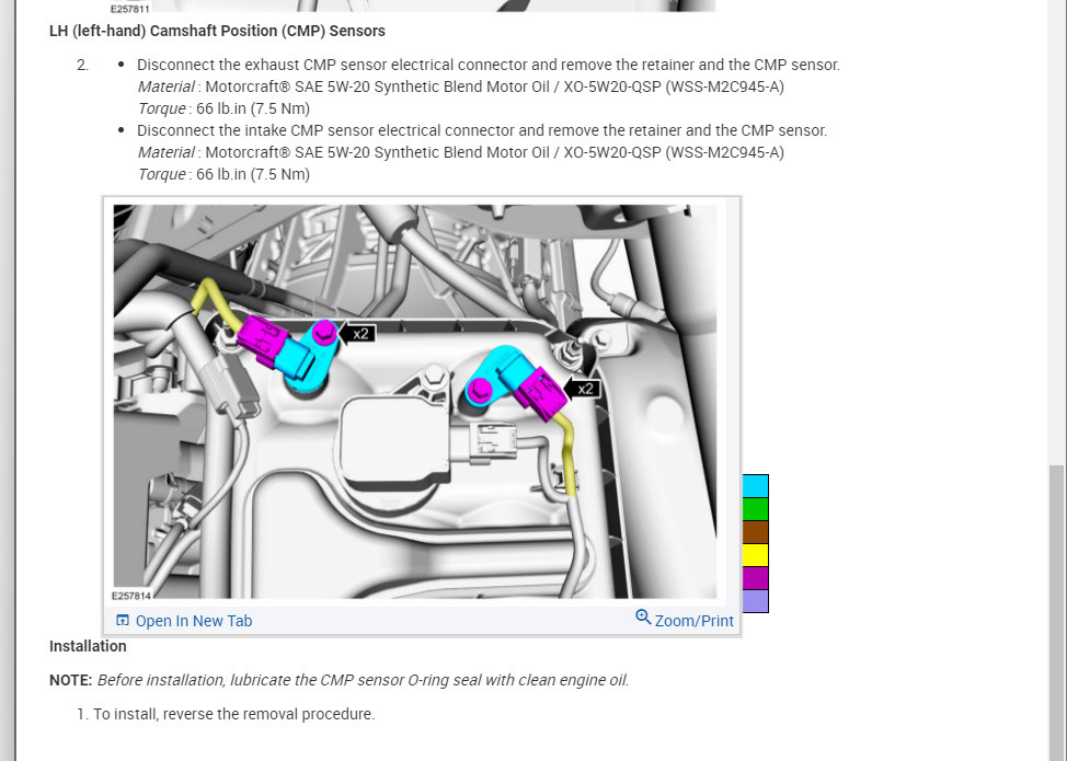

Need the position for the sensor listed above for bank 1, passenger side.
  • 52,797 POSTS
Good afternoon,
Is it the intake or exhaust cam sensor? There is one for each.
Why are you replacing it? They are not common failures. Do you have a code? If you do, can you give me the code so I can help you track down the failure?
BETH N ET

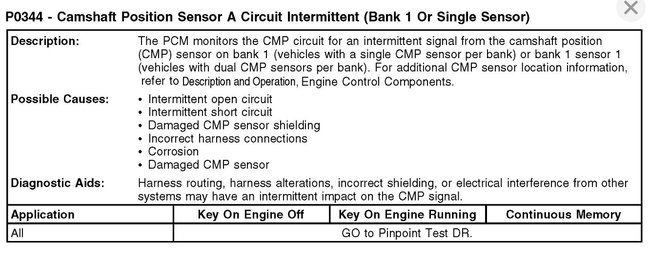

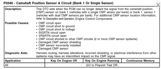

Codes P0340 and P0344.
  • 52,797 POSTS
340 possibilities. I listed the possibilities below. It looks more electrical than a sensor.
If you have a scan tool, you can monitor the cam sensor readings while the engine is running to see if there is a signal being sent to the PCM.
Symptom/DTC P0340
Descriptor
Camshaft Position Sensor A Circuit (Bank 1 Or Single Sensor)
Probable Causes
Camshaft Position (CMP) Circuit Open
Camshaft Position (CMP) Circuit Short to Ground
Camshaft Position (CMP) Circuit Short to Voltage
Camshaft Position (CMP) Circuit Shorted to Other CMP Circuits (2 or More CMP Sensor Systems)
Camshaft Position (CMP) Sensor Damaged
Camshaft Position (CMP) Sensor Incorrectly Installed
Camshaft Position (CMP) Sensor Shielding Damaged
Signal Return (SIGRTN) Circuit Open
Variable Reluctance Sensor Return (VRSRTN) Circuit Open
344
Symptom/DTC P0344
Descriptor
Camshaft Position Sensor A Circuit Intermittent (Bank 1 Or Single Sensor)
Probable Causes
Corrosion
Harness Connections Incorrect
Intermittent Open Circuit
Intermittent Short Circuit
Flow chart for the codes.

Note:If the generator/regulator is electrically noisy, the noise decreases when the B+ connector is disconnected.
Ignition ON, engine running.
Monitor the generator for an audible electric noise.
Ignition OFF.
Generator/regulator B+ connector disconnected.
With the engine running, determine if the generator noise remains steady, decreases or increases in volume.
Does the generator noise remain steady when the B+ connector is disconnected?
For DTCs P0341, P0346, P0366 or P0391, GO to DR20.
For F-150 3.5L and F-Series Super Duty 6.2L, GO to DR9.
For Escape 2.5L, Explorer GTDI 3.5L, F-150 5.0L, F-150 6.2L,
Flex GTDI 3.5L, Fusion 2.5L, MKS 3.5L, MKT 3.5L, Mustang 5.0L, Taurus
GTDI 3.5L and Transit Connect with DTCs P0340, P0344, P0345, or P0349,
GO to DR9.
For Edge 2.0L, Escape 1.6L, Escape 2.0L, Explorer 2.0L, Fiesta,
Focus, Fusion 1.6L, Fusion 2.0L, MKT 2.0L, MKZ 2.0L and Taurus 2.0L, GO
to DR12.
For all others, GO to DR4.
REFER to Charging System, to DIAGNOSE the generator is noisy symptom.
DR4 CHECK THE CMP SENSOR RESISTANCE
Note:Diagnose the suspect CMP sensor indicated by the DTC.
Note:Only measure the circuits that apply to the vehicle being diagnosed.
MARIO20
  • 2012 FORD F-150
  • 3.7L
  • V6
  • 2WD
  • 167,678 MILES
Trying to find camshaft position sensor locations?
Friday, August 21st, 2020 AT 5:36 PM (Merged)
I attached the location of the CMP sensors. Let us know if you still can't find them and we will see if we can get some more info. Thanks

Looking for the location of the two sensors listed above. I can't determine where they are and which side is which, nor can I find any diagram showing me where they are.
BMDOUBLE
  • 1,139 POSTS
The repair manual gives instructions to remove the transfer case, but I have done this from the top side. I pulled up a view with the valve cover off because there are no clear illustrations that show this, backside of the driver side head. One 8mm bolt holds each sensor in, so a shallow 1/4 drive 8mm socket and ratchet should get it done.
+3

STACEY CHRISTIANSEN
  • 2011 FORD F-150
  • 3.5L
  • V6
  • 2WD
  • 92,000 MILES
Had a P054a code. Can't find the location of the exhaust (B) camshaft position sensor bank1. Please send pictures or very good description of location. Thank you in advance.
DANNY L
  • 5,648 POSTS
Hello, I'm Danny.
That sensor will be located on the right side (passenger) cylinder on the back of the cylinder head at the bottom. Here is a tutorial showing how to replace:
https://www.om2carpros.c/articles/camshaft-angle-sensor-replacement
I've attached pictures below, However this is the left side. Similar picture but yours will be on the opposite site.Circled in red.Hope this helps and thanks for using 2CarPros.
+1
