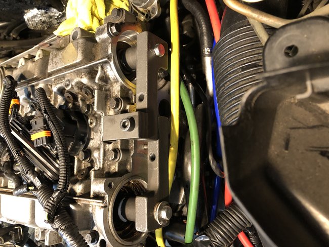

Tried to send you an update with a photo from my phone but the email function is screwed up right now. I'll explain what the photo shows.
I took a pic of the ends of the cams with the crank set on the marks. The stamped writing on the intake end is at ABOVE the center of the cam; the writing on the end of the exhaust cam is at UNDER the center of the cam. The slots are almost perfectly horizontal. I'm going to have to rotate them slightly to install the cam lock.
In review, you wanted me to take the cam sprockets off and reinstall them with the marks lined up with the cover, correct? (Using the install method for the exhaust hub that you mentioned in the last communication). Then take a pic and send it to you for you to inspect before I fire it up. I'll do that when I'm done - if this glitch with my phone is straightened out.
Question: how does changing the sprocket position have an effect on cam alignment if the cams are locked during sprocket R and R? I'm thinking that the sprockets' purpose is to merely turn the cams - not having any effect on timing other than having a reference mark for cam position. I've been wondering about this since I started this project. Can you explain? It's going to be a couple of days before I can get back on it; can't get parts until Monday. Thanks again.

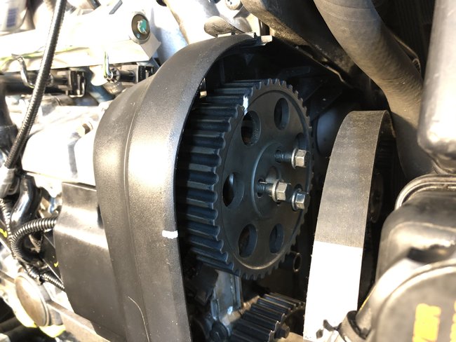

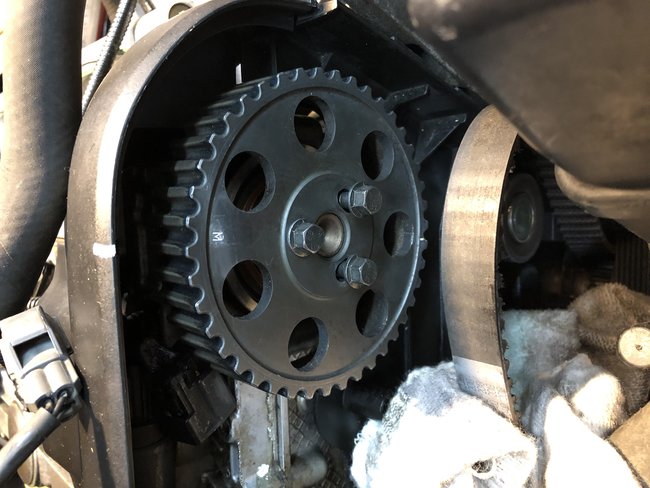

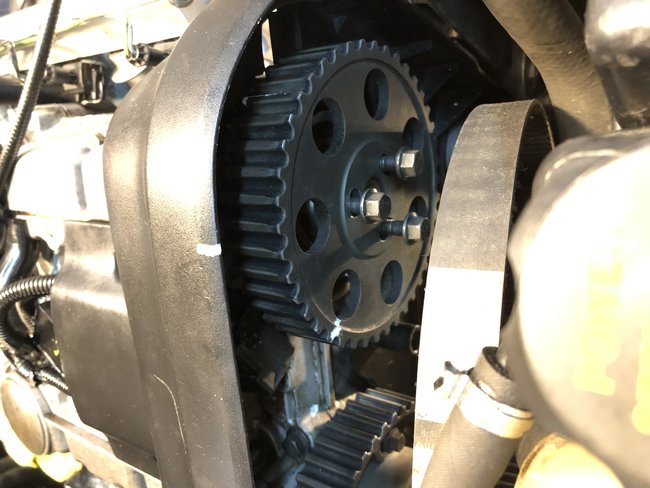

Here are pics of the cam sprocket marks in relation to timing cover marks.

The “M” mark on the sprocket lines up with bolts in; the thin mark does not.

That is all wrong. Lock the cam with the lock tool. The thin line lines up with the cover. How does the exhaust cam look?

This is a photo of the cam lock tool installed at the time that I took the cam photos. With the cam lock tool on, the intake cam sprocket mark- the thin line - will not matchup with the timing cover mark when the three bolts are installed; its either an inch or so to the left, or the same distance off to the right. Not that I think it’s right, but the “M” mark does, and perfectly This is really messing with my head.
The exhaust hub/sprocket will spin wherever I want it to go, so it’s not at issue as far as I know.

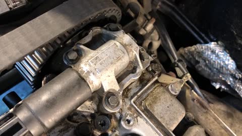

The oil control valve/variable timing solenoid was full of oil when I removed it.

Can get a definitive answer on whether or "oil control valve", "variable timing solenoid", and "camshaft adjust solenoid" is the same part. I need to know in case I need to buy one. Thanks.
Wednesday, September 25th, 2019 AT 10:03 AM
JIS001
  • 3,411 POSTS
They are pretty much call either one of those names.
