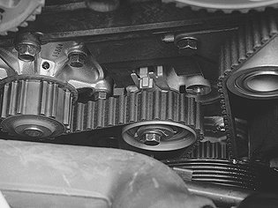

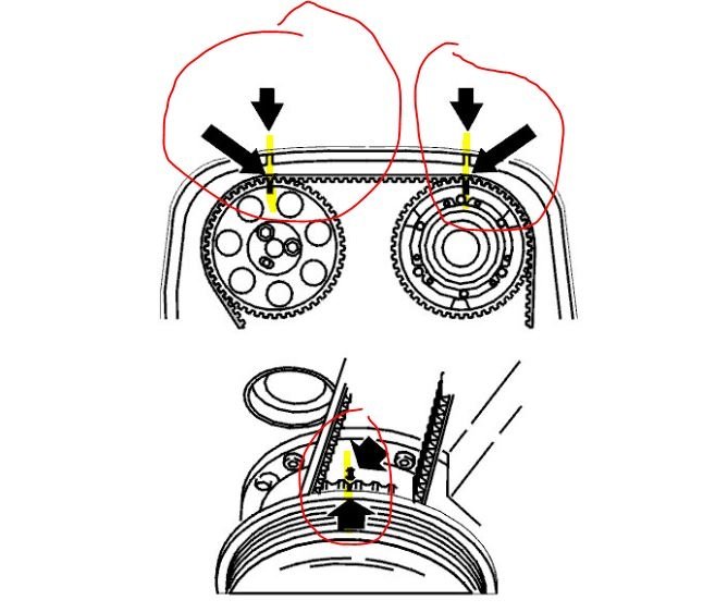

My camshafts are misaligned. The exhaust cam has been turned; how much I don't know. Timing belt off. How do I align them properly, and how can I tell if I've done it right? Can I tell by looking at them? I plan on taking the cam cover off to replace seals. I have the cam/crankshaft lock/cam cover remover tool kit as well as all the other tools I need. One more question: Does the crankshaft pulley go on only one way? I need to know if it's properly set on the crankshaft before I can align the mark with the mark on the oil pump. I see a 2-tooth gap on the crank pulley that appears to correspond to a specific place on the crankshaft end. Is that where they should match?
Aug 22, 2019 at 9:41 AM
  • 110,248 POSTS
Welcome to 2CarPros.
The crankshaft pulley will only fit one way. It should have a key-way that only allows it to go one way. Here are the directions for replacing the belt. All attached pics correlate with the directions.

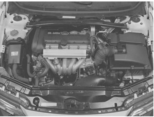

Remove:
- the cross stay between the suspension turrets
- the upper camshaft belt cover
- the servo reservoir and expansion tank.
Lift them up and place them on top of the engine
Warning! Ensure that no power steering fluid is spilled. It is extremely flammable!
- the auxiliaries belt
- the front camshaft belt cover.

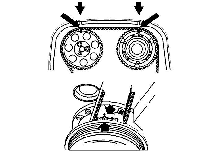

Position the engine according to the marking
pic 2
Remove the right front wheel.
Remove the nut from the cover in the fender liner.
Install the upper camshaft belt cover.

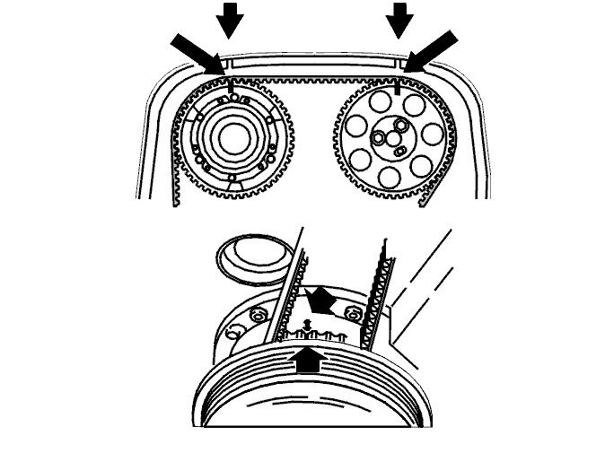

Turn the crankshaft clockwise until the markings on the crankshaft and camshaft pulley correspond.
Turn the crankshaft a further 1/4 turn clockwise and then back again until the markings correspond. The markings are illustrated.

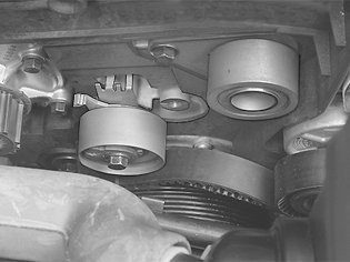

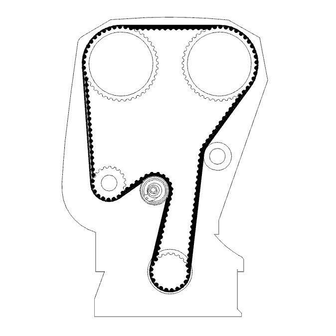

Slacken off the belt tensioner.
There are two variants of the belt tensioner.
Up to engine number 3188688 the eccentric must be turned clockwise when loosening.
From engine number 3188689 the eccentric must be turned anticlockwise to loosen the belt tension.
- Slacken off the belt tensioner center screw slightly.
- Hold the center screw in position and, depending on the variant, turn the eccentric on the tensioner to 10 o'clock (clockwise) or 2 o'clock (anticlockwise) using a 6 mm allen key.
- Remove the camshaft belt from the tension pulley, camshaft pulley and water pump.
pic 4

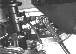

Remove the vibration damper.
Remove the oscillation damper. Use counterhold 999 5433 COUNTERHOLD See: Vehicle > Electrical / Mechanical Repair > 999 5433 Counterhold. Work the oscillation damper loose.
Remove the camshaft belt.

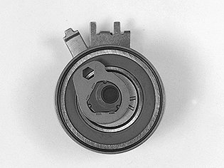

Checking the tension pulley and idler pulley
pic 5
Check for bearing wear:
Spin the idler pulley and listen for noise. If replacing with a new idler pulley, tighten to 24 Nm.
Spin the tension pulley and listen for noise. When replacing, screw the tension pulley into place with the center screw.
spin the tension pulley and listen for noise. If replacing, screw the tension pulley into place with the center screw.
Screw in the center screw by hand.
Ensure that the tensioner fork is centered over the cylinder block rib.
Ensure that the allen hole on the eccentric is at "10 o'clock".

Install the new belt in the following order:
- crankshaft
- idler pulley
- intake camshaft pulley
- exhaust camshaft pulley
- water pump
- belt tensioner.

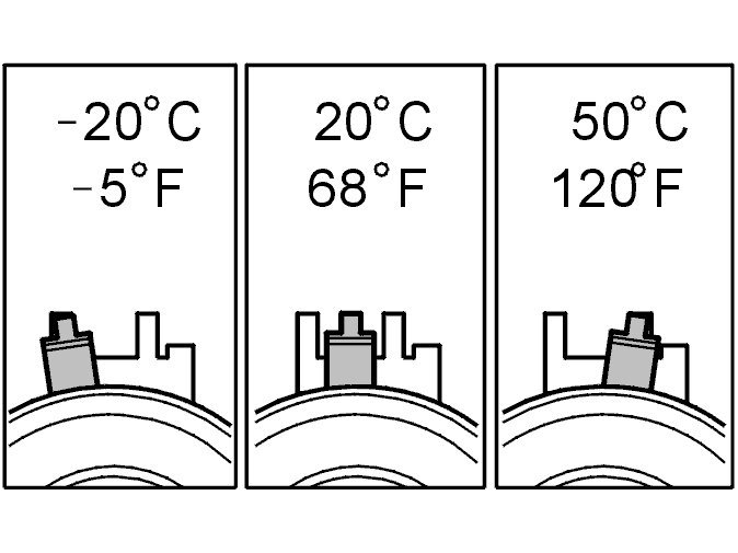

This adjustment is to be made with a cold engine. A suitable temperature is approximately 20°C/68°F.
At higher temperatures, for example with engine at operating temperature or at higher ambient temperature, the needle is further to the right.
The position of the needle, when aligning the camshaft belt tensioner at different engine temperatures, is shown in the illustration.
pic 8
Tighten the timing belt:
From engine number 3188688 the eccentric must be turned anticlockwise to tighten the belt.
From engine number 3188689 the eccentric must be turned clockwise to tension the belt.

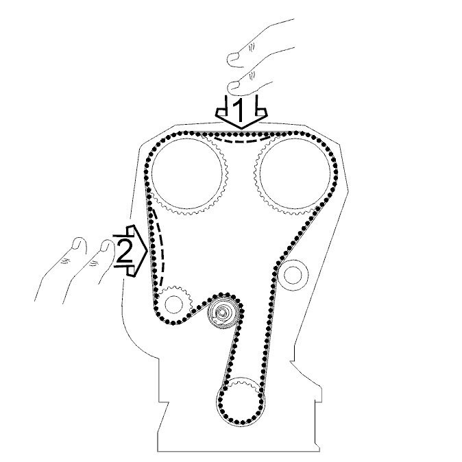

- turn the crankshaft clockwise carefully until the camshaft belt is tensioned. The belt should be tight between the intake camshaft pulley, idler pulley and crankshaft.
- hold the center screw on the belt tensioner in position and turn the eccentric on the belt tensioner clockwise/anticlockwise, depending on the variant, until the tensioner's needle passes the marked position.
Then turn the eccentric back so that the indicator reaches the marked position in the center of the window.
- Secure the eccentric and tighten the center screw to 20 Nm.
Check that the needle is in the correct position.
Check
pic 9
Checking markings:
- press the belt to check that the indicator on the tensioner moves easily.
- install the upper timing belt cover.
- turn the crankshaft 2 turns and check that the markings on the crankshaft and camshaft pulley correspond.
- check that the indicator on the belt tensioner is within the marked area.

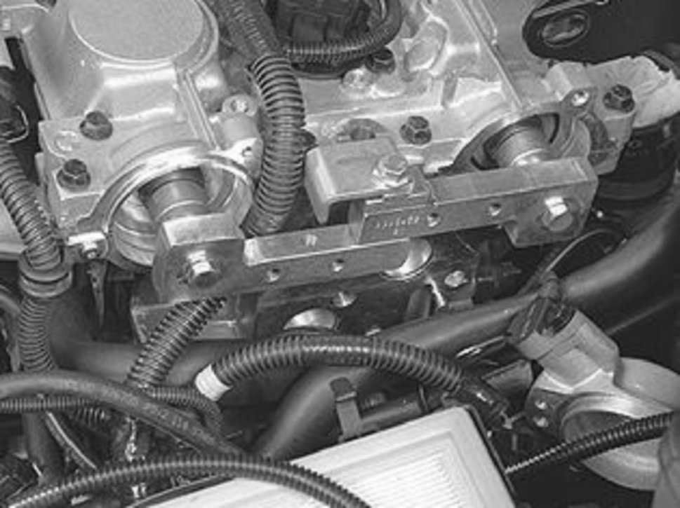

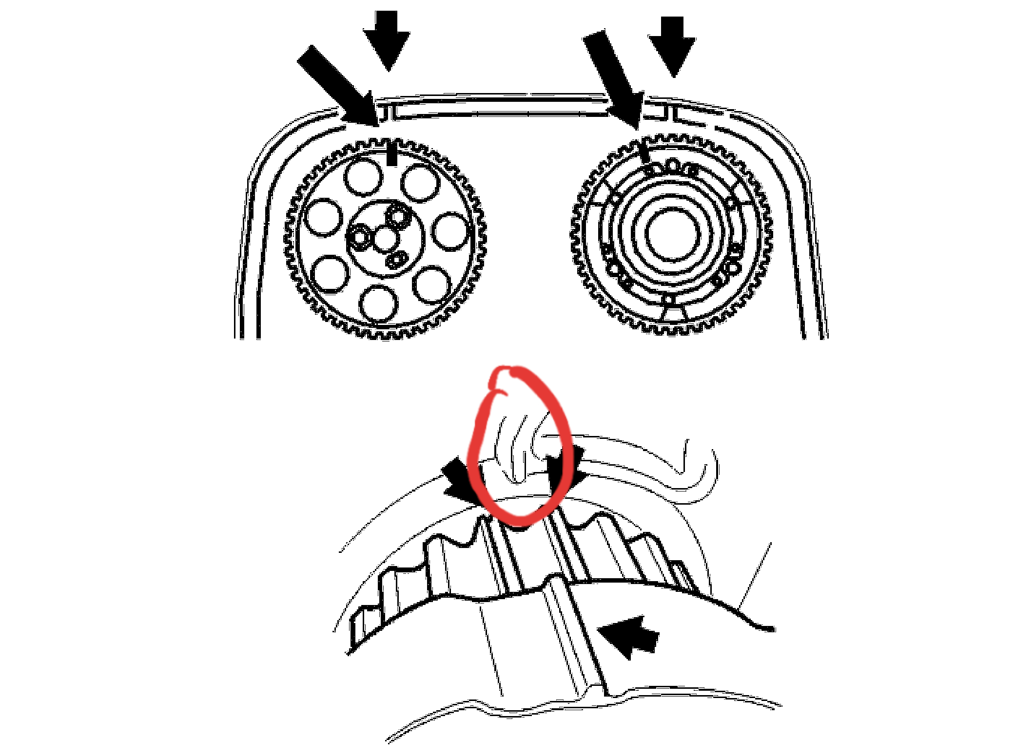

Hello and welcome to 2CarPros. First off I would not recommend you take off the cam cover since that is what holds your camshafts in place especially if you do not have much experience. The 2 notches on the crank sprocket is for you to align the crank to the oil pump dimple. See image below. The dimple aligns in between the 2 notches on the crank sprocket.
I also attached an image on how the tool set up is. Set your crank up as illustrated and then remove the timing belt. That will give you some room to move the cams a bit to set up the cam lock tool. Once set up you can remove the VVT sprockets to replace the cam seals. As a Volvo tech I already had my system of how to set the sprockets back up.
Before you remove the sprockets you will notice they are locked clockwise. Meaning it has enough play to go counter clockwise and back. Also check the VVT pulley for play. Majority of oil leaks is not the cam seals. It is the VVT hub that leaks so I recommend you replace them. Pricey but your already in.
Order new cam hub caps as well and the bolts. The actual tooth sprocket needs to be transferred over to the hub. Once you do that and reassemble snug the bolts to where you can turn the hubs clockwise and line the mark to the cover. Once lined up torque the center bolt and then install the center caps and install the timing belt. If you have any questions to the repair please do not hesitate to ask but do not remove the cam cover. Trust me, you are asking for headaches!
Also what fault codes did you get to suspect a misaligned exhaust hub? Majority of timing codes is a bad oil control valve, low oil level or low oil pressure? Any ticking sounds at idle? Also while engine running and hot pull dipstick and check for foam on the dipstick. That would indicate an internal oil leak with the pick up tube seals and can cause timing codes. Let us know please.

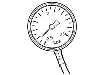

Note! Take readings at idle at operating temperature.
Warm up the engine until the thermostat opens.
Switch of the AC and other electrical equipment.
Reset the manometer using the adjuster screw.
Remove the dip stick and connect manometer 999 7226 Pressure gauge as illustrated.
pic 2
Note! The pressure values are given for sea level. High levels can reduce the reading slightly.
Read off manometer value.
The value for a clean crankcase ventilation is -0.2 kPa or lower.
If the manometer indicates a value from -0.2 up to 0.0 kPa or a positive value, the crankcase ventilation is partially or completely blocked and must be cleaned. Refer to: Crankcase ventilation, cleaning See: Positive Crankcase Ventilation > Procedures > Crankcase Ventilation Cleaning

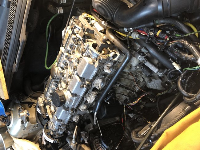

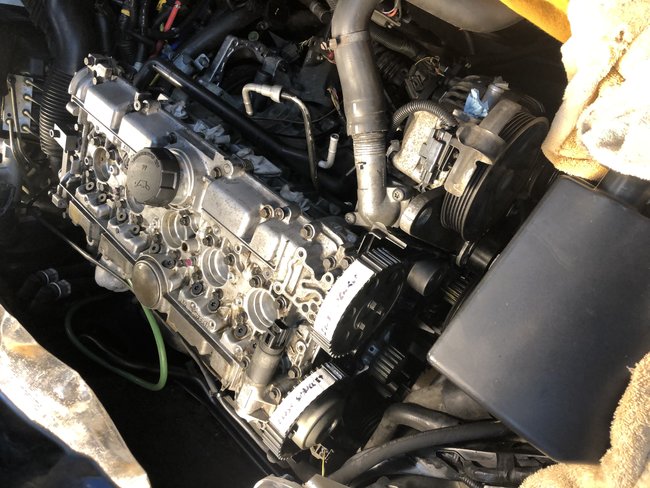

Okay. I'm ready to align the camshafts. Cam sprockets are on but loose. Crankshaft marks lined up properly and the crank lock pin is in. I want to turn the intake cam to where the writing on the end is down and the slot is flat. I want the writing on the exhaust cam to be UP and the slot is flat. (I know the slots are slightly off horizontal for perfect timing, but because the cam lock isn't designed to hold the cams that way, we'll let it go for now). With the cams locked in the position I stated, it's time to set and tighten the VVT on the exhaust cam as well as the sprocket on the intake cam. Note: The new water pump and idler pulley have been installed and torqued to spec. The new tensioner is ready to install, as are the timing and serpentine belts. If all looks good, please lead the way. I really appreciate your help!
Sep 5, 2019 at 10:45 AM
JIS001
  • 3,412 POSTS
Send me an image of how you locked the cams? If you are not using the proper tool then we are not going to know if your timed properly or not?
Sep 5, 2019 at 12:35 PM
RICK ESTESS
  • 52 POSTS
I have a Volvo 999 5452 cam locking tool on it right now. I used a homemade cam locking tool only to get the VVT bolt off after the original 999 5452 broke during the second removal attempt. That sucker was on tight - more than the 88 ft-lb torque spec. I can text and email pictures from my phone, but not from my PC, which is what I'm using to communicate with you. I'll see if I can pull up this email with my iPhone and send you the pictures if it's absolutely necessary. If you don't see them by morning it means I couldn't do it.

There is not much you can do with the intake came sprocket since it is a 3 bolt pattern and will go on as it needs to go on. The exhaust cam you need to put the center bolt snug where you have some room to to spin it.turn it clockwise to where you want it. But I recommend you line it with the mark on the cam cover. Once lined up torque the center bolt. Install the timing belt and turn engine over by hand several times to make sure no valves are hitting.

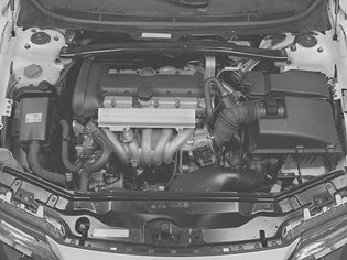

TIMING BELT, REPLACING
Timing belt, replacing
Special tools:
Note! Since the illustrations in this service information are used for different model years and/or models, some variation may occur. However, the essential information is always correct.
Remove components
pic 1
Caution! Remove the ignition key.
Remove:
- the upper timing belt cover
- the servo reservoir and the expansion tank.
Lift up and place on top of the engine.
Warning! Make sure that no power steering fluid is spilled. Extremely flammable.
- the front timing belt cover.

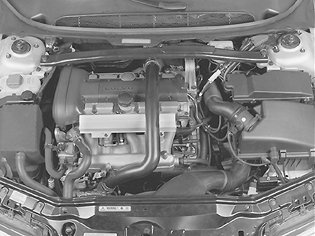

pic 2
- Remove the right front wheel
- Remove the nut from the cover in the wing liner
- Install the upper timing belt cover
- Turn the crankshaft clockwise until the markings on the crankshaft and camshaft pulley correspond
- Turn the crankshaft a further 1/4 turn clockwise and then back again until the markings correspond.
- Remove the upper timing belt cover.
Removing the timing belt
pic 3
Slacken off the centre screw for the belt tensioner slightly.
Hold the centre screw still. Turn the tensioner eccentric clockwise using a 6 mm Allen key to 10 o'clock.
Remove the timing belt from the tension pulley, camshaft pulley and water pump.
pic 4
Checking the tensioner pulley and idler pulley
pic 5
Check bearing wear:
- spin the idler pulley and listen for noise.
- spin the tension pulley and listen for noise.
When replacing, screw the tension pulley into place using the centre screw.
Screw in the centre screw by hand.
Ensure that the Allen hole on the eccentric is at "10 o'clock".
pic 7
This adjustment is carried out on a cold engine. A suitable temperature is approximately 20°C/68°F.
At higher temperatures, for example with the engine at operating temperature or at higher ambient temperature, the needle is further to the right.
The illustration shows the position of the indicator when aligning the timing belt tensioner at different temperatures.
For engine serial no. up to 3188688

Check
pic 10
Checking markings:
- turn the crankshaft 2 turns. Check that the markings on the crankshaft and camshaft pulley correspond

I know there will be damage if valves hit a piston. I know that the timing is wrong if that happens. What nobody has been able to tell me is, how much should I turn the cam to get it right? 1 turn? 1/2 turn? Could it take multiple tries to get it right or is it like a coin toss; if it lands on heads and you want tails, just flip it over and you get what you want - there's no half heads or half tails; it's one way or the other. This is what I've been trying to find out but nobody will give me a straight answer. It's possible that it's just too simple for you guys to believe that anyone could have difficulty with figuring it out. I'm not ashamed to say that I do. I'm definitely not stupid, I just want to be absolutely sure that I get this right because I've already invested over $6,000.00 in this car. I'm walking away from the car for the night.
Sep 6, 2019 at 2:24 PM
  • 110,248 POSTS
The timing marks on the cams must align with the marks indicated below as well as the crankshaft must align also at the same time as indicated below. It isn't a 50/50 shot. There is only one way it will work. If I am misunderstanding what you are asking, let me know.

Thanks for restating that. I get a little more comfortable with each piece of advice. To me, the more critical something is, the more I need to hear the same thing said in different ways; it solidifies it. When this is done, I'll be looking to help somebody else get out of this bind - pay it forward. The most important bit of info that I've been missing is this: the crank to cam ratio is 2:1. I'm betting that the main reason you guys were wondering why I couldn't get this is because I should have known it. (I found out last night). Knowledge crossover carries a lot of assumptions and as long as you're teaching new people, it's gonna happen. As long as there's mutual respect, this will work. There is and it does. And I appreciate it.

While turning the engine over by hand.

I tested the cam alignment by turning the crankshaft clockwise. I'm hearing a pop coming from the cam hub area on the exhaust side. (No valve to piston contact which means the big problem has been solved!!)The pop sounds after about every seventh tooth on the timing belt passes over the sprocket. I've been told that it's just the sound of the cam turning over and it's nothing to worry about. Is this true? I need your input before I put everything back together. I want to get my car back on the road tomorrow! It's been two months! Thanks for all your help!

Post a video so we can see and hear the exhaust hub please. It might be normal since oil is pumping into the hub but I still want to confirm the sound.
