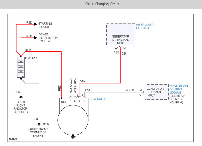

alternator wiring diagram - batter not charging?
1999 CADILLAC DEVILLE
AFRO2
the battery not charging message came on. i turned the ignition off and car will not start when i tried to turn it on again.

It sounds like the alternator went bad but to be sure let's jump the battery and check the alternator here are two guides to help us get started.

For about two months my car's computer has been showing intermittently that the battery was not charging. It would be fine for days then for a few minutes the message would come up on my screen.
It has progressed now to the point that it is on steady and today the power level must have gone down significantly as power systems started shutting down.
The battery is new as I bought it 6 weeks ago so I am guessing by these signals that the problem may be the alternator.
What am I faced with if I decide to replace the alternator myself.

You should check the alternator first before you replace it, most auto parts stores will do this free of charge.

Recheck the battery. The cables may not be tight enough to provide good contact.

it sounds like you have an alternator diode that is out.

Sounds like you have a very large parasitic draw. If this only occurred after the ignition cylinder was replaced I would start with a visual inspection of the wiring harness and see if it is pinched or shorted under the dash where the work was done.
If the battery itself was disconnected during the repair it is also possible that there is a bad connection there and the voltage drop is due to a bad cable. GM cables are bad for corroding inside the housings for the battery terminals.

alt will not charge when first started but in 5 to 10 mins. works fine 14.3v and works good all day. Battery test good . But battery needs replacing about very 6 months car not driving far or much. alt test good when working.
Feb 12, 2019 at 6:01 AM (Merged)
HMAC300
  • 48,601 POSTS
check battery for condition including load test then make sure terminals are clean as well at engine and body like the grounds. check fusible link to alternator it may only have a few strands connected causing your problem.

The "BATTERY NOT CHARGING LIGHT" refers to a problem with the charging system. It could mean that the alternator is not charging properly. You should have both the battery and the alternator tested to make sure the alternator is putting out the proper charge and the battery is able to receive and hold a full charge. Also make sure the battery cables are tight.

Check battery cables POS to starter and NEG to block.

car does not charge battery have had alternator replaced still have problem dash shows system not charging drains battery and dies some times message goes off car runs ok for a little while . have had car checked at a mechanic could not find problem. dont trust car any more so dont drive it.any suggestions?

it can be a connection proble from pcm and or alternator so would need to be checked for that.

old alternator died and replaced it with a new one but now it does not charge. traced it down to no voltage going to the regulator
Feb 12, 2019 at 6:03 AM (Merged)
WRENCHTECH
  • 20,761 POSTS
So, apparently the alternator wasn't the problem. That power is supplied by the PCM but my diagrams don't show where the PCM gets it from. I would use a test light and test every fuse with the key on. https://www.2carpros.com/images/external/81022107.jpg.gif
