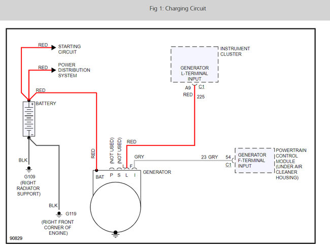

Alternator wire diagram or schematic please!
1999 CADILLAC DEVILLE
MR.LUTTRELL
the alternator wire somehow got melted or cut and was hanging from the alternator its two wires i believe red n yellow or green. i cant find the other end to patch or replace the plug.

Here is a guide to help you test the connections and the alternator wiring diagrams below. Check out the diagrams (Below).
