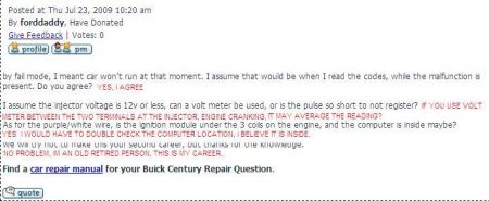

by fail mode, I meant car won't run at that moment. I assume that would be when I read the codes, while the malfunction is present. Do you agree?
I assume the injector voltage is 12v or less, can a volt meter be used, or is the pulse so short to not register?
As for the purple/white wire, is the ignition module under the 3 coils on the engine, and the computer is inside maybe?
we will try not to make this your second career, but thanks for the knowledge.

https://images.2carpros.com/forum/automotive_pictures/170934_buick_century_3.jpg
I'm not sure that is readable, I tried to do something different, my computer skills aren't very good.

Barely, but i got it. a good way to answer, but very small text.
