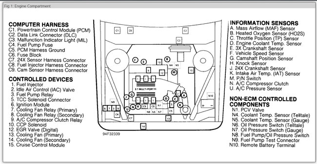

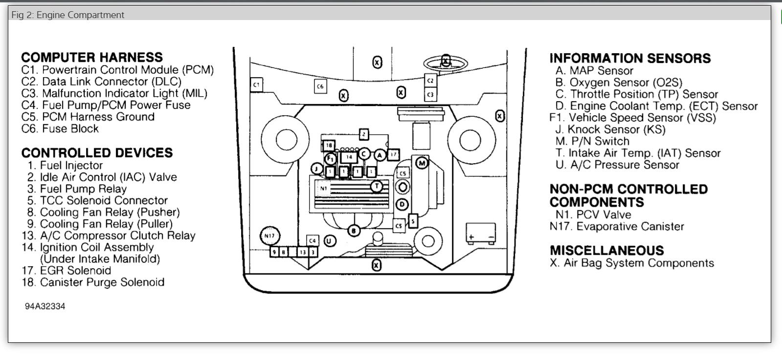

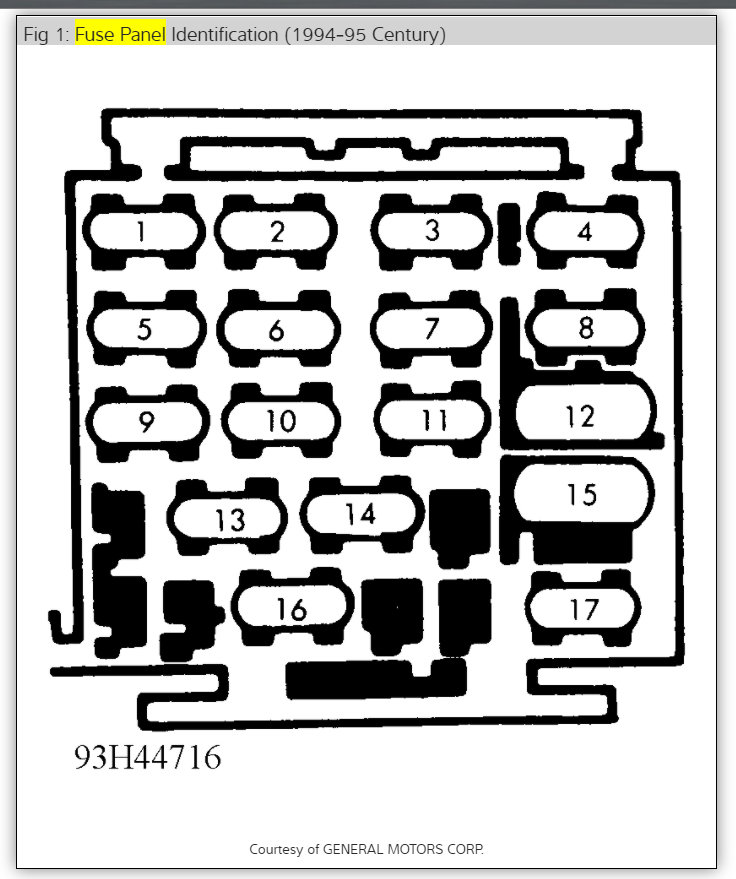

My understanding is that this fuse is located behind the passenger headlight. It was dark out last night and I don't think they were marked. There were at least 3 or 4 that I could see. They all look the same. My car wont start. It cranks fine but I can't even get a single pop out of it. No firing at all. I would like to check the fuse and hoping it is an easy fix.

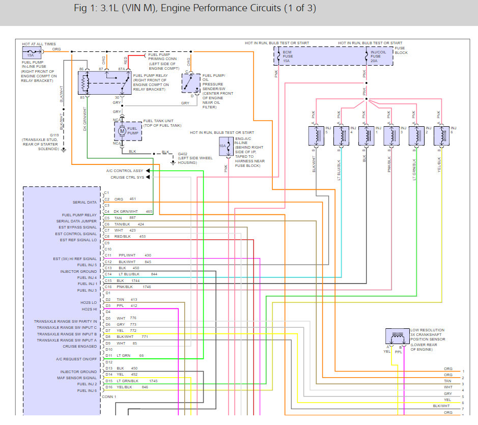

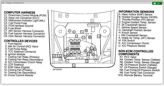

The fuel pump relay is on the front core support on the right side near the radiator. The fuse is right next to it. Here is a diagram for you CLICK BELOW.

Where is the fuse located for the fuel pump? The manual just says it is under the hood.

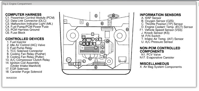

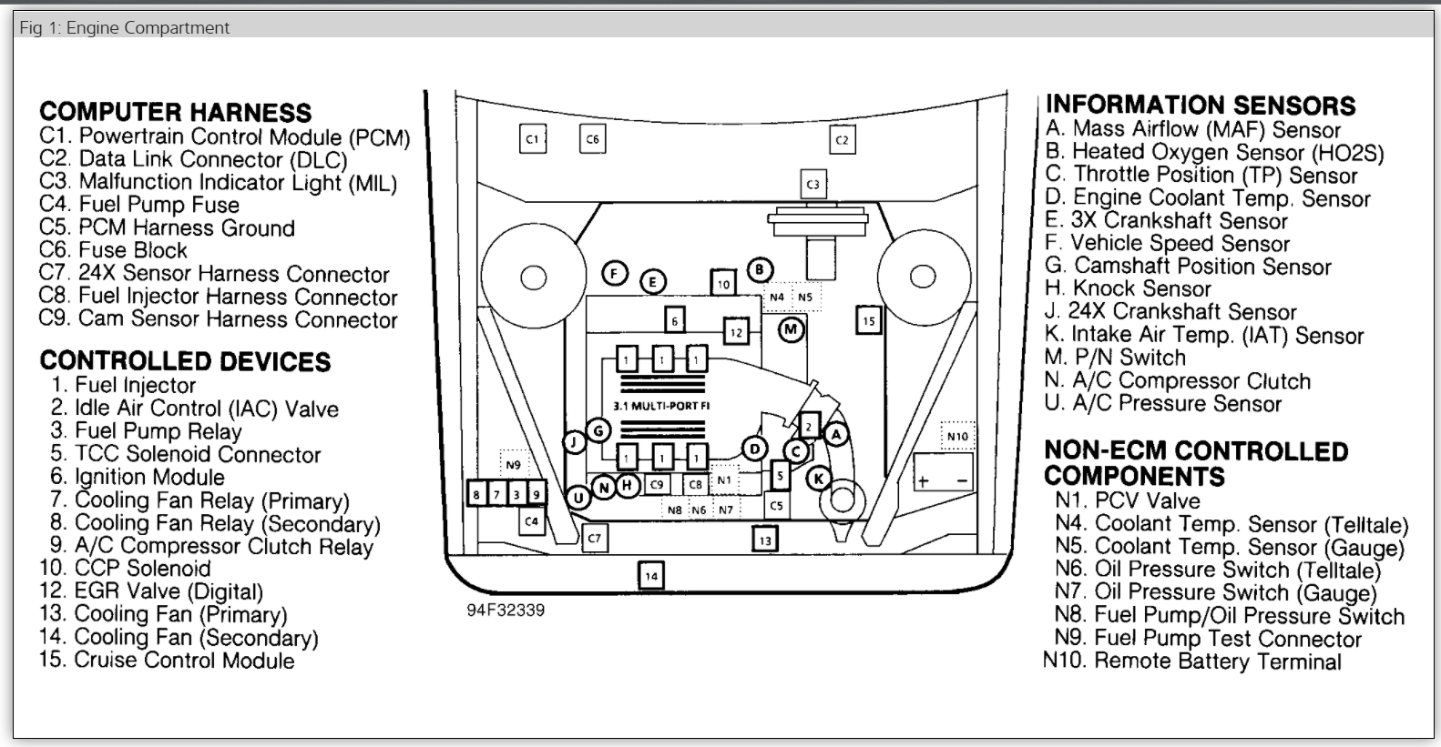

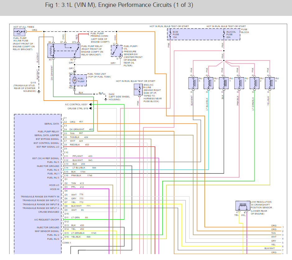

The fuel pump fuse is in a stand alone fuse holder near the wiring harness in the engine compartment right front on the relay bracket, C4

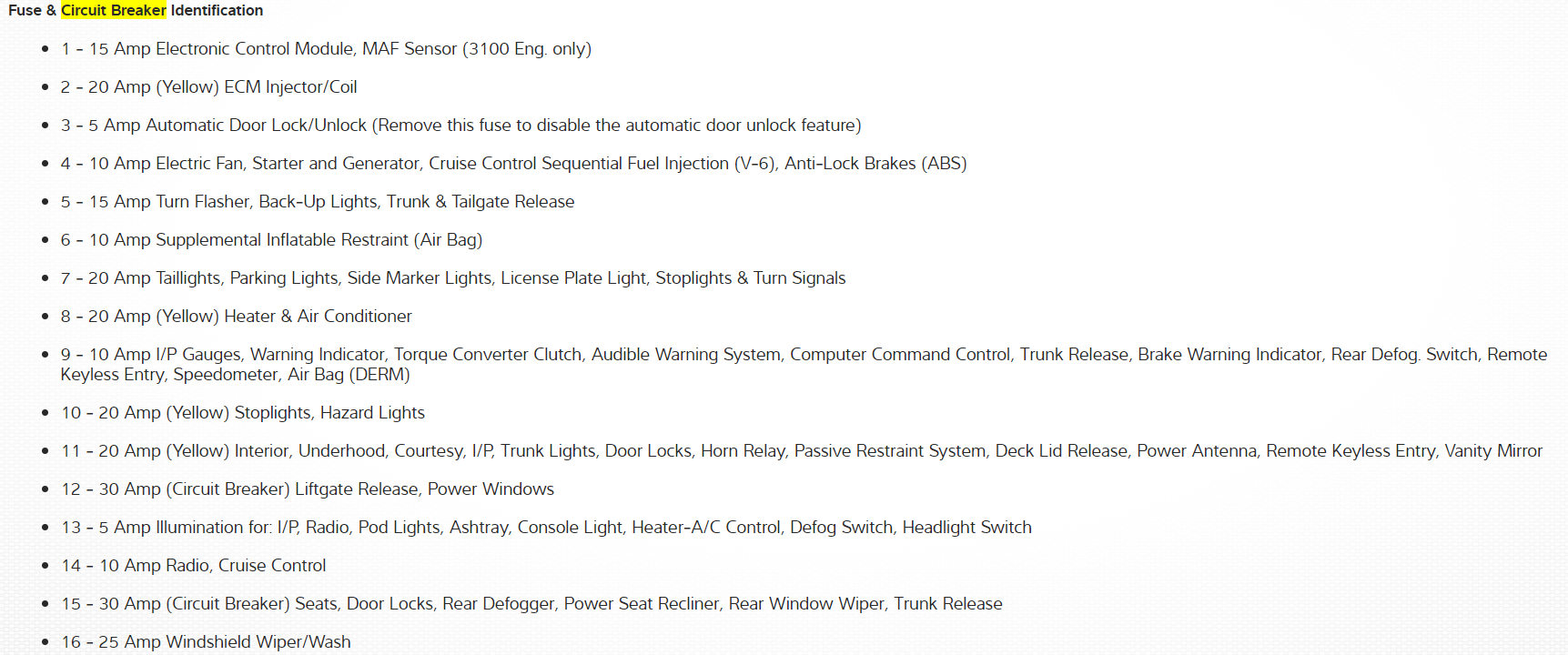

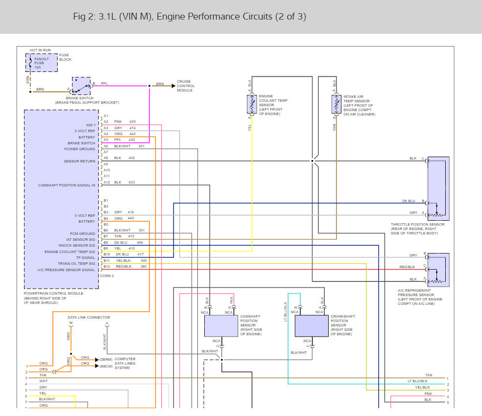

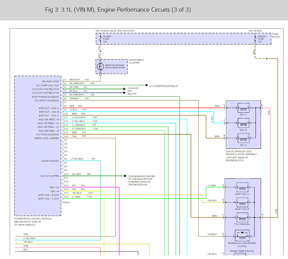

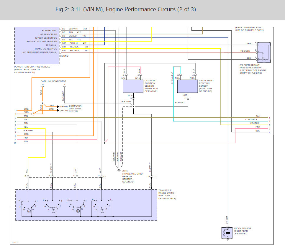

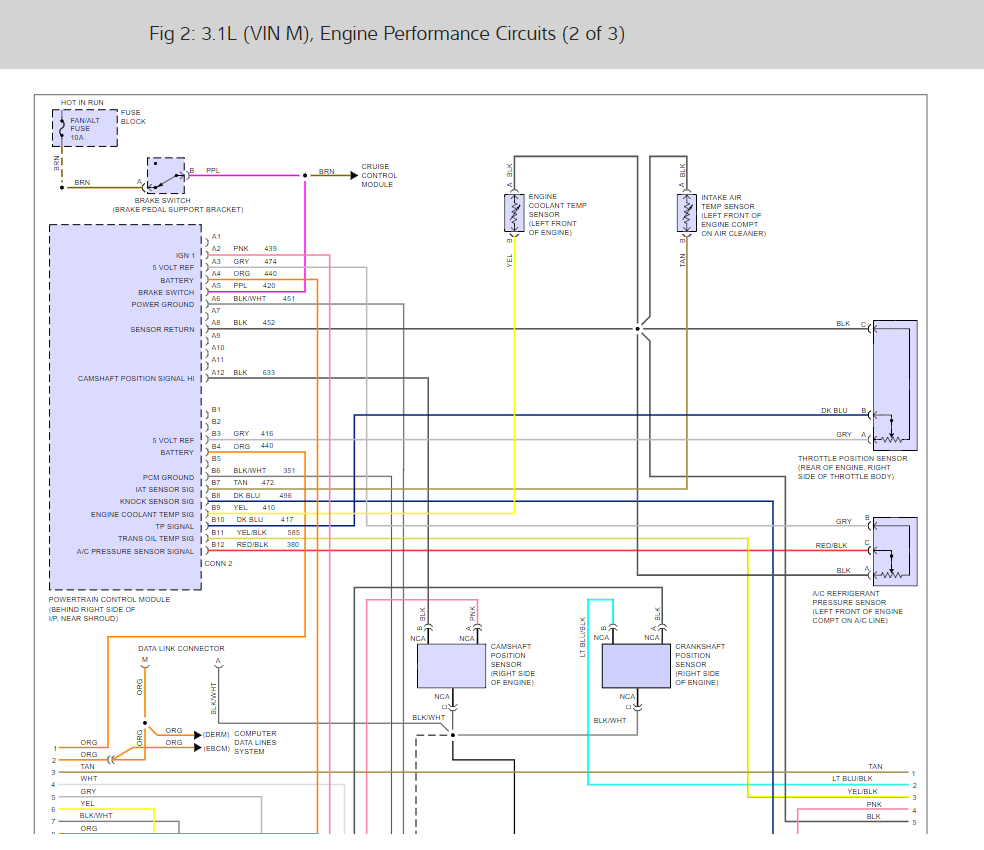

Here is a guide and some fuel pump and engine wiring diagrams along with the fuse panel diagrams (below).
