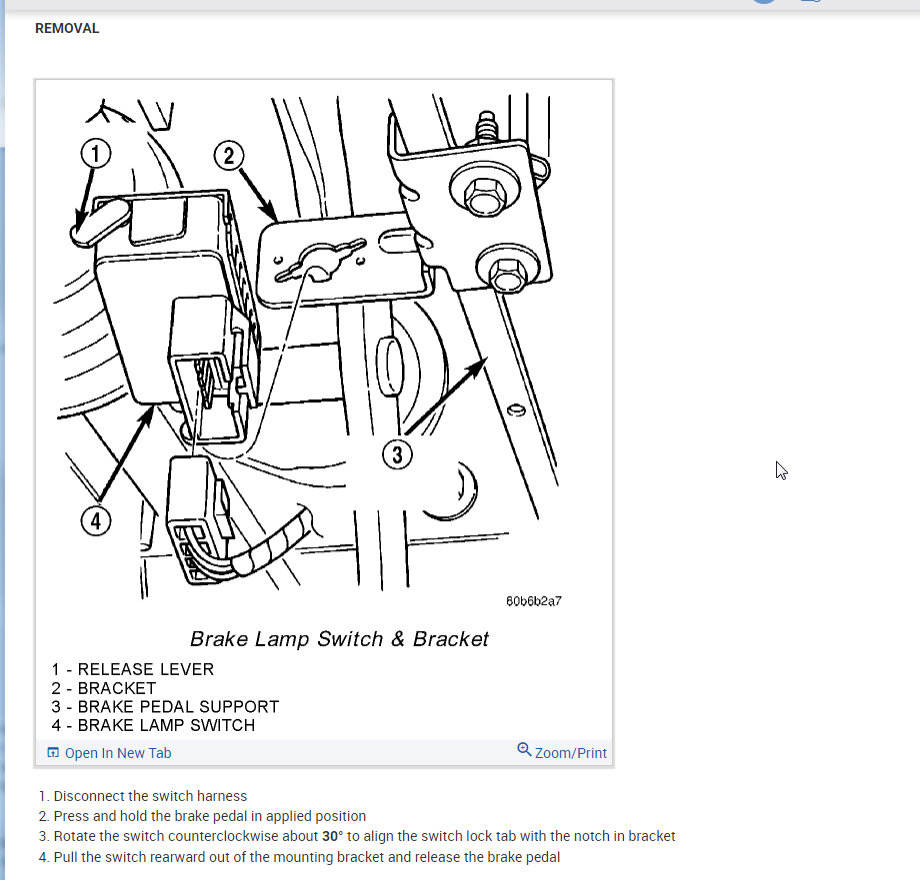

I have recently noticed my brake lights have been not working?
2004 DODGE RAM
101,350 MILES • 5.7L • V8 • 4WD • AUTOMATIC
COWTIT
I have recently noticed my brake lights have been not working?. I have read some post and hear people having problems when this happens. Just wondering where I should start to diagnose this problem? Brake switch I assume?
Apr 18, 2016 at 2:35 AM

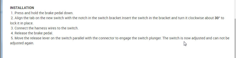

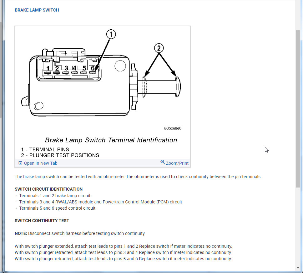

If all the brake lights are out then yes, the switch is most likely the issue.
I attached below the process on how to test the switch and how to replace it as I am sure this is going to be your issue.
Here is a video on a different vehicle but they are all pretty similar so it should give a good idea on how to get it replaced:
https://www.youtube.com/watch?v=RBCDVfzNQGk
Please let us know what you find with this. Thanks

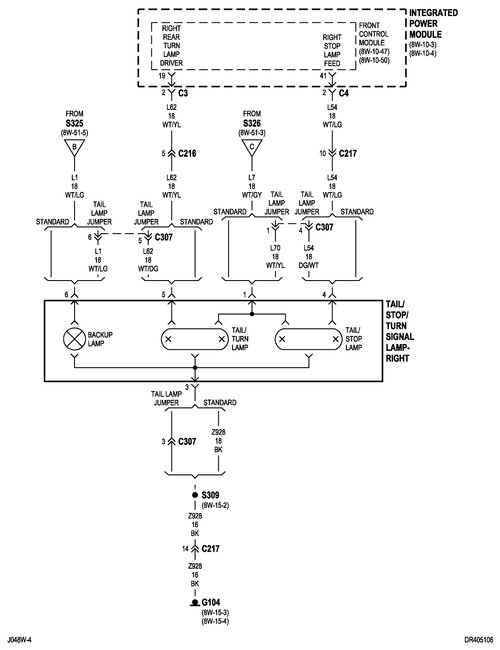

When i turn my head lights on my brake lights will not work. When i turn the head lights off they work. Now all of a sudden the drivers side tail light wont even come on. I have replaced the bulbs, both circuit boards on the tail lights also checked all the fuses. I cannot seem to find the problem.
Mar 17, 2021 at 11:22 AM (Merged)
CARADIODOC
  • 34,378 POSTS

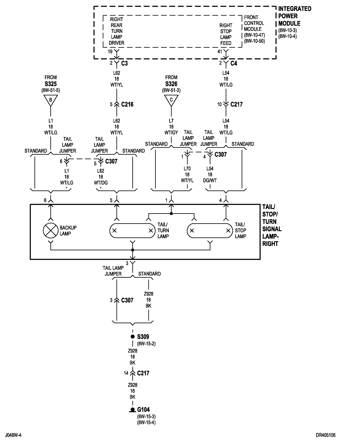

Your first two sentences are the classic symptom of a broken ground wire. Start with a visual inspection of those wires. If we need to go further, do you know how to use a digital voltmeter?
STEVE W.
  • 15,344 POSTS

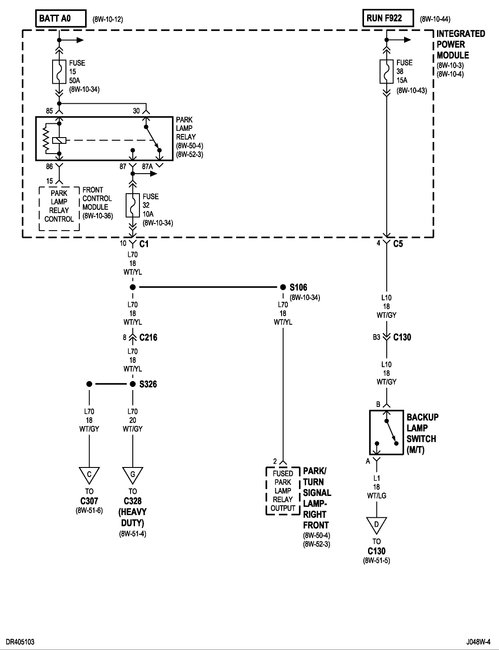

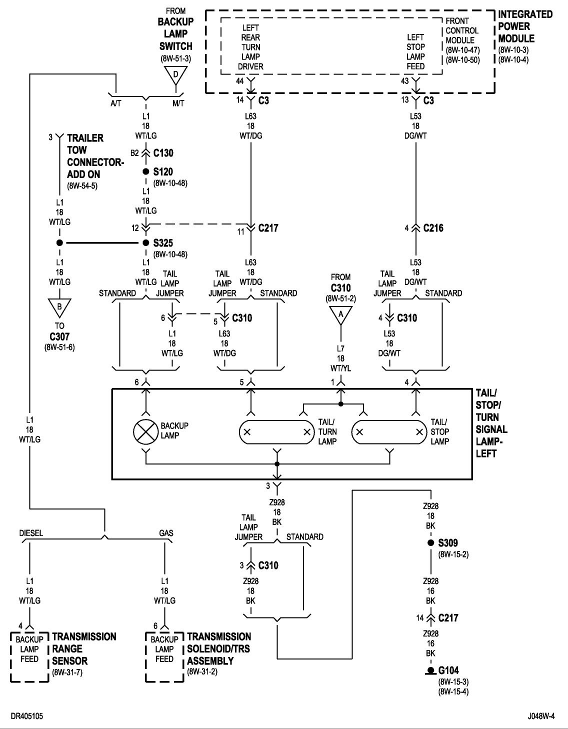

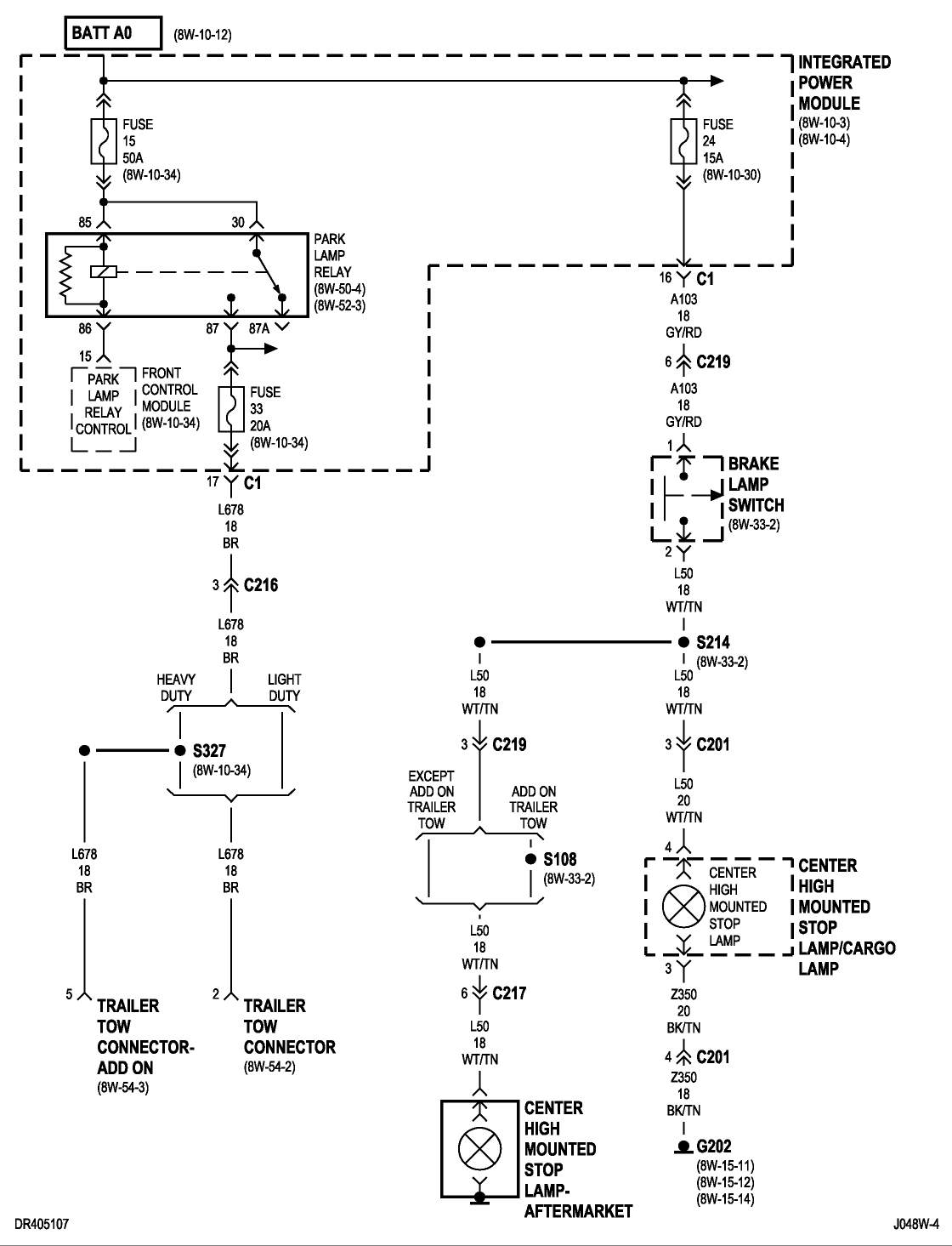

First thing to check is if you are getting power to the rear tail light. Pull it open and with the lights on check for power at pin one (white/yellow stripe wire) in the connector. If you have power check the connector inside to see if the actual connector is loose on the pin on the circuit board.
Since all of those lights share a ground it is likely to be a power feed issue. from the park lamp relay. If it is turning on (should be if all the other park/tail lights work) then it is in the wiring to the left tail light, either the pin is loose or the wire is bad.
Now for the brake lights, the only common items between the headlights and the brake lights (if nobody has played with the wiring) are the forward control module and the IPM.
To see if it may be the problem, check at the brake light switch for power on one terminal and not the other. Then turn on the lights. if the power goes away now it is the IPM or forward control module,
Below are the wiring schematics to give you the wire colors to test.
SCOT91
I do have a voltmeter but im not familiar On using them. I do have a test light. But I took my test light and checked the pins on the connector on the tail light on the side it isnt working. The only thing isnt making my test light come on is the brake light. I had the key on the off position and tried the 4 way blinkers and they wouldnt work. Only way they would come on is if i turned the key to the on position. And what is the IPM?
SCOT91
Ok on the side that wasnt working its working now i wiggled the connector and they started to work. On the passenger side taillight the middle bulb is bright and the top bulb is kinda dull. The drivers side looks normal. what would cause that? But i have no Brake lights now even when the lights are off.

STEVE W.
  • 15,344 POSTS
Here is a guide on the meter.
IPM is the integrated power module. Basically the fuse box and it's controls.
Wiggling the connector tells me you have either a weak connector pin or the wire is broken inside the connector. Both cause the same symptom. I would get a replacement pigtail and install it. That would repair both failure types at once.
4 ways not having power unless the key is on suggests the you may have an issue in the IPM, possibly a blown fuse or bad fuse connector.
I am not sure which fuses you are checking because the brake lights are controlled through the front control module. However, they are powered through a lighting fuse but so are the parking lights so if the brake lights/tail lights are the only thing not working then the fuse is okay. So let's check the front parking lights as well. If they are not working then you have an issue with the relay.
So, if you are not getting power to the fuse then the relay that is feeding these fuses is not okay.
Here is a guide that will help with testing the park lamp relay:
Below is the wiring diagrams that you will need to do this. Please run through this material and let me know what you find. Thanks

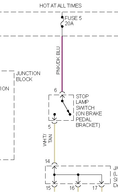

Electrical problem 6 cyl Four Wheel Drive Automatic 130000 miles

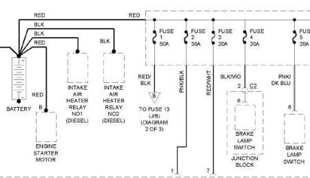

My brake lights quit working a few days ago. All other lights on the truck work. The cruise control works. The bulbs have been tested, they work, the brake controller (aftermarket) has been tested, it works. The brake switch was replaced twice. After that, I diagnosed the leads into the switch. There is NO constant hot into the switch (I believe there should be - pink wire w/ blue(I think) tracer). There is no power coming into the switch at all. I believe dodge sends the brake switch HOT through a multi function switch. Is there a diagram available for this that can be posted? Can the multi function switch be tested? It is a $110 part so I do not want to replace without being sure. The Chilton manual wiring schematics are worthless and very incomplete.
In addition the wiring schematic from the multi function switch to the fog lights would be appreciated, those have not functioned for several years. The lead that grounds out when activated, does not fully ground out (minimal voltage remains).
Vehicle, more specifically that above is a 1999 Ram 2500 Diesel. It is a half year vehicle in that it uses a brake switch from a 2000 Ram.
JDL
  • 16,098 POSTS

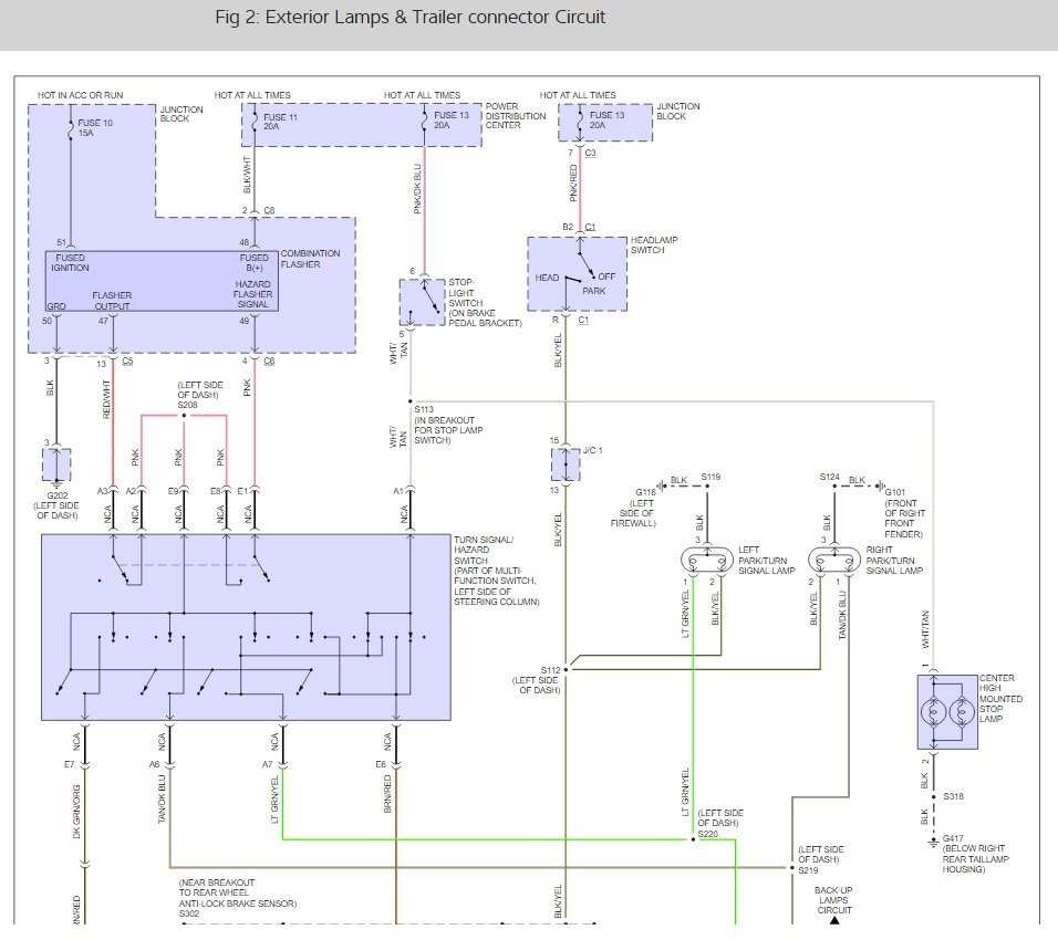

That is ignition feed, pink wire/dark blue tracer, to the brake switch, goes hot when you turn on the key, there is also a fuse, this info says fuse c 20 amp. If there is a junction where that feed comes from, other than the ignition switch.
Here are a couple of guides and diagrams (below) that will help you get the problem fixed.
and
Please run some tests and get back to us we are interested to see what it is.

Thanks but I need the internals of the switch and before the switch so I can check the power in and jump the switch as a test. Also, am I viewing the pictures the wrong way?
This is exactly what I'm looking for.

JDL
  • 16,098 POSTS

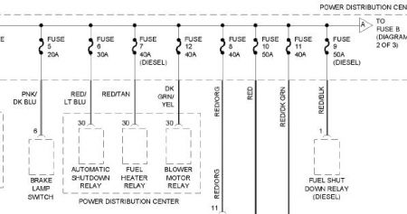

Hello again, after my morning coffee, I think the brake lights should work, even with the key off. I looked at a couple of databases on the diesel. I think that circuit should be hot all the time. The ignition switch shouldn't have anything to do with it.
The wiring diagram me and you both looked at, does show that fuse circuit goes hot, with the key on.

JDL
  • 16,098 POSTS
https://images.2carpros.com/forum/automotive_pictures/170934_better_diagram_1.jpg
Is that any better? The diagram I was looking at, I increased the magnification, before I copied, then posted. That fuse is located in the power distribution center.

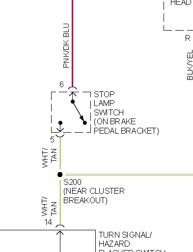

on my 99 Dodge ram my brake lights are not working, the turn signals work, the running lights work, the hazard, the headlamps work, all the lights work except for the brake. I replaced the 20 amp fuse under the hood I replaced every other fuse or relay you can think of and the brake switching the pedal. I have no idea what it can be at this point.
CARADIODOC
  • 34,378 POSTS
Does the brake light over the rear window work? If not, check for voltage on the pink / dark blue wire on the brake light switch, then on the white / tan wire. The first one should have 12 volts all the time. The second one should have 12 volts when the brake pedal is pressed.
If the center high-mount brake light works, the brake light switch is okay. The suspect then is the turn signal switch.

Thank you for getting back to me so quick it ended up actually being the brake switch, i replaced it but one of the pins on the inside was bent wrong. On the new switch so it did not work..... corrected the problem and it works great now thanks again for all your help

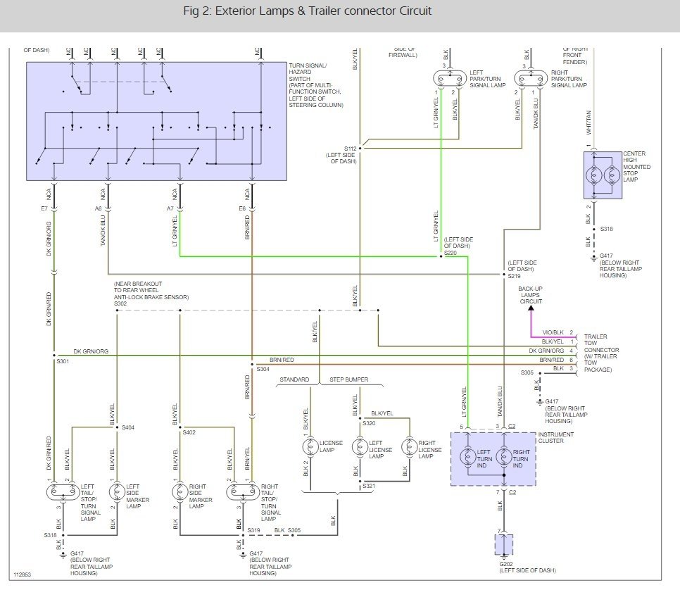

Whenever i applied my brakes it blows my brake light fuse change the switch still does it..any help please
Mar 17, 2021 at 11:23 AM (Merged)
CARADIODOC
  • 34,378 POSTS

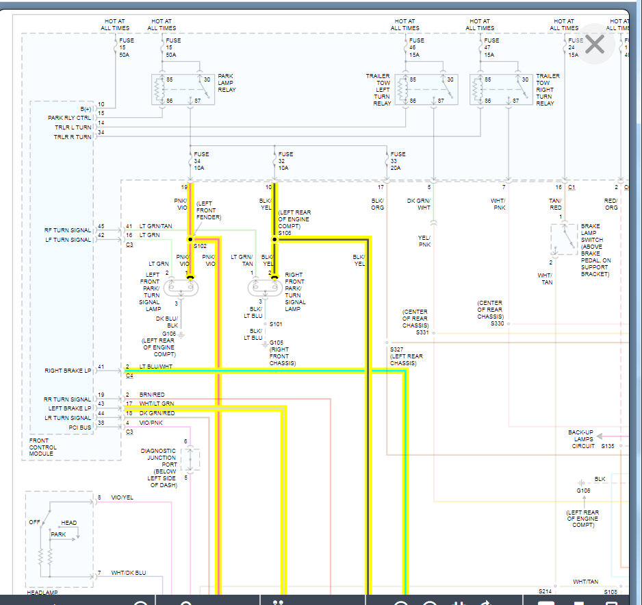

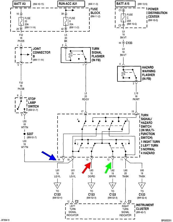

If the fuse doesn't blow until you press the brake pedal, that proves the brake light switch is okay. Even if the switch was shorted, the symptom would be the brake lights stay on all the time. You have something shorted after the brake light switch. That is what we have to find.
Before you do anything else, check if there is a trailer wiring harness added on and if those wires are chewed up.

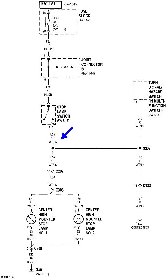

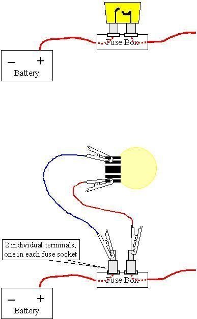

The first thing to do to narrow down which circuit needs to be diagnosed is to observe there are three separate circuits. There's the left rear brake light, the right rear brake light, and the center high-mount brake light. As luck would have it, the two rear brake lights are the same ones used for the turn signals. If either of those circuits are shorted, the turn signal fuse will blow when that side is activated. See if the signals work on both sides or if one side is dead.
Once the shorted circuit is identified, it is too costly an ineffective to keep throwing new fuses at it. Instead, plug in a pair of universal crimp-type spade terminals in place of the blown fuse, then use a pair of small clip leads to connect them to a small 12-volt bulb. A 3057 brake light bulb works well for this type of circuit. The bulb will limit current to a safe one amp. When the circuit is turned on and the short is present, the bulb will be full brightness and hot, so be careful what it is laying against. Now you can move things around and unplug connectors to see what makes the short go away. When the short is out of the circuit, the bulb will go dim, and you may see the other brake lights turn on very dimly. The first drawing shows using the bulb in place of the fuse.
The second diagram shows the brake light switch. The short has to be someplace after the blue arrow. That circuit goes directly to the center high-mount brake light, but it has to go through the turn signal switch to get to the two rear brake lights. If you follow the white / tan wire to the right and up, it goes to terminal 14 of the turn signal switch. In the third diagram, the blue arrow shows terminal 14 again, and if you follow it around through the switch assembly, it comes out on terminals 15 and 12 when the switch is at rest. Those are the two individual rear brake light circuits. The triangles with "C" and "D" inside indicate the circuits are continued on the next diagram.

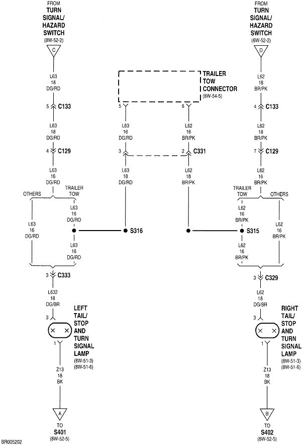

Diagram four continues those circuits to the rear brake light bulbs. These are the two circuits where the short has to be, or it is on the circuit going to the center high-mount light shown in the second diagram.
If you haven't identified which of the three circuits has the short, consider unplugging the connector from the back of the turn signal switch. There is usually a bolt to remove, then the plug can be pulled out. That will isolate the two rear brake / turn signal circuits from the fuse or test bulb. If the test bulb is only dim now when you press the brake pedal, the short is not in the circuit. You can put a new fuse in and observe the center brake light works properly.
Let me know what you find up to this point, then we'll figure out where to go next.

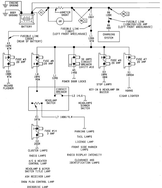

Take a look at the fusible link L1 If it is burnt/corroded you lose all of those or if the circuit has failed to it. Easy way to test if it is related to that is to check for power at fuses 7,8 and 9 as they are the system feeds for those items.

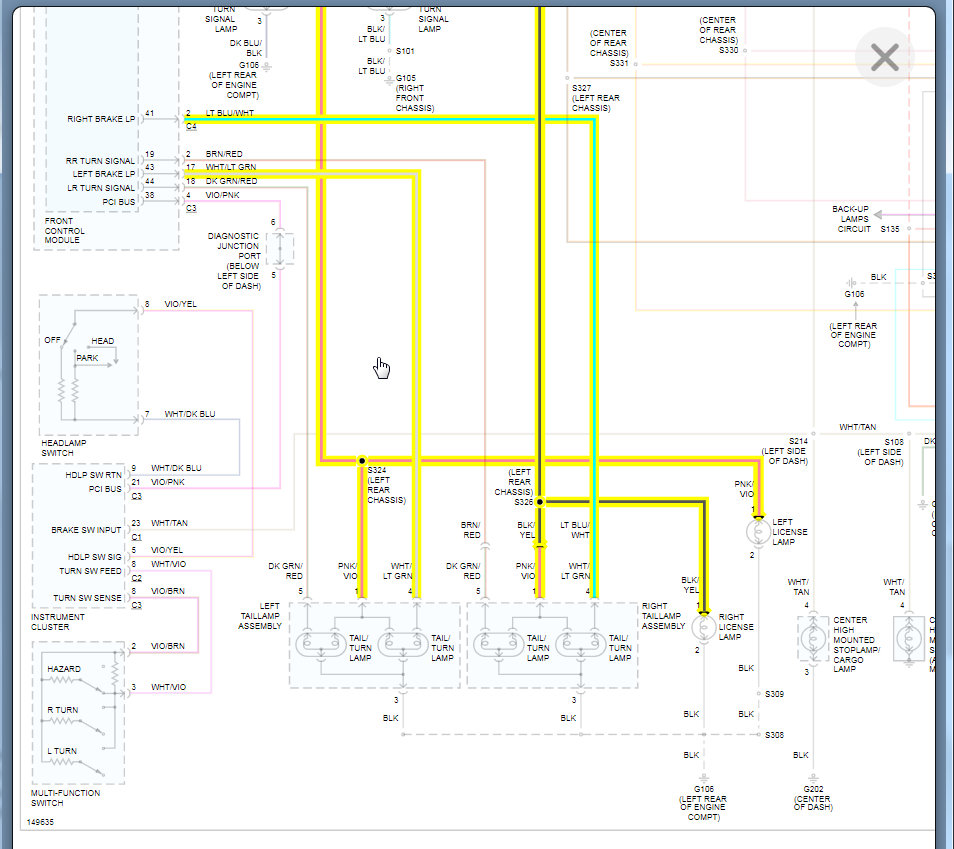

I do not have any breaklights though, all my other lights work including the hazards. I replaced the break switch with no luck. I checked for power/ground over the four wire plug and get nothing, I do get continuity over the 2 wire plug from the break switch to ground. Just not sure what/where to check next.
RANDICO
  • 174 POSTS
The combination switch. Or the turn signal switch , the brake light signal goes from switch to turn signal switch to brake lights
SRKLEPPIN
  • 5 POSTS
No power at all at the brake switch. Checked all the wires to ground from the switch.
four terminal plug
Blue/Red tracer - open to ground
White/Red tracer - open to ground
White - open to ground
Blue - open to ground
two terminal plug
Pink - no power - continuity to ground
White - no power - continuity to ground
removed the brake switch and rechecked with same results.
Would it matter if the turn signal works as well as the hazards and running lights?
