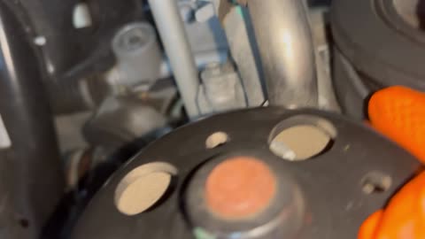

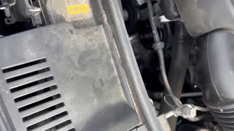

I have a belt chirp, and I determined that the idler pully has dry bearings, and I spun the idler pully and it free spun and it wobbles a little. I also checked the tension pulley, but it doesn’t make any sound when the belt is off, and it seems good but when the belt on and running, I hear some kind of noise but it may be normal. I need a second opinion on it before I spend the money replacing a good part.

This is the sound.
Sep 15, 2024 at 10:59 AM
  • 110,244 POSTS
I do hear a little bit of a whistling sound. Is that what you are referring to? If it is, to me it sounds normal to an extent, but I'm not there to hear it and it could be a bearing related issue.
As far as the tensioner and idler, they could make the noise. If the idler pulley wobbles, that is not normal, so chances are it needs to be replaced.
We have the same vehicle I purchased new in 2013. At 140K, the belt is still original as well as the items you mentioned. With that in mind, I'm surprised there would be an issue at 40K, but anything is possible.
Let me know if it is the idler pulley that has a wobble, and I can get you directions for replacement.
Sep 15, 2024 at 12:42 PM
SKOOTER28
  • 98 POSTS
Yes, the idler pully ik for sure is bad cause that sims and its metal on metal sound when i put the screw driver to it but when i put it to t the tensioner pully i hear a low bearing noise but if I take belt off the tensioner pully doesn’t seem bad it moves like it’s supposed to without any noise and it's not dry but with belt on and running with the screw driver with the milk kid attached it’s amplified and I can hear it but ik sometimes bearings will make noise but the only one ik for sure is the idler.

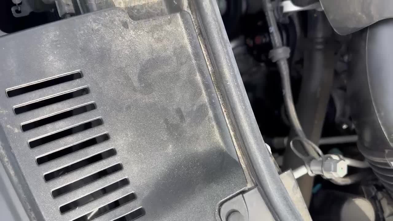

This is the original sound.

  • 110,244 POSTS

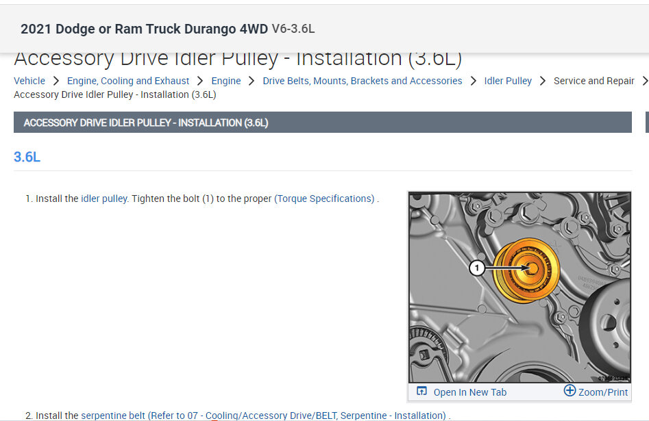

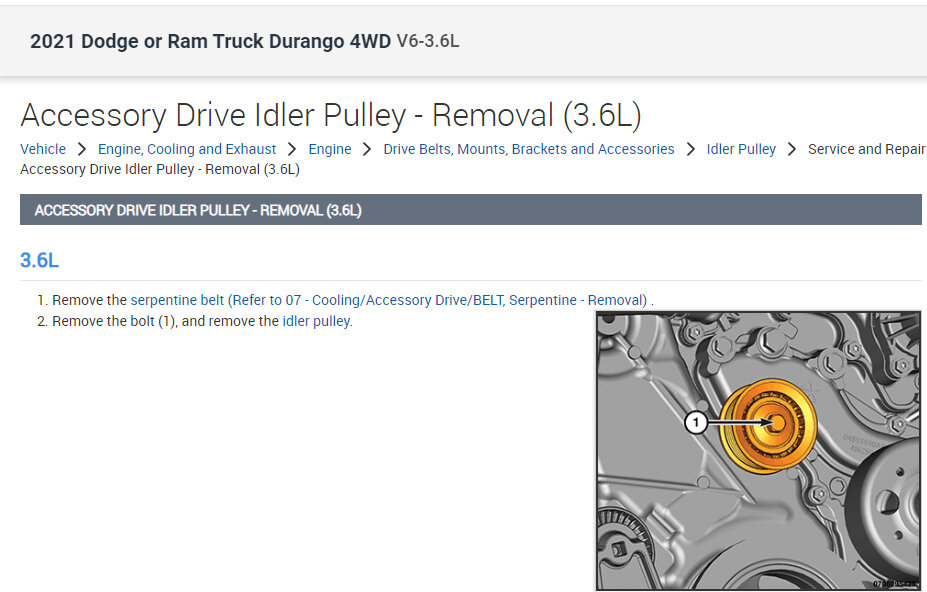

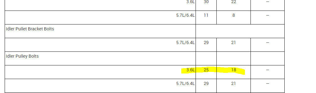

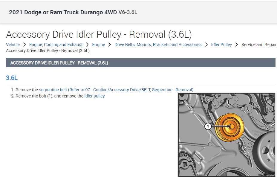

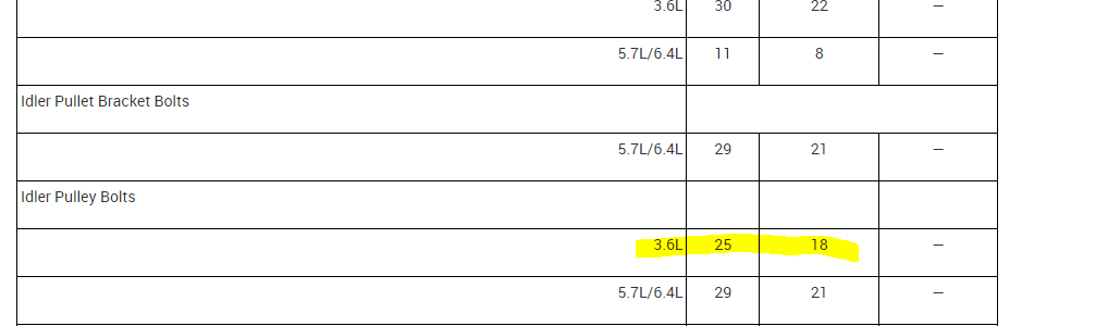

That is where I would start. I suspect the idler itself will resolve the issue. I attached the directions below and the torque specifications. Note it is 18 ft/lbs.
Let me know if this resolves the issue.

Replaced the idler pully and the belt was stretched and the tensioner was good but replaced it anyway and still a noise I checked all the pullys and I spin the water pump pully and no sound but it makes a noise in and out .
Sep 24, 2024 at 9:41 AM
  • 110,244 POSTS
Is there any side-to-side movement in the pump? I wouldn't think there should be play, but anything is possible. Also, is there any evidence that coolant may be leaking from the pump's weep hole? If any coolant or other contaminate is getting on the belt, it will make noise.
Sep 24, 2024 at 12:31 PM
SKOOTER28
  • 98 POSTS
I don’t see any play, but I can hear that noise when wiggling the pully.
Sep 24, 2024 at 8:40 PM
SKOOTER28
  • 98 POSTS
My eyes aren't the best but that noise can’t be normal.
Sep 24, 2024 at 8:43 PM
SKOOTER28
  • 98 POSTS
It makes an almost like a slight knocking noise when I wiggle the pully in and out, but I can’t see it actual moving but it’s making that noise that video I sent was what I hear.

Since you have a belt noise and the play is present, there is a chance the bearing inside the pump is failing and causing the noise you hear. It's a theory, but it's possible.

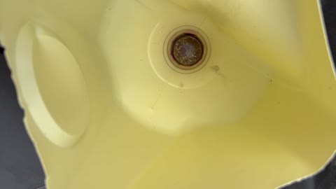

I think it’s an engine tick idk where they got that from, I think they were just guessing at it all, but I’ll put the phone to the milk jug maybe it’ll amplify.
