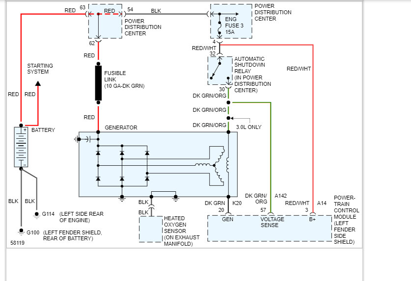

Okay, how about this Roy? Would you have a pin diagram with the pin numbers of the ECM or whatever it is called with the internal regulator? Or is there a procedure to test the voltage regulator with say an ohm meter?

The wiring diagrams show the circuit are the connections melted or what is the problem?

Well I replaced the black box thing near the alternator with another one. When I removed it. There was a broken tab that connects to the alternator. Thought that would fix the problem and it didn't. Can the alternator be tested on the vehicle with a volt meter then there must be a way to test the voltage regulator with an ohm meter within the ecm? But what pins? If the brushes are totally worn in the alternator would it not throw a charge? Thanks

  • 52,797 POSTS
Okay, start the engine and put the voltmeter on the battery and tell me what the voltage reading is on the Dc scale.
Lets start there.
I attached a diagram for you to view. You will use a voltmeter as well to test the ECM control of the regulator.

Okay, I did that. It read 15 volts before starting and the 14. While running. But my voltmeter on the dash is only reading about 12 volts? Whats next? Can you give me a couple tests to run? I don't have my own computer to take out there.
