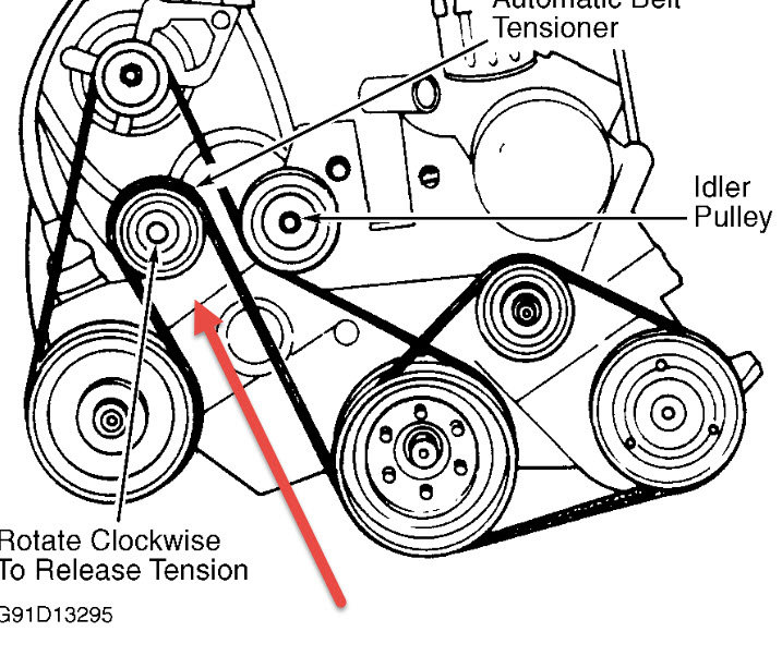

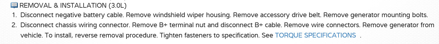

hire one of us lol, just kidding. this is for a 3.0L as we dont' have engine size other vehicles similar...see pics. tensioner will have bolt or square hole for rachet etc.
