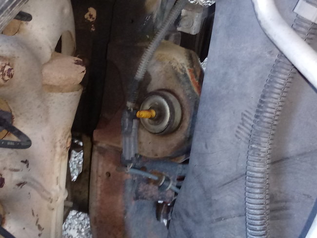

Okay. I'll start another thread about the cluster. It's no problem. I understand, lol. But yeah, the EGR has been removed. Observe exhibit A (pic I uploaded). I'm guessing it was removed when the original owner cut the exhaust off at the cab. As you might imagine my truck is supremely loud. I plan to install an exhaust system as soon as I get the other bugs worked out.

Forgot to upload exhibit A. Lol
Thursday, September 3rd, 2020 AT 6:25 PM (Merged)
  • 109,874 POSTS
Hi, Angel,
I'm not sure what I'm looking at in the pic. I see the top of the shock. I attached a pic (exhibit B) LOL of the EGR. Let me know if this is what you are referring to.

I'm sorry, I took the wrong pic. I'll upload an exhibit C later when I get the time. I'm beginning to lose hope in my chances of fixing this truck. The worst part is that I still owe on it. Anyway, my mechanic friend installed fuel injectors, fan clutch and did a transmission fluid/filter change and when we started it up after it made a terrible clunking noise like something was trying to fly out of it or came off track and then after that it wouldn't turn over at all. Some of of the injectors weren't properly placed and were leaking fuel. Some of it got in the oil, but that wouldn't have caused it to not turn over right? I sure hope that the motor hasn't stuck. That'd be my luck though. We're thinking it's the starter though since we did have trouble getting it to start before. I sure hope that's the case anyway.

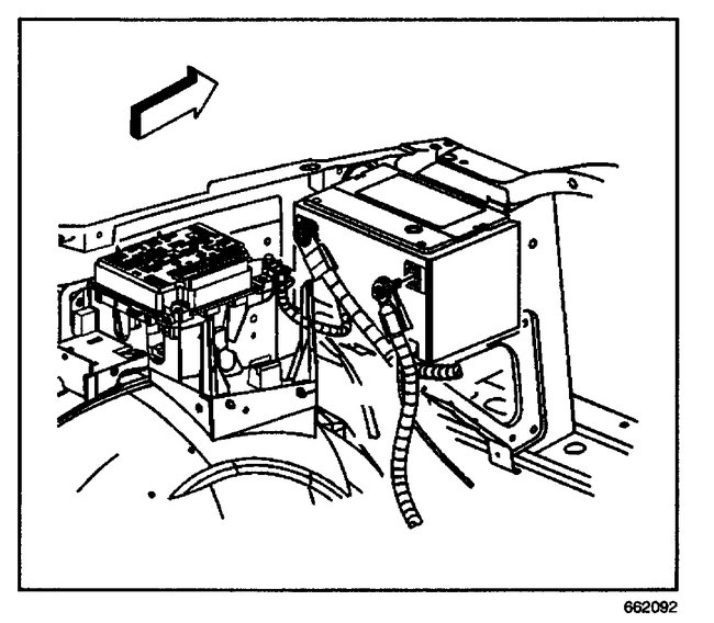

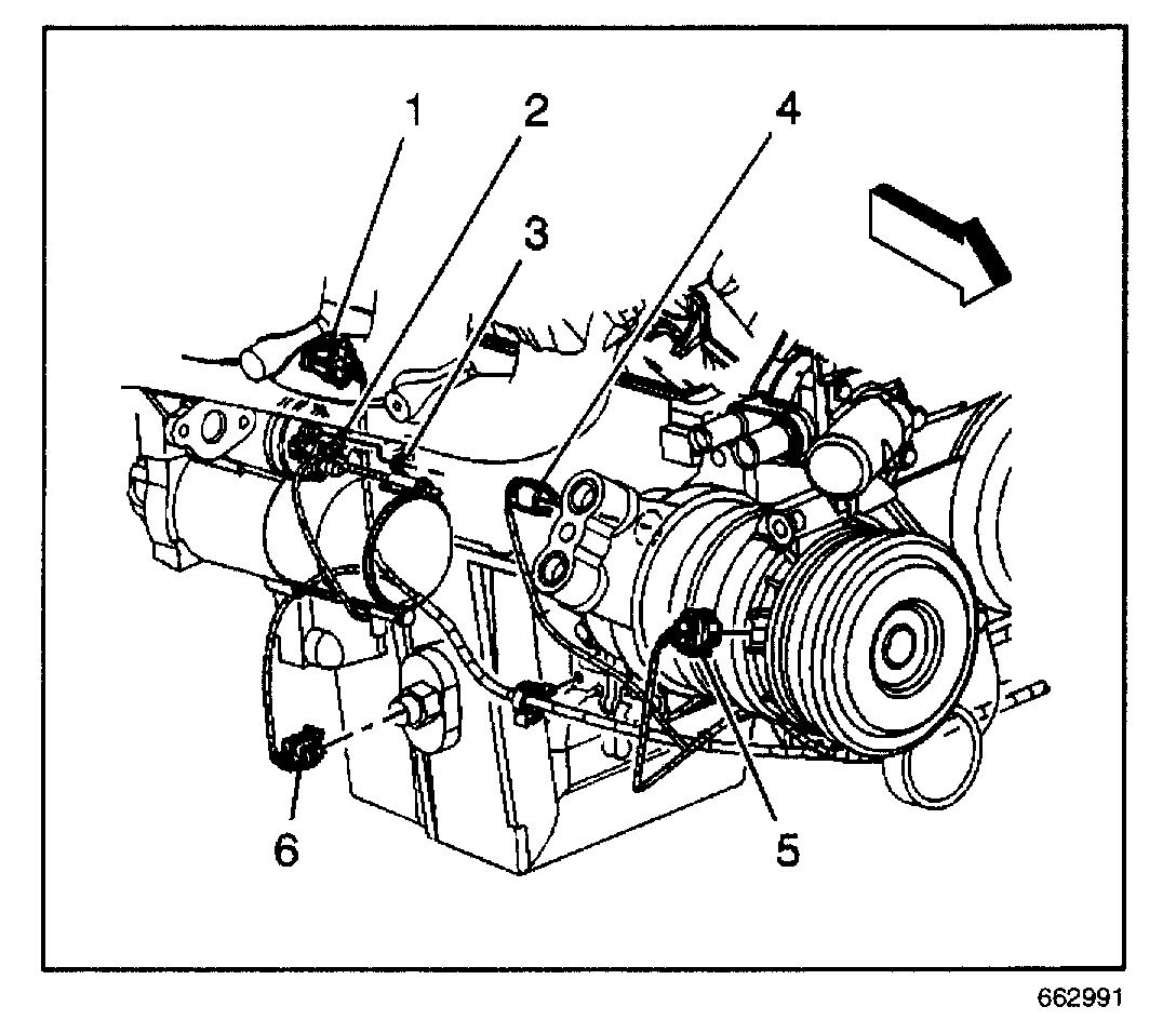

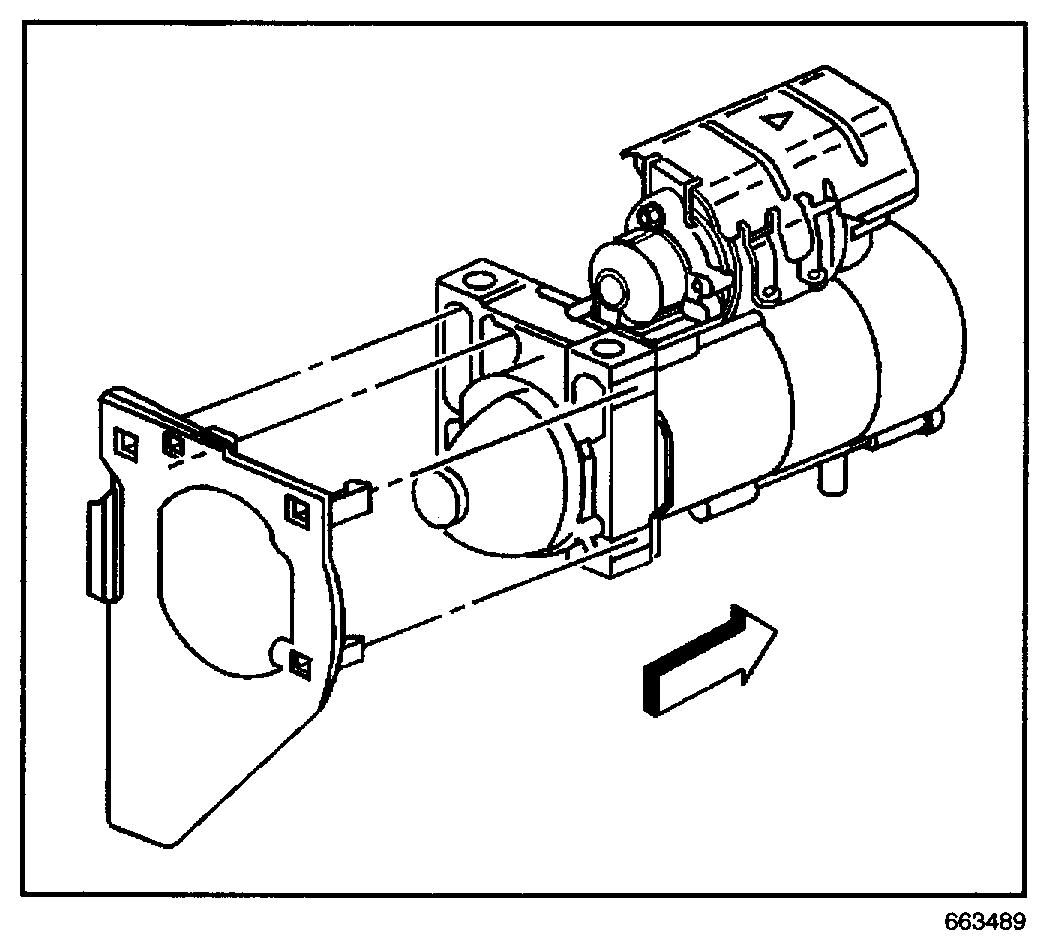

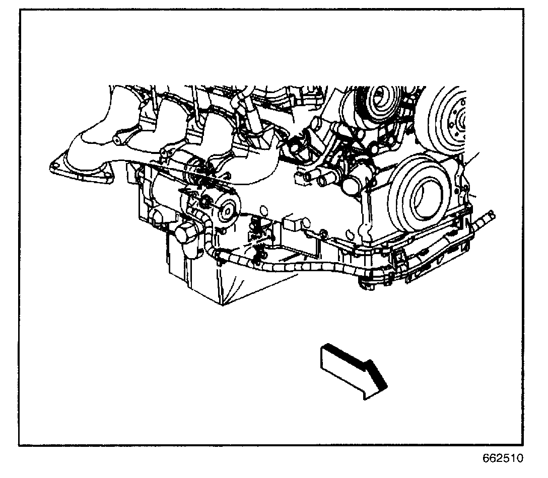

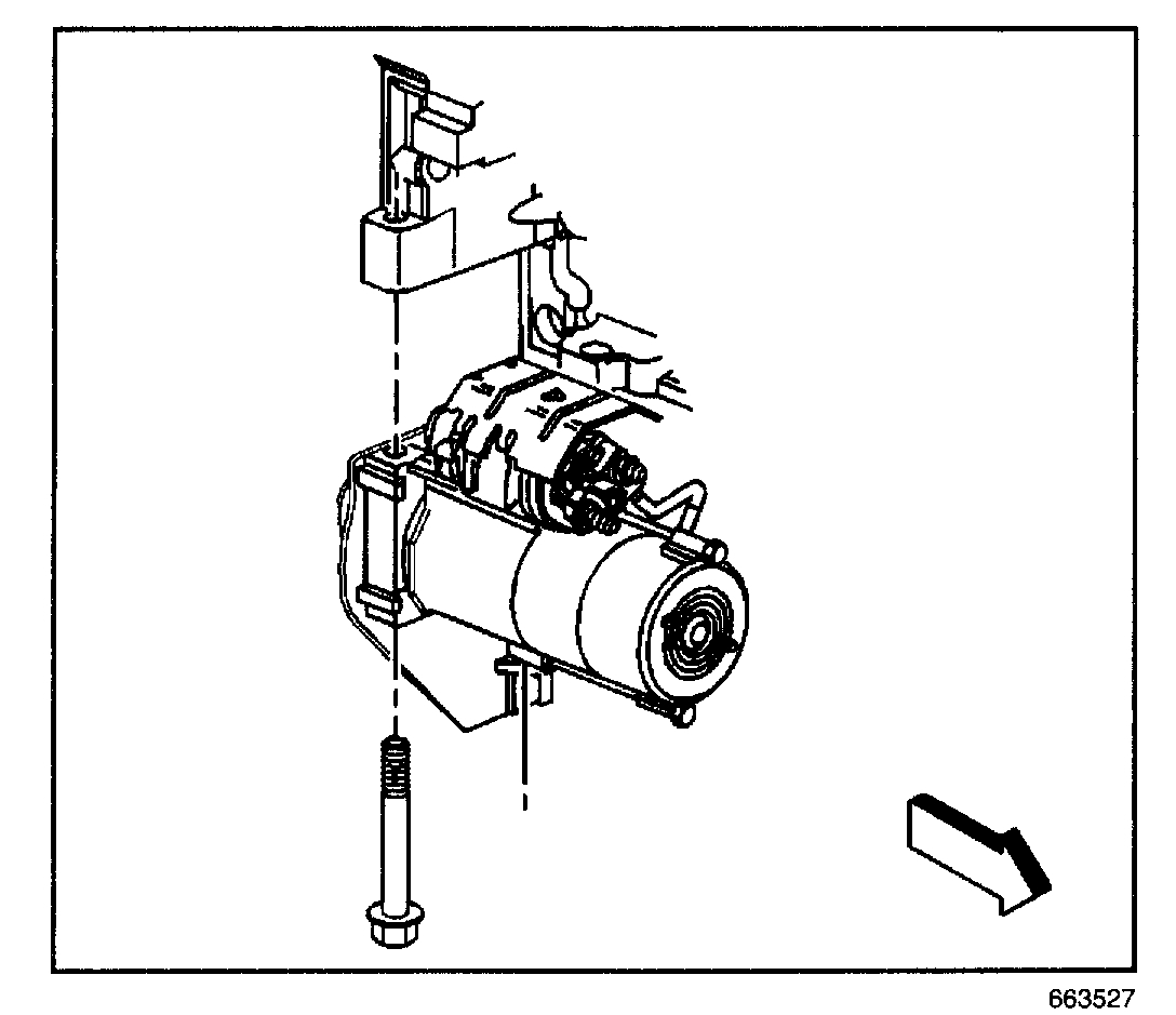

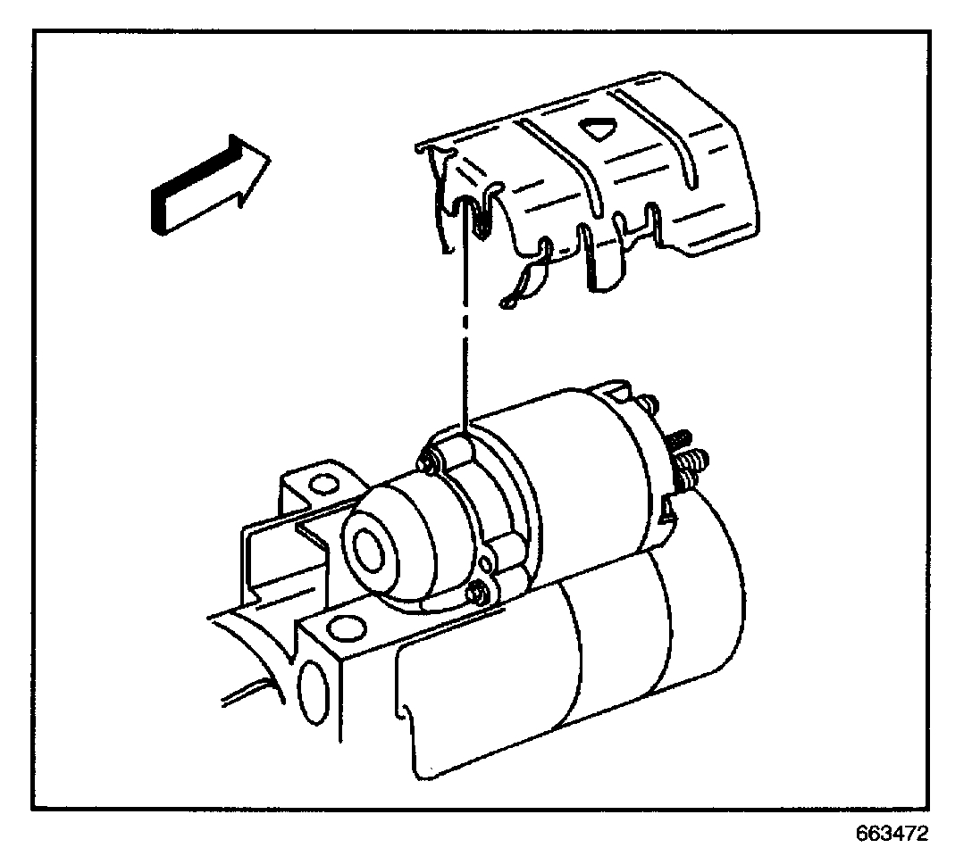

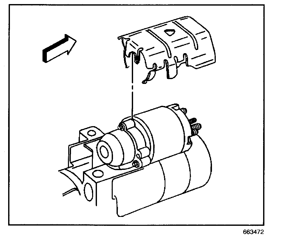

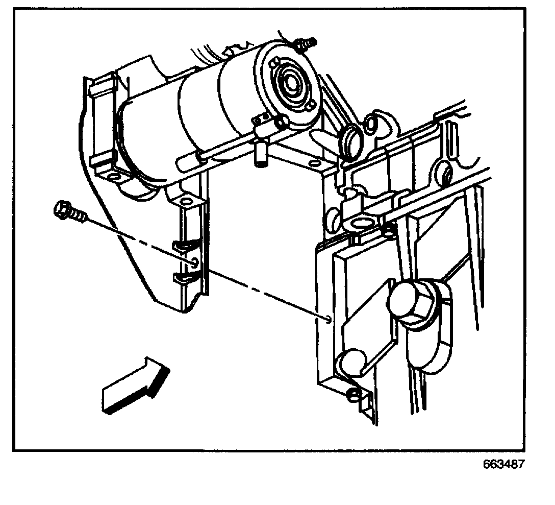

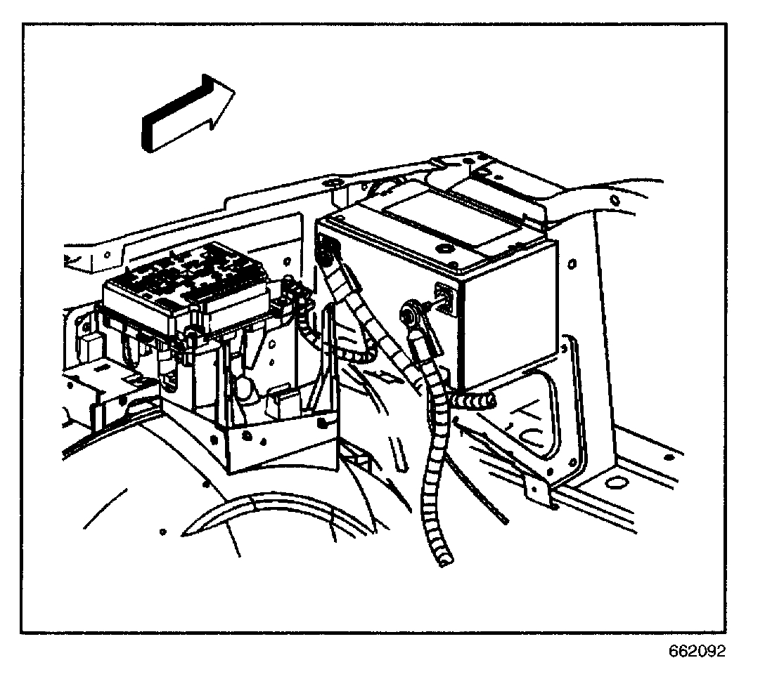

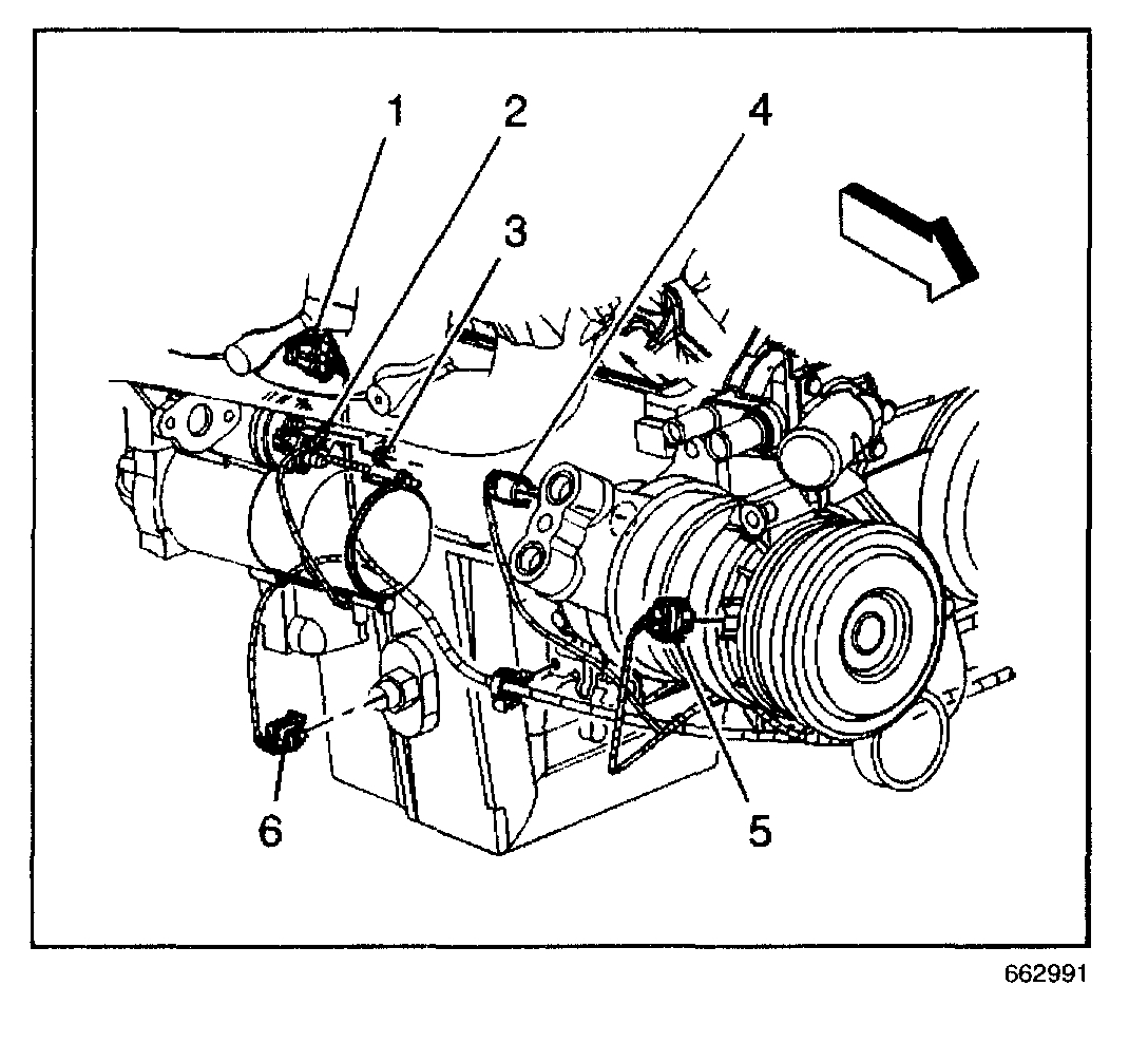

Let me know about the starter. I wish I could have heard what it was doing. I don't know if you need it, but here is a link that shows in general how to replace a starter:
Here are the directions specific to your vehicle. The attached pics correlate with the directions.
____________________________
2002 Chevy Truck K 1500 Truck 4WD V8-5.3L VIN T
Starter Motor Replacement -2
Vehicle Starting and Charging Starting System Starter Motor Service and Repair Procedures Starter Motor Replacement -2
STARTER MOTOR REPLACEMENT -2
REMOVAL PROCEDURE
CAUTION: Refer to Battery Disconnect Caution In Service Precautions.
pic 1
1. Disconnect the negative battery cable.
2. Raise and suitably support the vehicle. Refer to Lifting and Jacking the Vehicle.
pic 2

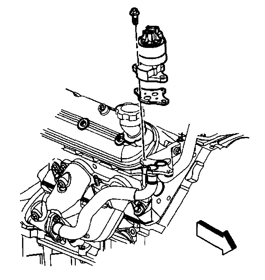

3. Remove the right transmission cover bolt.
pic 3
4. Remove the starter bolts.
5. Disconnect the oil level sensor electrical connector.
6. Slide the starter forward until the starter clears the transmission.
pic 4

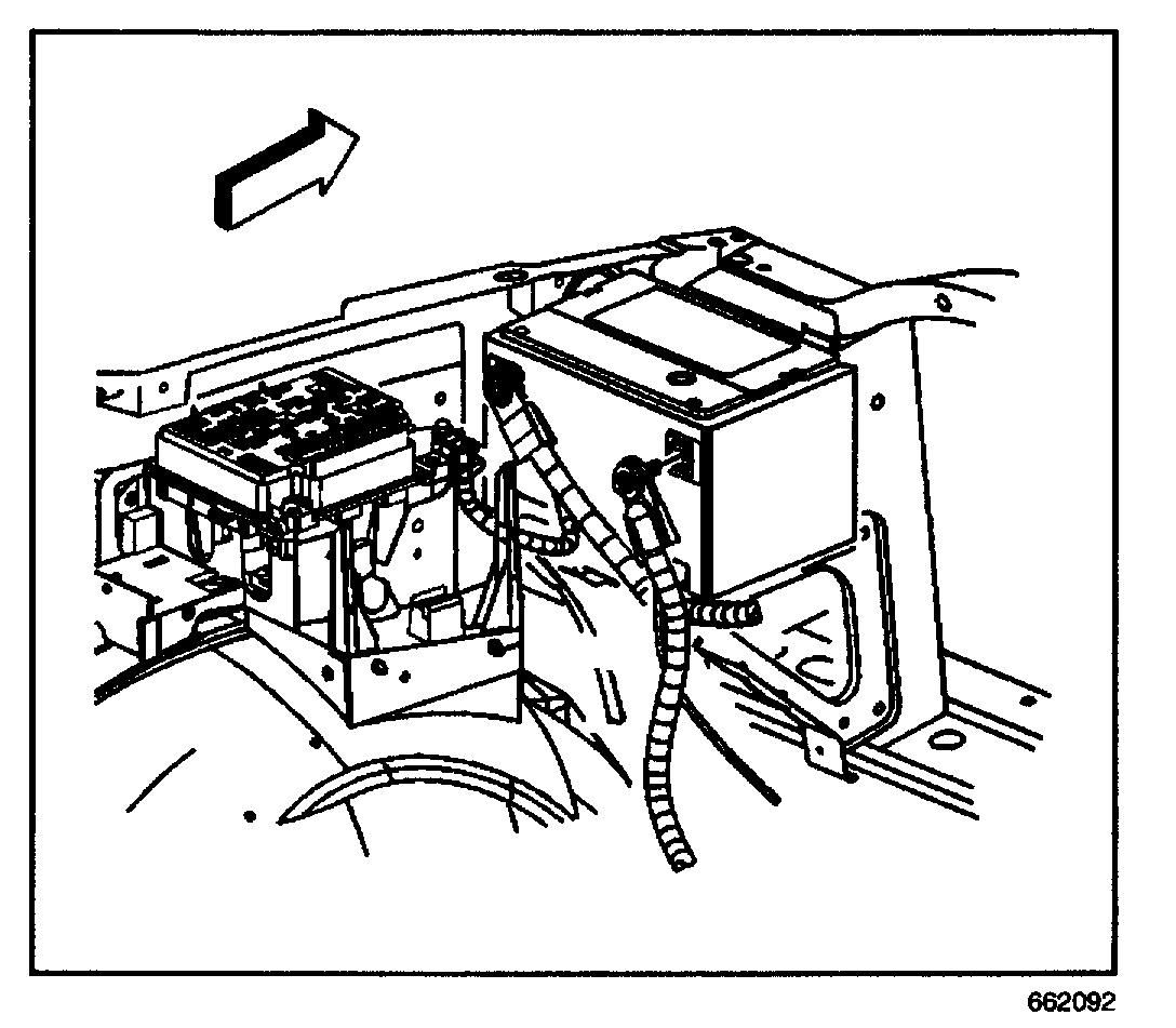

7. Remove the starter solenoid nut (3).
8. Remove the starter lead (2) from the solenoid stud.
pic 5
9. Remove the starter lead nut.
10. Remove the positive cable from the starter stud.
11. Place the starter on a workbench.

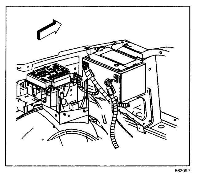

pic 6
12. Unsnap the transmission cover from the starter.
pic 7
13. If necessary, remove the starter shield.
INSTALLATION PROCEDURE
pic 8
1. If necessary, install the starter shield.
pic 9
2. Snap the transmission cover to the starter.
pic 10
3. Install the positive cable to the starter stud.
NOTE: Refer to Fastener Notice in Service Precautions.
4. Install the starter lead nut.
Tighten
Tighten the starter lead nut to 9 N.m (80 lb in).
pic 11
5. Install the starter solenoid lead (2) to the solenoid stud.
6. Install the starter solenoid nut (3).
Tighten
Tighten the starter solenoid nut to 3.4 N.m (30 lb in).
pic 12
7. Snap the transmission cover onto the starter.
8. Slide the starter rearward.
9. Install the starter bolts.
Tighten
Tighten the starter bolts to 50 N.m (37 lb ft).
10. Connect the oil level sensor electrical connector.
pic 13
11. Install the right transmission cover bolt.
Tighten
Tighten the transmission cover bolt to 9 N.m (80 lb in).
12. Lower the vehicle.
pic 14
13. Connect the negative battery cable.
___________________
