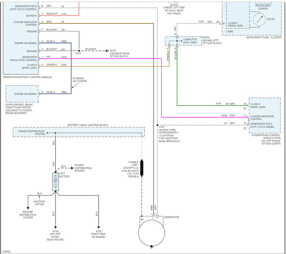

My truck listed above SS has a battery light on and it is not the alternator or the battery per AutoZone. They load tested and all came back good. What would I need to look at next and are there any tools I will need to test things myself? I read a post that said could be BCM? Could be a fuse? Cluster is newly rebuilt and oil pressure was bad when cluster was put in changed sending unit and gauge reads good now so trying to pin point my problems. Thanks in advance.
Sep 3, 2020 at 6:23 PM (Merged)
  • CAR REPAIR CONTRIBUTOR
  • 110,190 POSTS

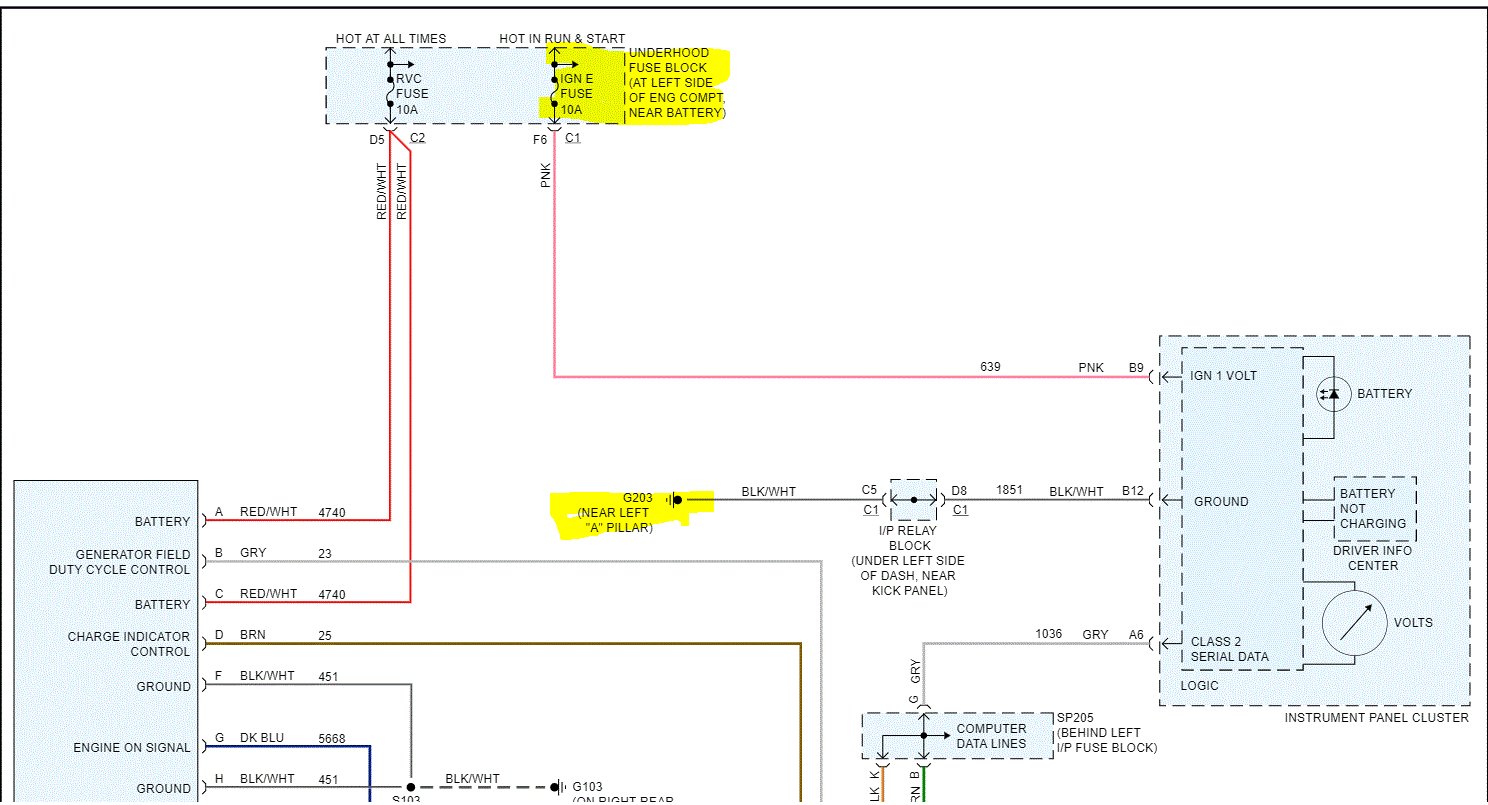

Is the alternator charging the battery? Do me a favor. Try this simple test to confirm charging. All you need is a multi meter or volt meter.
With the engine off, you should be right around 12v at the battery. With it running it should be near 14v. If it is charging, then there are a few things to check. I attached two pics below of the charging system. In the first pic, I highlighted a fuse to check and also a ground.
Do that first and let me know what you find.

NACHOSS
  • 6 POSTS
Vehicle off voltage is between 12.6 and 13. Vehicle on is around 14.4. AC on stereo on vehicle is around 15 volts. Fuse you highlighted is good I don’t see the ground wire or relay under dash next to kick panel going toward a pillar.
  • 110,190 POSTS
Are you able to check for power to the pink wire going to the instrument cluster. We could have a bad connection or damaged wire. I'm asking this because if the fuse is good, the next think to check is if power is making it to the IPC.
NACHOSS
  • 6 POSTS
I apologize for the long hiatus just finally got time to do this. I checked the pink wire at the connector to the cluster with key on and I get 12.23 volts. Truck running I get just over 14, like 14.10.
  • 110,190 POSTS
Okay, can you check for ground to the black wire. Basically check for continuity to ground. If there is ground, I suspect something has failed in the cluster.

NACHOSS
  • 6 POSTS
There is a black wire with a white stripe when I test that one I get a -0.03. The all black ground under it I test that wire and get a -0.06.

MERLIN2021
  • 17,250 POSTS
My thought is either corrosion on the battery cables, especially the negative, check for voltage drop on the both cables. shut off the truck. measure battery voltage, then measure the negative cable at the block and + battery post, if not the same as battery voltage replace the cable, do the same on positive cable but touch _ post, readings should be battery voltage. If OK re check connection to alternator, and check small ground spur wire to the fender if you have one. Also when you say no codes, did you scan it with a tool capable of reading B and U codes? Or with a generic tool for P codes? B and U codes cant be read with generic tools and do not set the service engine light. This truck has a generator battery control module that monitors the charging system. and the first step is ALWAYS to scan...
  • 110,190 POSTS
It is the black/white one. Disconnect the battery when checking for continuity. Power is showing negative, so somehow the battery polarity is getting reversed. It is likely because the battery is connected.

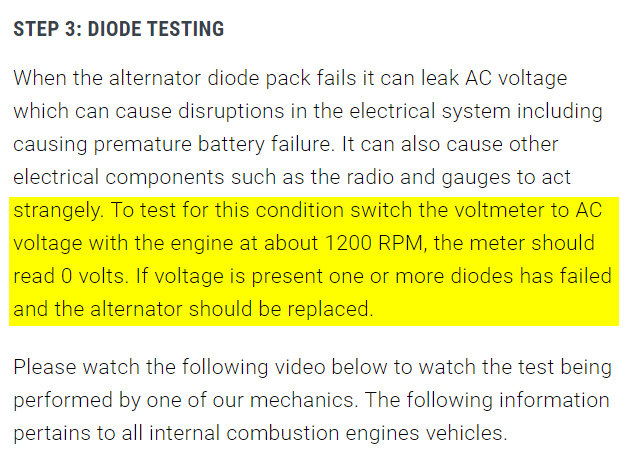

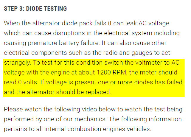

JOHN WILKINSON
Started truck after work and barely turned over. Drove fine on the way home. Got home did not have enough charge to turn over. Jump started. Checked voltage while running. Was between 13-14 volts. Replaced battery. Everything worked great. One week later battery light comes on but everything is working fine. Tested alternator 13.70v same result under load with lights and A/C. I did test for A/C voltage and got 0.033. your video said to test for that. Is that enough to need a replacement? I thought maybe that is what killed my last battery.
I assume you are talking about the diode test when you got .033 volts AC at 1200 RPM?
If that is the case, then yes a diode has failed and you need to replace the alternator. This will cause your battery to fail and a new battery on a bad alternator would last about a week depending on the load and use.
The battery light simply means there is not sufficient voltage present so it is normally the battery or alternator so I think you have enough to feel confident that the alternator will fix this.
Let me know if you have questions. Thanks
