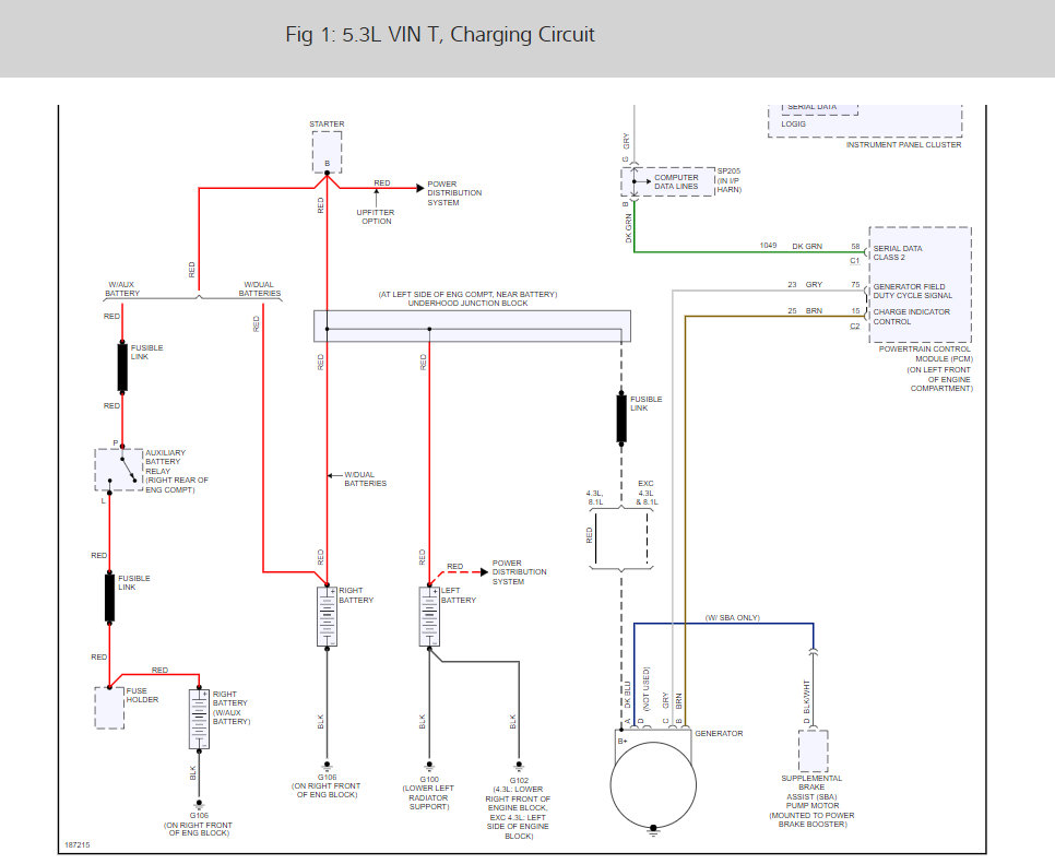

I have checked the alternator battery all the wiring and the grounds in the engine but the battery light in the cab turns on and off along with the message center telling me the battery is not charging turning on and off.
Sep 23, 2019 at 6:31 AM
Good evening.
Can you check the voltage at the battery with the engine running?
Sep 23, 2019 at 8:50 AM
JOSEPH19832
Their is 14.6 at the battery and 14.7 at the alternator. also the battery is holding a 12.5-12.6v charge.

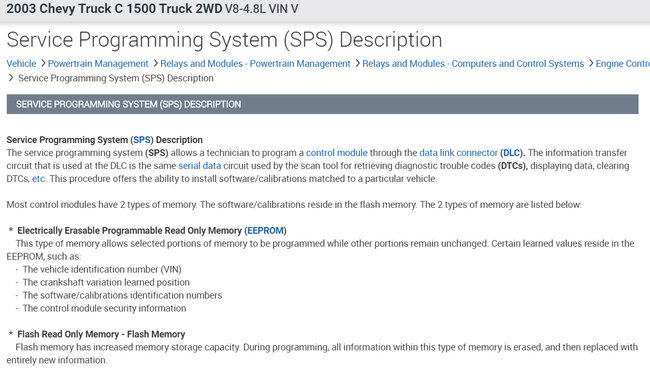

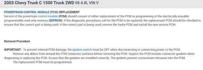

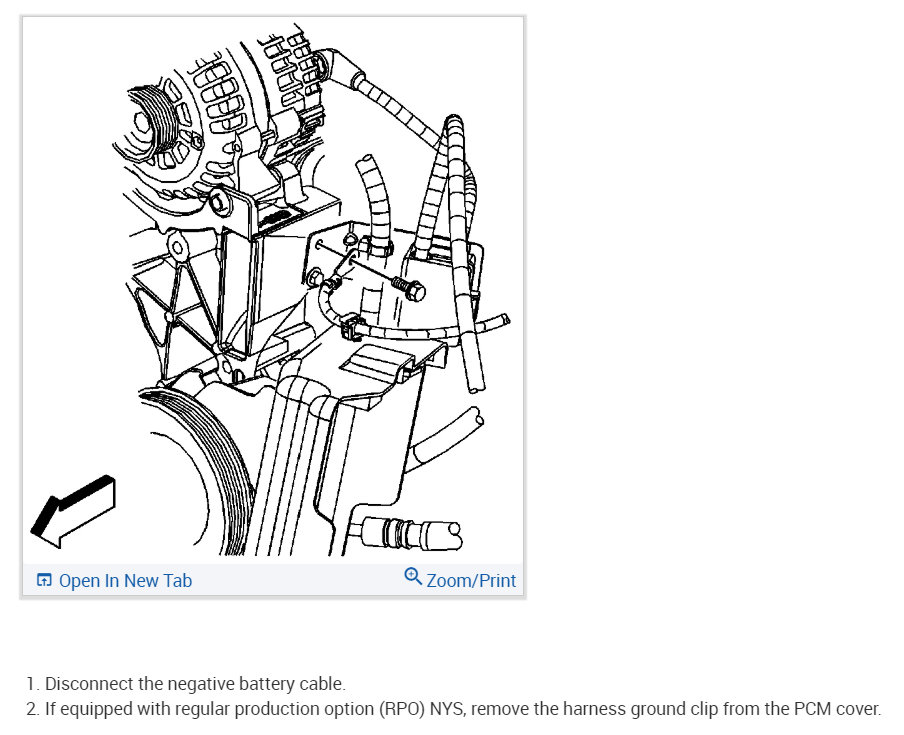

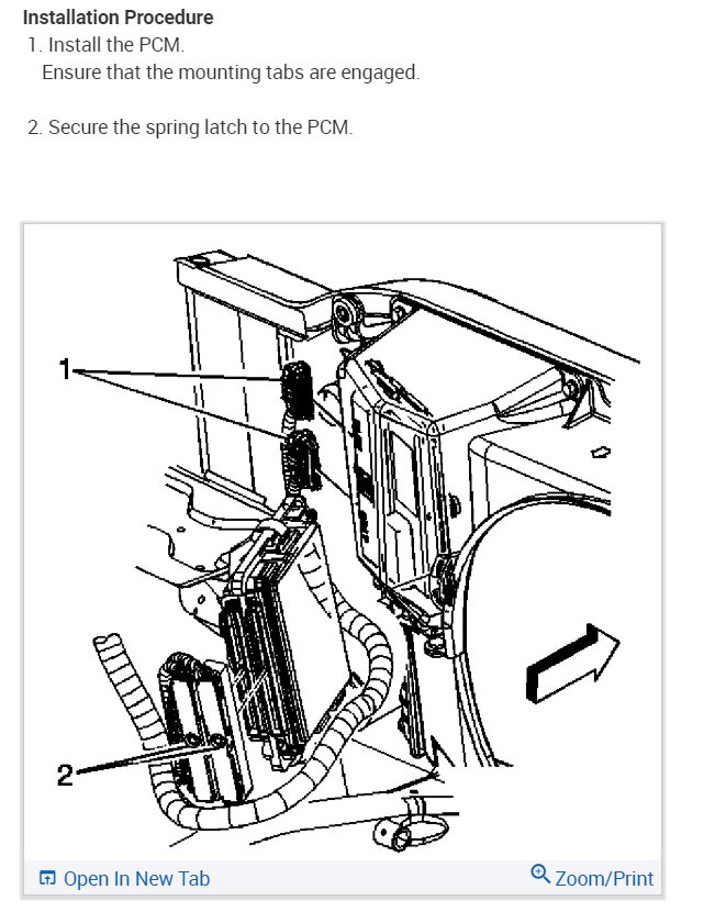

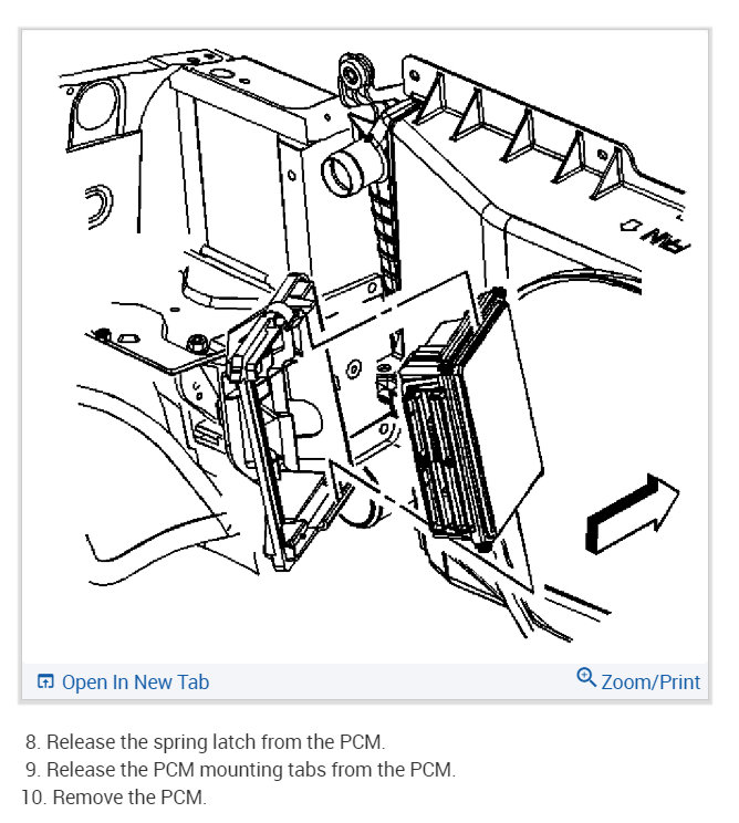

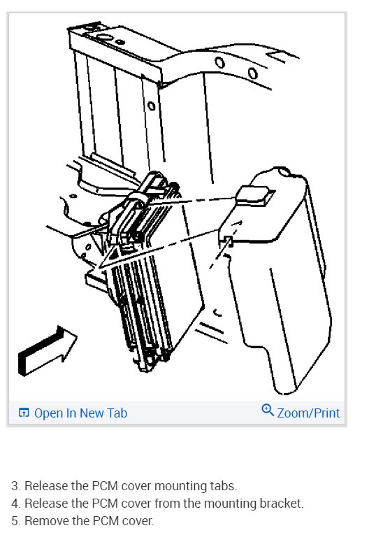

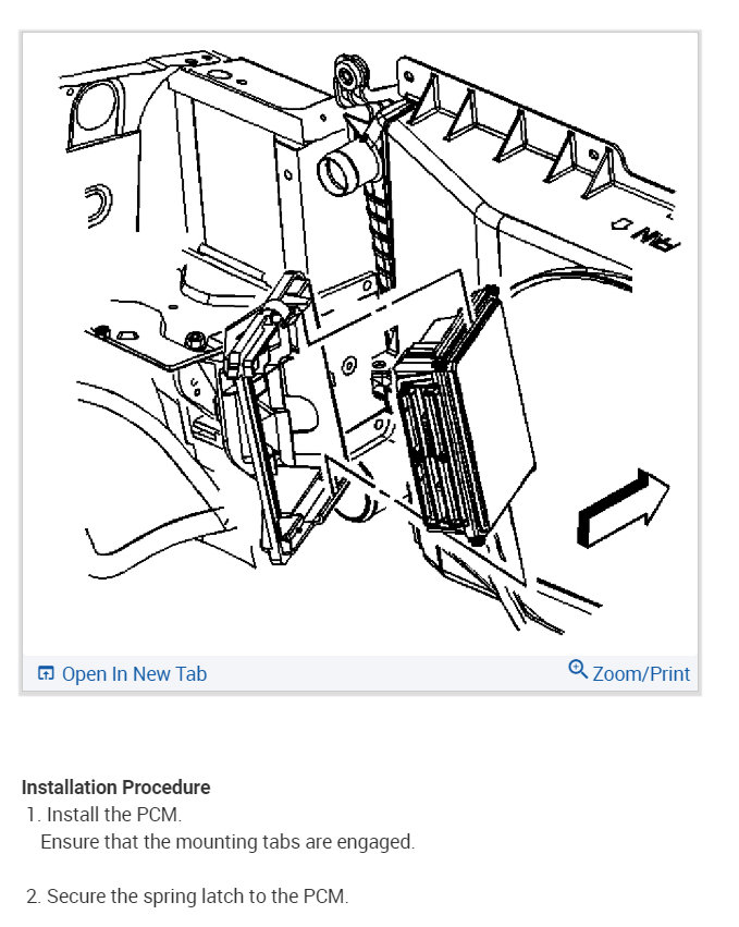

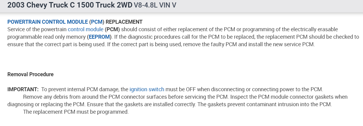

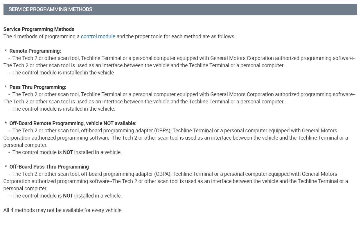

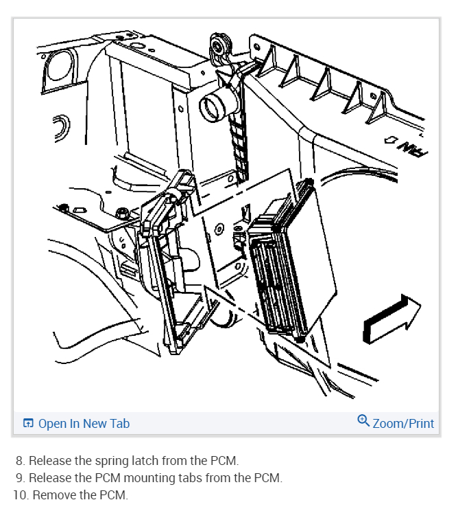

If I can step in here. it sounds like the have a bad PCM that is what controls the alternator. To be sure here is a guide to check the wiring with the alternator wiring diagrams so you can see how the system works and the PCM replacement instructions as well:
Sep 25, 2019 at 8:22 AM

Sounds like you need to have the computer controlled of the alternator's field generation circuit -checked

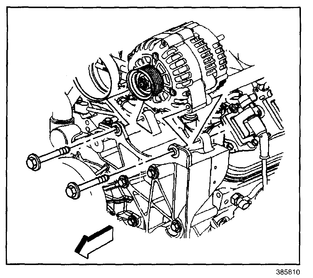

If you see the alternator gauge dropping, chances are the alternator is the problem. Do me a favor. I want you to check the alternator output. It is very easy to do. All you need is a volt meter or a multi meter. Here is a link that explains how it is done:
I don't know if you need it, but here is a link you may find helpful:
If you find the alternator isn't producing and needs replaced, here is a link that shows in general how it is done:
https://www.2carpros.com/articles/how-to-replace-an-alternator
____________________________________
Here are the directions specific to your vehicle for replacement. The attached pics correlate with the directions.
2002 Chevy Truck K 1500 Truck 4WD V8-5.3L VIN T
Generator Replacement
Vehicle Starting and Charging Charging System Alternator Service and Repair Procedures Generator Replacement
GENERATOR REPLACEMENT
REMOVAL PROCEDURE
CAUTION: Refer to Battery Disconnect Caution in Service Precautions.
pic 1
1. Disconnect the negative battery cable.
2. Remove the accessory drive belt.
3. If necessary, remove the engine sight shield.
pic 2

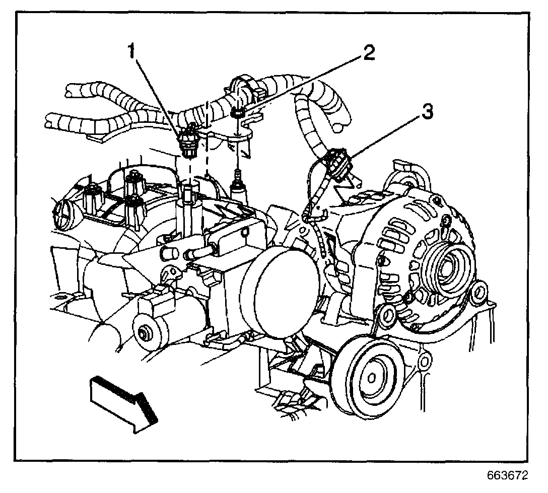

4. Disconnect the generator electrical connector (3).
pic 3

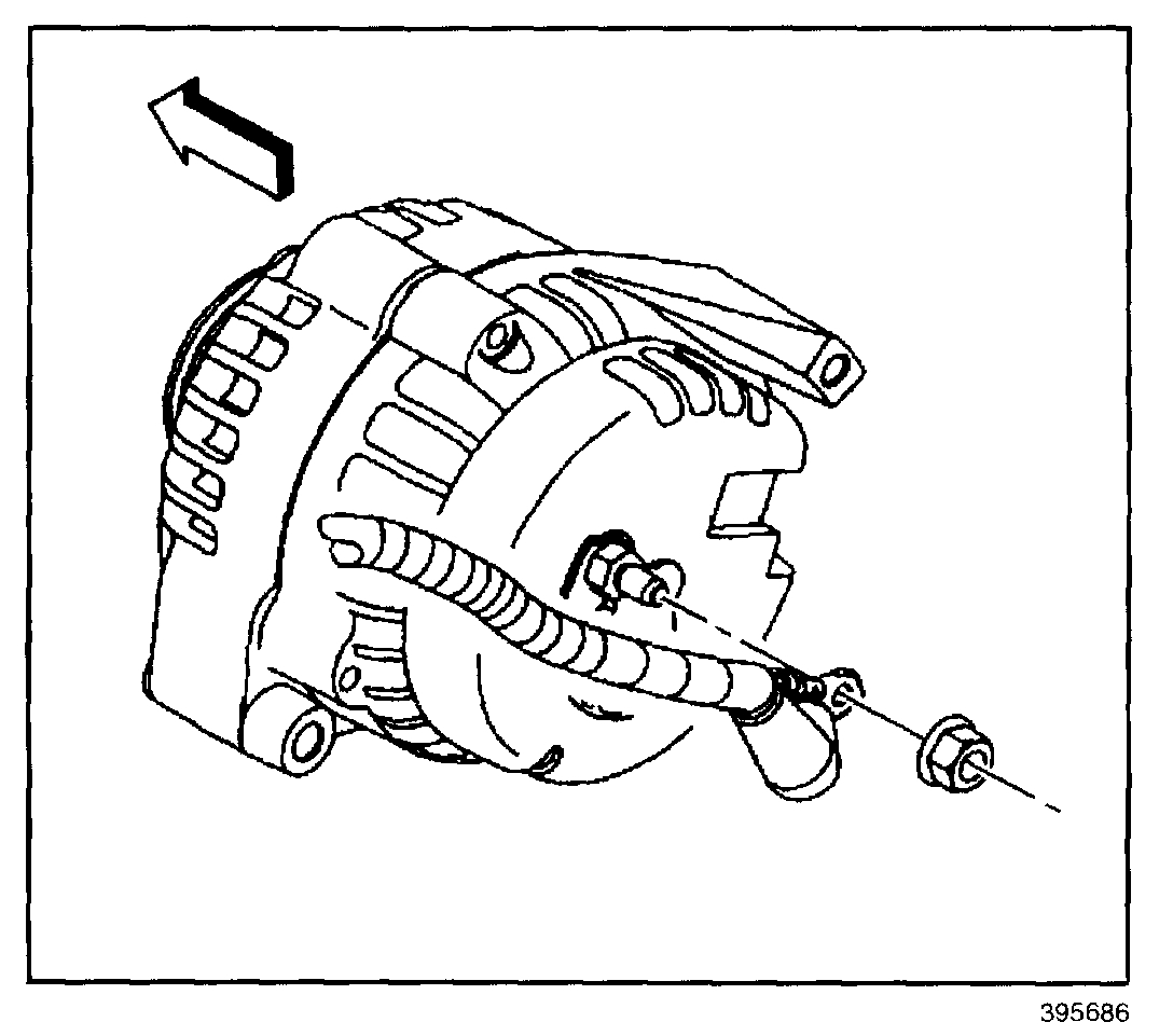

5. Remove the generator cable from the generator, perform the following:
5.1.Slide the boot down revealing the terminal stud.
5.2.Remove the generator cable nut from the terminal stud.
5.3.Remove the generator cable.
pic 4
6. Remove the generator bolts.
7. Remove the generator.

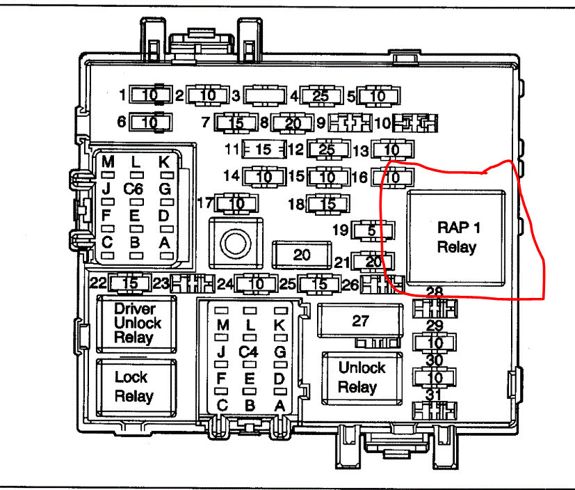

Interesting about the wires. Are the connected to the brake pedal switch? Is it possible for you to upload a pic of what you found? I want to see how they are in the box. If possible, attach a pic of the remote jumper cable you mentioned.
Sep 3, 2020 at 11:25 AM (Merged)

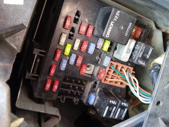

ANGEL LONG
  • 17 POSTS

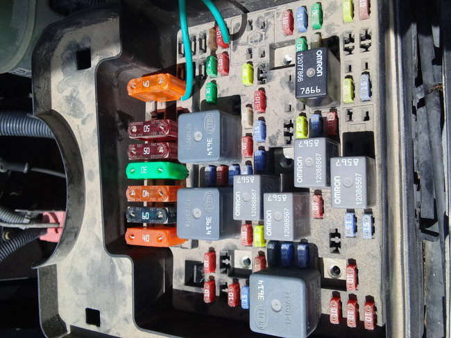

The wires go to the brake switch. The last pic is of the fuse block on the inside.

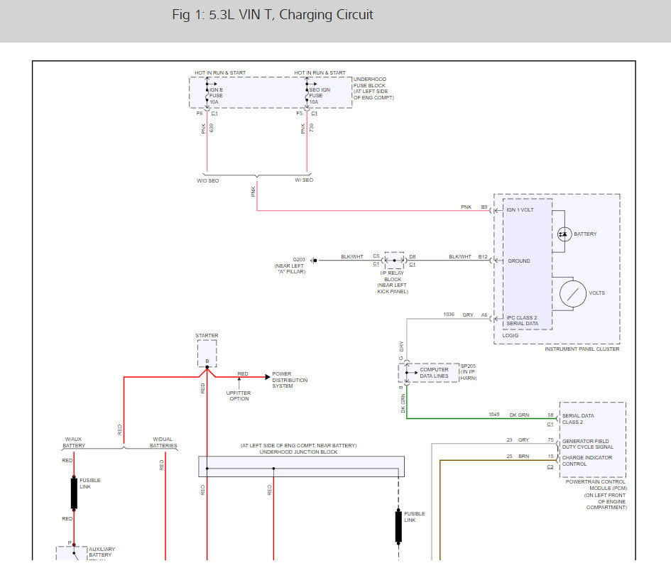

  • 75,988 POSTS
Get the computer controlled of the alternator field generation duty cycle signal circuit checked out and also check battery and alternator connections-

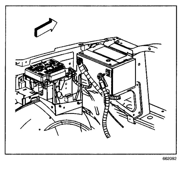

  • 110,251 POSTS

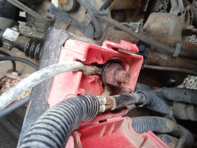

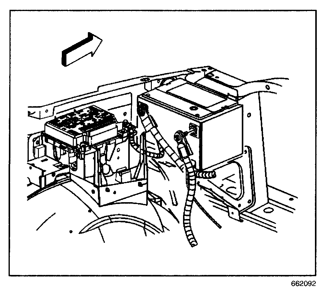

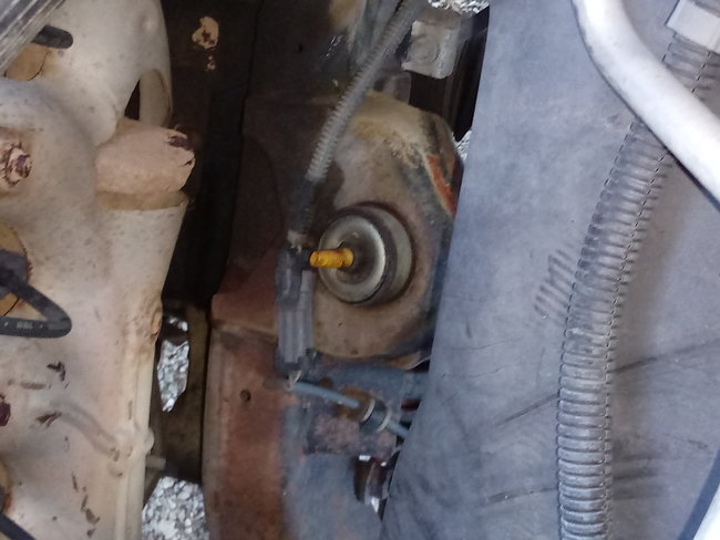

Since the jumper wires they attached are pushed in, disconnect them from power and see if the brake lights still work. If they do, I suspect those were for an electrical brake controller.
Also, pic 1 shows a lot of corrosion. Disconnect the battery, remove the nut (pic 1) and clean everything to confirm a good connection.
Let me know what you find.
ANGEL LONG
  • 17 POSTS
We replaced the jumper. It's getting connection a lot better, but it still doesn't want to start after running a while. None of the gauges inside are working now...The wires do work the brake lights. Do you think that's wearing the battery down? Side question: as you can see in the third pic I posted, the RAP relay is missing, do you think that has anything to do with the problem? Also, my mechanic friend says the clutch fan needs replacing, would that run the battery down?

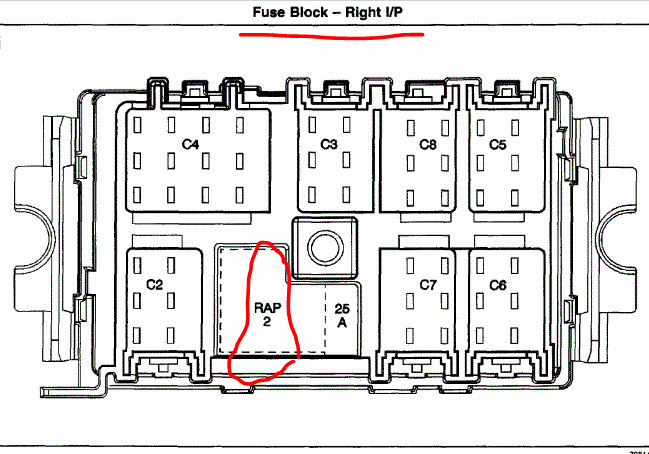

As far as the RAP, that is energized until you have the key removed and open the door. If the door isn't opened, it will power certain accessories until a predetermined amount of time passes. Since there isn't one, I have no idea if the prior owner is powering some things all the time. The RAP continues power to things such as the power windows, radio, Onstar and so on. Do any of those things remain powered after the key is in the off position and prior to opening any doors? Note there are two RAP relays. See pics 1 and 2 for locations.
As far as the loss of instrument panel gauges, did you check fuses where you were working? Also, have you ever been able to identify if spark or fuel is missing when it refuses to start?

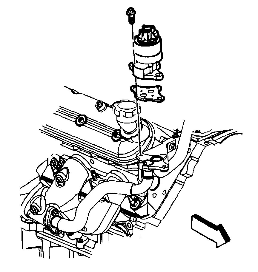

  • 110,251 POSTS
Hi, Angel,
I'm not sure what I'm looking at in the pic. I see the top of the shock. I attached a pic (exhibit B) LOL of the EGR. Let me know if this is what you are referring to.

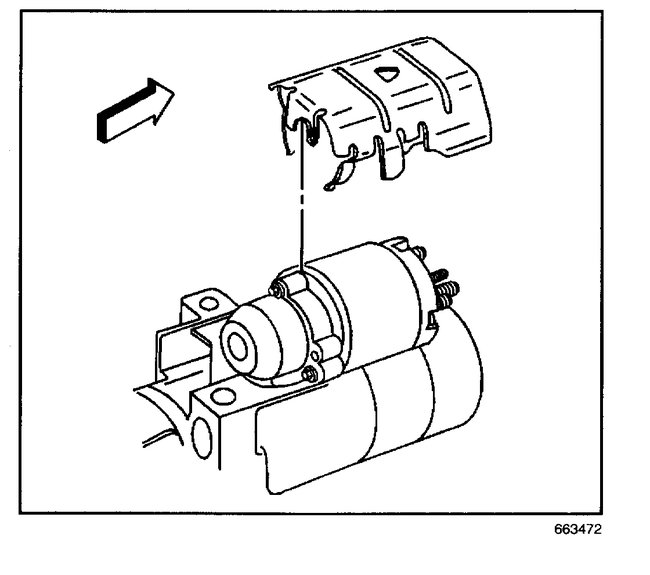

We'll get it running. Don't worry. Upload exhibit C when you get the chance. Also, the leaking fuel injectors won't cause the engine to lock up. However, how did it get into the oil? Where were they leaking from? Keep in mind, any fuel leak can be dangerous so be careful.
Let me know about the starter. I wish I could have heard what it was doing. I don't know if you need it, but here is a link that shows in general how to replace a starter:

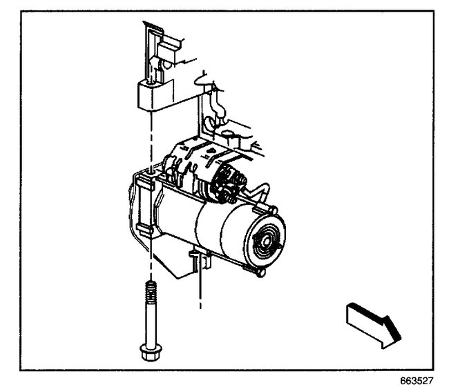

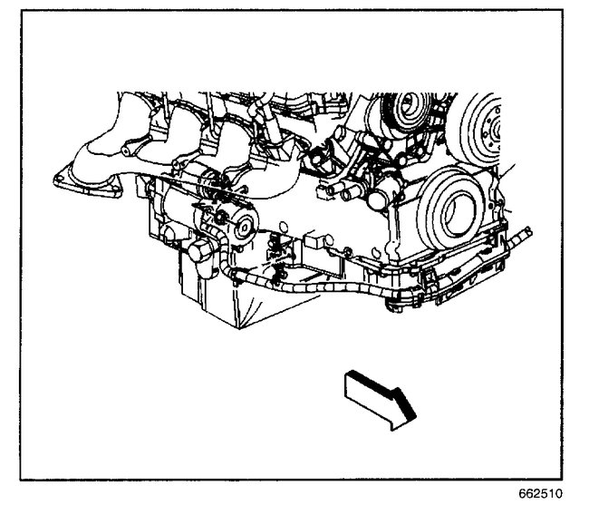

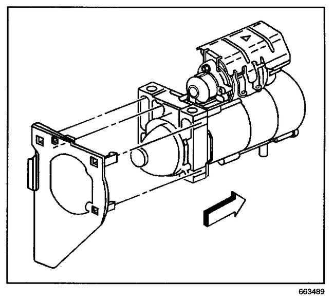

Here are the directions specific to your vehicle. The attached pics correlate with the directions.
Starter Motor Replacement -2
Vehicle Starting and Charging Starting System Starter Motor Service and Repair Procedures Starter Motor Replacement -2
STARTER MOTOR REPLACEMENT -2
REMOVAL PROCEDURE
CAUTION: Refer to Battery Disconnect Caution In Service Precautions.

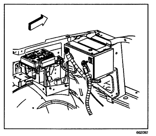

pic 1
2. Raise and suitably support the vehicle. Refer to Lifting and Jacking the Vehicle.

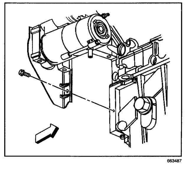

pic 2
3. Remove the right transmission cover bolt.
pic 3
4. Remove the starter bolts.
5. Disconnect the oil level sensor electrical connector.

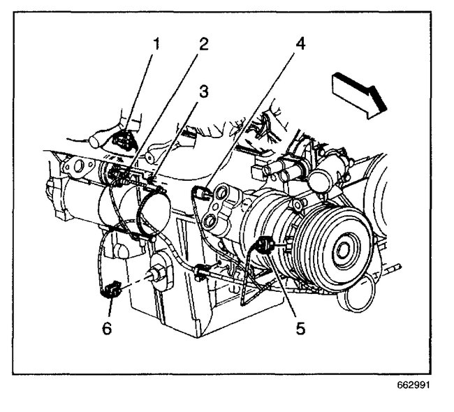

6. Slide the starter forward until the starter clears the transmission.
pic 4
7. Remove the starter solenoid nut (3).
8. Remove the starter lead (2) from the solenoid stud.
pic 5
9. Remove the starter lead nut.
10. Remove the positive cable from the starter stud.
11. Place the starter on a workbench.
pic 6
12. Unsnap the transmission cover from the starter.
pic 7

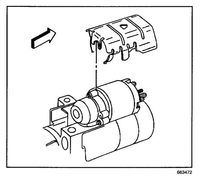

13. If necessary, remove the starter shield.
INSTALLATION PROCEDURE
pic 8
1. If necessary, install the starter shield.
pic 9
2. Snap the transmission cover to the starter.
pic 10
3. Install the positive cable to the starter stud.
NOTE: Refer to Fastener Notice in Service Precautions.
4. Install the starter lead nut.
Tighten
Tighten the starter lead nut to 9 N.m (80 lb in).

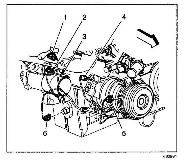

pic 11
5. Install the starter solenoid lead (2) to the solenoid stud.
6. Install the starter solenoid nut (3).
Tighten
Tighten the starter solenoid nut to 3.4 N.m (30 lb in).
pic 12
7. Snap the transmission cover onto the starter.
8. Slide the starter rearward.
9. Install the starter bolts.
Tighten
Tighten the starter bolts to 50 N.m (37 lb ft).
10. Connect the oil level sensor electrical connector.
pic 13
11. Install the right transmission cover bolt.
Tighten
Tighten the transmission cover bolt to 9 N.m (80 lb in).
12. Lower the vehicle.
pic 14
13. Connect the negative battery cable.
